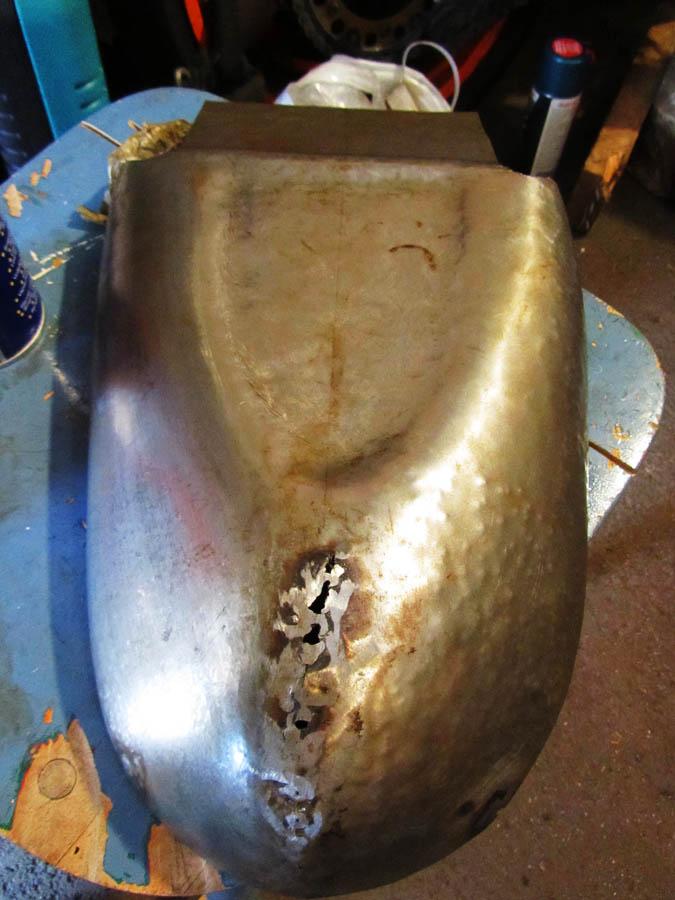

I started out with just a few handtools and an old "stickweld" not made for thin metal :)
Along the way a few new things been bought, as tigwelder, shrinker and a featherhammer to smoothen out the metal.

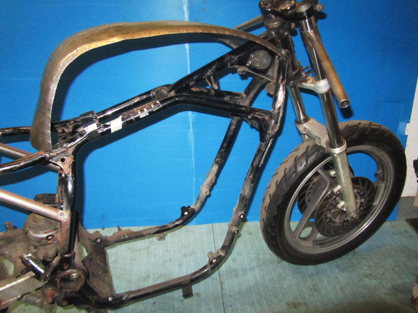

Here is a review in pictures starting last winter ...

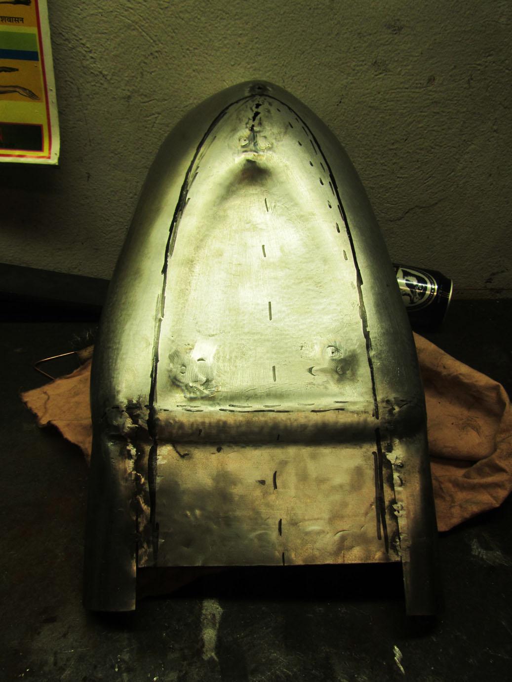

From Dec 2011 to Aug 2012 I was doing everything in a garage with no heat or insulation, no "real" electricy ...
Unfortunatly I have lost all pictures as harddrive crashed :-\ from the first month. A lot of the first metalwork ended up in trash can, but one pice I'm still proud of is the cuts (not sure that is what you call it). This piece is still on the bike but I will do another, slightly bigger as the last gastank i HUGE ... pics on that one will come late in this story :)

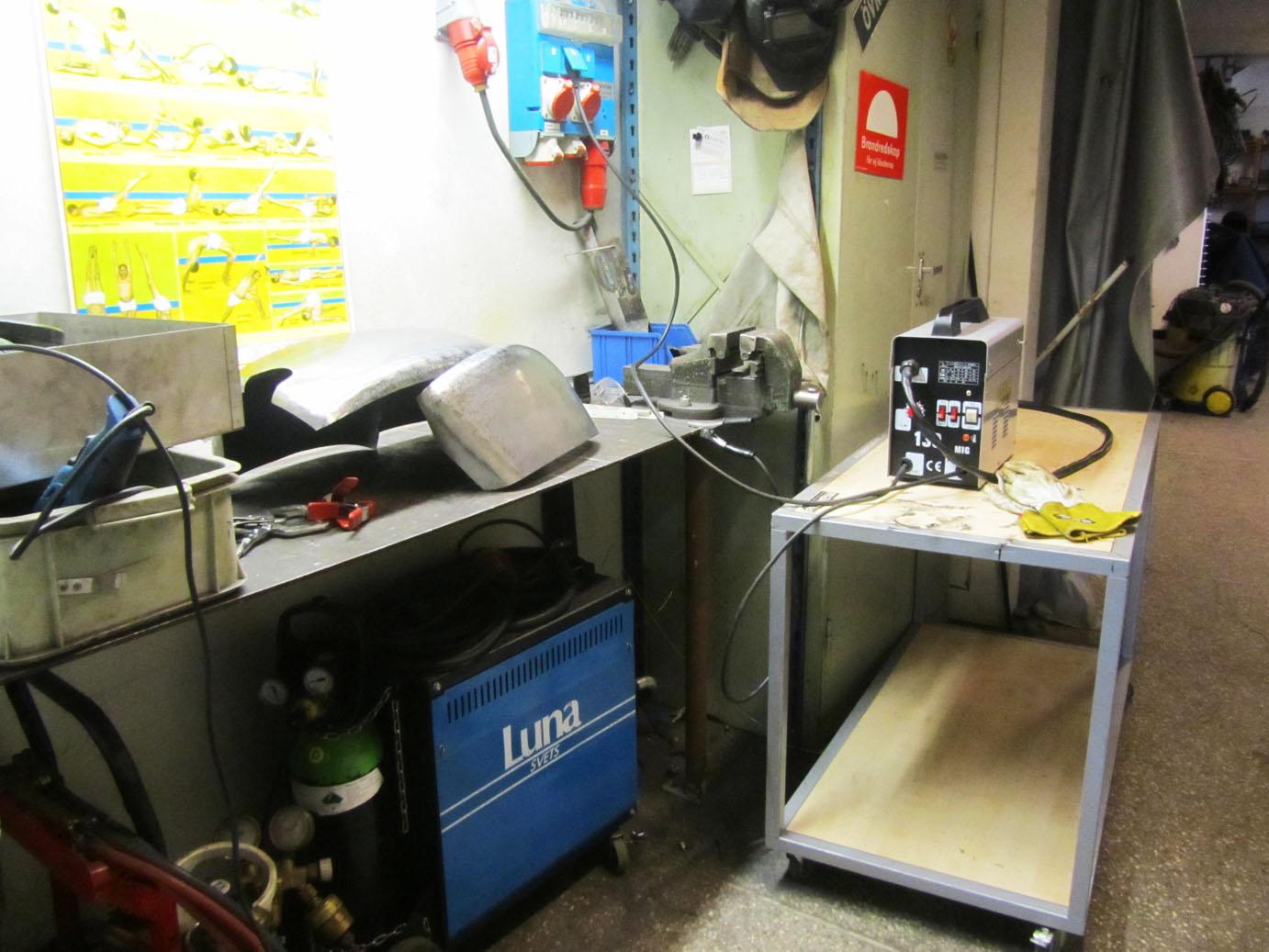

Will try to update until "as is" before next visit to the garage. Next pics is from August and the new garage. And just moving in and see all the others bikes or projects, mostly bobbers, inspired to build a new gastank :) but this one became a bit to much chopper ... oops!
First pic is what I brought from old garage...

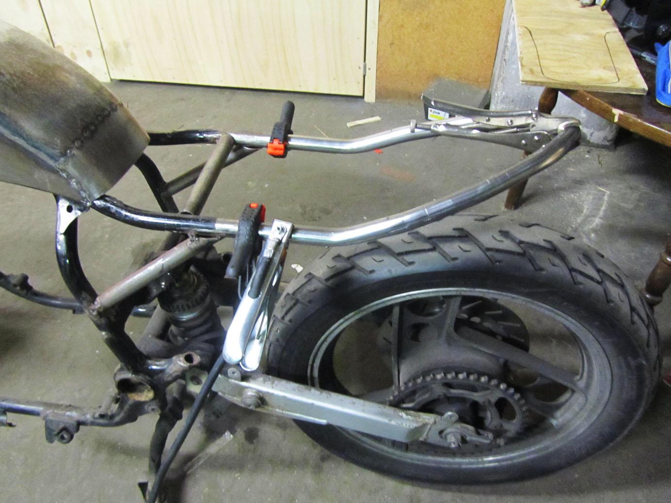

Next step was to lower the backend to get rid of the fighter looks... at same time needed to cut out a bit of the cuts buttom.
Did som mockup to see what to use and desided ...none :) (missed to attach the other mockup pic)

Still got a lot to learn when it comes to tig welding. My first real big AHA, was realising I needed glases ;) hepp, a new world opened up in close range 8)

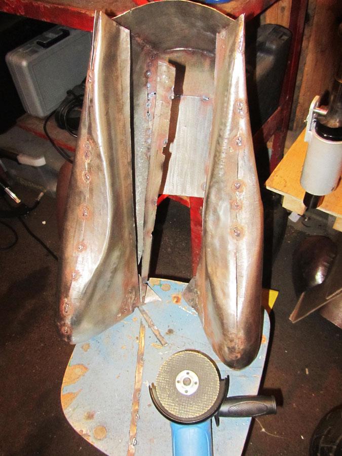

Well, things start to look like I want. Less fun to deal with is the bottom of gastank, a lot of angles in different directions and I found it real hard to get clean and nice fitting between all pieces. A pair of clip-ons was also made, as I could :) now having the right tools for that in the new garage :)

Tnx Bolshevik. Well, long time ago , like 20 years ago I did some constrution-welding in thick metal, but never with MIG or TIG and never in thin metal (and as said earlier in tread, a LOT of pieces is in trash can with a LOT of burned holes in :o )

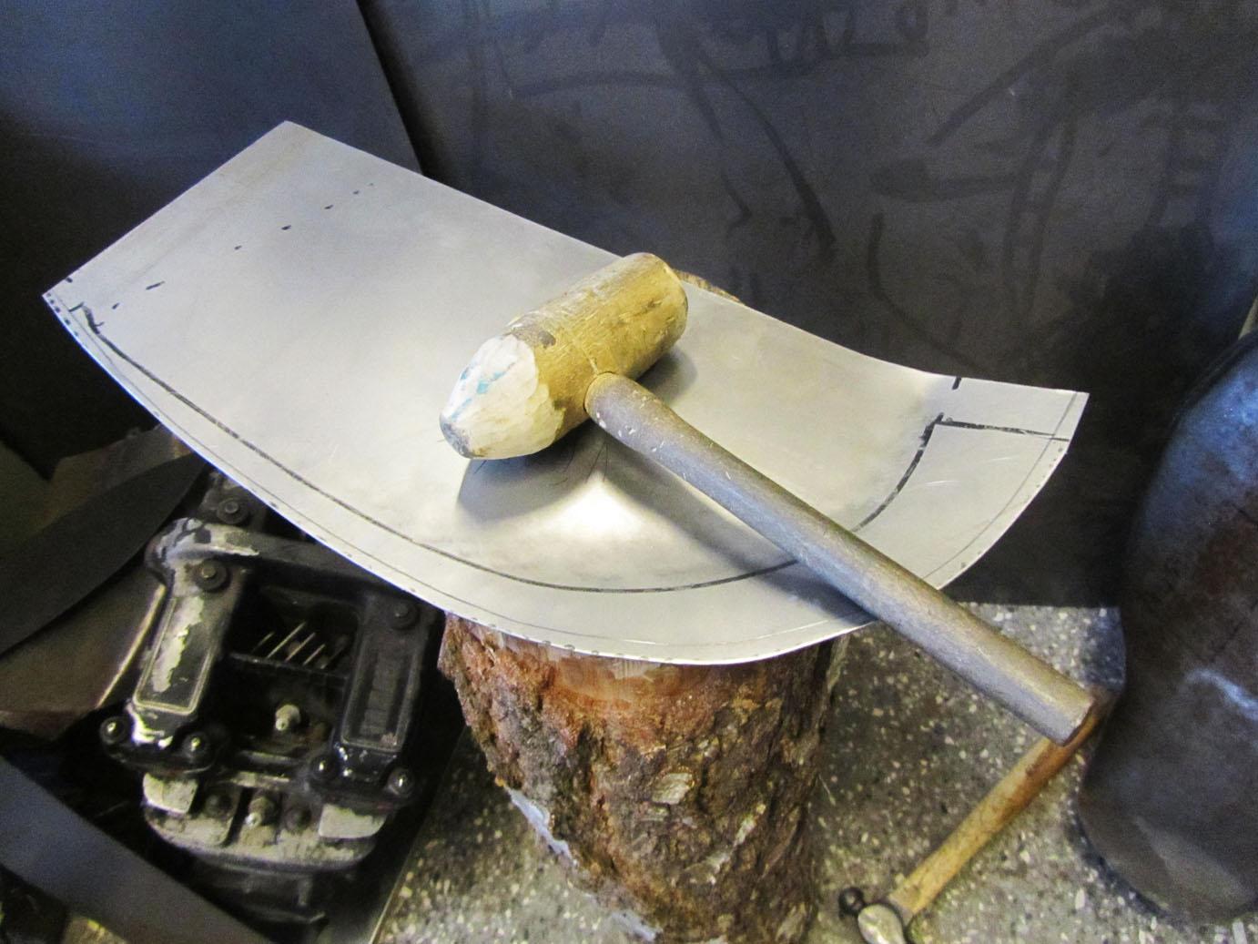

Some thoughts about a new gastank started in my head as I bought a shrinking tool :)
Found out tat we call it MANX tank, in Sweden, and thats a cool piece of art.... just how I think a gastank should look like ...
so...
See that the pics came last pic first ...
So, building a Norton Manx gastank ... maybe this time I have taken "water over my head" (swedish expression for not knowing what you are doing) :)
AND, I will build one like this, in a couple of years, in polished alloy (?), thats anyway what I aiming for :)
But, my skills are not there yet ...
