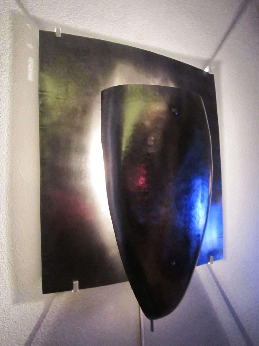

Spent evening in garage :D
Didn't get as far as a wanted, should just weld a small "inner frame" to support the piece that will be front of the tail and meet the seat... GAHHHH, nothing worked out as I wanted.
But ... whom of you have a piece of your bike on the wall in the livingroom ::)
AND your girlfrind think it's realy goodlooking...
Here's a piece of my tail upon a piece of naked metal ;D
Another thought crossed my mind ... NO TAIL, just a small pice of metall on a rod ... thats it??
I had a dark brown leather brooks seat on our mantel that the wife liked.
Are you really going to use that seat?
:) "LIKE"
Well, that seat someone just picked out o fsome box for see how it could turn out... but I probably stick with my tail, I just hate it for the moment ;)
