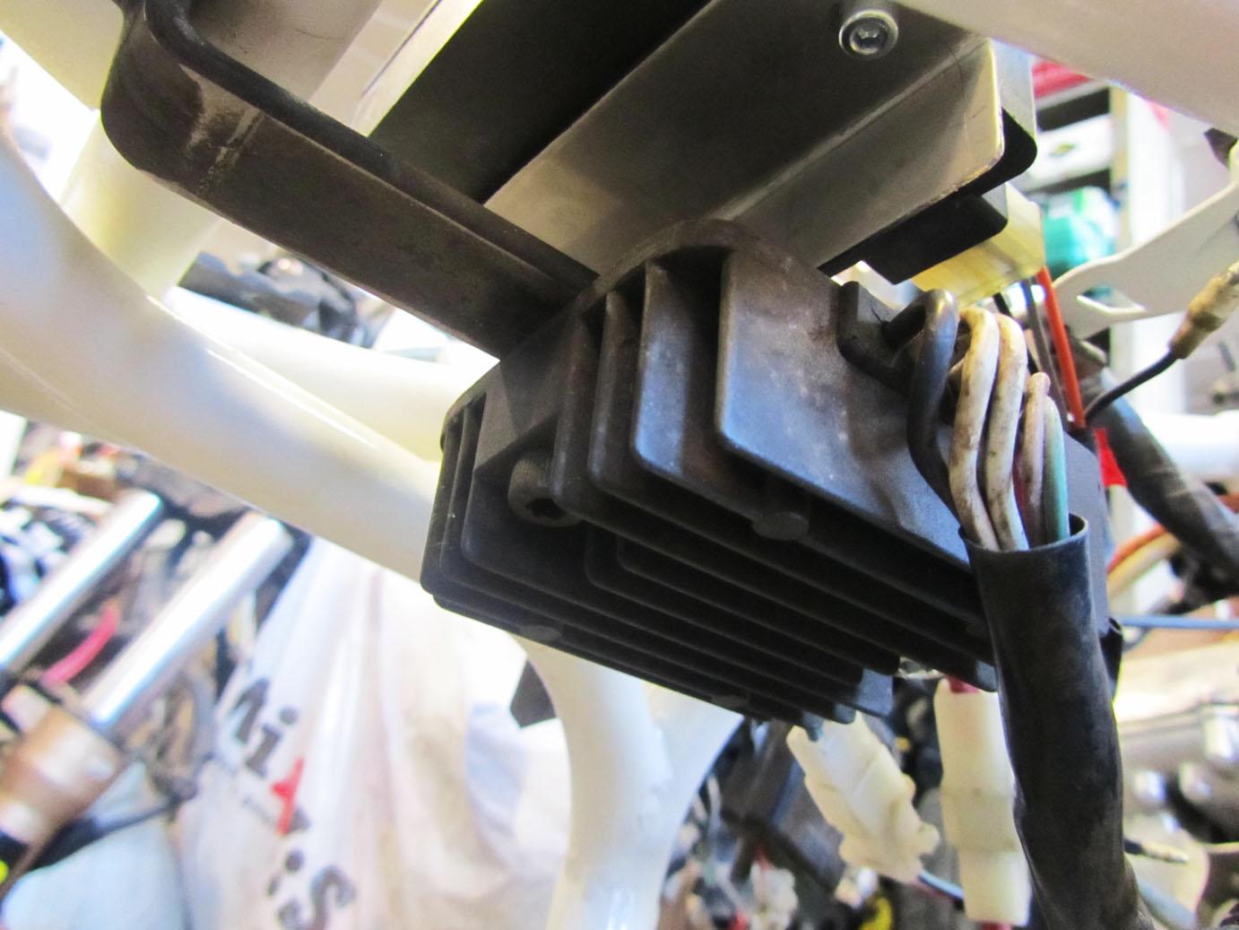

How about my cafebuild then... well, been in the garage a couple of times , made some small progress. Started to do the eletrics... ouh, not my cup of the.... but needed.

Made some boxes in alu for eletric stuff.

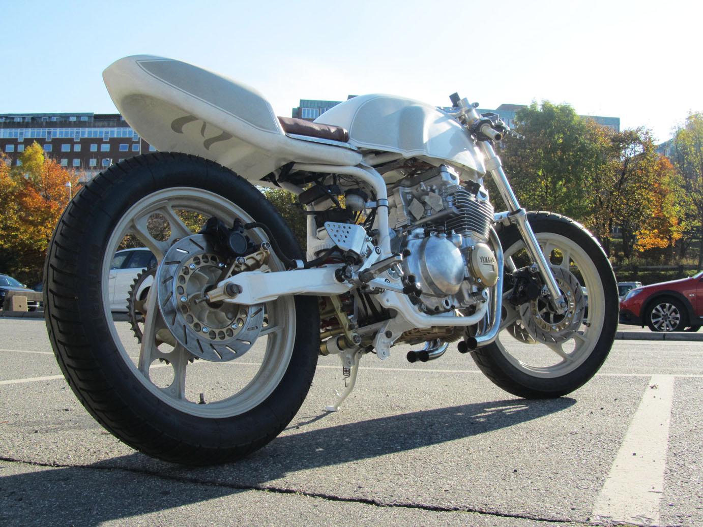

And also took it out in the sun so I could get a chance to look at it from some distance.

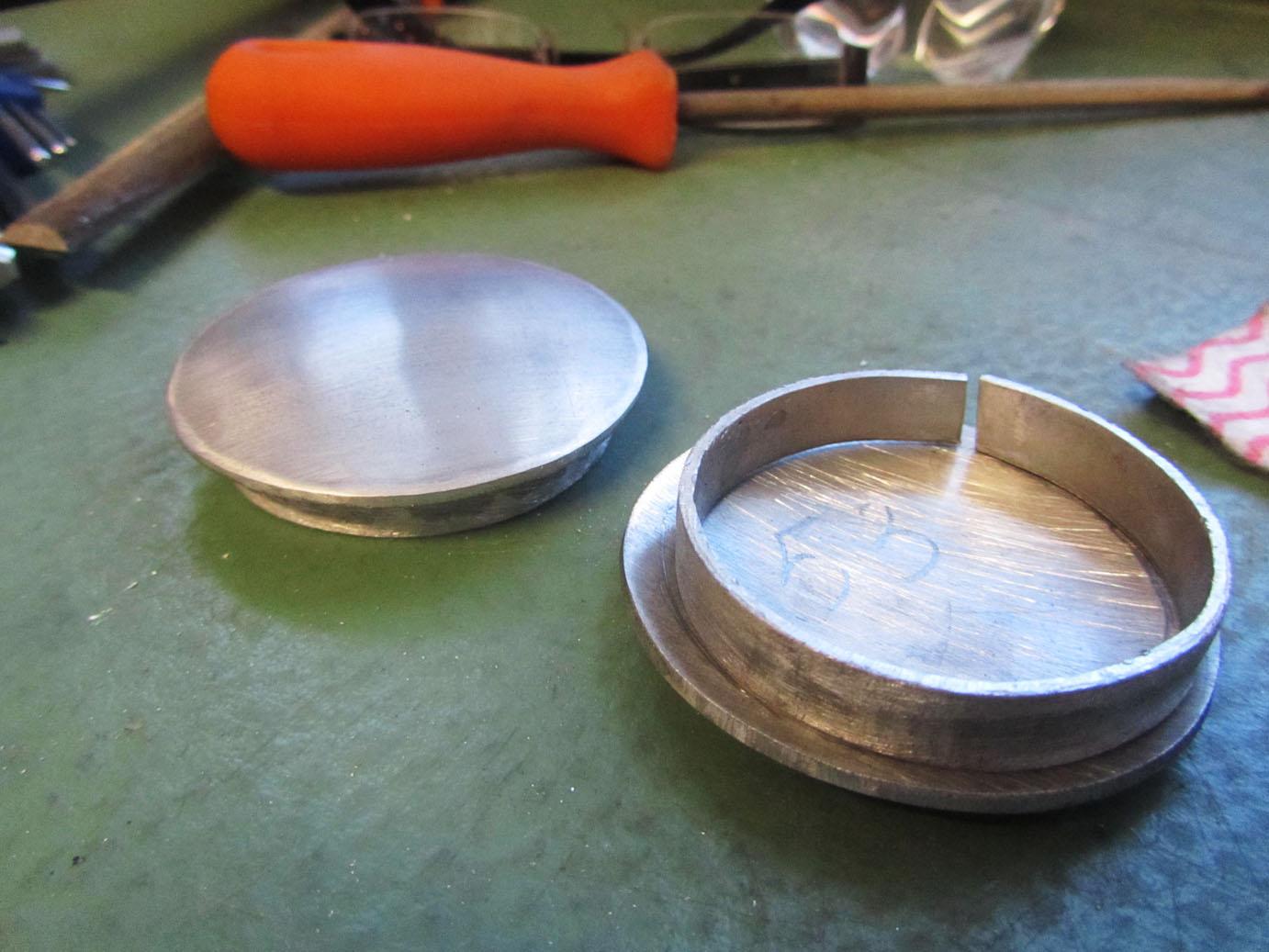

Also made 2 alucaps to hide swingarmbolts.

And some pics from the outside...

WOW
The Yanx is looking great out there in the sun. The full bike shots show off all the hard work you've done on this. The tank and tail have really nice lines. She looks fast sitting still, I guess that is the goal that we all have for our bikes. Happy to hear you are able to get back to work on this too.
phil

Started cleaning the oilcoller, pulled it apart and start sanding parts. Will have a gold frame and black. Also got alurods for "welding" alu, will try this out on the covers for swingarmbolts. Hope to remember bring a camera :)
