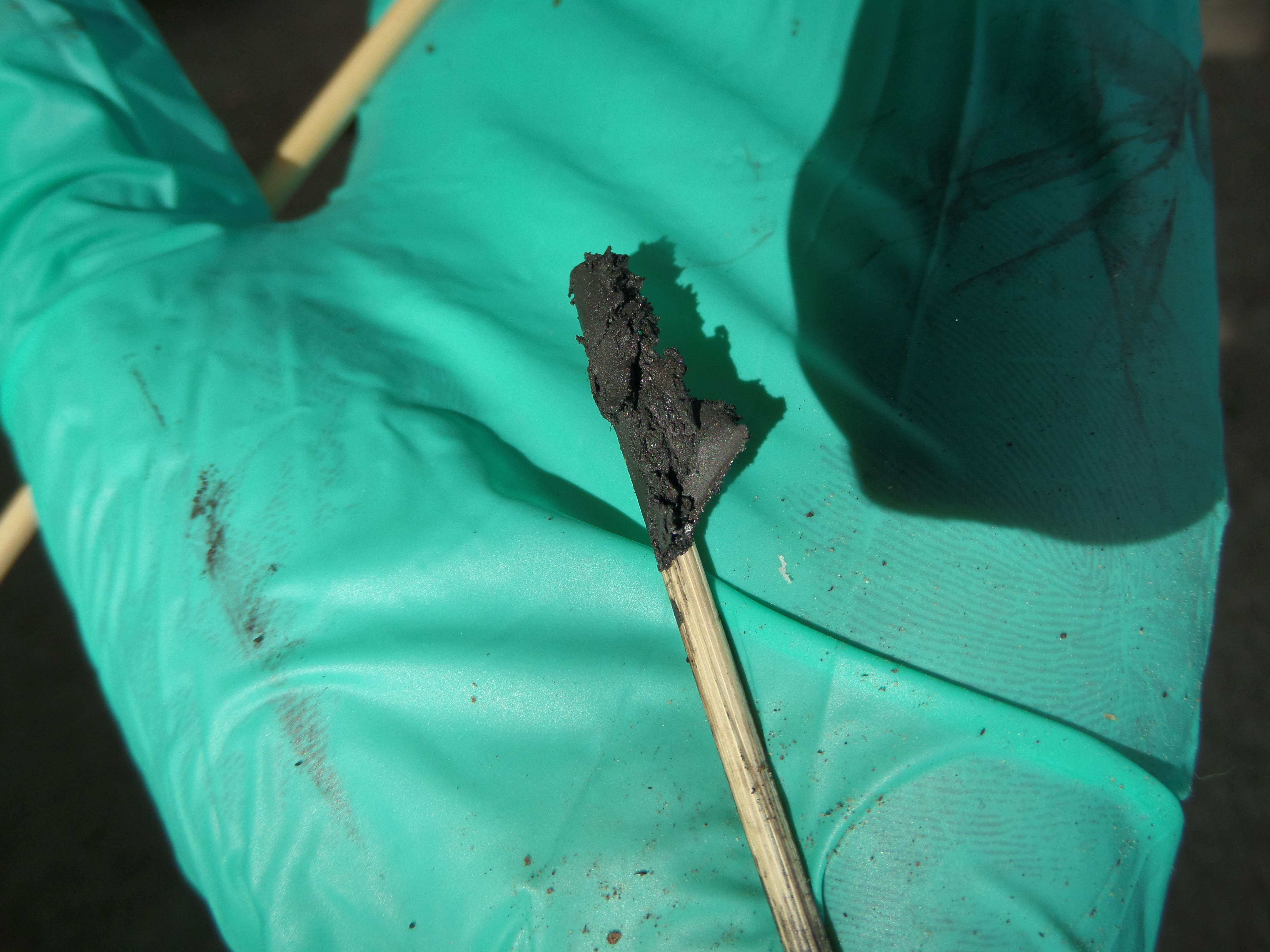

While I was very unprepared for this step of the process I'm glad I did it because when I was cleaning out the oil filter, I found a bunch of this sludge. Its almost like putty but it has metallic flake like stuff in it.

Metal is no bueno. Did you see any in the oil itself? Hillsy's gasket making advice is good, but if you're planning on keeping this bike for a while I'd just buy a whole gasket set. If those metal fragments are caused by something important you're likely going to have to tear down the top end before too long. Plus, once you get to riding it you may develop leaks here and there.
That's "normal" on any high mile Honda and usually the cam chain slapping up against the head or barrel somewhere. It could be much more serious of course, but don't panic - yet. Clean it and run the bike with fresh oil and change it regularly and see what comes out of the filter on the first few changes. Check the Oil pump screen too.
