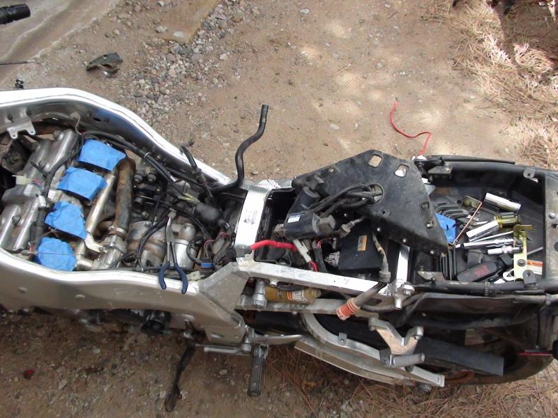

I hooked it up to the battery in my truck but it still didn't want to turn over well. So, I pulled the plugs and the engine turns over fine. Plugs back in, turns over like it should.
The stock 750 carbs are a bit crusty.
So it appears the PO did open these carbs at one point because....they lost one of the float needles. I went to the Yamaha dealer just to check and I can get one in a week for 28$, they only sell them as a needle/seat set. The seats on mine are in good shape. I'm going to see what other carbs I can cannibalize for a damn needle.

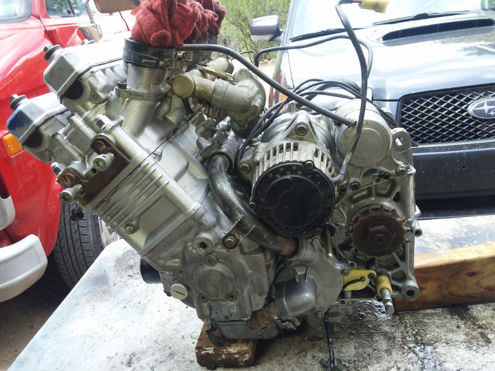

Today I got the 1000 motor cleaned up. It cleaned up well, no paint necessary. I also pulled the wheels to prep them for paint. I need to get a chain and sprocket set ordered soon.

I like questions. I got my hands on an earlier FZR for a few hours one day years ago while I was stationed in San Diego but I've never ridden a Yamaha like one of these Yzf's. So.
I'd like to know what the 750 motor feels like on the road so part of me just wants to get it running and swap it into my good chassis and ride it awhile. The winner though will probably be putting the 1000 Ace in first and roll the dice. Either way it would be nice to compare the two.
For the Ace motor: The motor mount mods need a little work. The mod plates for the conversion are a bit rough and could use a do-over if I ocd it. I'll likely source a few more engine mount bits and mount it in the good chassis. This while I deal with 750 parts bike and ordering stuff as I can.
