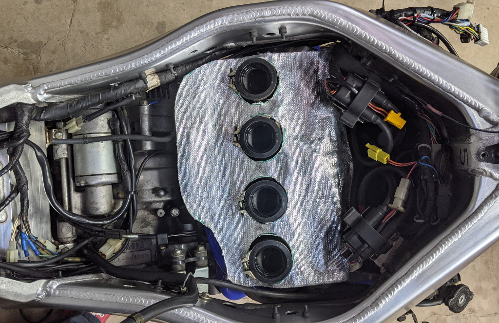

Got the heat shield for the carbs setup too. It was a 12x24" piece of 2000 degree adhesive backed material. I peeled the adhesive backing and stuck it to itself for a 2x thick layer between the carbs and the motor. I hope it helps.

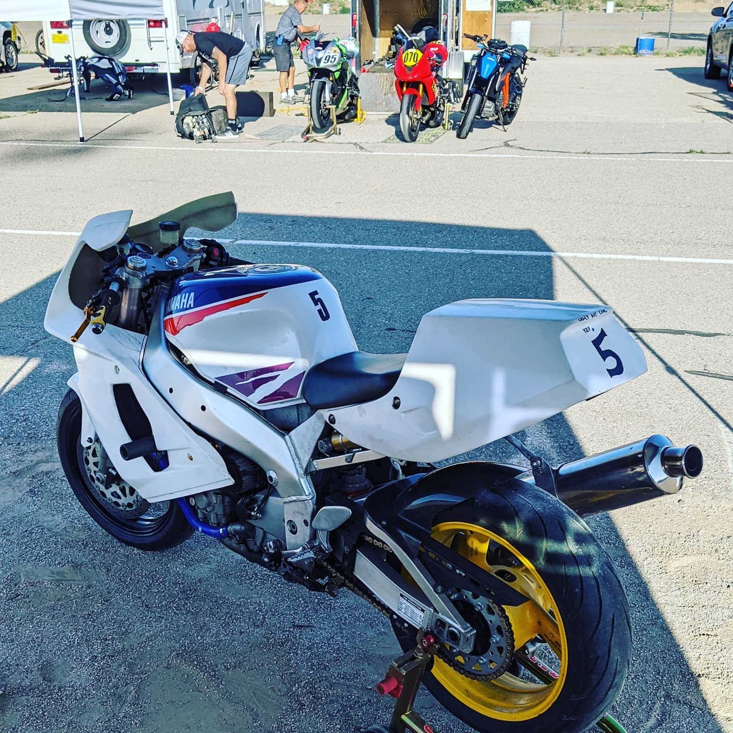

So... track days ROCK!

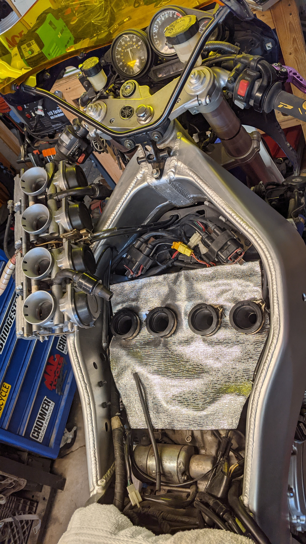

So the track bike (#5) is giving me some fueling issues again. It pissed fuel into the exhaust last week when I started to warm it up. That's going to take a sec to figure out. Meanwhile it was time to get the survivor (#3) cleaned up and off the lift again. #3 had coolant leaking from the main manifold. It looked like Florida in there. I pulled a good one off another parts bike and got it swapped in to #3, refilled with coolant and buttoned the fuel system back up again. Did a fresh oil filter and changed the oil. Coolant leak is resolved at least. Naked shakedown was a blast. It's blowing a little black smoke after it's warmed up and I goose at high rpms on the open road. I suspect the 27 yr old valve seals. From what I've read about these, it's a thing and makes me think when I pull the head to do the seals, maybe a 902?cc piston kit would be cool. For now, I'll just ride it some more and keep an eye on things while I do my homework on the issue.
