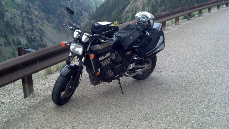

My 2000 ZR1100-C4, the ZRX. I bought it brand new back in 2001 after I moved out from a woman I couldn’t' live with and her two tiny dogs. I've ridden it stock for 15 years. It's my normal daily and sport touring ride. I take good care of it but it's time to tweak a few things. Photodump of progress so far follows:

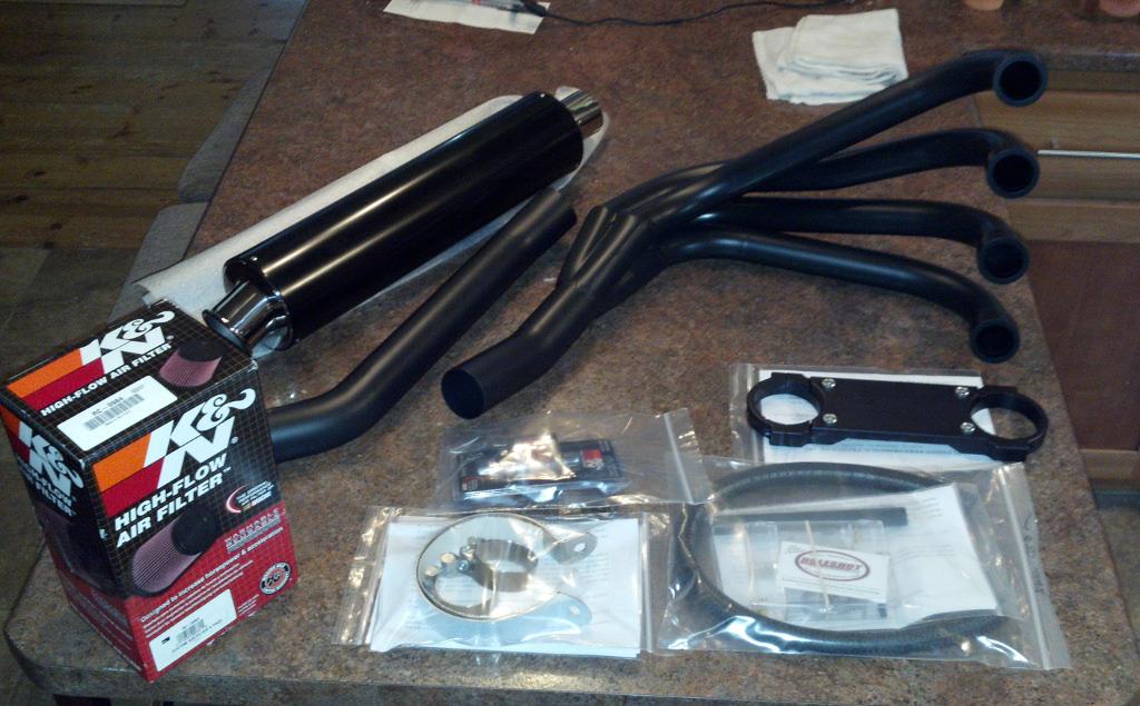

I got some goodies. New header and muffler, stage 2 jet kit, K&N filters, and a fork brace. All of it from Holeshot racing. Dale was cool to talk to and he's got a great rep over on ZRXOA. This pipe is soo much lighter than stock.

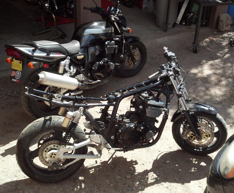

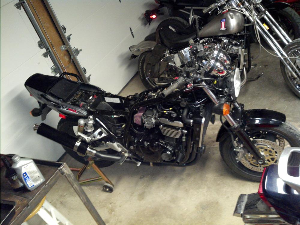

I love this bike enough that last year I scored a 99% complete same year/color spare bike that I'm slowly tearing down. Notice the giant exhaust can and heavy stock headers. I've already had to weld them up once after a wet road trip. Time to go.

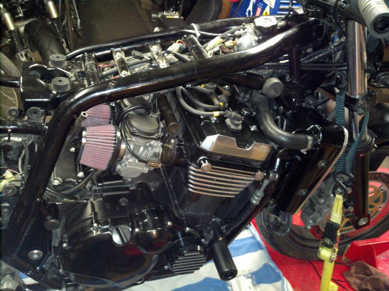

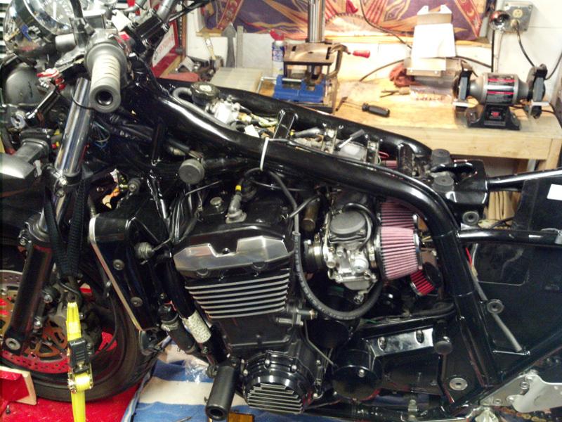

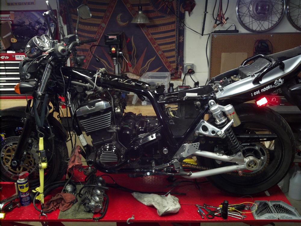

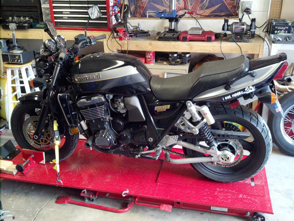

On the lift and digging in. Getting the airbox out was a pain as expected.

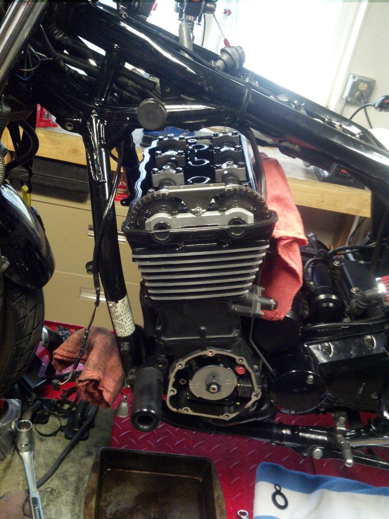

And since it's up there on the lift anyway, I'm doing the valve adjustments. I wasn't 100% sure on the shop I had do them the last time. From here on out, I'll do it so I picked up a 9.48mm shim kit from HotCams. About $80
Into the valve adjustments.

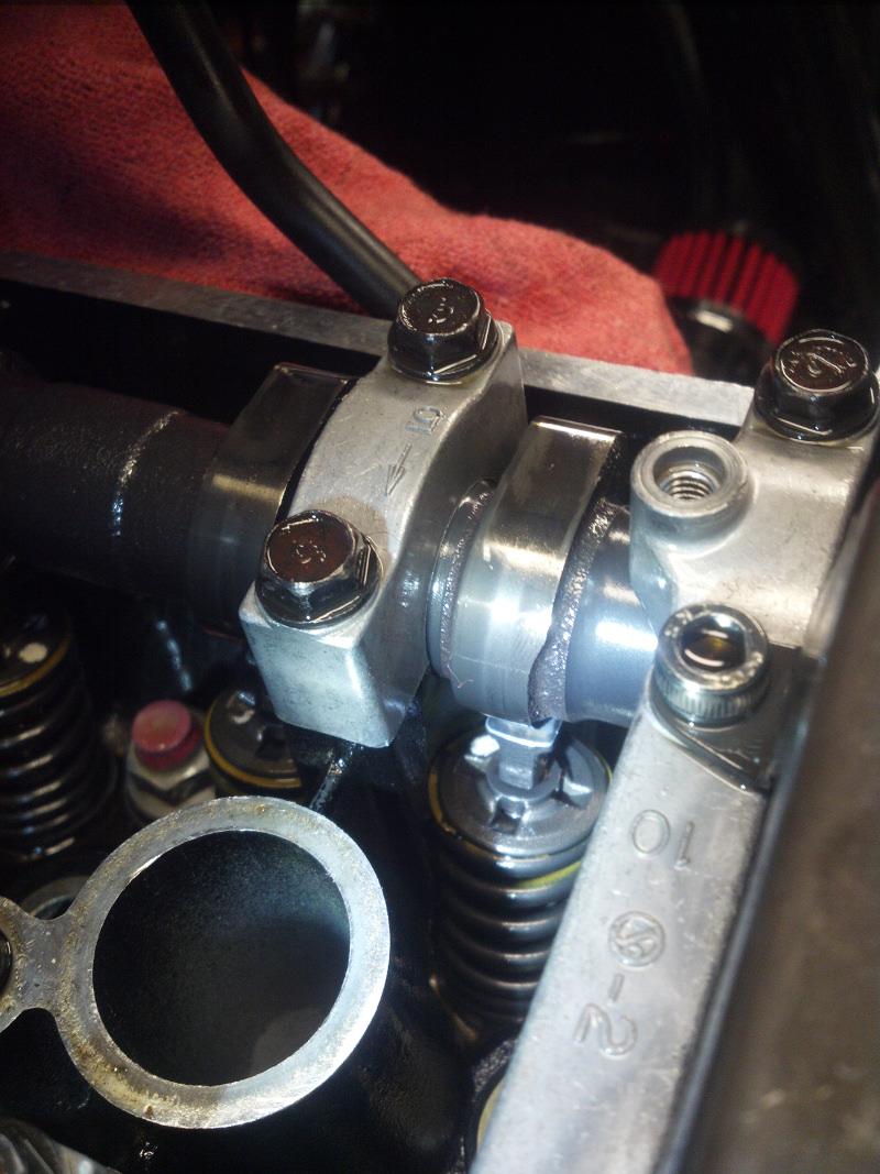

The rocker arms are spring loaded and slide laterally off the shim. No removing cams necessary. Nice.
I'm glad I decided to do this myself. I had a number of them that were tight but not too far out of whack. The shim kit was awesome. I ended being a single 2.70mm shim short, even after swapping them around. Bobby J's Yamaha had it for $5.
A bit of scotch makes the job go smoother.

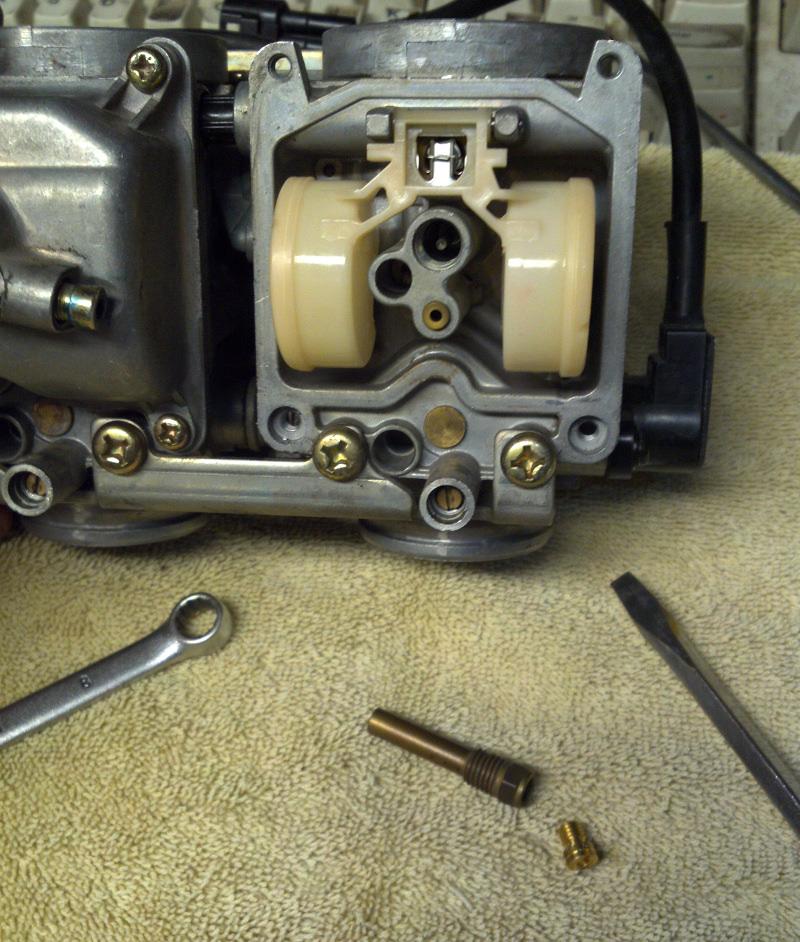

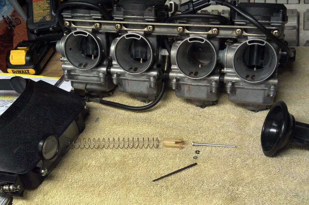

And then there's the carbs and the jet kit. Stock mains were 95, the stage two kit comes with 128,130, and 132's. I live and ride above 5000' feet MSL so I went with the 128's .

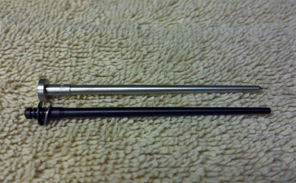

Next was the adjustable needles. 3rd notch down from the top, washer under clip.

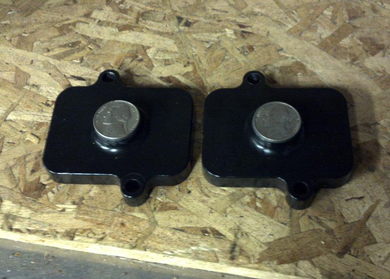

Since I got rid of the emissions junk, I had to come up with some kind of mod for blocking off the air induction plates on the valve cover:
