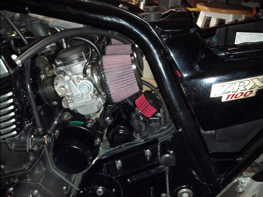

Here's a shot of the solution to the engine case vent. 1/2" K&N

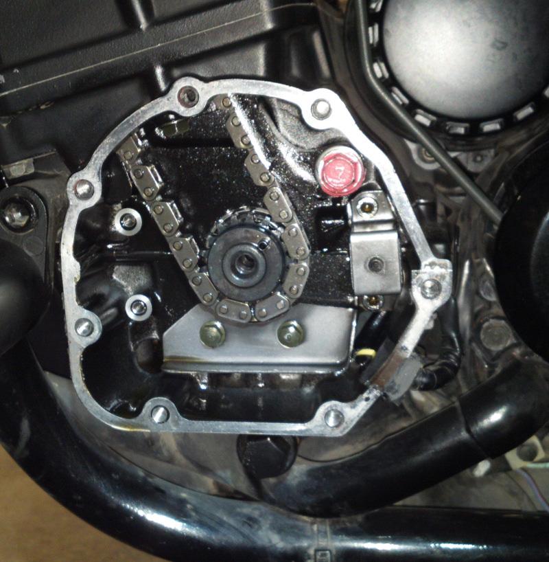

So back into the timing cover to swap the new advancer plate in.
