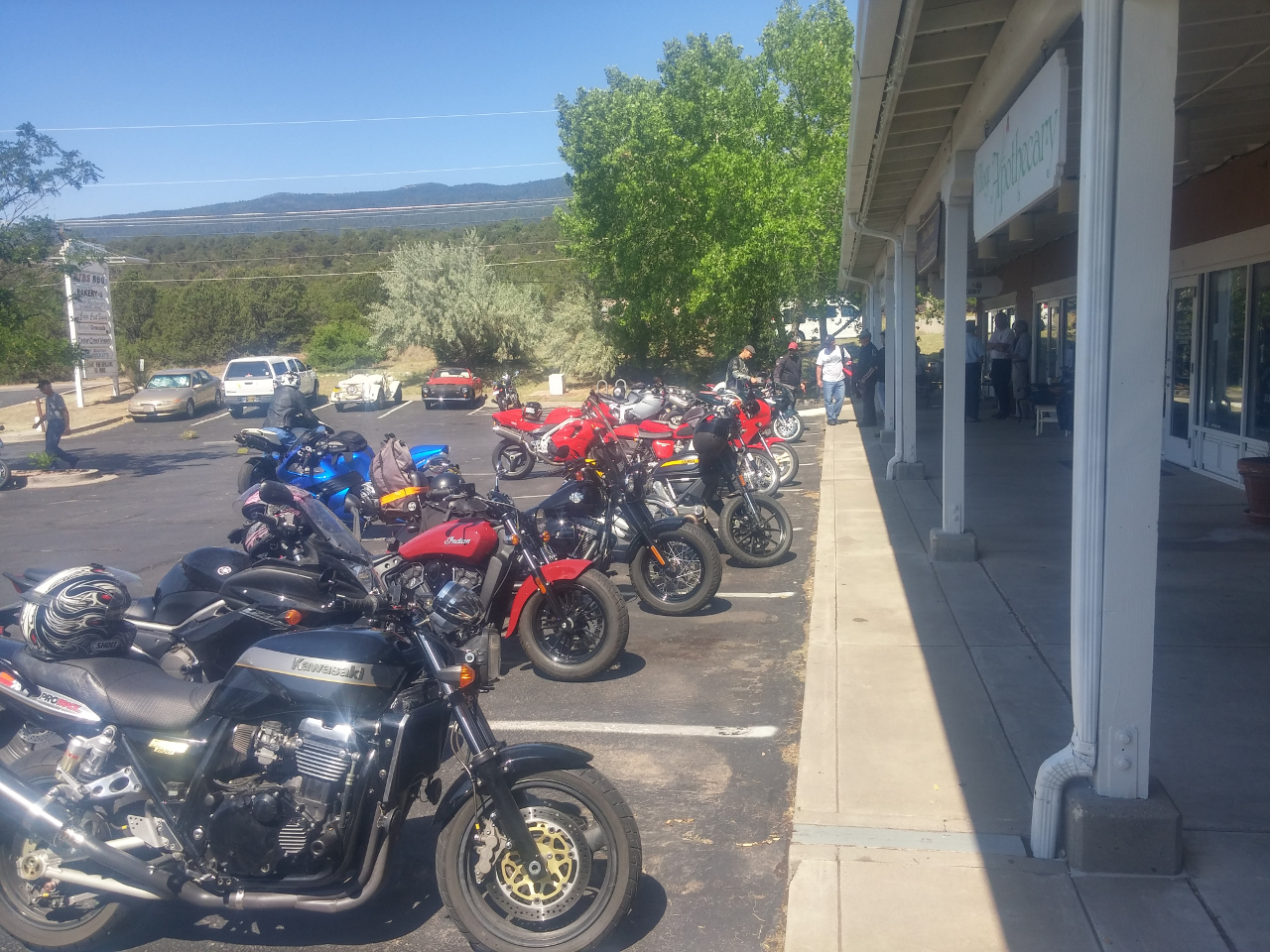

Update. Finally got the Racetech stuff done on the front forks. Gold valves, straight-rate springs....Very different, I can feel the road under the bike better now. I'm still doing some tuning there. Also, the original clutch was pretty much gone so I replaced all the plates and did new springs this past weekend. Got it all done Saturday so I could make it to bike church on Sunday.
