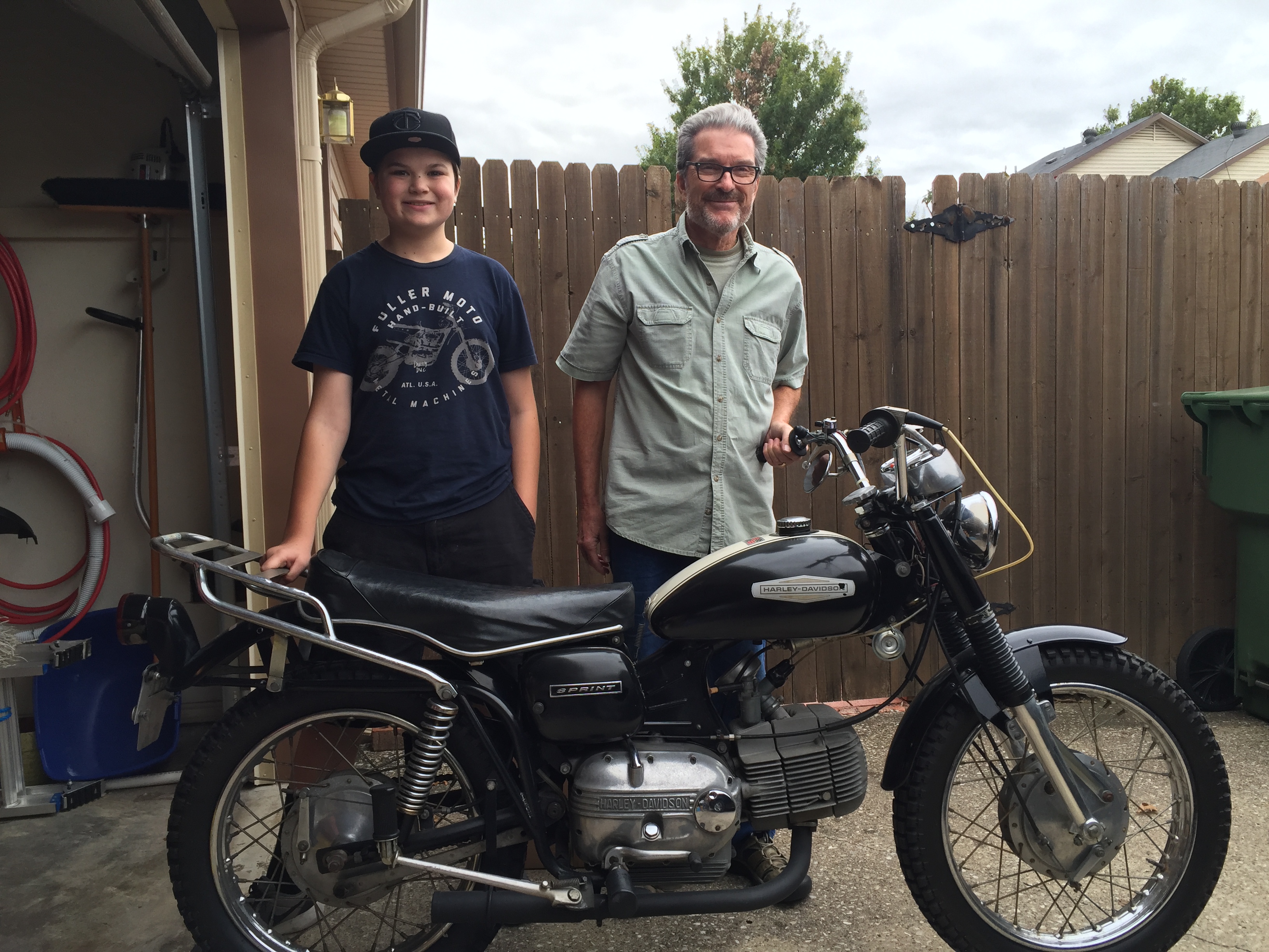

So our journey continues Japanese, Spanish, and now an Italian lady that likes to wear a Harley jacket.
Our paint supplier told us we needed to go see his dad so we did. John was looking for someone to pass on his beloved sprint to. He bought this Harley Sprint 250cc SS in 1967. She has been garage kept and covered since 1985.

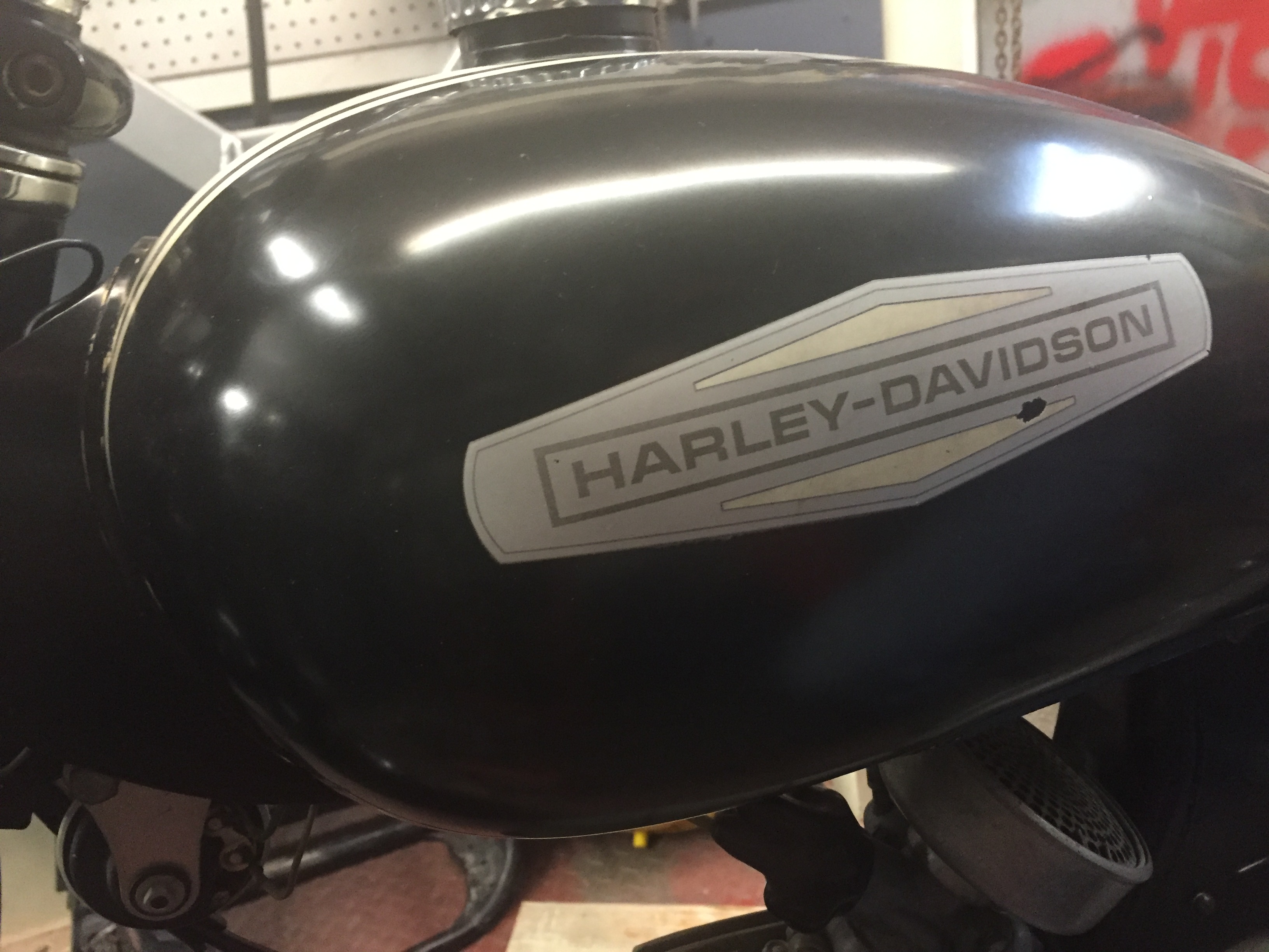

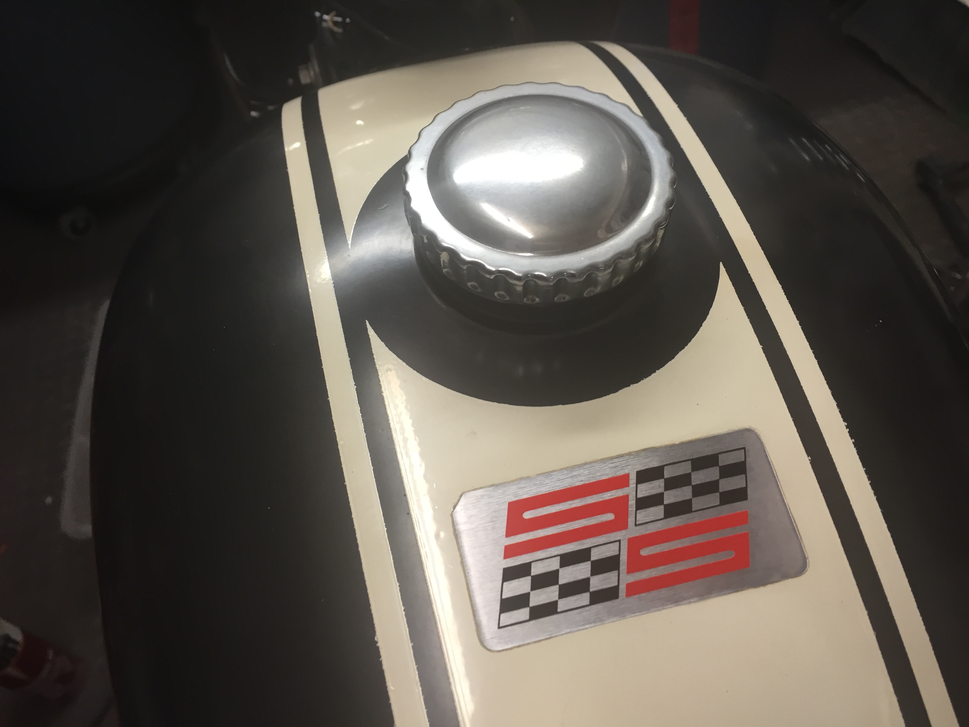

In 1967 Aermacchi came out with the short stroke SS and H model. John put over 25k miles on this little gal. Along with the bike came spares, cigar boxes, magazines, and manuals.
