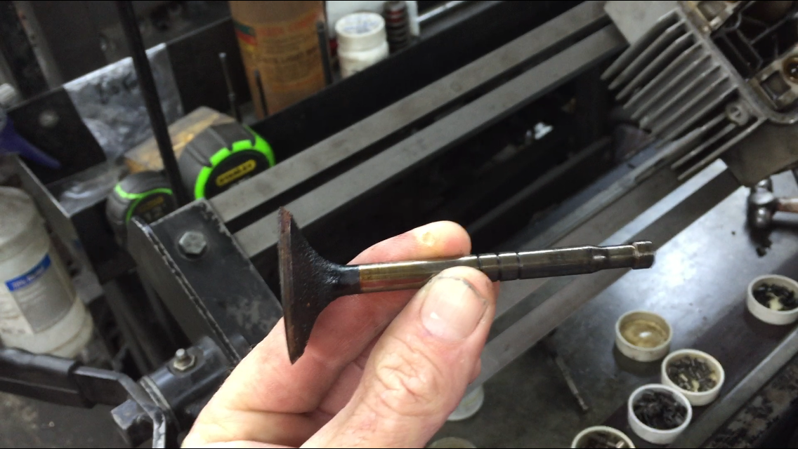

What do you think Jack about these valves? Check out the oil grooves on the stem!

I was not expecting the dished valve. There are several examples of dished vs flat valve explanations on the web. Here are a couple samples; reasons include lowering compression to improved intake performance.
Thread #16
http://honda-tech.com/honda-prelude-4/flat-vs-dish-valves-1901436/#post26498770
Thread #7
http://honda-tech.com/all-motor-naturally-aspirated-44/lets-talk-about-flat-faced-valves-dished-valves-2928785/#post45162070
Got me on this one.. I was expecting tuliped :)

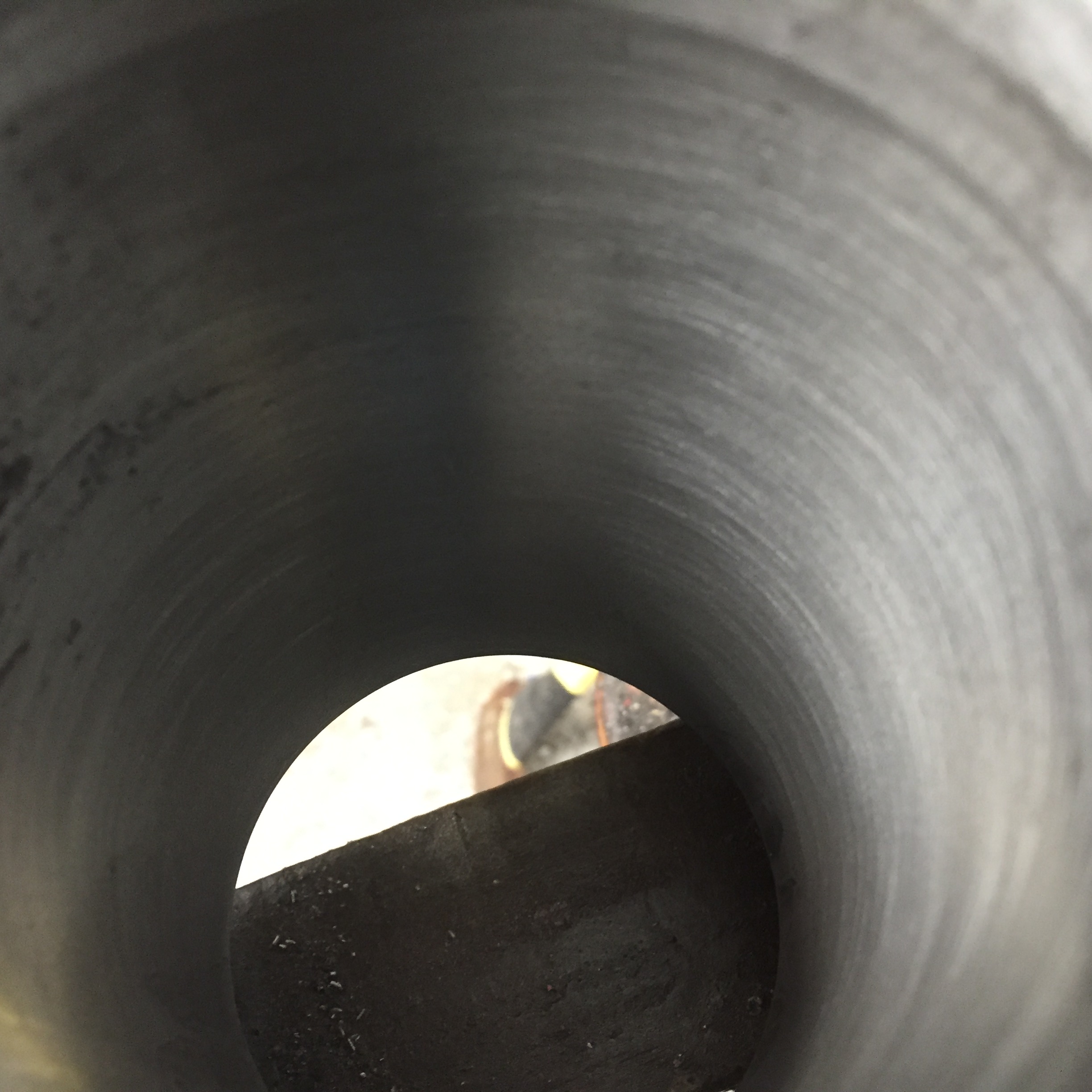

Ran into a an Italian hick up with the serdi cutting..the need a .296" pilot going to do some research. However everything is now bead blasted. Harley by name Italian by disposition.
