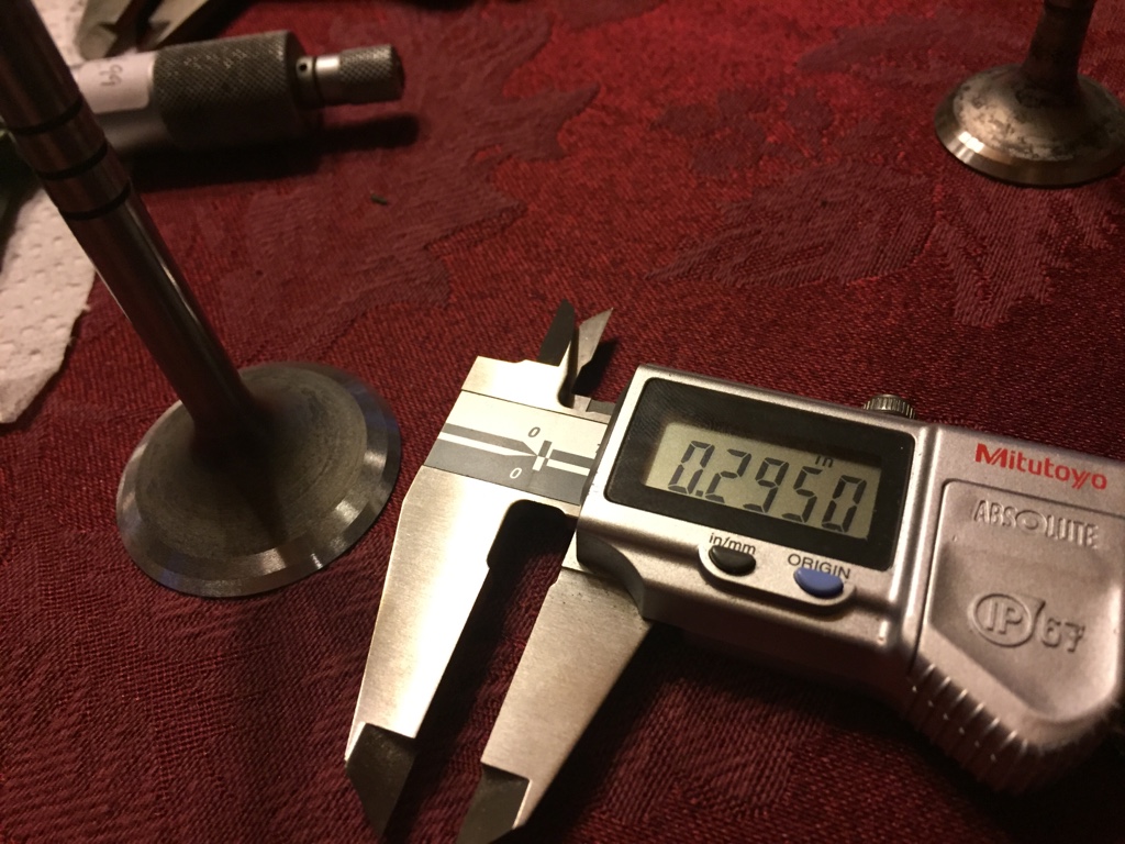

You mean the cutter size for the Serdi machine? Italian is a special size?
yes the pilot needed for the serdi is an off size. The valves are about 7.5 mm stem diameter.

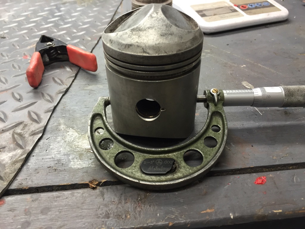

Glad we had a road block with the pilot guide. We got the clean head home disassembled and checked the valve to guide clearance using a dial indicator and we can see why he stopped riding it and picked up another head. The exhaust valve has .015" valve to guide clearance and the intake is .005" We will disassemble the other head and check the clearance later. Also the piston to wall clearance is out of spec at .0035"
We learned that the piston is measured at the piston's gauge point. The Pistons gauge point is set by the manufacturer. The measurement is used in calculating piston to wall clearence.
