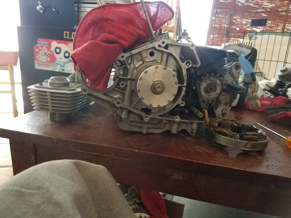

First one is after I finally got the jugs off and confirmed that the rings had slid off the piston and jammed between them and the cylinder. I drilled straight through the overhang on the cylinder wall and tapped the pin out because that was the only way I could think of. I feel bad about it, but it worked.
Next one is taking off the oil cup, had to drill the head off and wiggle the cap out, but it's free.
The third picture is just the other side of the motor with the timing marks. I got the bolt in the end off shortly after, so I'm gonna pick up the bolt to thread in there and pop it off.
The last one is the clutch side. Is there a bolt in here somewhere that is still holding the case together? I took off everything on the bottom and every single thing I could find that'll keep them together but I just can't seem to split the cases. The left side is split, but the clutch side won't come apart.

Couple of suggestions.
Alternator rotor: Remove the center bolts and screw in the rear axle until it bottoms against the crank and then tighten it some more. Then strike teh end of the axle sharply and the rotor should pop off. Also remove the sprocket and circlip .
Clutch side: remove the nut inside the oil slinger, then remove the slinger and the first gear behind it. Then undo the two oil pump nuts (they have tab washers) and slide the clutch and oil pump off together.
Then remove the shift shaft and carefully lift it off the shift drum.
Smack the clutch shaft lightly straight down and straight up with a rubber mallet (do not use a metal hammer) and the two case halves should crack open.
Later 175/200 motors have an extra hidden bolt hiding inside the sump plate but early sloper motors do not.

On the other side of the engine, the oil slinger thing is really on there so I'm gonna need a really big breaker bar or something since I don't have any air tools here. The case is split everywhere but behind the oil slinger and clutch basket so maybe there's something back there holding me up.
I'm frustrated haha, I know that if I could split the case and clean it I'd have it back together in a couple hours so this thing is driving me nuts.
Sent from my SM-G935P using DO THE TON mobile app
Did you pry back the tab of that lock washer in the slots in the castle nut? After that, take the tool plus a short extension plus a short bar and smack it with a rubber mallet. One quick blow should get it free.
Then thread an 8mm (IIRC) bolt into the center of the slinger to pry it off the crank.
Then remove one primary drive gear
Then remove the clutch basket plus oil pump (two nuts plus tab washer)
Then the two halves should split. Sometimes you have to strike the crank upwards with a rubber mallet but take care and do not use a metal hammer.

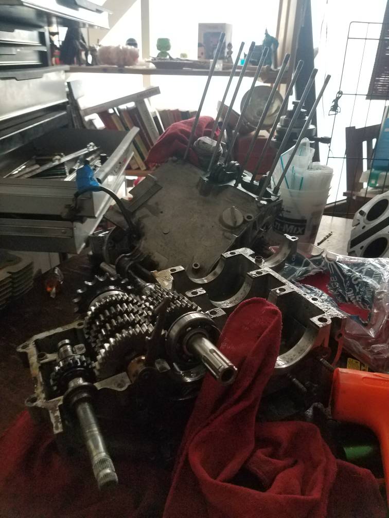

Alright, after half a can of PB Blaster, a heat gun, a potentially broken knuckle, and the sacrifice of a small socket extension, the piston is finally off! I've cleaned up the inside of the cases and cleaned everything inside them, so once I've gone to the hardware store and replaced everything with Grade 8 stuff or hex bolts, I'll be ready to put it all back together.
Couple questions though.. In the pictures I've pointed out holes for what I'm assuming are retaining pins, and I don't have them. I'd like to think that they were never there, but it's more likely that I lost them somewhere. Does anyone know what they're called, or where I can get them, or at least an acceptable substitute for them? I feel like I could cut some metal rods and throw them in there but they're probably cheap enough to just buy.
In the last picture are the gear fork things, again I don't have a name for them, but what position do they need to be in when I put all the gears back in?

Most of us call them dowels and HONDA calls then knock pins or something like that. Last time I needed some I got them from my local Honda dealer. Not all of those holes have pins. On the main bearings one each are pins and the others are for oil IIRC.
The gear selector forks go into slots in teh various gears. Two on one gear shaft and one on the other. Jiggle teh shafts and gears into place and get it into neutral and you should be good to go.
Before you assemble it, clean the two mating faces and wipe them clean with acetone and then apply a THIN smear of Threebond to one face. Honda twins of that era are assembled upside down. Large blocks of wood are useful to prop up the back of the cases and don't forget to fit the cam chain and do not fit the sump plate until the cam chain is fully fitted.

Do these look right? I separated the gears accidentally and I just can't understand the service manual's instructions on how they go. One of the gear selectors is on one set, two on the other. I have no idea how to get neutral from here but I'm hoping to put the case back together today.

That looks fine.
Slip the gear shift lever on and cycle through the gears while turning one of the shafts by hand. It will soon be obvious if they are correct. if teh dogs hit each other, keep rotating the shaft until they slip into engagement.
