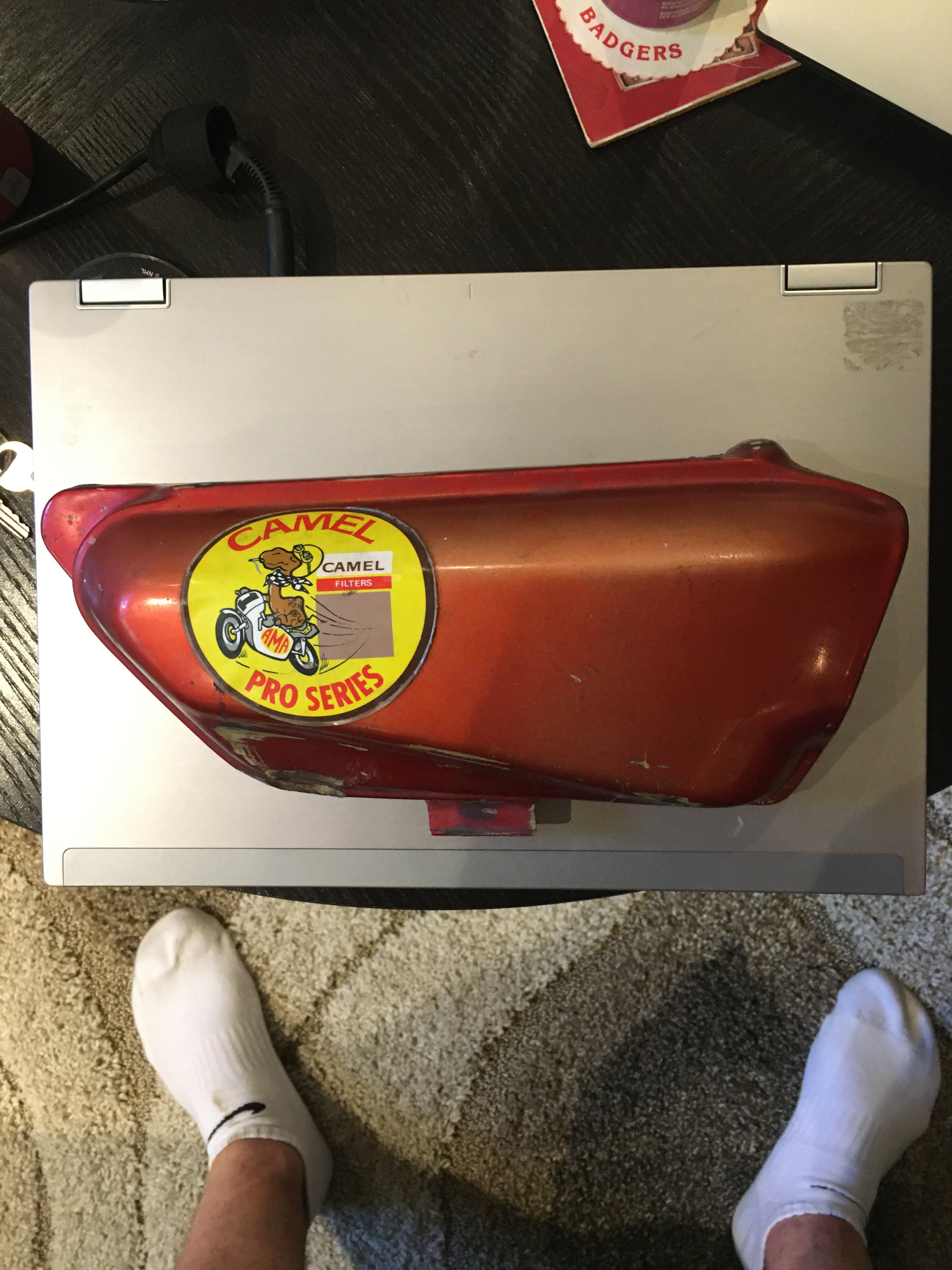

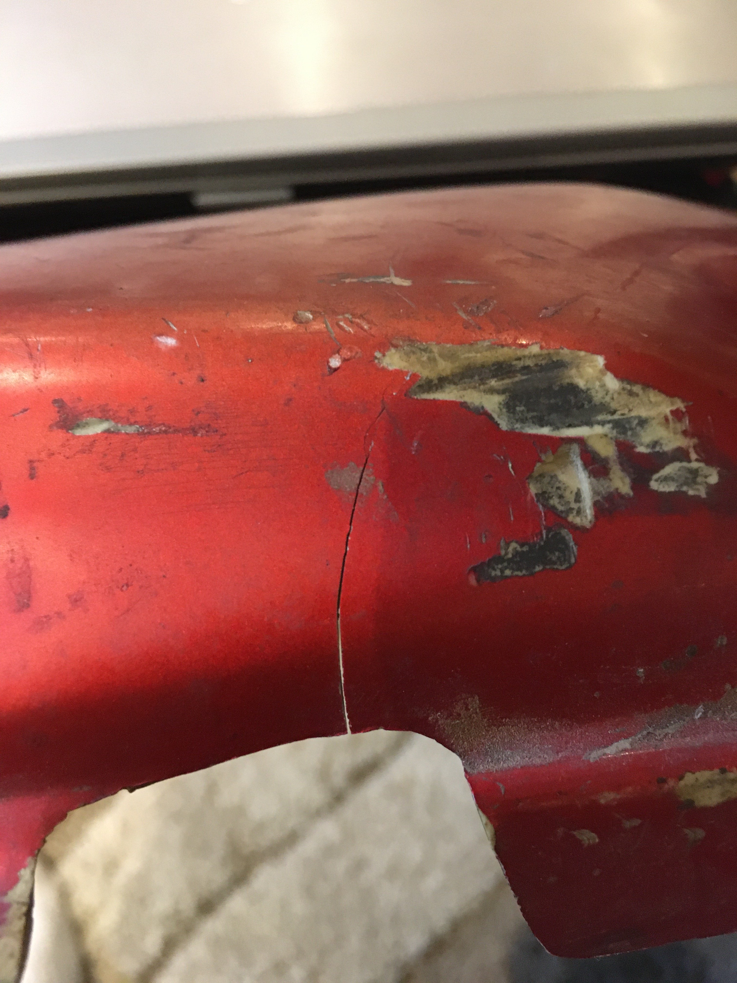

Last night I went to see the friend who sold me the bike because he has a friend who just bought his first motorcycle and wanted me to look at the malfunctioning speedo. While I was there he told me that he had found something he thought went with the bike and it turned out to be the right side cover.
I am super stoked that I have a side cover now! It’s only the right side and it’s got a small crack, but since I need to repair the headlight bucket again I’ll just do this at the same time. Other than that it’s almost perfect. Some scratches and stuff but these things go for like $300 for nos! Each!!! And I kinda dig the AMA Camel race series sticker. I definitely don’t want to take it off either because I’m sure all the adhesive from 20 years ago will stay on the paint. Plus now I have something to take measurements off of to potentially make sheet metal ones. So today I sat down for a few hours in fusion360 and came up with this:

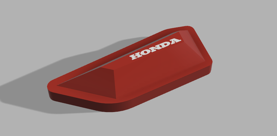

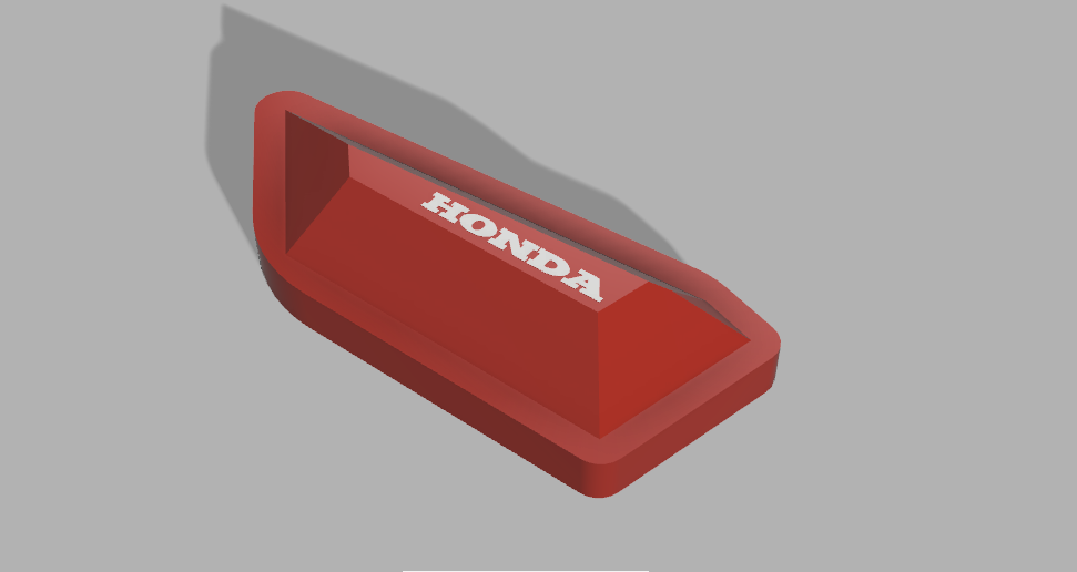

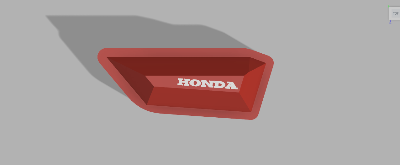

I haven’t modeled in the clips yet but I figured it’ll be easier just to make them on the fly if I build these. As you can see I went with a pretty sharp edged design, which doesn’t really match the style of the bike, but I had to design it to where I could build them out of sheet metal with just basic tools and a welder, which I think is doable. They will require a lot of cleanup, but definitely doable.
So I put the cad drawing onto foam board first to see if it would work before I did sheet metal. It looked good so I moved forward with sheet metal. Yesterday it got it all cut out of 22 gauge sheet steel and welded it up. I think when I do the left side I’ll use 18 or 20 gauge. I didn’t realize how hard it was gonna be to weld 22 without blowing holes in it, even with tig. But in the end I was able to get it all together. I backed it with All Metal to give it some extra strength, plus All Metal is waterproof unlike bondo so if in the unlikely scenario that water gets through the paint it’ll only ruin the bondo that I used on the faces of the cover, and not the seams too.

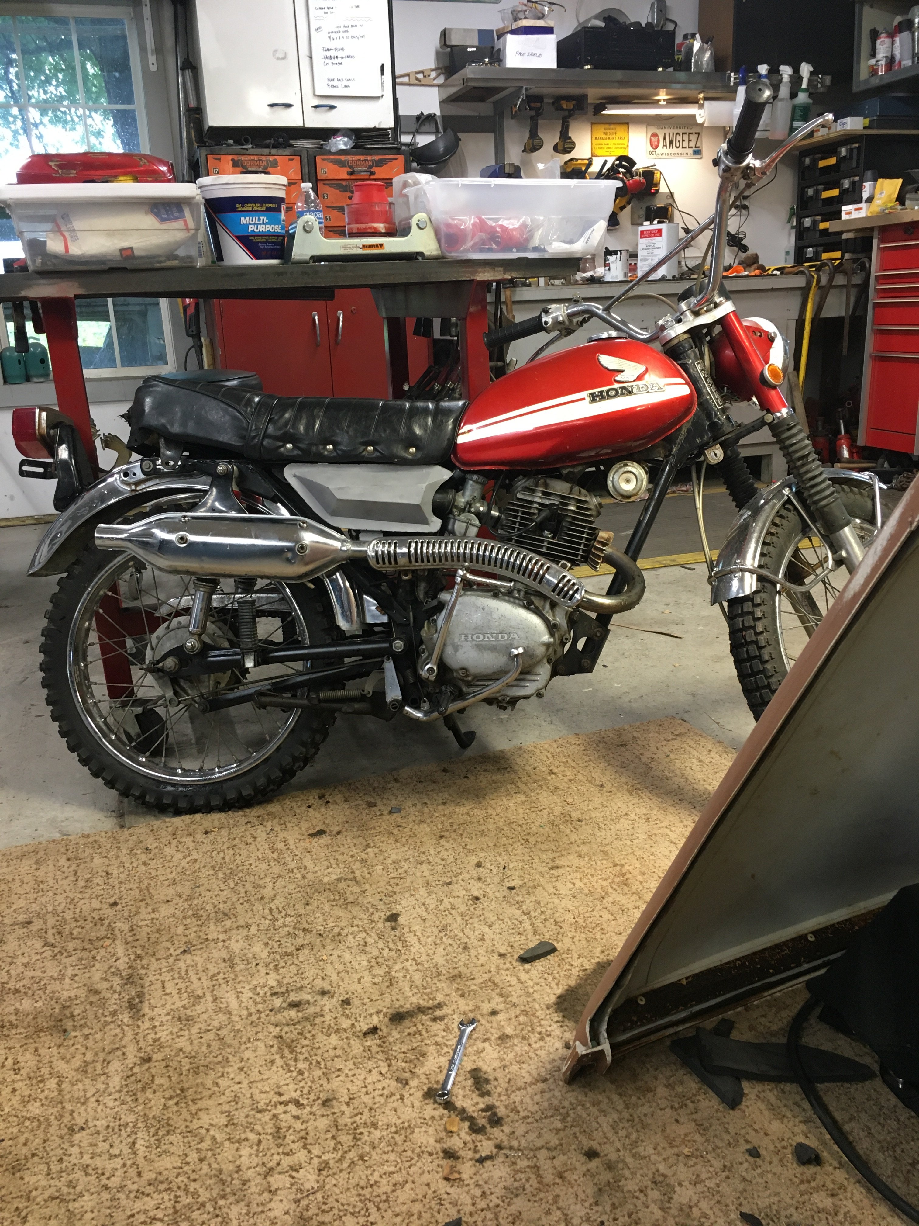

so here it is all welded up and soda blasted in the blast cabinet. As you can see i added the tab on the bottom to utilize the stock lower “mount” on the back of the tool kit.
And here it is on the bike. I like how it looks personally. I think that the sharp lines are kinda cool, despite the fact that they don’t necessarily fit the style of the bike.

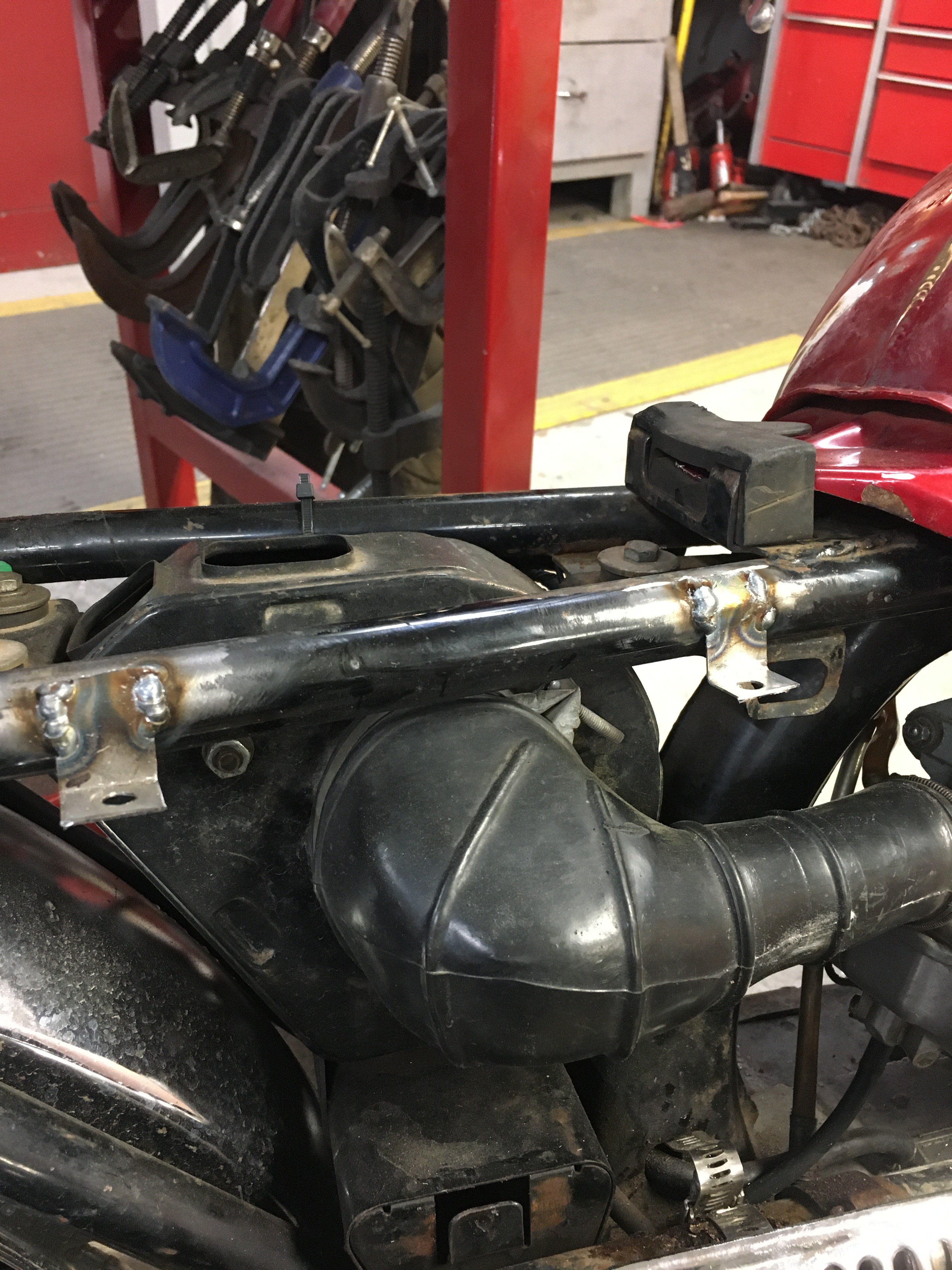

I ended up just welding tabs on the frame and and nuts inside the cover. I thought about making clips like the originals but these are a lot easier and will be super easy to remove if I ever decide to. I didn’t really take any pics of the bondo work or primer or anything but that’s what I’m on now. I’m not very good at body work though so fingers crossed it turns out ok

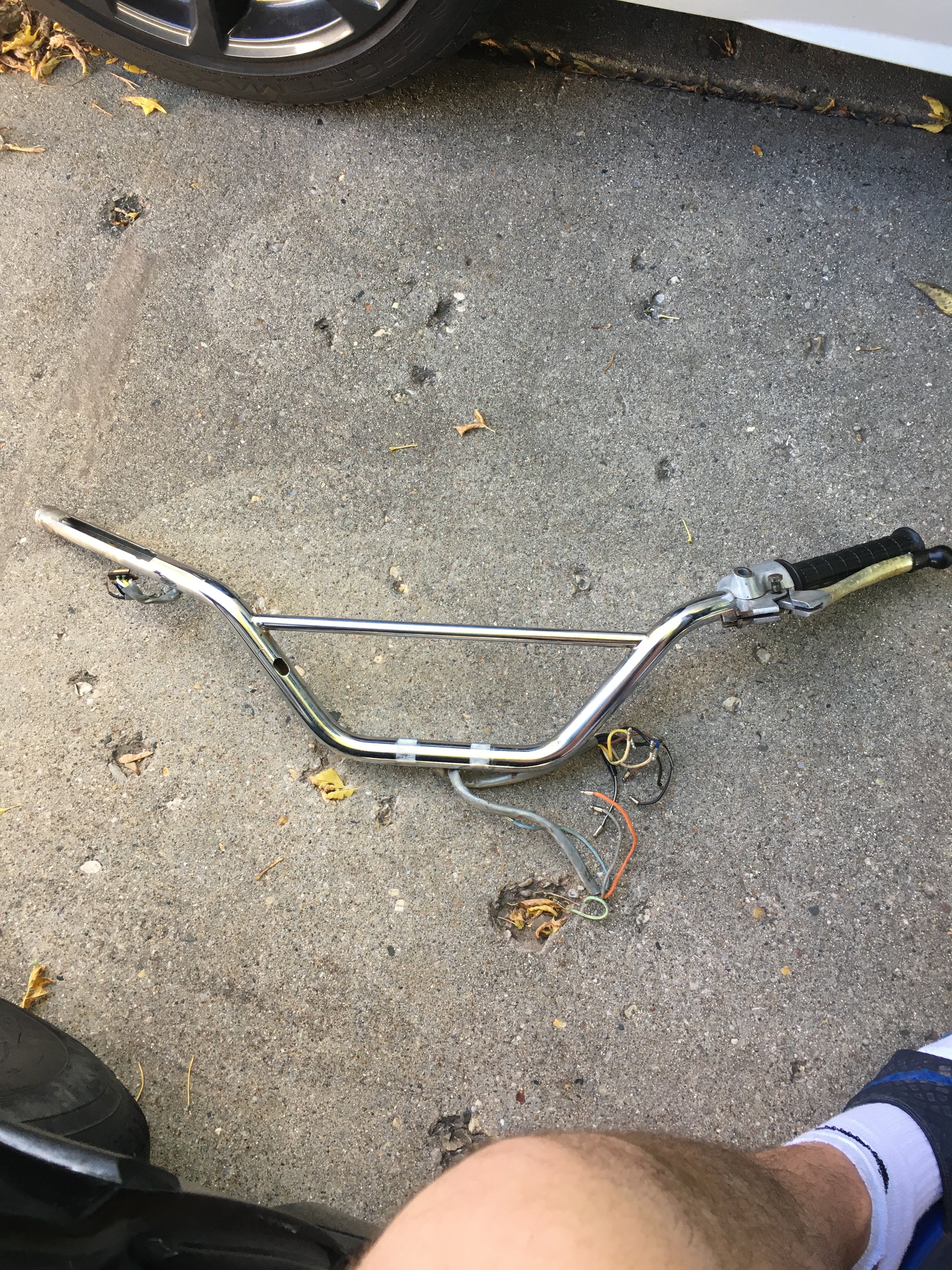

So last month I moved to Milwaukee, Wi from Madison, Wi to play a season of junior hockey. I currently live with what is called a “billet family” which is a family that volunteers to give players a room in their home for the season. When I moved here, I obviously had to leave the bike at home and haven’t had a chance to work on it or see it since I left. But just the other day a opportunity that I just couldn’t pass up fell in my lap. Just 5 miles from my billet house, there was a guy selling sl100 and cb125 parts! I mean what are the odds of that. And since most things are interchangeable with my bike, I jumped on it. I ended up with two headlight buckets, one in perfect shape,
a set of handlebars,

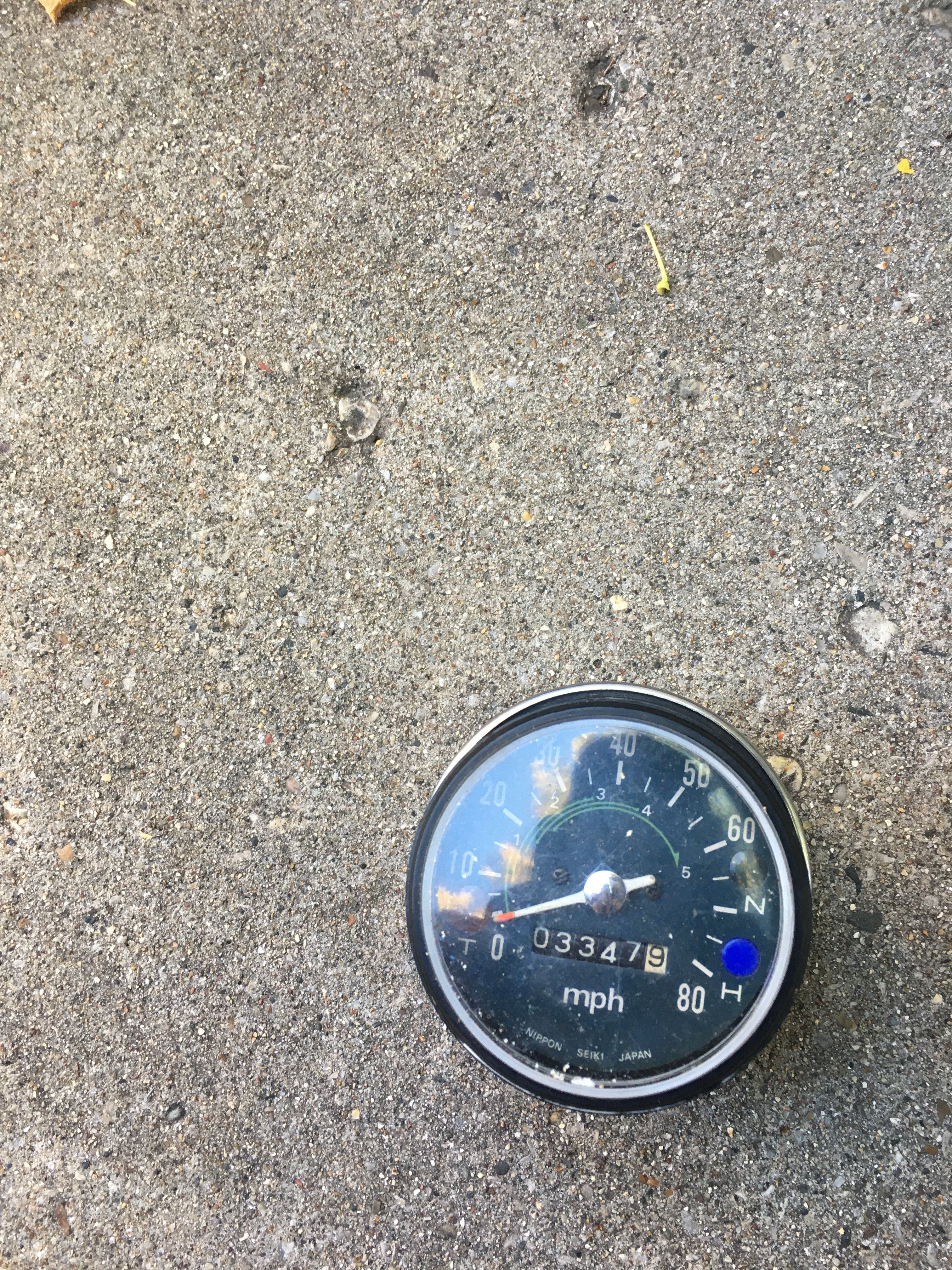

A 125 speedo,

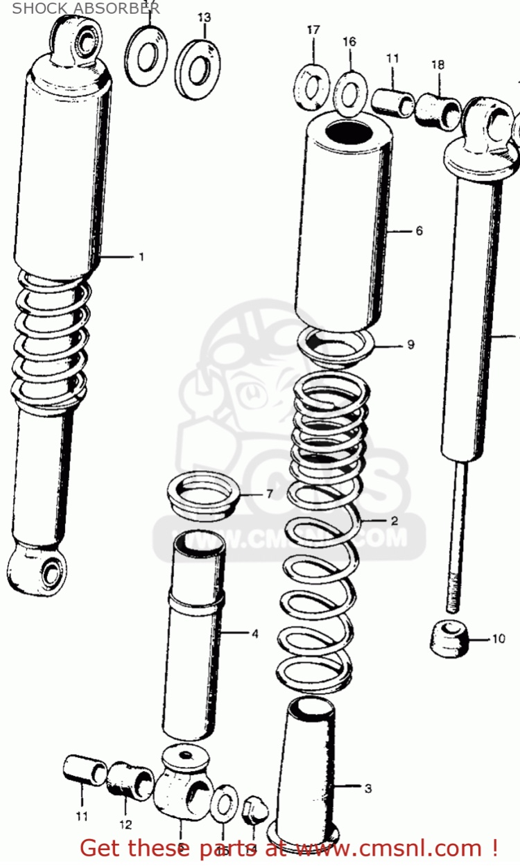

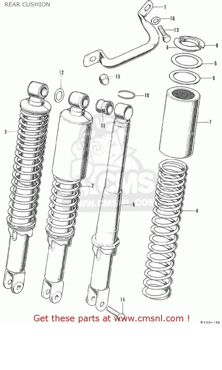

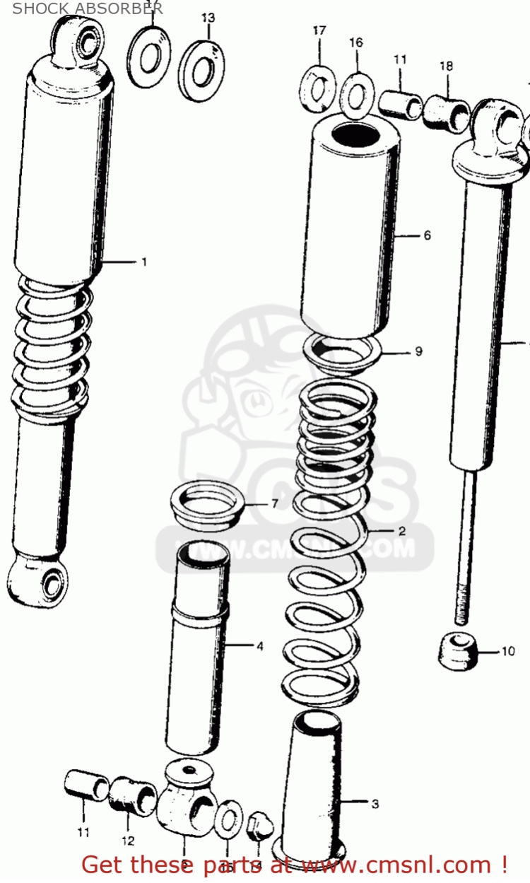

Thanks guys, I didn’t take any pictures of the shock modifications but I’ll pull one off of the bike when I have time and try to get some pics. I’m the meantime I found some diagrams so I’ll attempt to explain that way.
So this diagram is of the cl100 shocks, and all your gonna need off of those are the bottom eye, part #1 in the picture, and the little metal insert that goes in the rubber bushing on top, which would be part #11. The metal insert should just pop out with some force, I’m sure you gentlemen can figure that out yourselves. The bottom eye just screws off. It should have some flats on it that you can grab with a wrench, but you’ll have to hold the shock body, part #4 (I don’t really know what this part is called but from here on out if when I say shock body, I am referring to this part) with something. I found that a vise grips with a rag or a cushion of some sort around the body to avoid ruining the shock body works well. After you get these two things off you should be done with the cl100 shocks. The cb175 shocks are where things get tricky. They come standard with the bracket style bottom mount that needs to come off to put the cl100 mount on. The best way I found to do it is as follows: first you should remove the spring from the shock. If you have a spring compressor this would be best, but otherwise you can compress the shock by hand. Once compressed, remove the retention clips, parts #8 in the diagram below, and this should now allow the spring to come off.
This step isn’t strictly necessary but it makes things easier later. Next, as you are looking at the shock from the bottom, there is a nut on the mounting bracket, take this off. An impact works best as it means you don’t have to hold the shock body (the equivilent of part #4 in the cl100 diagram) with anything, but the vise grips with a rag works here too if you need to use a socket with a ratchet instead of the impact. Now, unfortunately, the bottom mount doesn’t just fall off, because it is actually welded to the shock body. What you should do is cut a slot on the threaded rod that comes out of the bottom of the shock to fit a flathead screwdriver. Make the slot pretty big as you will need to put some decent torque on it. Once you have the slot you can turn the rod clockwise while holding the shock body from rotating. This will unthread the shock shaft from the bottom mounting bracket as well as the shock body. You should now have the shock body and bottom mounting bracket separate from everything else. Now that you don’t have the threaded rod to worry about you can just cut the bottom bracket off, I found that a sawzall with a metal blade worked well for this but I’m sure an angle grinder would work well to, just be sure you dont remove too much material from the shock body. Once you’ve done this you can thread the shock body back onto the shock shaft using the groove you cut into the shock shaft earlier to tighten it down, and put the spring and spring retainers back on. Now you can get the cl100 bottom shock mounts out and get those ready. All you need here is a 9mm x 1.25 tap and the appropriate drill for that tap. I got the drill bit and tap for like $9 at my local hardware store. Drill the old threads out of the cl100 shock mount and re-tap it with the 9mm x 1.25 tap. You can now thread this onto the threaded shaft of the cb175 shocks, if I recall correctly I had about 6 or 7 threads of engagement, witch for a thread this size should be more than enough. At this point you should be done with the bottom mount, which is the hard part. Now you just need to press the metal sleeve from the cl100 top mount into the top bushing of the cb175 shocks. It isn’t a perfect fit, but I found that a little heat on the rubber bushing helped a lot. You should now be able to mount your cb175 shocks on your cl100!
I hope this was helpful, but I imagine it was a little hard to follow unless you have the shocks sitting in front of you while you read it, but I’ll try to take some pics when I have the time and that should help clear things up. Feel free to ask for help if you need
