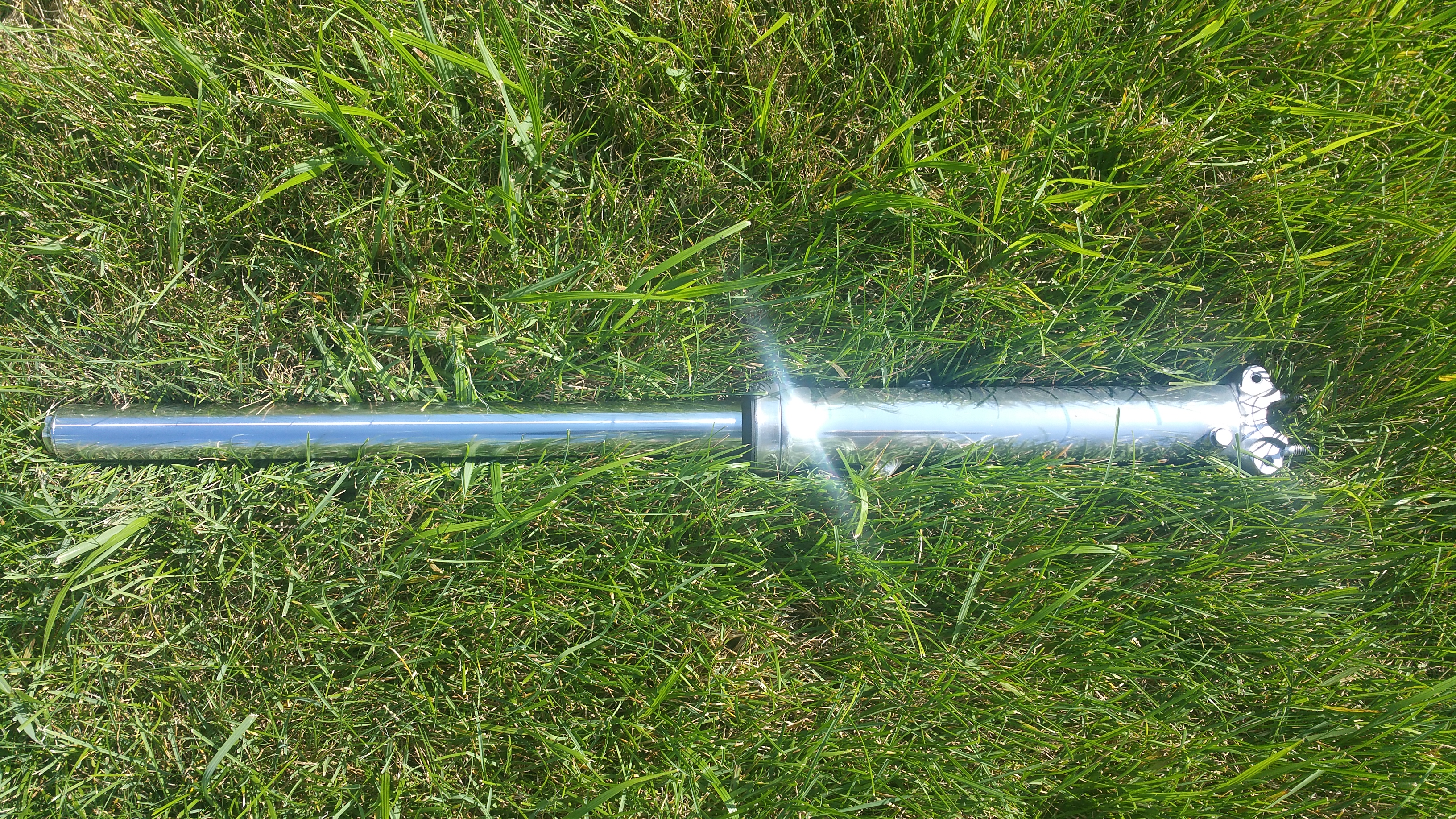

Should also mention, that was the least time and best result I have ever gotten on a lower leg. I used an ultra fine wire wheel from brownells at 3000rpm, then some good compound and a wheel also at 3000rpm. Total time, 45mins.

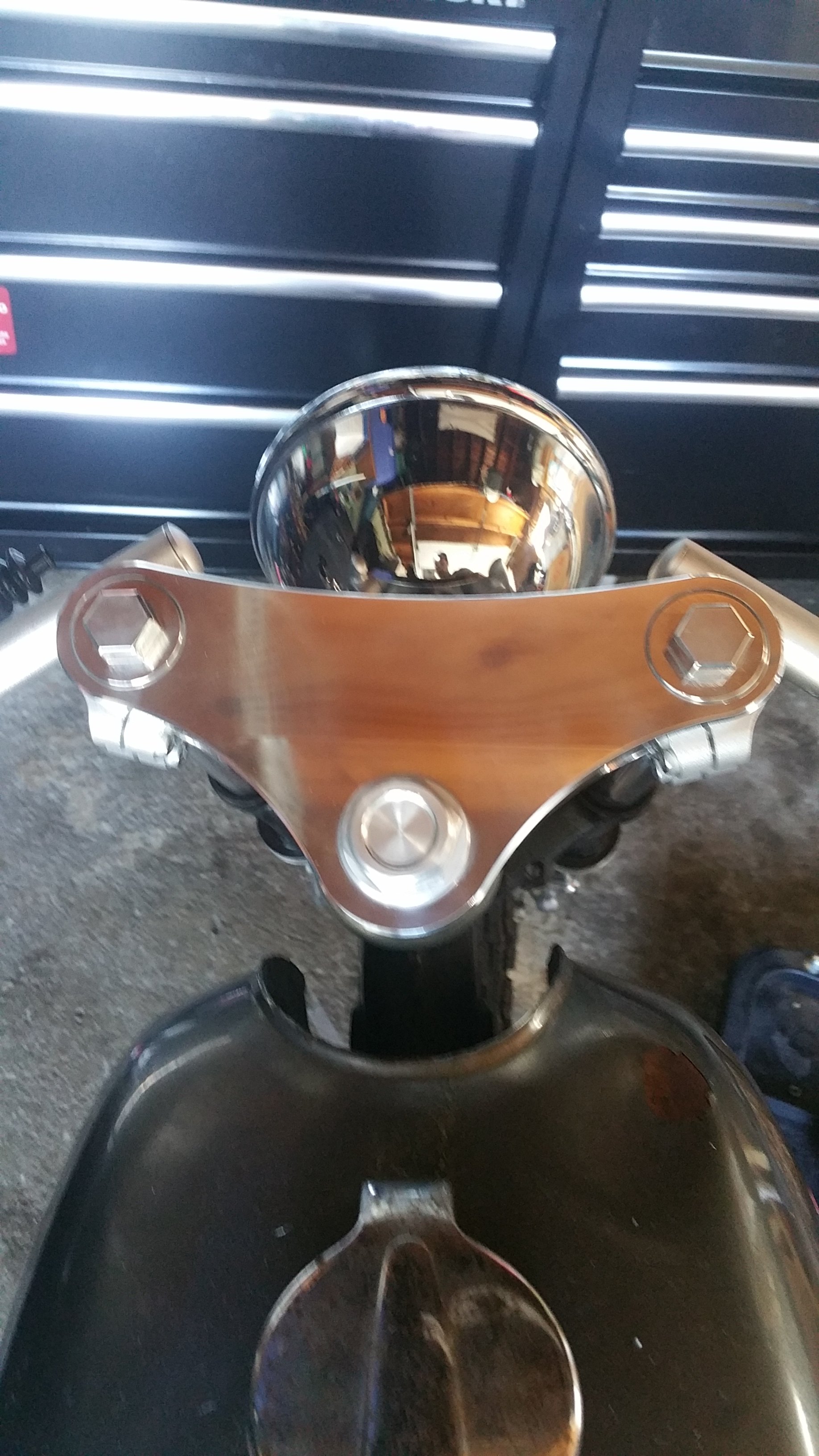

So both legs are done, will do a final inspection in the sun tomorrow and give them a once over. The plan is my top triple should be here tomorrow, I will assemble the front end with bars and controls to get a feel for what it'll look like. Before that happens I will have to cut the lock off the bottom of the triple, clean it up a little, then fab up a bracket so I can use a bottom mount headlight. I really like the way Kott does it, thinking to steal his design.
Well got the front end refinished- little tweaking to do but back in a roller. Definitely like how it shaped up up, especially Cognito's top triple!

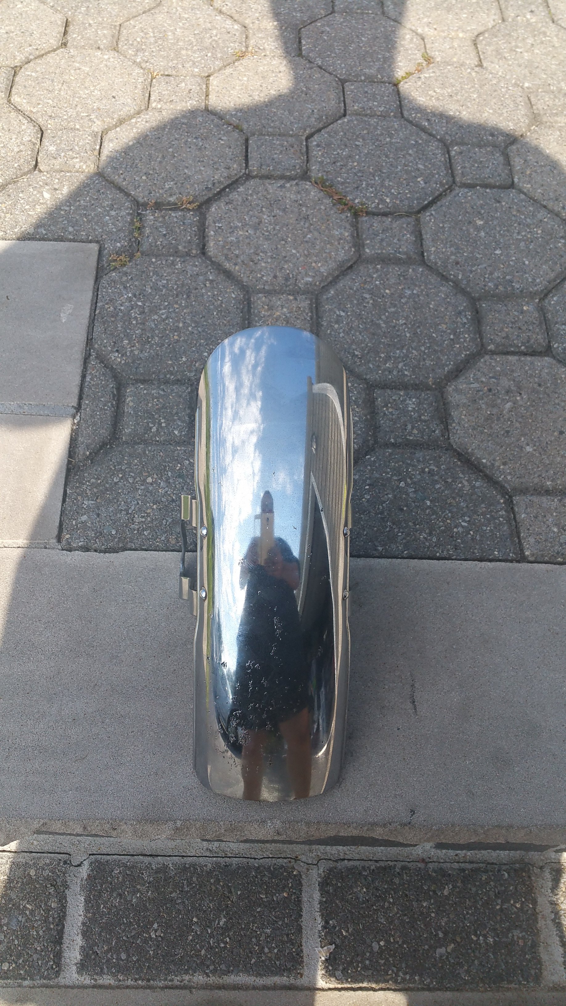

So about halfway done with the front fender, or may be more accurate to call it a brace. No sure of the shape just yet, but a grinder is a beautiful thing. And yes i will be shaping the other side.

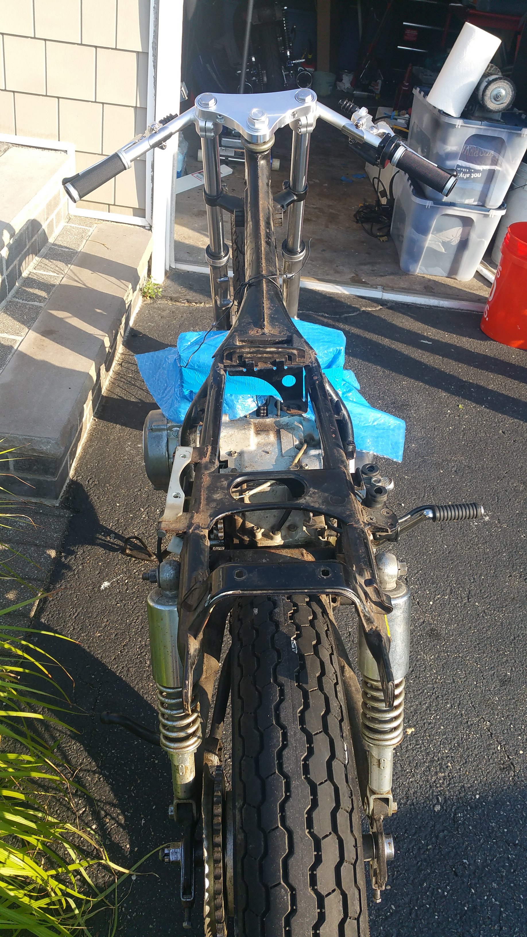

So i just thought about the bar length. Threw the tank on to check it out. Measures 28 inches end to end, and im going to add a bar end mirror yet. Im thinking cut an inch off each side and if its still too wide ill take off one more

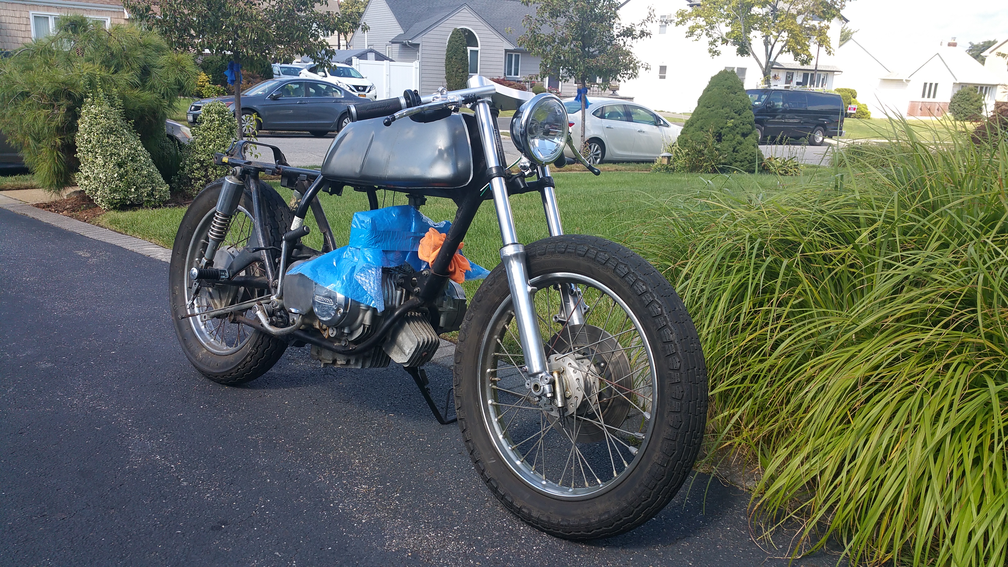

Got an order of parts today, will take photos tomorrow. One of the parts is the new headlight. I definitely wanted a beefy look, this may be ridiculous haha. 7 inch glass and 8 inch outside diameter, so it's wider than the forks. I have a feeling I may be sending it back. Pics tomorrow.
Headlight success!!! I love that i was able to do it with no brackets! So much cleaner.
