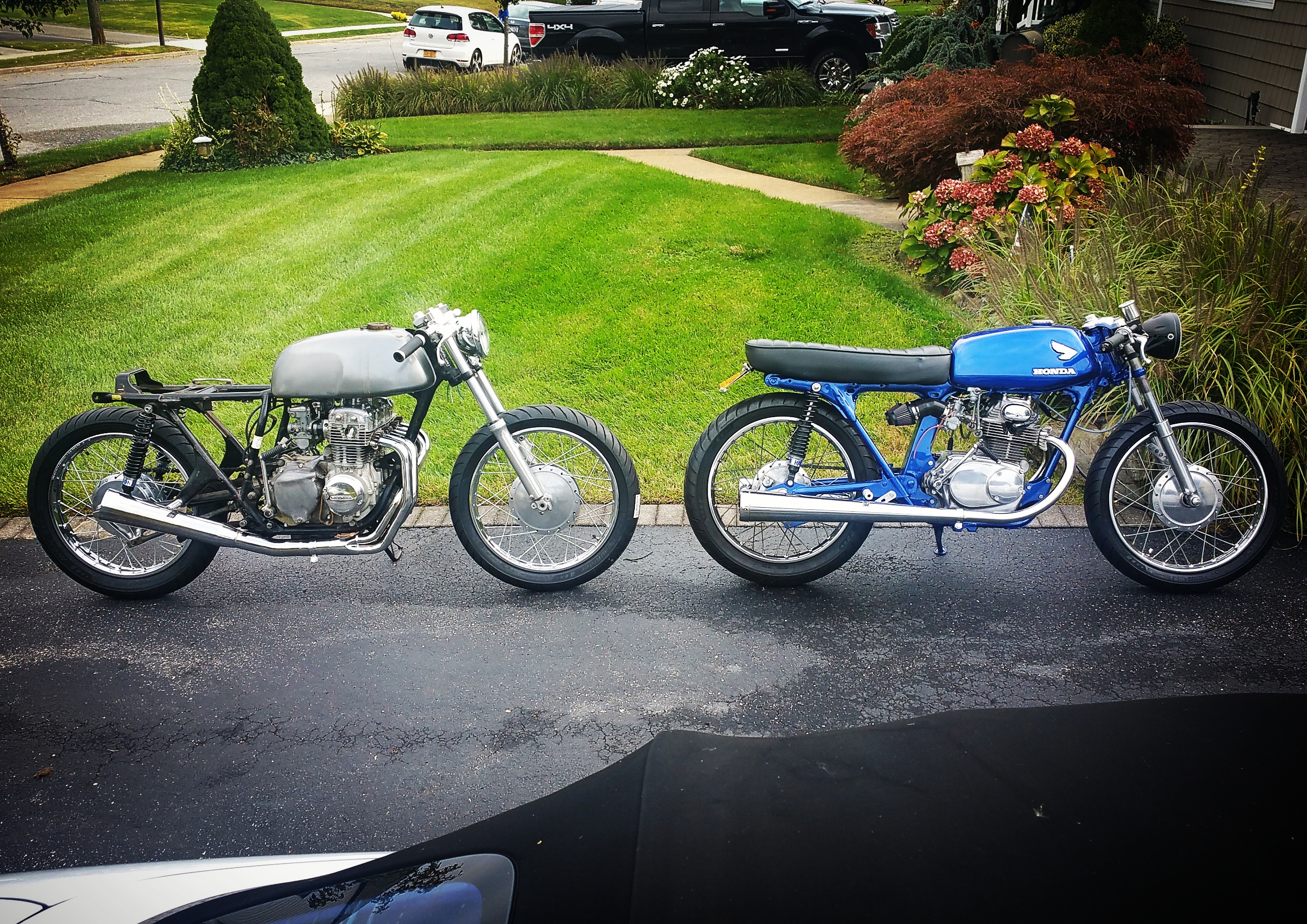

A little early but I took a picture of the growing family since I needed to clean out the garage.

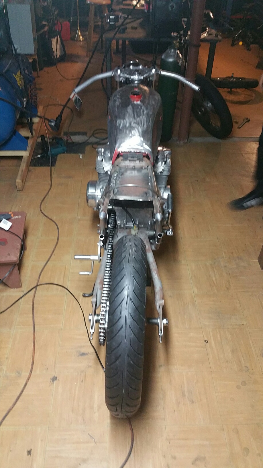

And here's a preview on a cb550 I'm doing with a friend

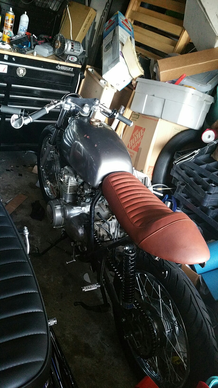

And in a recent turn of events, went with a different seat. I absolutely hate the cover, will have a new one made, but it fits the bike well. Also the back is a little close to the seat, need to shave half an inch off to have the correct clearance for the rear suspension travel. Very doable.
