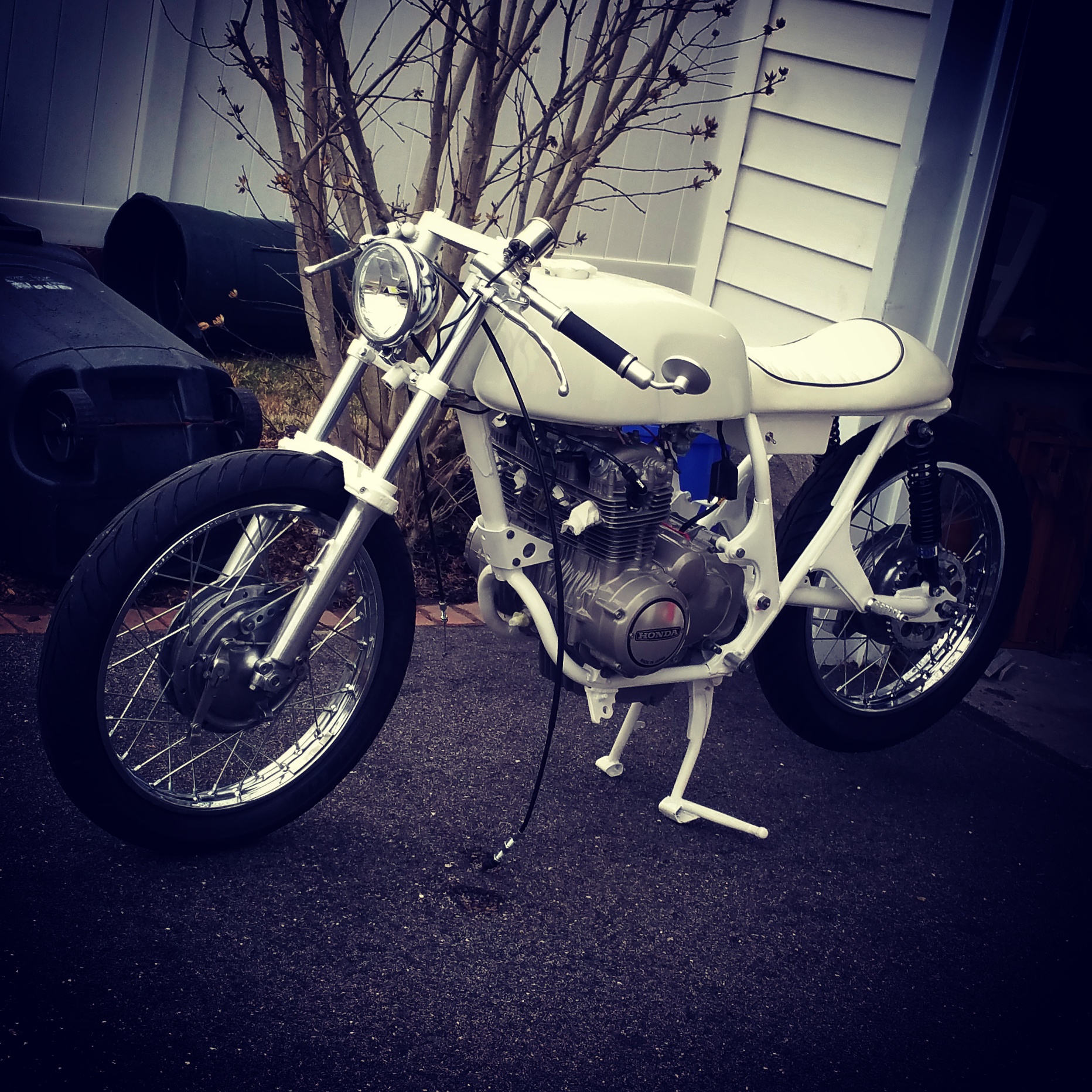

Thanks. Everyone thought I was nuts doing a white bike, but by the time I get all the silver and chrome on I think it's gonna look just fine. If I wind up wanting less white I'm going to have the tank airbrushed.
Been very busy, but did manage to get the swingarm/ shocks on, as well as the new bearings with triple installed. tomorrow should bring a full roller, I hope.

Got into the electrical today, shouldnt be much longer to be complete. Decided to throw the tank and seat on for a photo. The tank needs a graphic for sure.

Got a bit more done. Left to do:
Change front brake linkage
Install exhaust
Install airbox
Put on kickstand
Put on kicker and shift lever
Put on new axle adjusters
Run fuel line
Go through the torque specs for every bolt one last time
Go for a long ride
