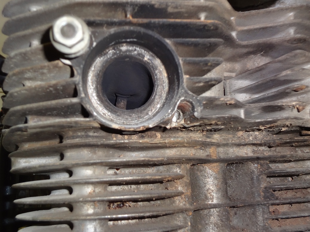

Hell, I just went to the site and found it as well. It showed up right away. I may have used some weird link to get to your site, either that or I didn't scroll down far enough. Sorry for the hassle. Either way it doesn't matter, I appreciate you giving me the info. Just an FYI for others removing the rotor, I bought a 16mm bolt with the 1.50 threads x 60mm. It might be longer than needed, but it worked fine. I simply held the rotor by hand and used an impact drill along with the correct impact socket It popped right off. Its just a Makita impact drill not a big 1/2" air impact gun. Point is it shouldn't take much to remove it. Anyone with a beat up tank with a clean inside they wouldn't mind getting rid of? Trade for some Decals? Let me know, mine isn't going to be ready in time. Trek, did you want a pic of the plug once installed? It should show up Friday. I'll throw it on and get a couple of pics. I also have to pull the head. One of the studs on the exhaust was broken when I bought the bike and Im trying to decide if welding will work on the cast aluminum or should I look for a new head.

Dont go to all the trouble of welding the stud or a new head. Simply, find a machine shop close to you. Drop it off and then pick it up. Im sure they won't charge much to remove a broken stud. (less than shipping alone on a new head) probably easier and quicker than you could fuck it up yourself. If things are slow for them...maybe while you wait, or run an errand.
Sounds good. Heres the issue I have. Its not the stud itself but part of the aluminum around it. Someone JB welded some shit in there but it obviously didn't hold. lol I didn't know it was broke, I just thought it was an exhaust leak. Bike wasn't running when I picked it up. I have fired it up so I know it runs but Im sure the motor wouldn't take this for to long. Any thoughts? This crap aluminum is tough to weld I hear.

Any half decent weldor (welder is the thing you weld with, weldor is the person doing the welding ;D ) can do it, but, you will have to pull the head off so they can get into the 'hole'
