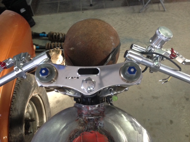

so I've been working on this bike quite a bit. I received a lot of parts and pretty much have the front end buttoned up. just waiting for the rim to be laced up / new tire installed. I decided on a front end conversion (GSXR). Conversion parts came from Cognito Moto, Devin is really great to deal with and answers all my questions. My favorite part from Cognito is their top triple with Motoscope Mini built in. Very clean look and when polished up this thing just stands out. Digital gauge with speedo sensor makes for an easy install.

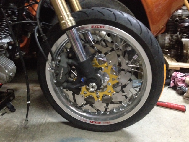

front end is finally on. Trying to find someone to lace up my front wheel but that is easier said than done in this town. Just have the headlight on there for fun right now. Probably will pick up a Bates style 5 3/4". This one is too big, might work on another bike I'm gonna build down the road.

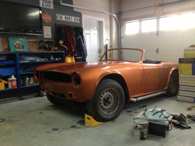

In case anyone is wondering the car in the background is my 1973 Triumph TR6 I am doing an engine swap on. BMW V12 with auto trans / paddle shift. This is more of a long-term project when money permits.

That TR6 is the shit! And with V12 its gonna haul ass........is the Beemer motor getting any massaging, like a turbo with a retuned ECU??

The V12 is an M70. I bought the whole car (1990 750 IL) and parted it out. Engine was well maintained so I'm going to do a basic tear down and new gaskets / paint etc. There's really nothing you can do internally and stock its at 296 HP so that's enough for a 2,000 lb car. On the front of the engine I'll be just running a small alternator and oil pump....have to do a dry sump for clearance. Might gain a couple HP here. I'm going to be running both stand alone engine & tranny controllers and also 12 ITB's.

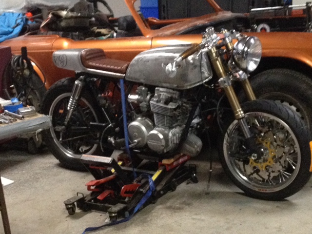

Got my front rim back and was able to get the bike down on the ground finally. I'm quite happy with the way it sits. Its lower in the front and when I put the new rear shocks on it should come up an inch, giving it a nice taper towards the front. The rear rim should be here any day and based on now seeing the front rim together I cant wait to get the back done. I might spend a bit of time this weekend removing the center stand and cleaning up some of the tabs etc, to be ready to mount the new exhaust.
Let me know what you think her???
