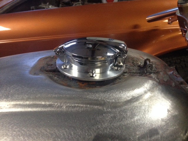

Also received my new gas cap with mounting flange from Dime City, nice product. Just have to drill out the existing stuff with a 2 3/4" hole saw then this puppy can slide right in and be bolted on. I like the look of the bolt-on vs soldering in the brass ring.

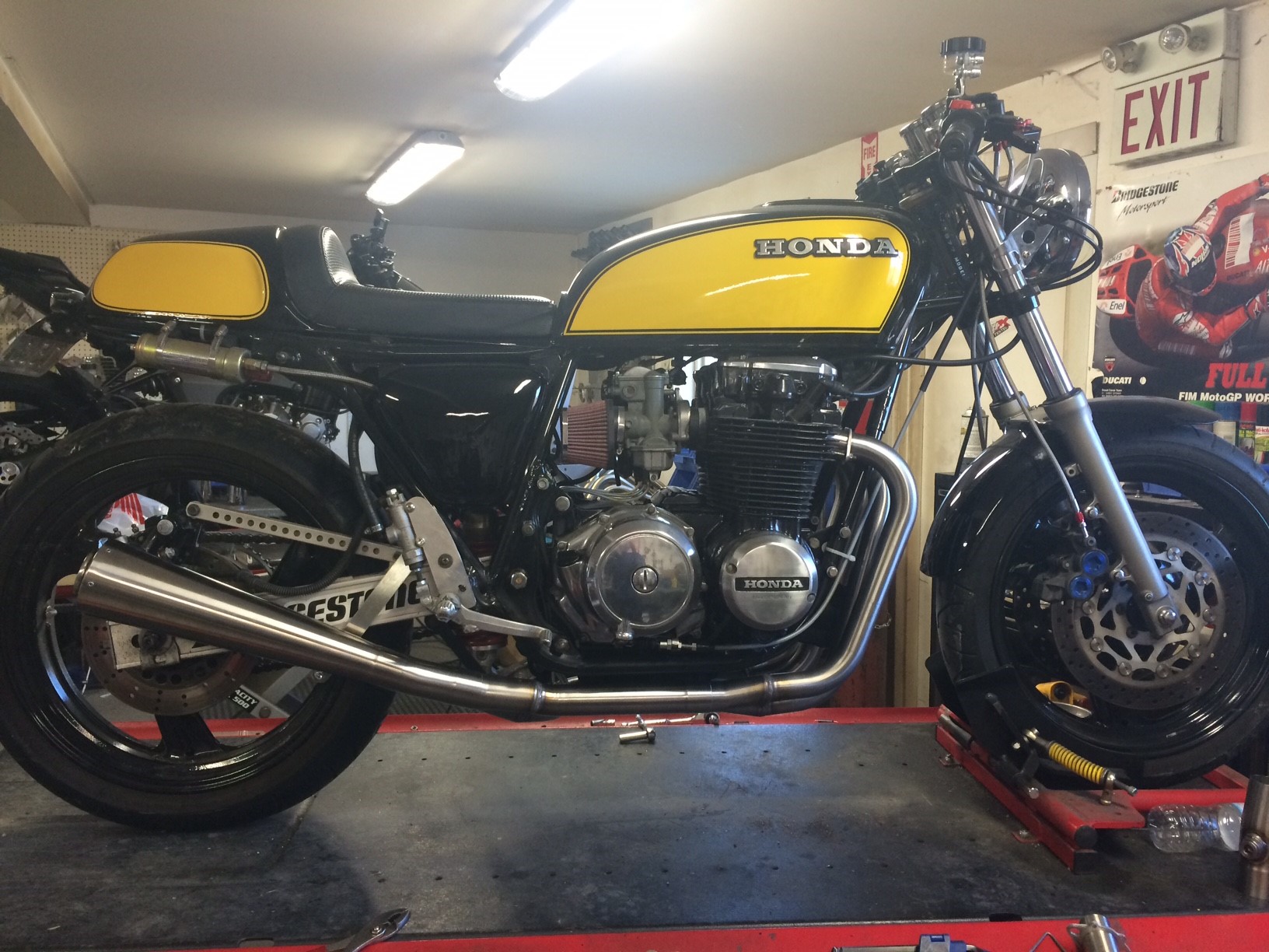

Ride509 said:
I love it, beside the fact that it's about identical to what I am currently building. Guess great minds think alike
Do you have a link to your build or some pics????
Here is the only pic I have waiting to do a build thread till I get farther along . Currently it's apart because I am welding up the frame . Putting a hoop in and doing some gussets

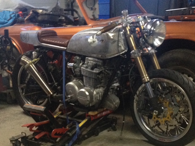

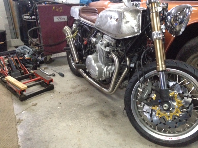

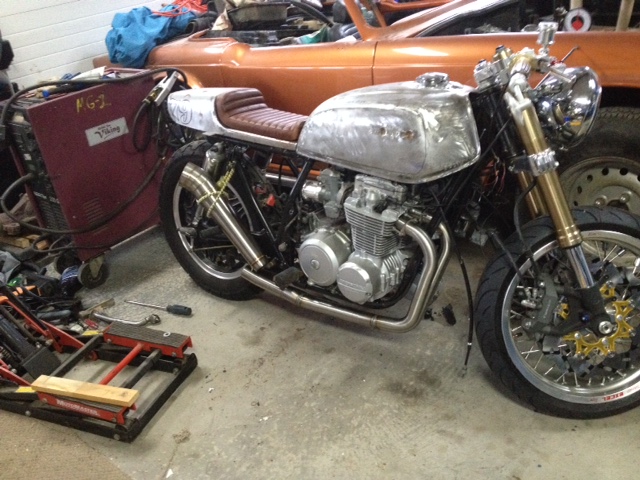

Well its been a bit, life stuff I guess. I finally received my stainless header from Ripple Rock Racers. Just have part if it on for now to check fitment. I gotta say this thing is beautiful and I'm glad I held out for it. Have to buy crush washers before I can install. The mid-pipe has to be bent to accommodate my muffler location. The muffler was not part of this Hindle exhaust but it is stainless to match.
I am well into this bike now with parts so I decided I'm going to make up a new wire harness using the Moto Gadget M Unit stuff. Not much left to buy for this thing to make it a new bike lol
Still waiting for my rear wheel to be laced up. He was having problems with getting the pattern right. Hopefully this week.

Got some rear sets in off ebay. The brackets I got from Cognito Moto. Brackets are for a cb750 so for my 650 I had to slightly notch out the right side to accommodate the bolts for the sub frame. These brackets are pretty beefy so this shouldn't effect anything.

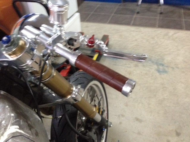

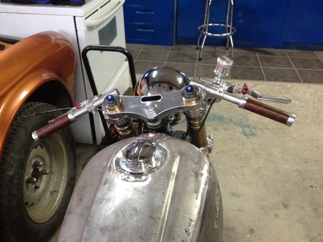

also picked up a set of Brooks leather wrapped grips out of the UK......but made in Italy. These things were a bit pricey but fuck it they are beautiful and match up with the seat perfect !!!
The install is a bit tricky on the throttle side. These grips are made for bicycles and fit 7/8" bars so I am going to have to get creative for the right side when I install it on the new polished aluminum throttle assembly I just got. It has a slightly bigger diameter as it slips over the 7/8" bar. More on this later.

jpmobius said:
You'd better consider a green zip tie for that: safety first!
hahaha....I like the black..........good eye!!

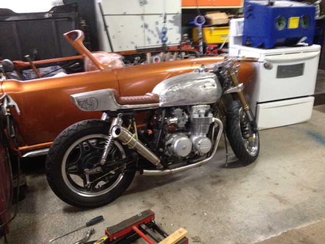

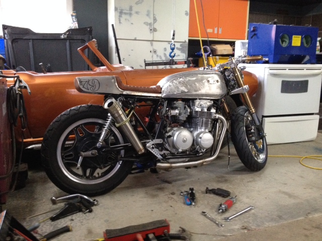

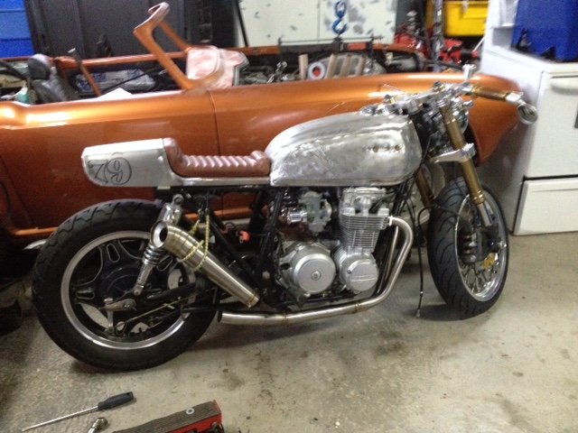

Just mocking up the bike for now. Have to fab up a bracket for the right rear set linkage side to get it out of the way of the exhaust pipe.
How do you like my bungee cord muffler mount?? LoL
