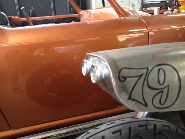

I debated on a rear brake light for months. Single round light, square, old school etc. I started thinking outside the box and searching for chopper lights. I located these LED beauties from After Hours Choppers. There called Pair O Tit Mouse Lights, lol, don't ask, I have no idea where the name comes from but looking threw the sight it appears he is motivated maybe by titties!! hahaha
For the install I will be counter sinking them into the metal seat pan. I will fab up a bracket that they can bolt to on the inside. Once the bike is painted these polished alum lights will really pop !!!

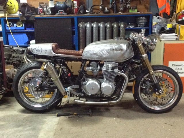

Well things have been moving along slowly with this project. My wife and I had our first child in August, healthy baby boy!! and I have lots of other projects in and around the house but things are getting done and I will have time this winter to finish the bike for spring!!
One of the big hurdles I had with this bike the past year was the rear rim / hub. Was having problems lacing it up then after talking with Devin at Cognito Moto we realized I had the wrong hub (Anyone looking for a polished 550 hub???) Got a new hub but still had troubles getting the spokes in. I finally shipped the whole works to Devin and he graciously got it done for me.
Here are a couple of shots of how she sits today. Now I can decide what shocks (and height) I want to order. Likely going with the Fox Podium R's. Would love to get the RC1's but I do have a few more big ticket items to get to finish off this bike.
Also getting ready to order all the Moto Gadget stuff for a new harness and a new set of carbs, Keihin CR29's.

The V12 weighs in at approx. 500 lbs., maybe a little less once I shed some of the accessories off. The straight 6 lump weighs in around 450 lbs so they are pretty close.
I'm hoping for paint soon.......just waiting for my rear shocks to arrive so I can set the ride height and weld up a few pieces.

Thank you, the tank is the original, '79 cb650. I rolled the rear lip in and under so the seat pan would fit a little closer. I also cut out the original fuel cap to install an aluminum. The old gas cap tabs etc are now gone. This is an older pic
