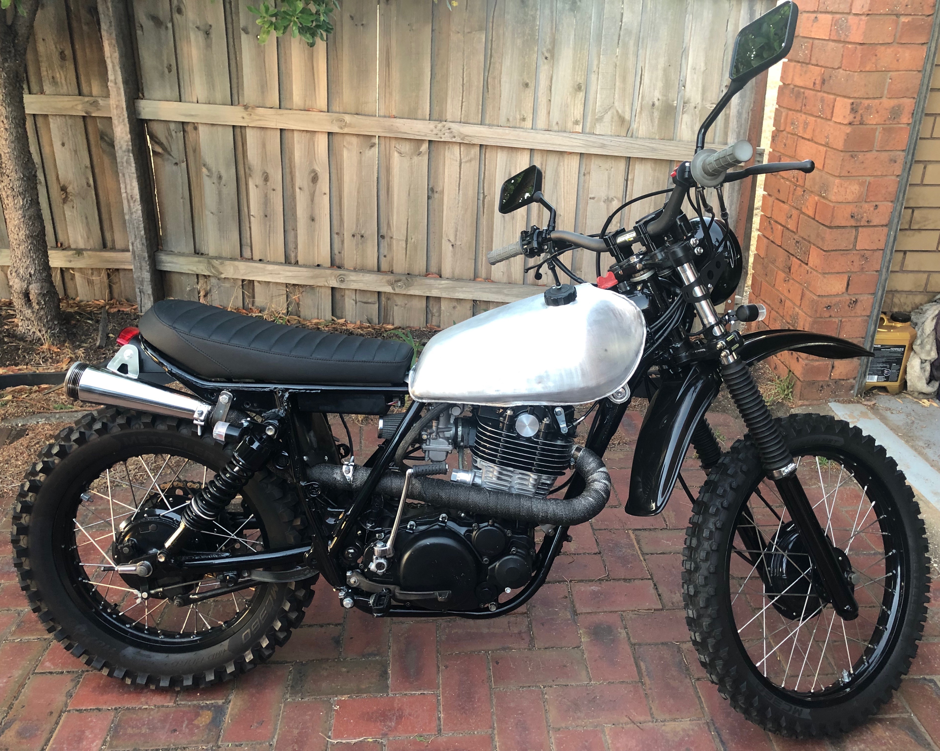

Does anyone have any thoughts on tank paint options?
