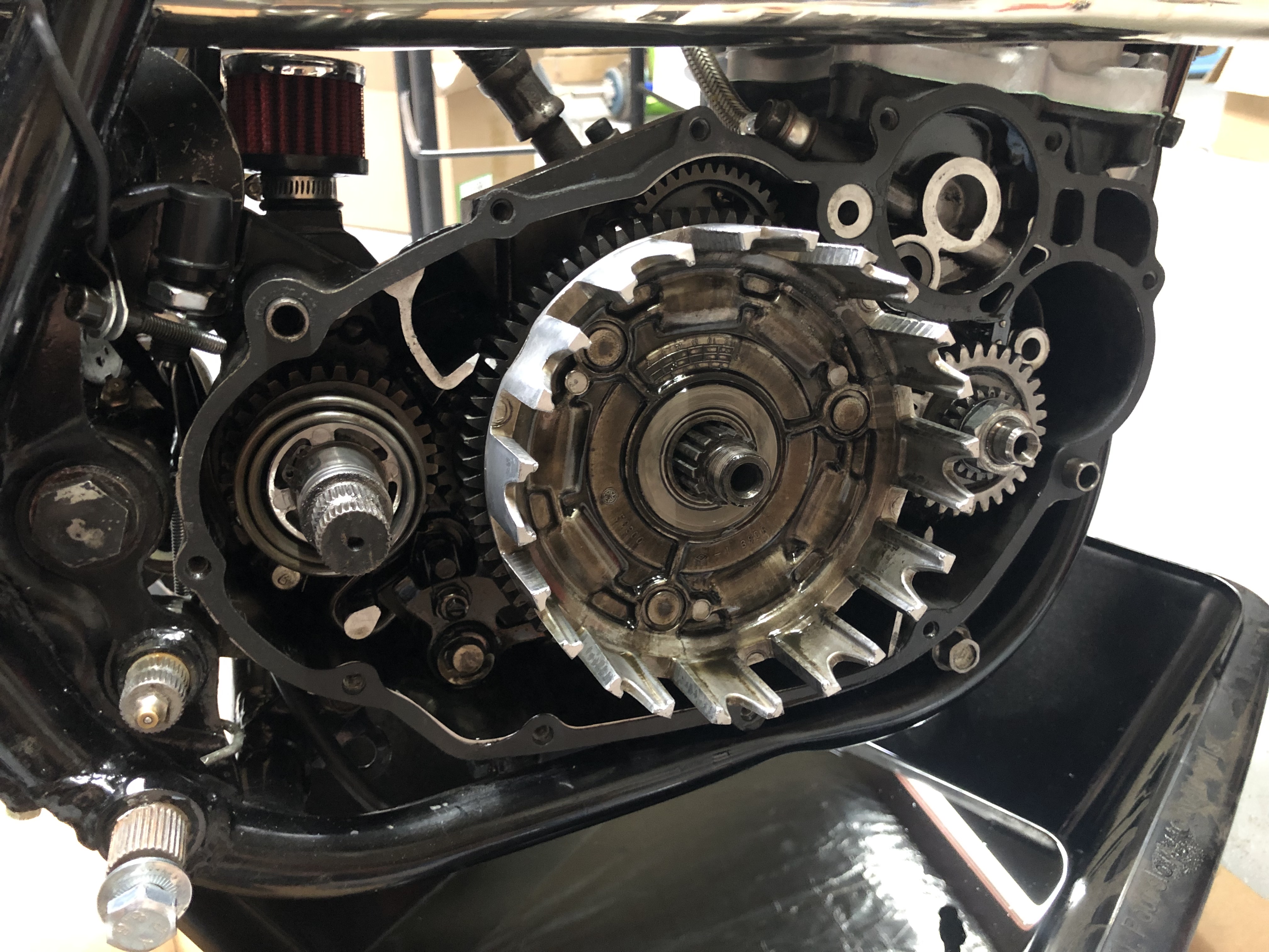

Well, ive learned the hard way!
So it appears after i removed the side cover, you do have to remove the clutch basket. Which means this will be a larger job than expected.
But thats no problem.
In actual fact! From what i can see if you only want to replace the shaft. you probably dont have to remove the whole basket, however in my case i bought a brand new gear shift shaft from KEDO parts, and there part comes all as one part, as in the PAWL is welded to the shift shaft.

I have removed all the plates and basket. No problems here, very easy and straight forward.
Behold the gear shift shaft!!!!!!!!!
time to remove it and through it as far away from my garage as i can!

Once the E-clip was taken off the shaft, it slides right out, and if you wanted to replace the shaft only, Ive noticed the whole clutch basket does not need to come off, because the shaft slides right out.

New gear shift shaft installed, no problem. Notice how the shaft is welded to the gear change arm. so thats why i had to remove the whole clutch basket.
As the manual request, i put it into 2nd gear. and lined up all the marks. and adjusted the screw so all the marks matched.
So should be all good.
