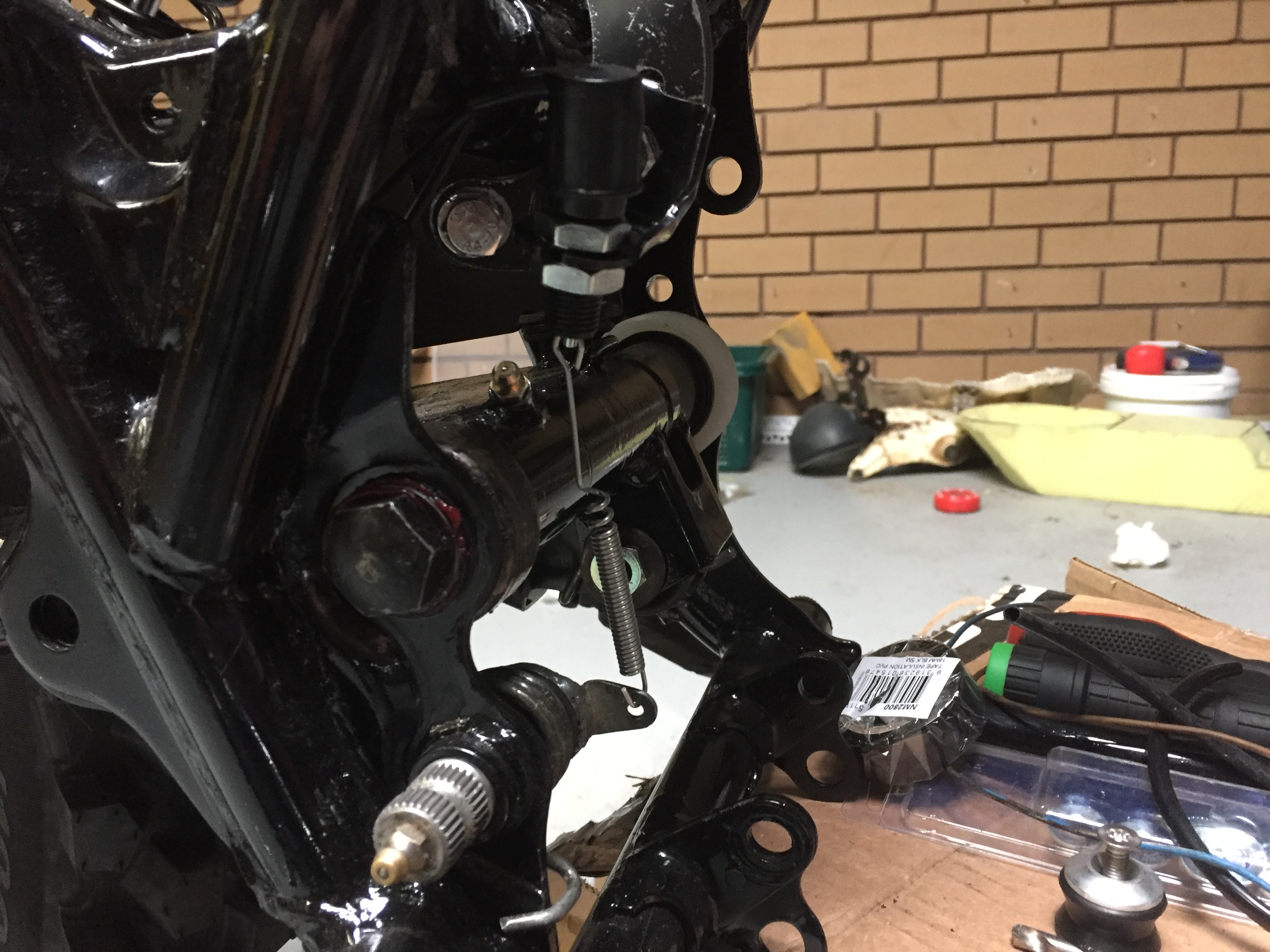

Just installed the rear brake switch, i was waiting for the bracket that holds the brake switch,

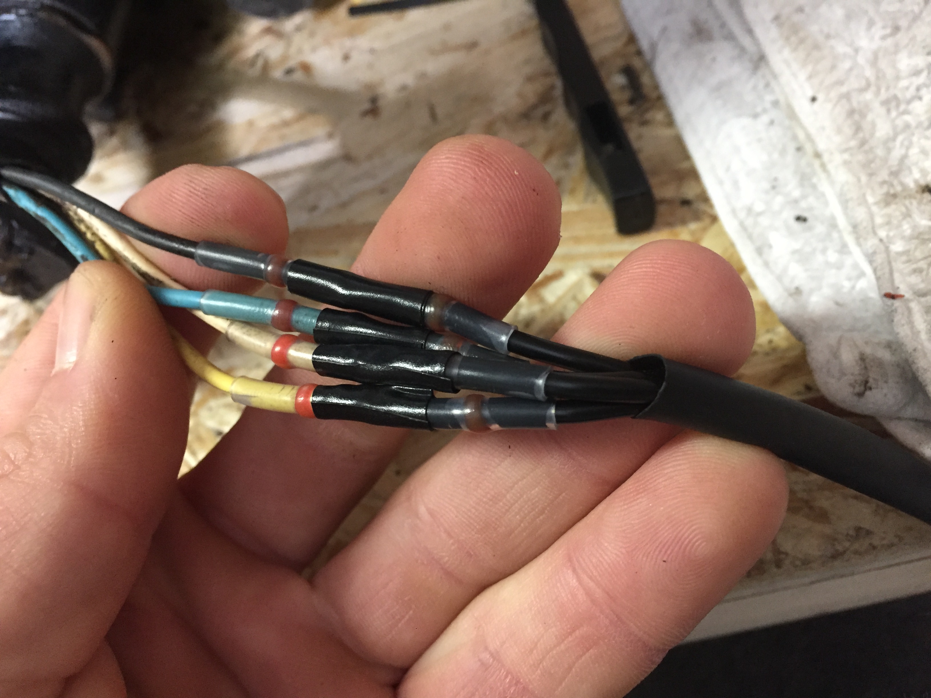

Probably the biggest challenge i have had so far is redoing all the wiring, given the way the wiring was, i will feel so much more comfortable rewiring the entire bike. knowing that every connection and wire is solid and connected properly will make me feel way better.
Most of my delay with my posts have been because i have been trying to figure out the wiring, but I have made some great progress understanding the wiring. So im kicking goals now!

Looks like good quality environmental splices there.
One thing you'll find, like I did, is the Hi beam indicator on that speedo is BRIGHT! So much so, that I put a piece of tape on it at night, because it kills my night vision!
Sent from my SM-G955U using Tapatalk

Yeah your right, it is super bright, i have the exact same speedo on my Triumph.

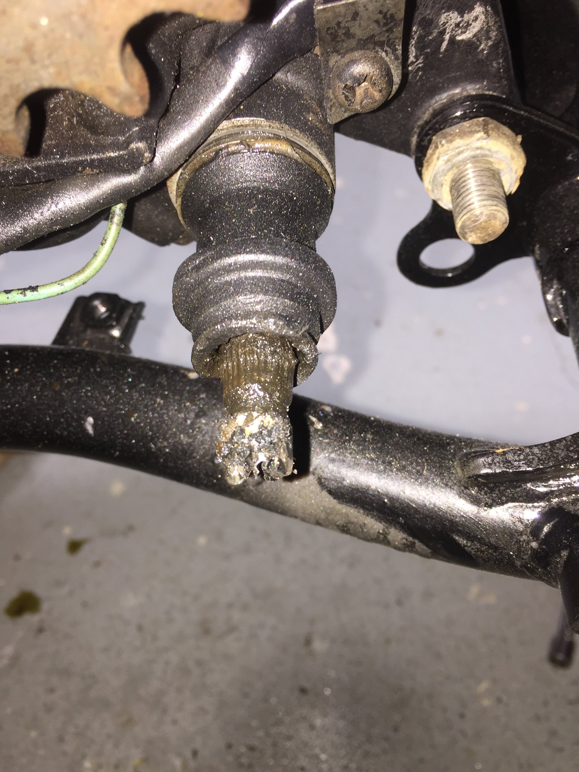

Its always awesome when the last person that owned the bike just thought it was a super idea to weld the clutch foot lever on.
Great for him but a nightmare for me, trying to get it off was a killer.
Installing the new one turned out ok though.
