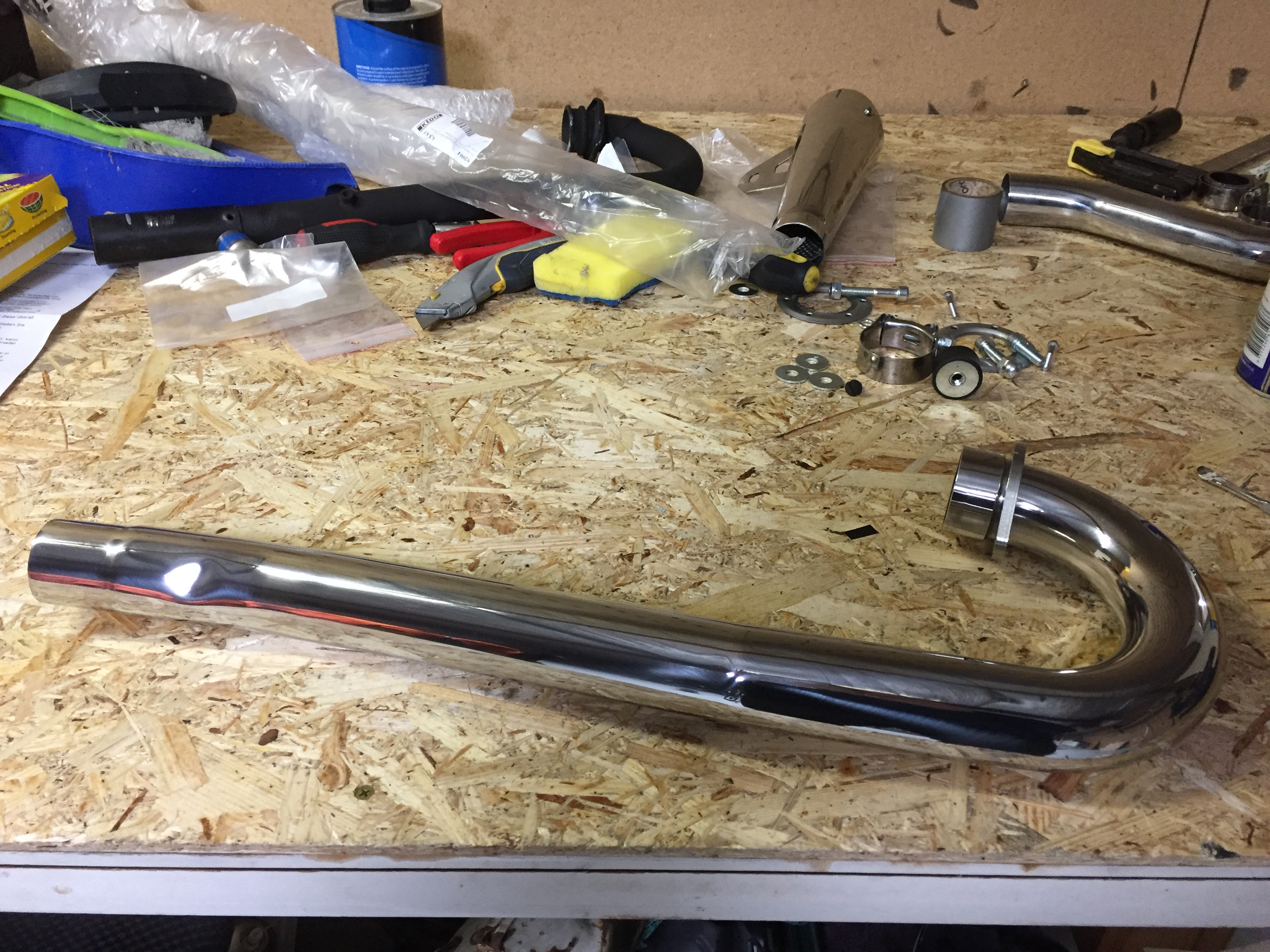

So i bought a new pipe.

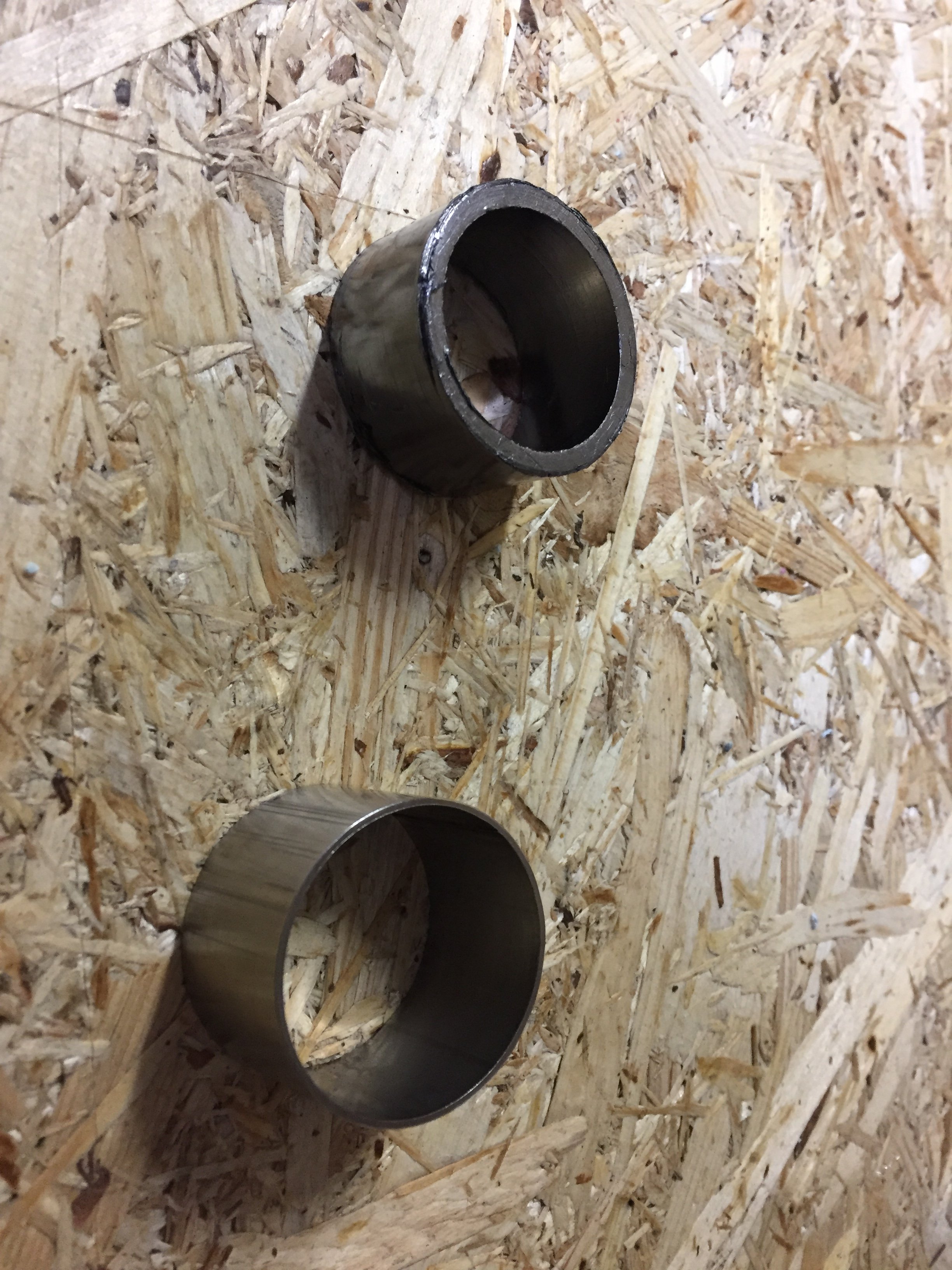

Im still waiting for kedo to send me some english instructions, which i doubt are ever coming. Sooooooooooooo does anyone know where these 2 rings go? or what they are for?
Any help would be great.

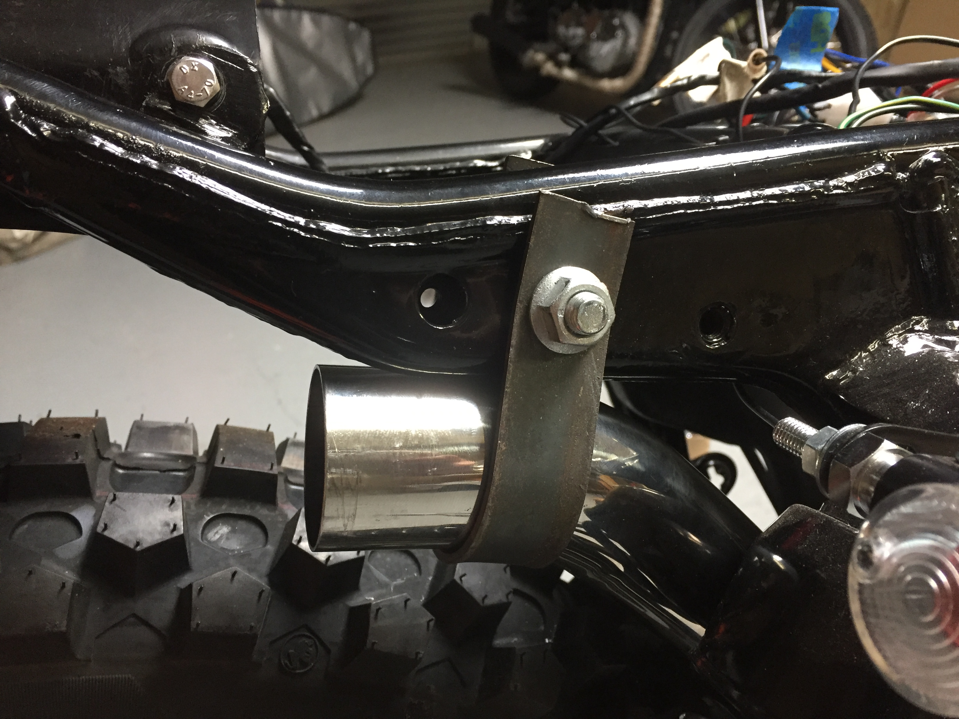

In regards to the new exhaust and pipe, it really didnt fit all that well, so i have had to make up a new bracket to hold the exhaust in place,
as im sure most of you are aware there is absolutely no room for exhausts and mufflers on the XT, its so tight. I personally, on this bike am really struggle for room, so i have had to adjust some things. It may work for other people on there bikes, but for this build the exhaust wasnt fitting very well, without having problems late with the tyre rubbing.
So this bracket i made with solve that issue. I know it looks horrible now, but i will paint it and shape it better, im just seeing how it will fit, and turns out it works great.

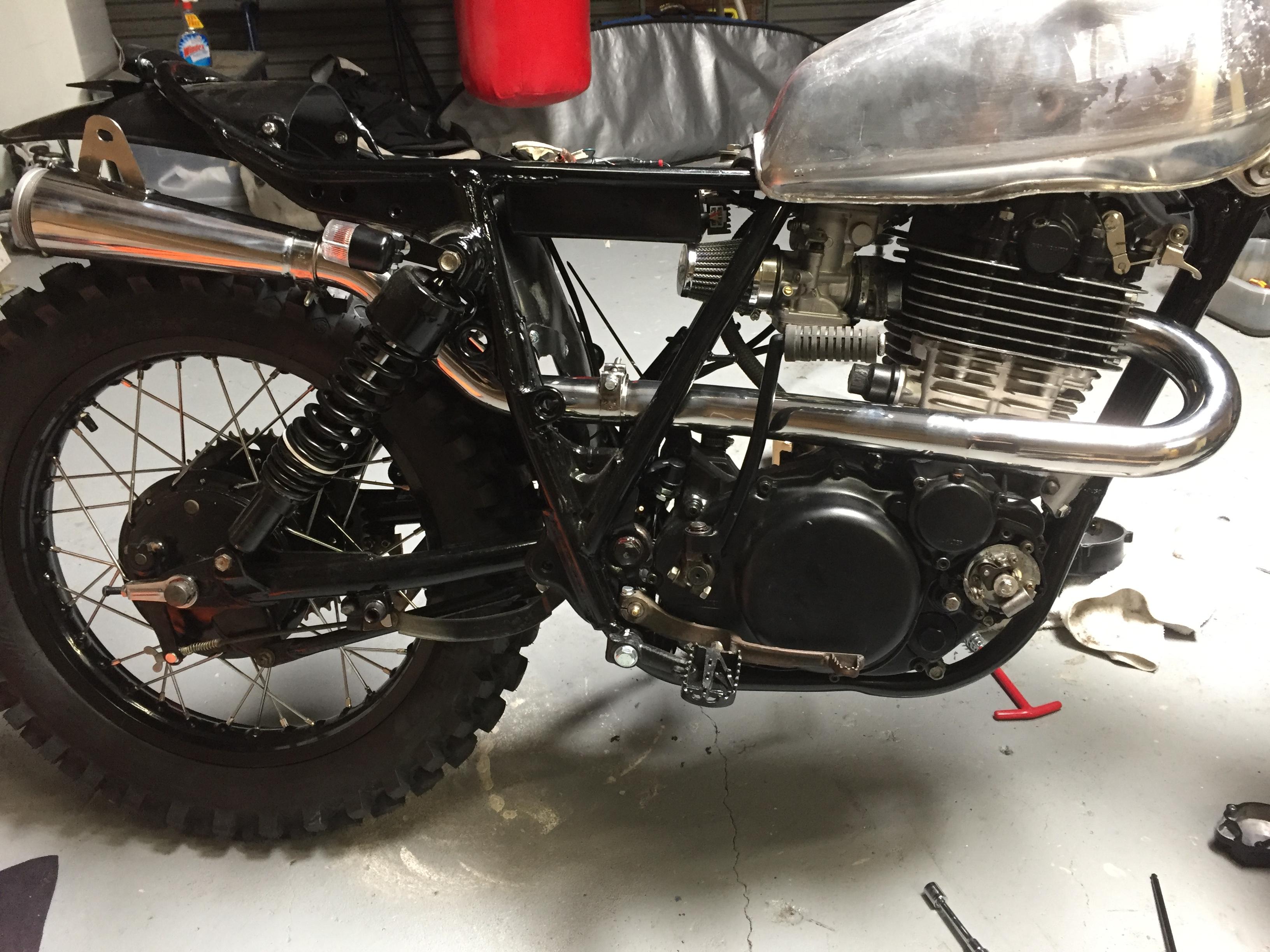

So here is the bike so far.
What do you think?
Its ready for some fuel and lets get it started and running!!!!!!
