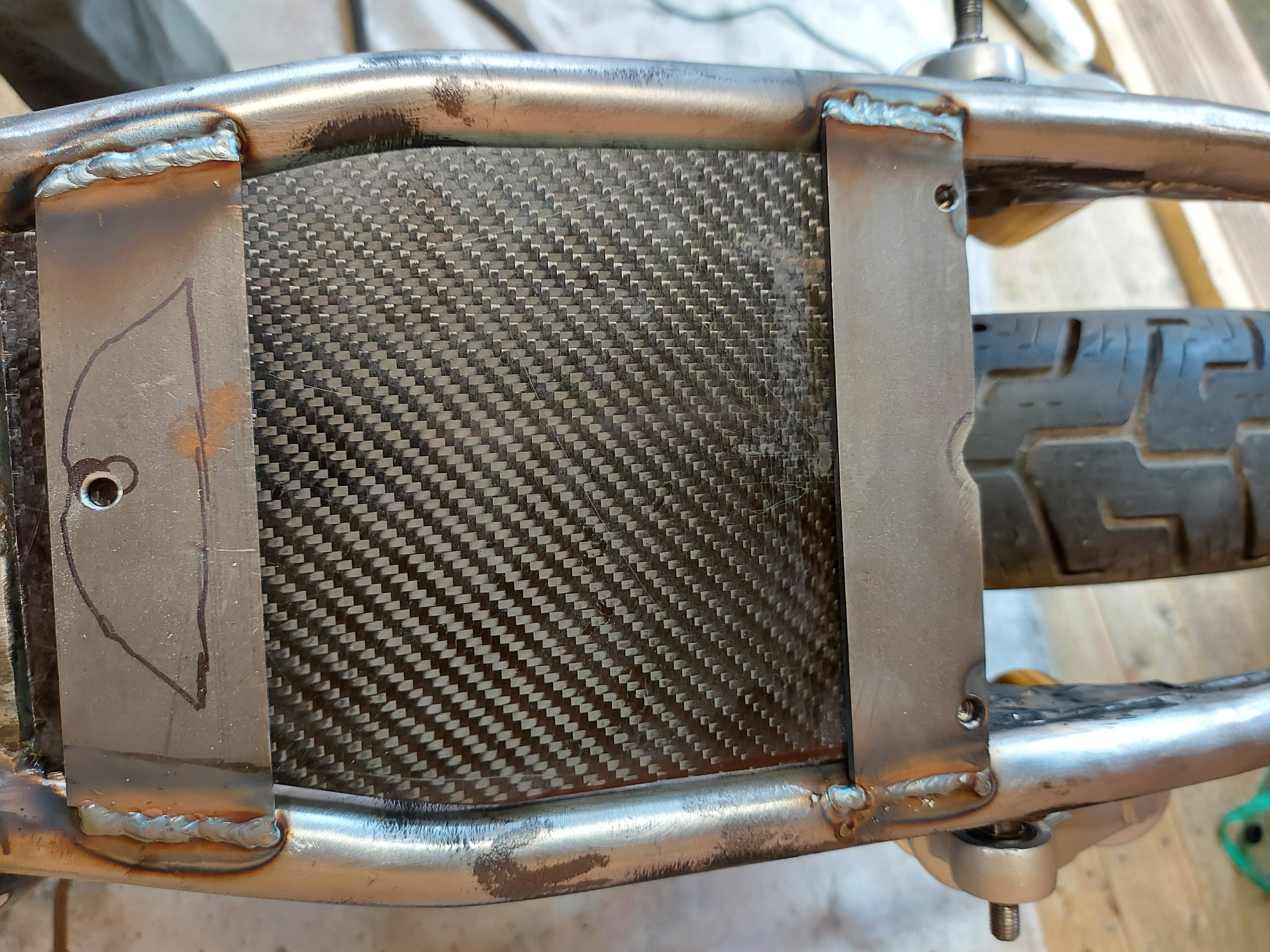

Seat hoops done at last!
I'm not sure if I want to plate the frame under the seat or not, it adds weight, I may try an undertray in carbon or something.

Got a bit more done with the frame.
The tank originally had 2 rear mountings that fastened to a kind of bridge on the frame, ugly and a pain to work around, I also wanted to lower the back of the tank a little to line up with the seat unit better.
So, cut the bridge off, welded a new bar into the frame for a central fixing.
Then I had to make a piece to weld into the back of the tank.

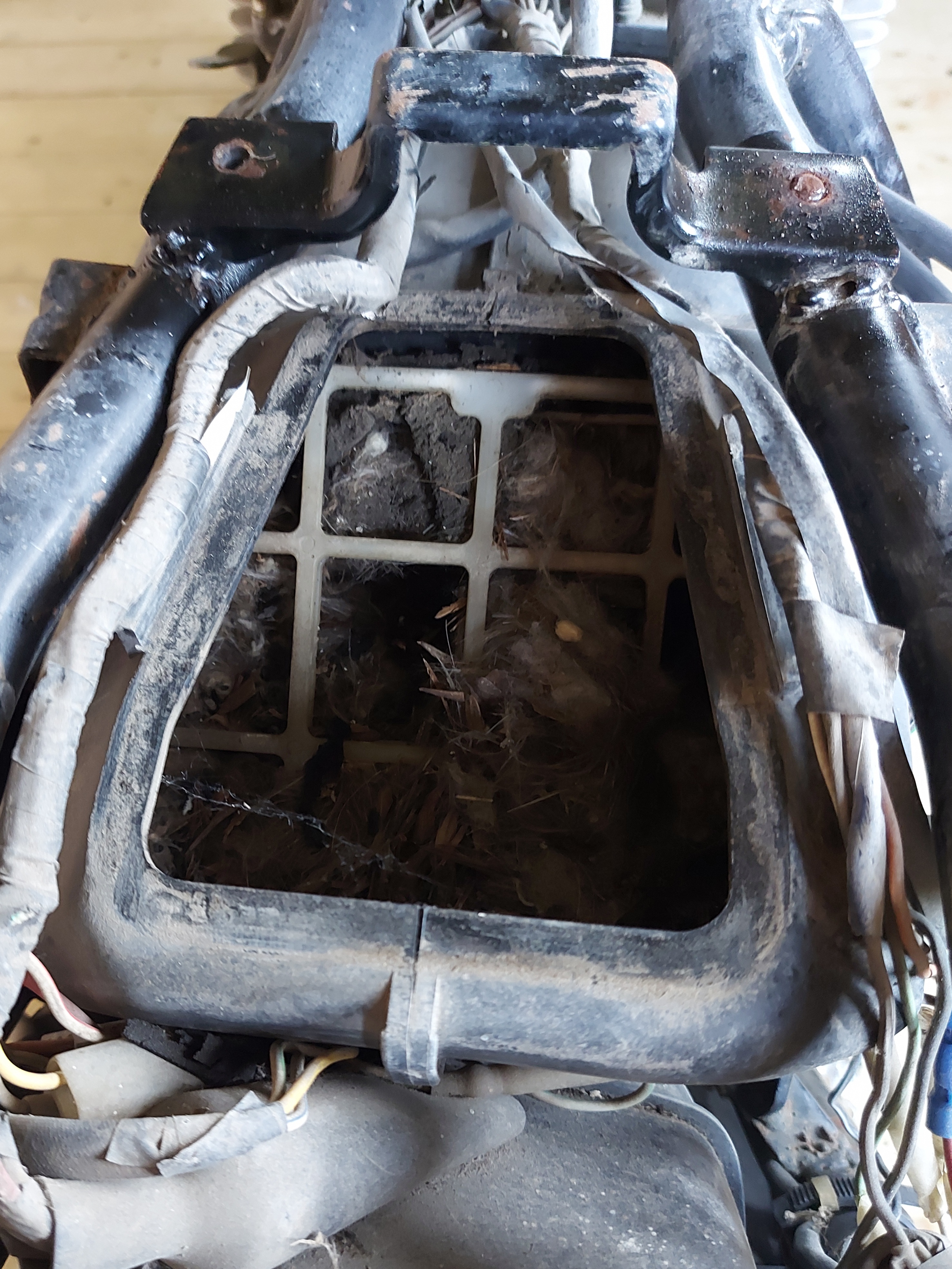

And made a start on the carbon undertray, this will also form the top of a carbon airbox, with short velocity stacks inside with a foam filter.

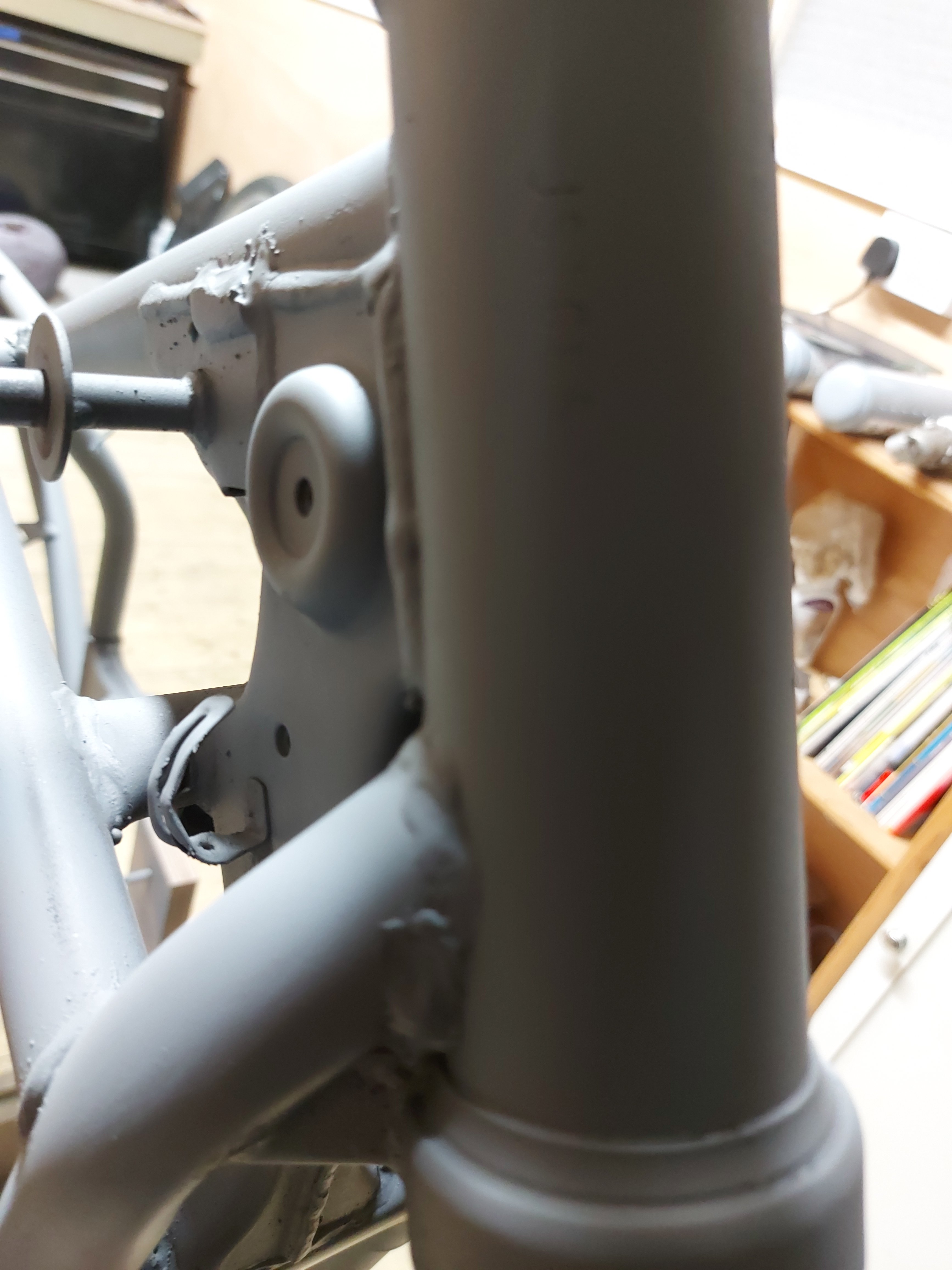

Small update, frames done and ready for paint!
Some of the 40yr old paint shows no sign of wanting to leave the party so it's been sanded and scotch brite cleaned.
Also managed to get the very stubborn bottom headstock bearing out, savage heat is your friend!
Also, an update on the carb front, decided on later GS500 carbs, bit more modern design, easier to set up and half the weight of the originals.
And K&N do a double filter for it at reasonable money.
Should be here by the weekend.

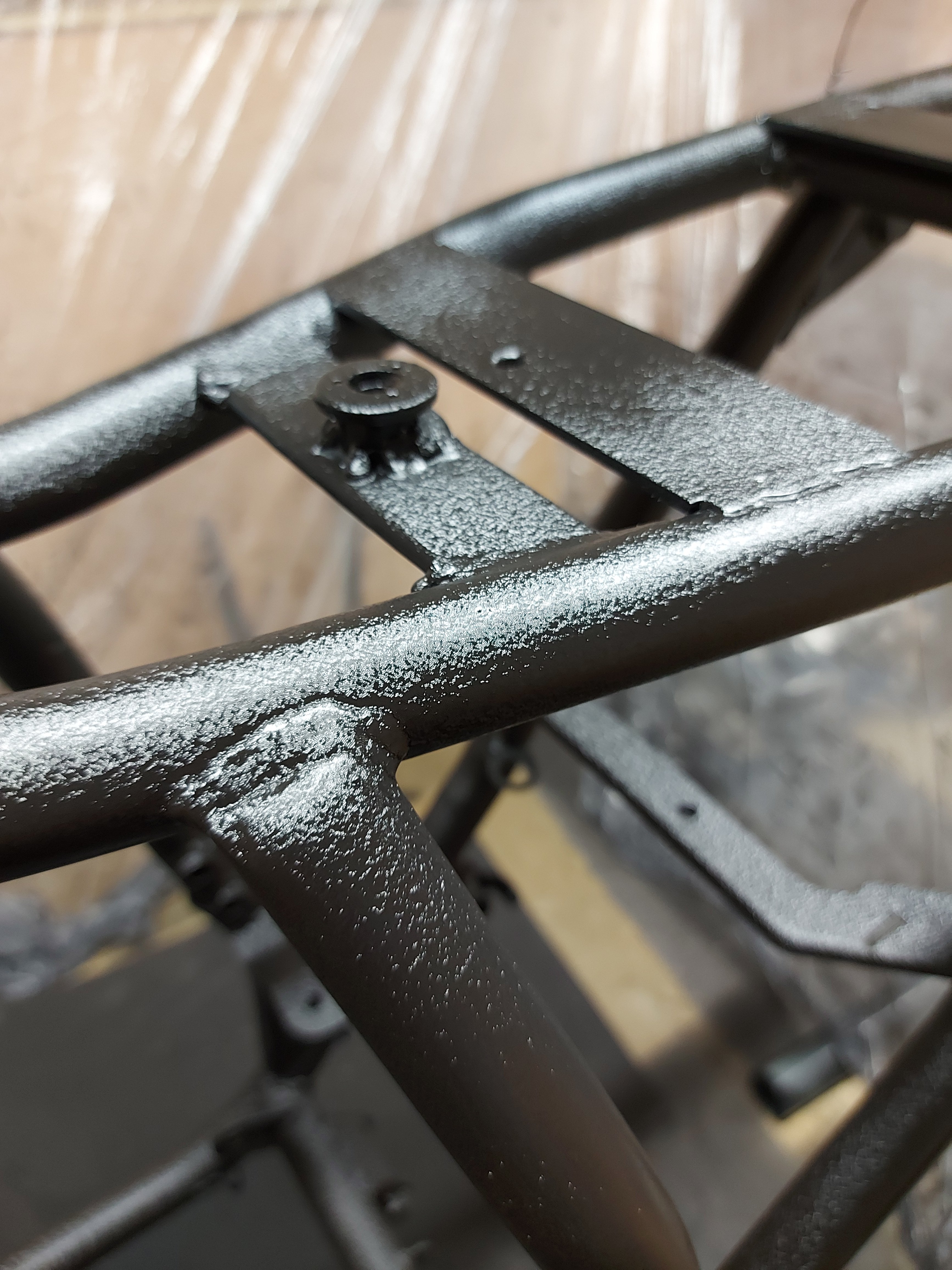

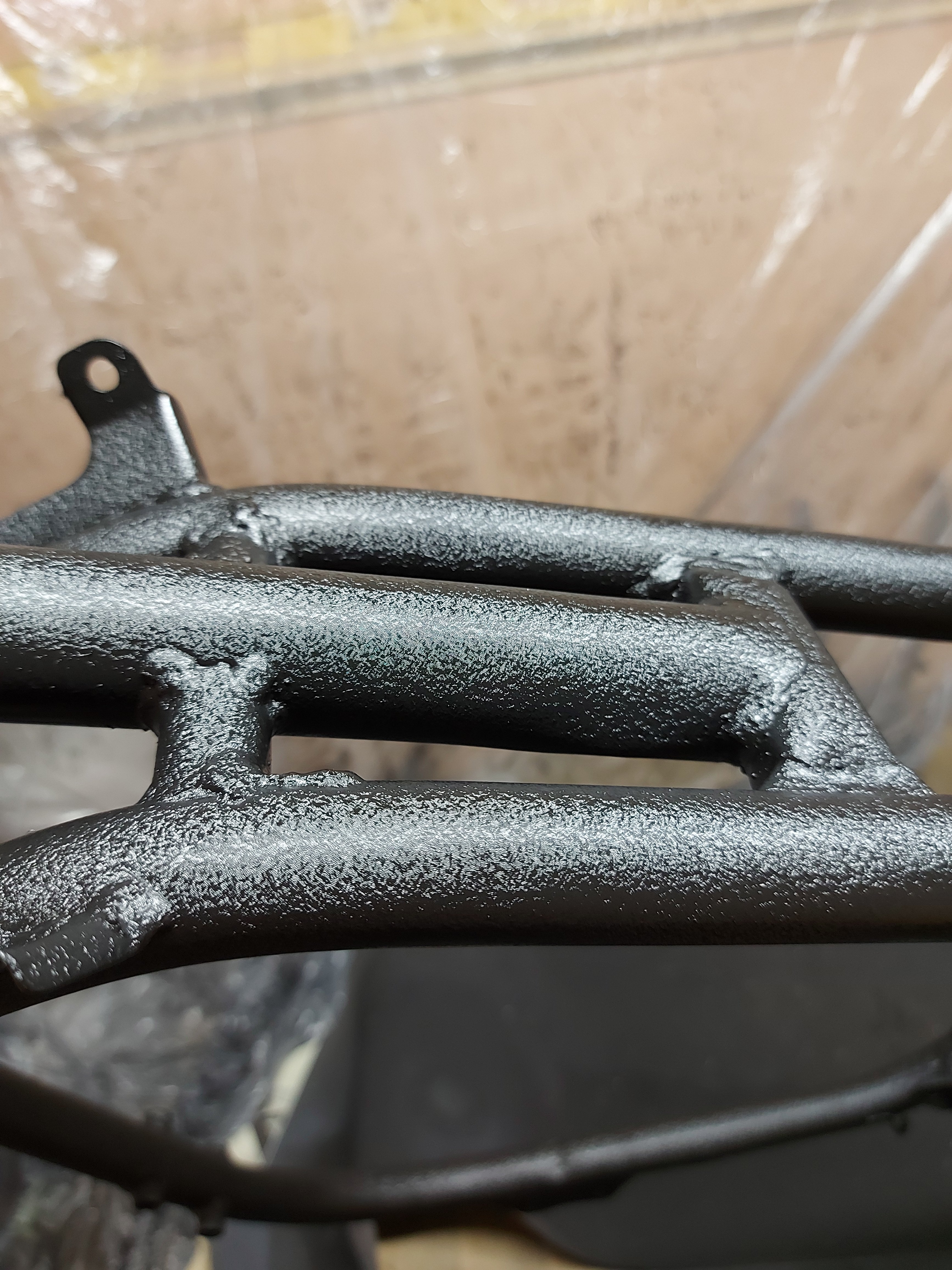

Temporary spray room set for the frame painting, the space has to be warm for the paint to work, I'm using the wrinkle finish stuff that gets used on car cam covers.
It's very tough once cured, but a pain to apply and has a particular technique, I have heaters set on timers for tomorrow so my shed should be warm as toast by the time I'm ready to paint.
Well, so far so good, horrendous stuff to spray, everything around it gets sticky, very high gas off after painting.
But, it's looking like it's worked
It's over some heat now until tomorrow morning, it will help cure the paint and tighten up the grain, it'll be as tough as powder coating in 48hrs.
