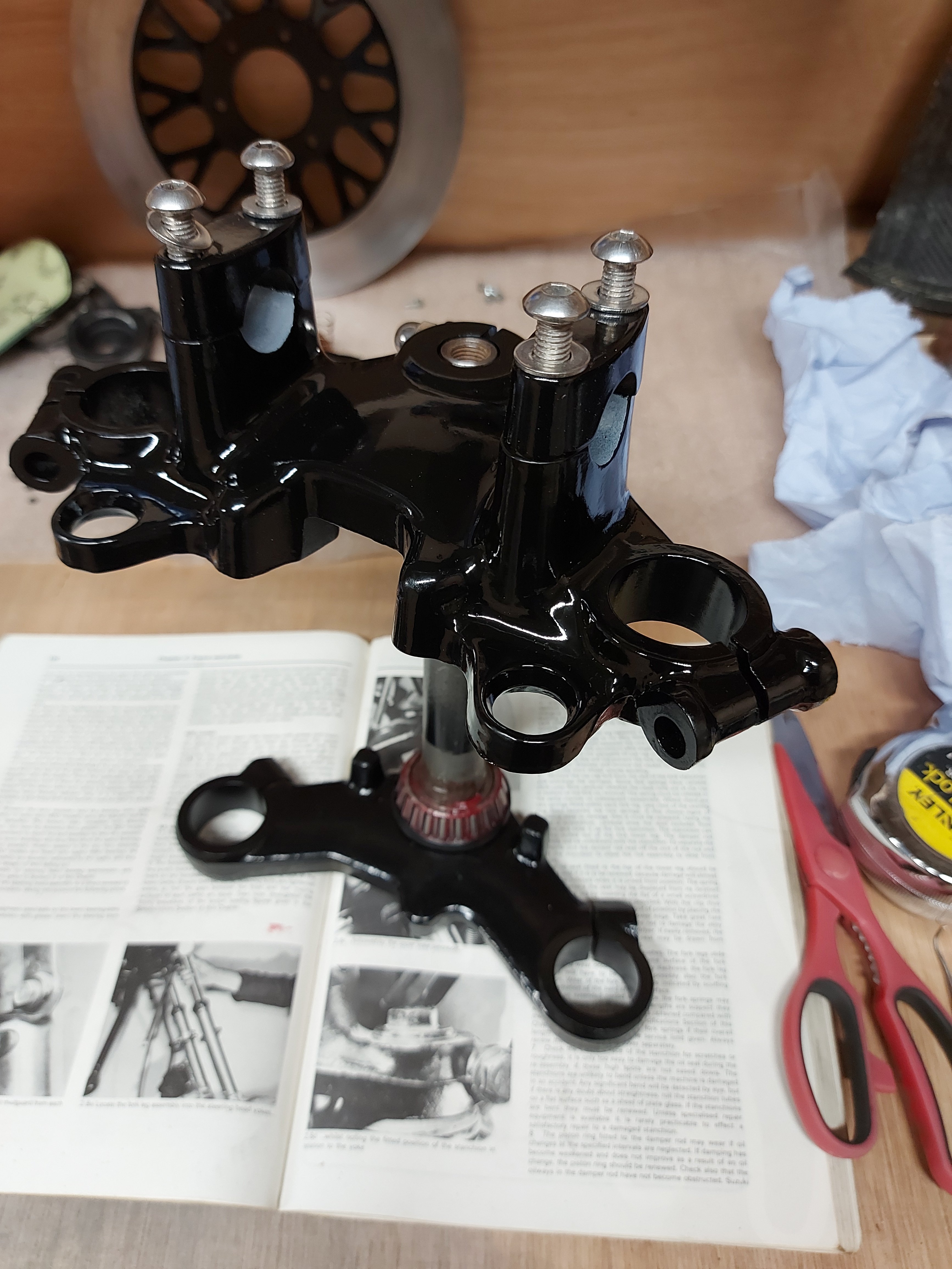

Also, while sanding the frame I got the yokes / triple trees painted and new steering head bearings fitted.

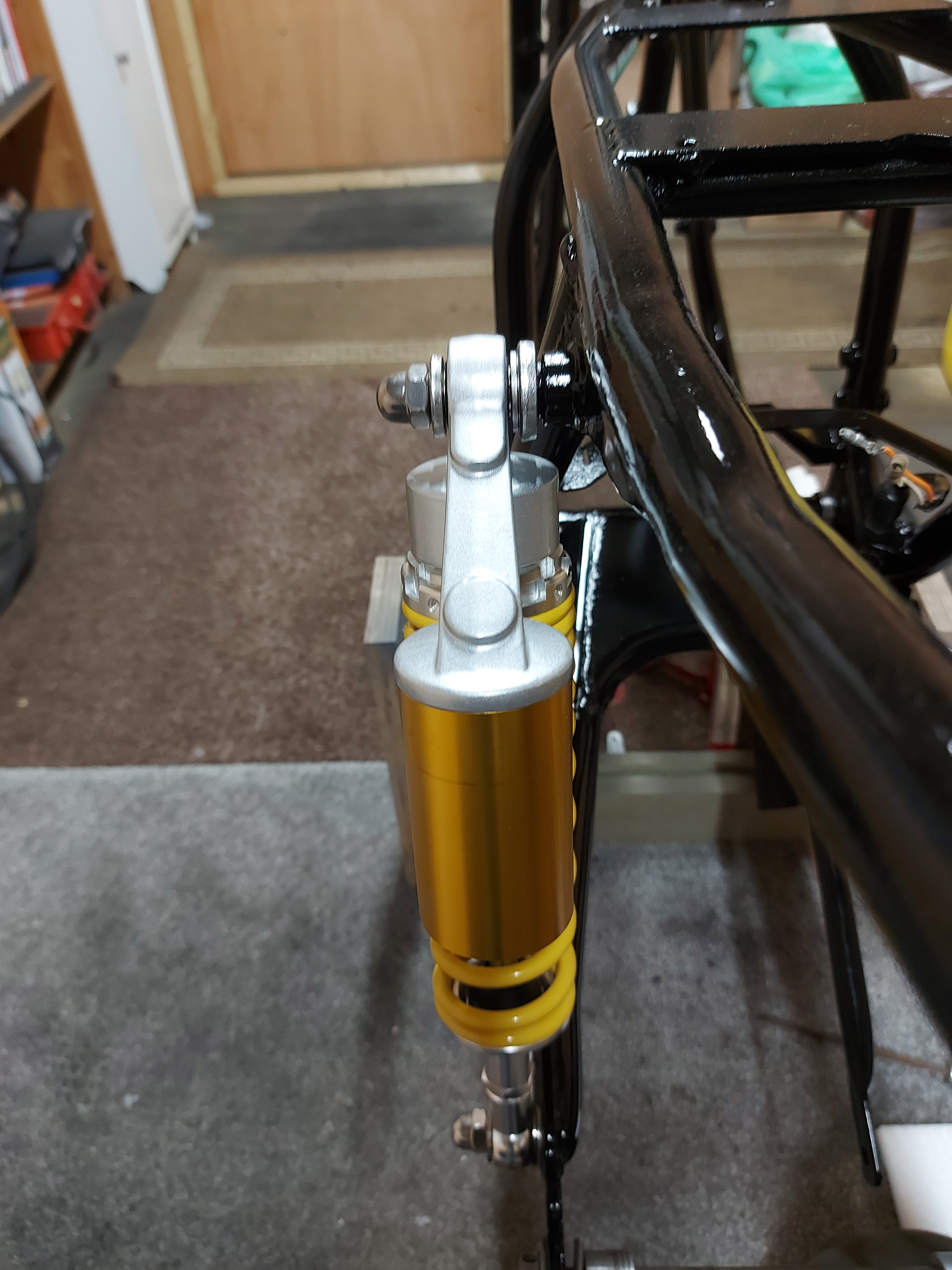

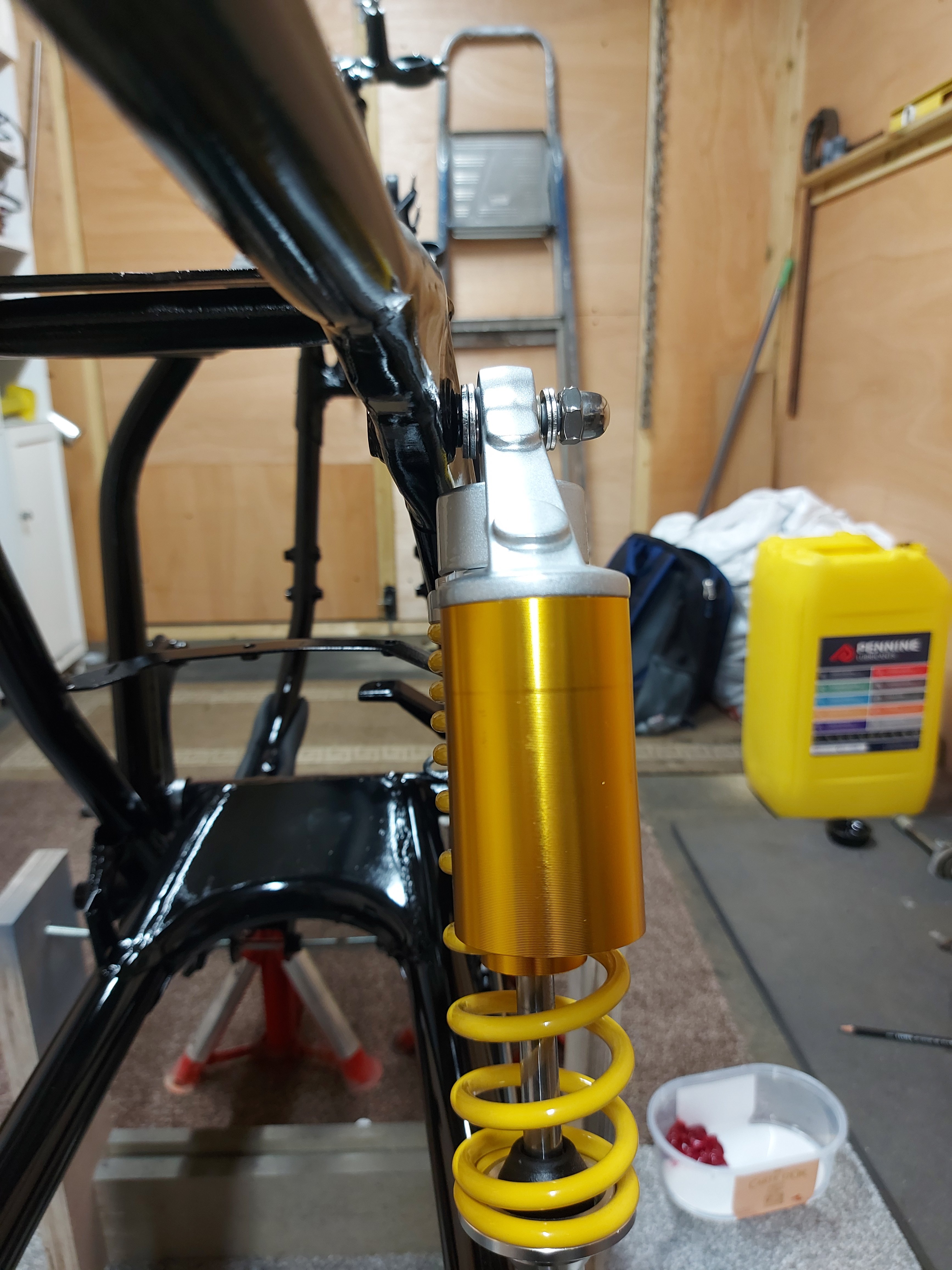

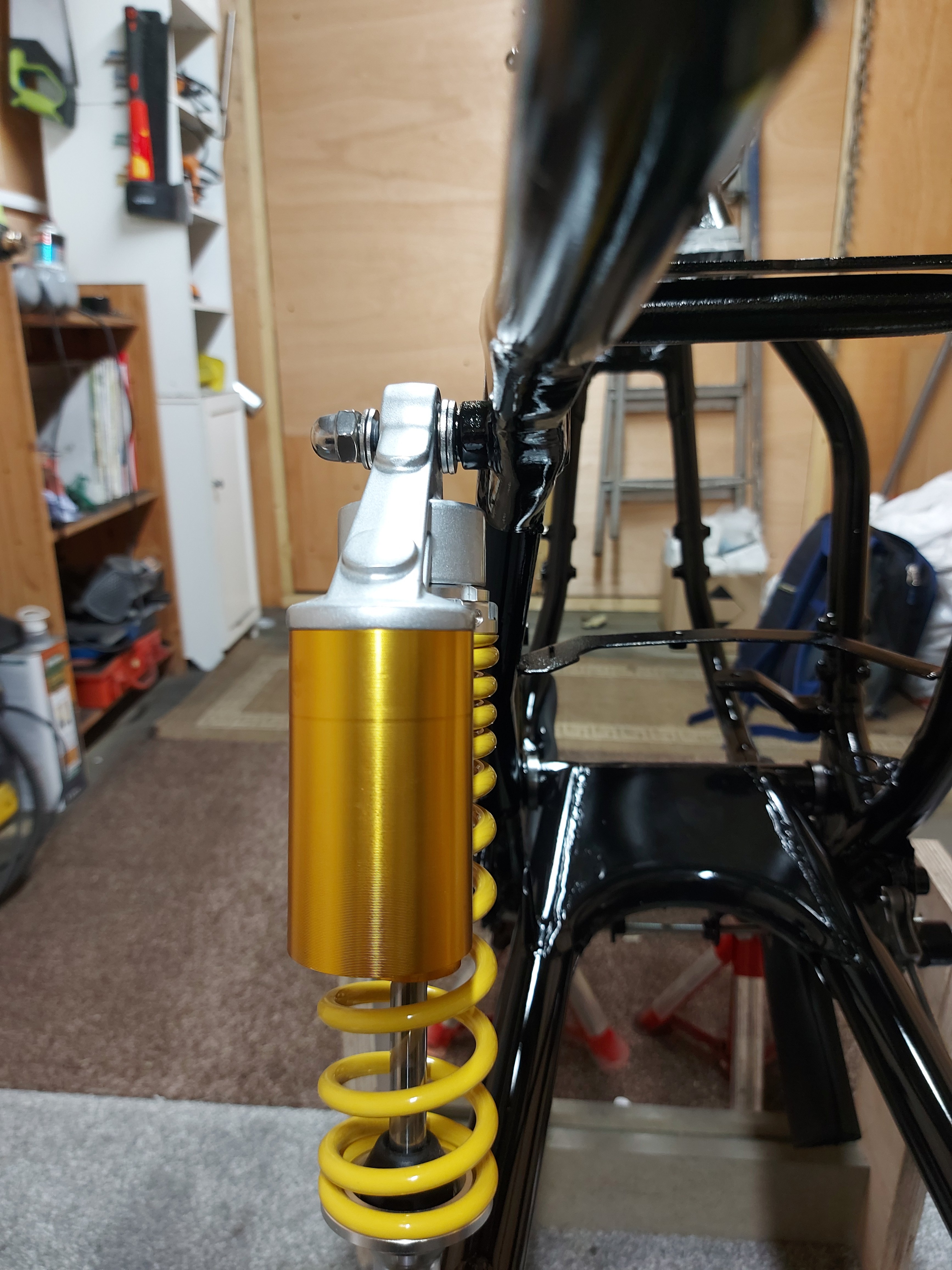

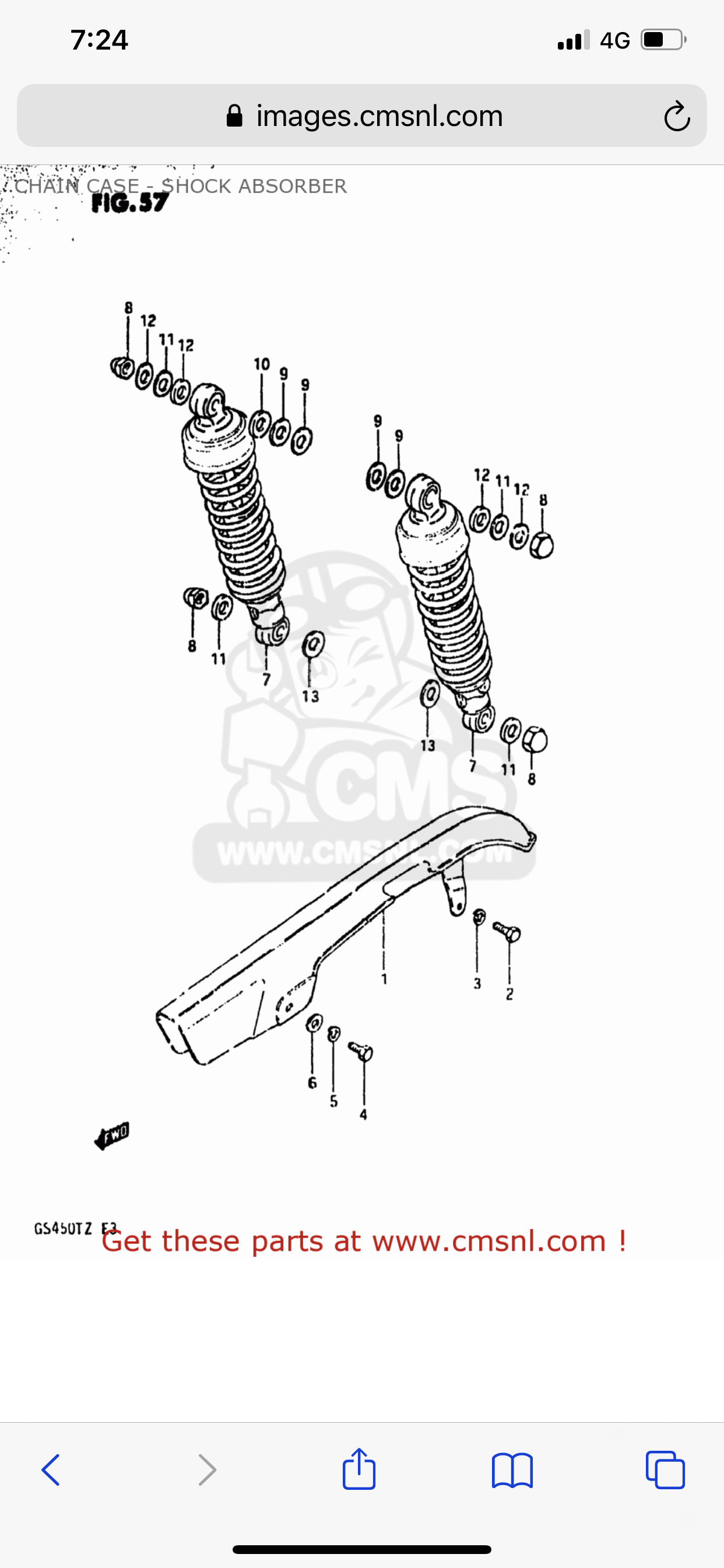

Guys, I need some help.
I'm currently trying to get some measurements for a couple of spacers for the rear shock upper mounts.
But both sides are different and I can't grasp why, it would seem the standard shocks would have been at slightly different angles to each other.
One side (the chain side) has a captive spacer on the top shock mount that isn't on the right hand side.
Why would this be?
Why would this be?
I think it’s for chain guard clearance.
You can see the diagram quotes an extra washer on the other side to space it out.

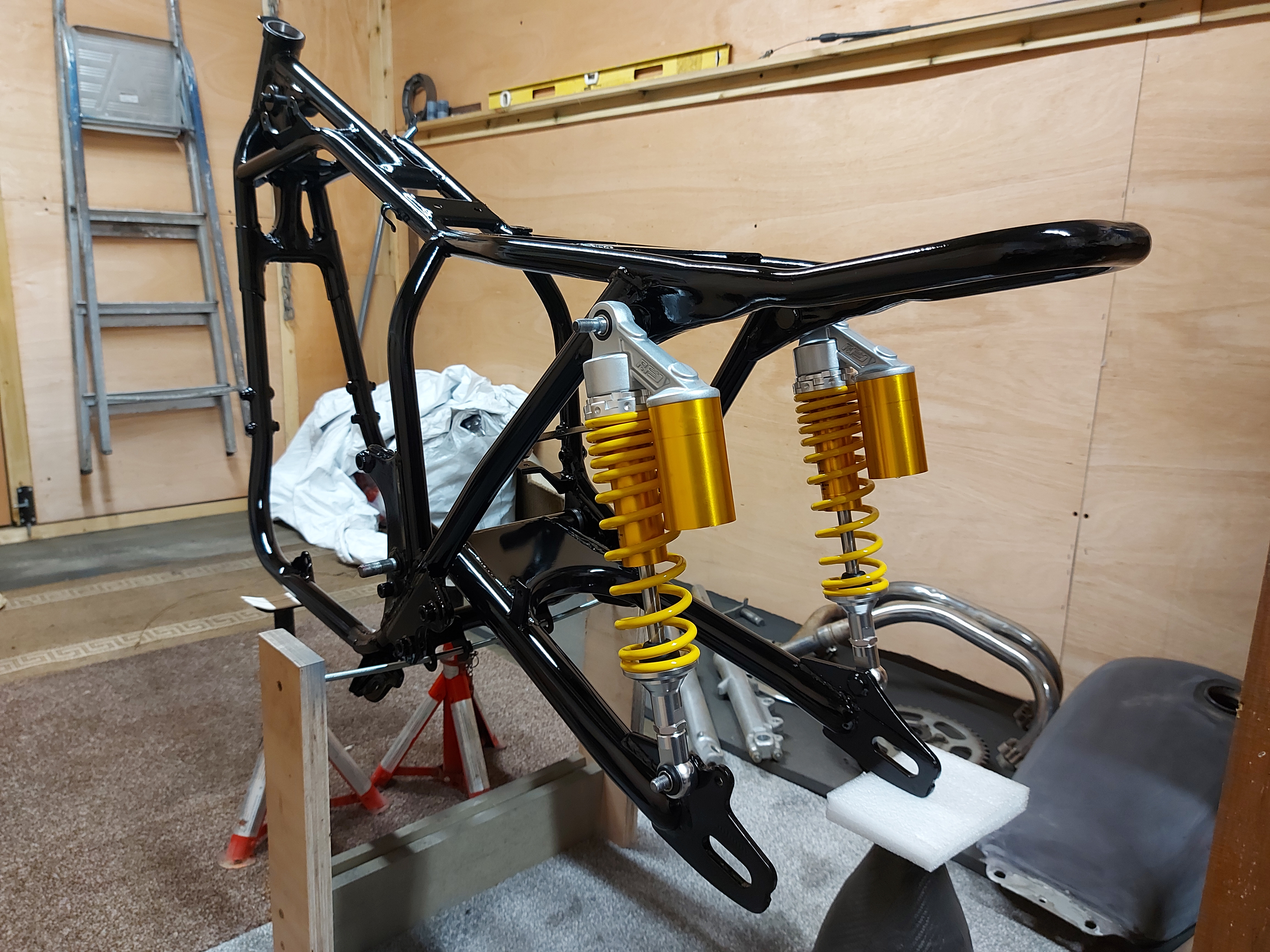

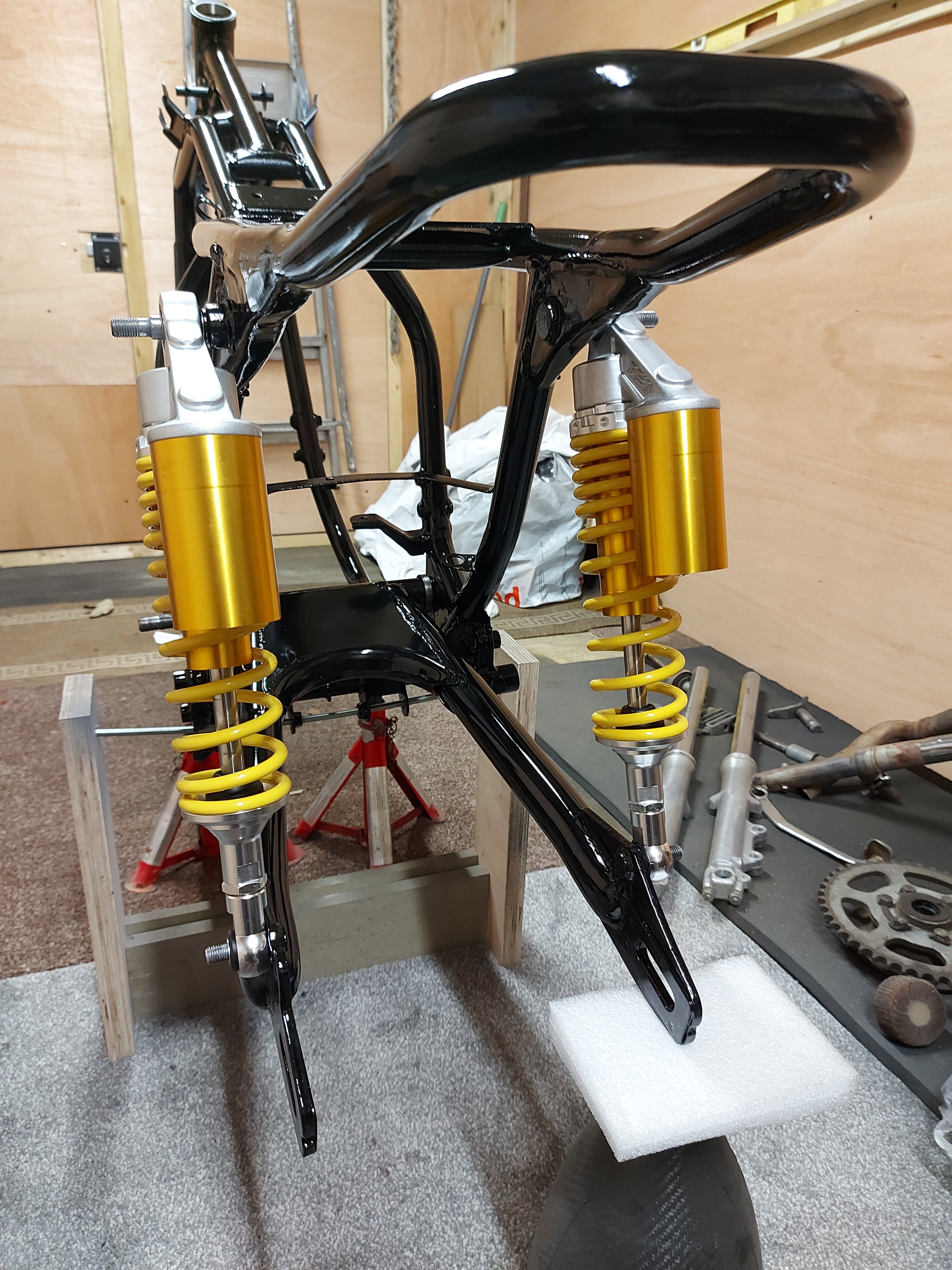

Got a little progress this week, got the brake rod and torque arm done, nice stainless adjusters instead of the rusty and seized old ones.
Got the shocks fastened up with thick stainless washers.
And rebuilt and painted the forks, loosely fitted while I decide on oil weight and levels.
Hoping to get the wheels painted this week so I can get it back on its wheels over the holidays.

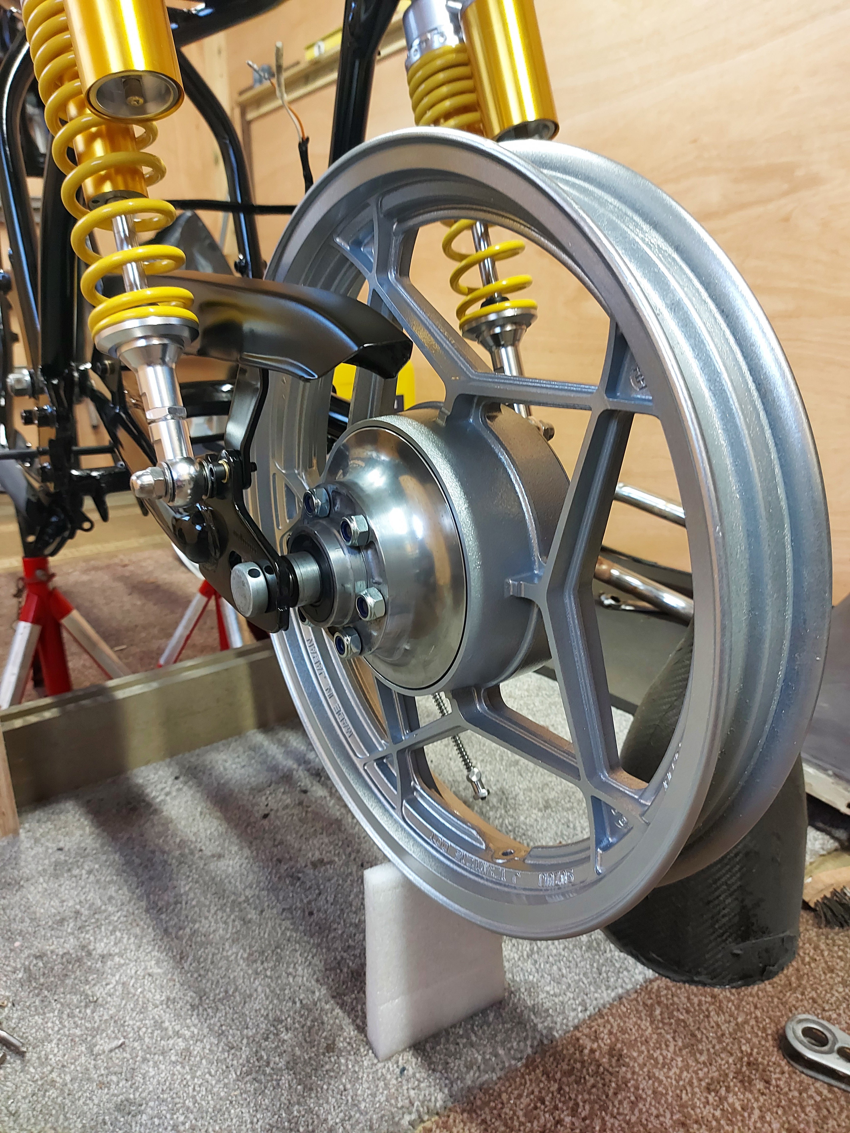

Bit more today, got the wheels prepped and painted, went with a glittery silver to contrast with the black, and cut down the chain guard as the shape didn't follow the chain run around the rear sprocket, also trimmed the front of it by around 3".
Now it's fitted you can see why it has the captive spacer on the top shock mount, it's quite close to the shock bottom.

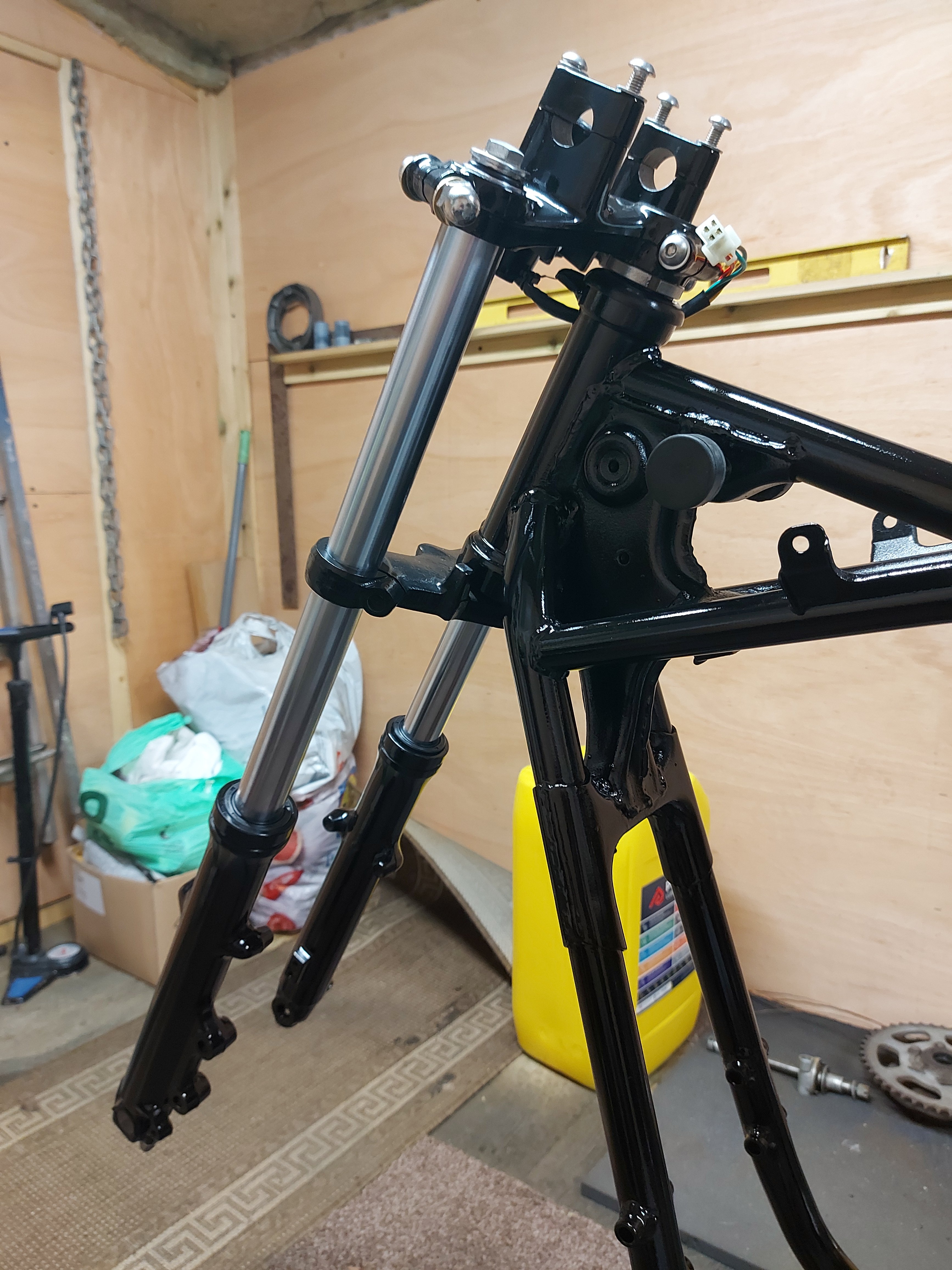

Forks are back in, new bushes, seals and dust covers, 10wt oil.
Just need disc bolts and tires and it's a roller again.
Did a quick mock up to make sure it looks like I want it to.
I reckon it's a goer.
