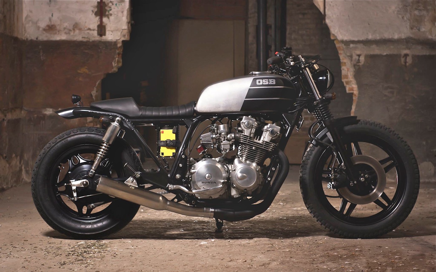

I appreciate the information that you all have put out there and look forward to this build. I will post pics throughout the process which may take time as funds are available so be patient. I am attaching a pic of my bike the day I picked it up and my inspiration Thanks

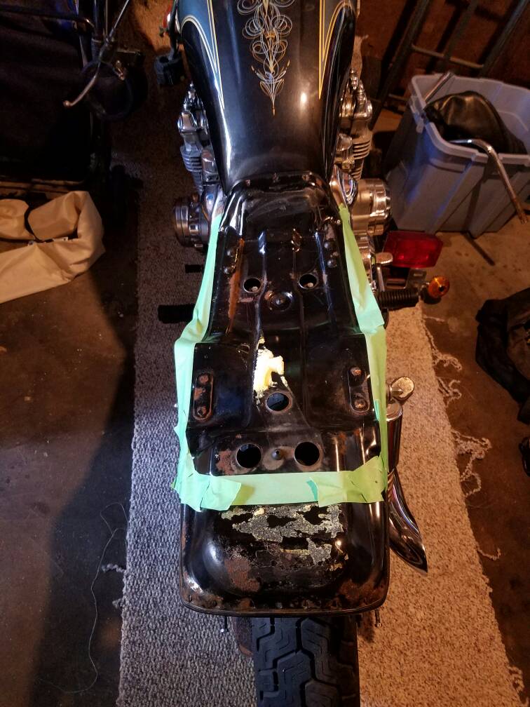

So after the first weekend... new drag bars, grips, & mirrors on order. Rear end stripped and seat shaping has begun (can't afford new right now so I'm working with what I have)

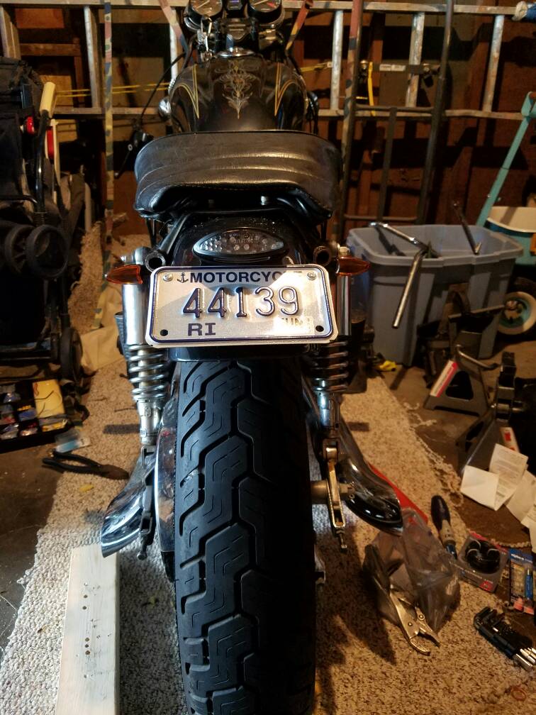

Decided to use the old leather than re-upholster the seat. I slimmed down the seat pan and screwed the old material underneath. Got led turn signals mounted on new brackets and tail light mounted to the stock fender which I repositioned to clean it up a bit. Electrical wired up (had to get electronic blinker relay for leds) now waiting for the front end parts to arrive.

I put the drag bars, mirror, grips on, re-assembled the controls and she feels/looks great. Ill post a pic later (at work right now) but I was wondering about the rear suspension. I feel like it sits low in the rear. I know the cb750 "c" was the cruiser style. I have the manual and can replace the stock suspension however I feel like they are too short for the look I'm going for. can someone tell me how much getting longer springs will affect the bike, handling etc. even just to raise it up 1-2"?
Hi Mike, For a C model I think the stance looks great, meaty rear tyre, shortened seat and straight bars are a 'look' in it's own right.
I have no direct experience in raising rear suspension and how it can affect steering handling, but altering the fork angle can quicken the steering or make it twitchy and potentially dangerous. However, on the basis of suck it n see, before shelling out your hard earned $$$ on longer shocks,maybe a cheap pair of shock extenders might allow you to feel the affect in reality?

I appreciate your input. I agree after cleaning up the rear end it looks pretty good. After looking at other bikes I think it's more a lower font end than a raised rear. I'm thinking about just getting new rear suspension but not any longer. I've read about the steering issues with altering suspension and angles. I'm not trying to open a can of worms or add any issues just for cosmetics.

How about sliding the fork legs down the yokes 1" or two and see what happens? You can always correct it if it causes issues?
