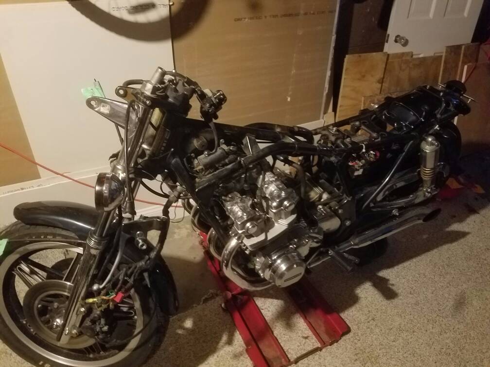

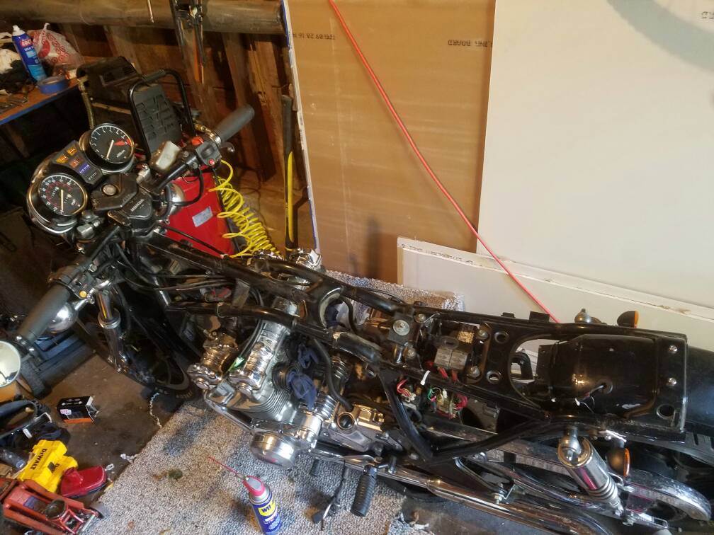

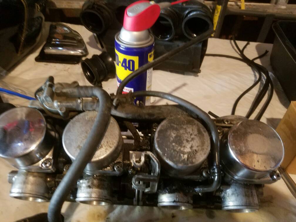

And so it begins... my winter project, complete rebuild. Today tank removed, carbs pulled, and carb disassembly has begun. I'm a noob so well see how this goes.

Have fun with the carbs - they aren't nearly as hard as they initially look. There is a PDF that comes up on the first page of google search all about "CB750C carb rebuild" that you will want to follow if you haven't already.

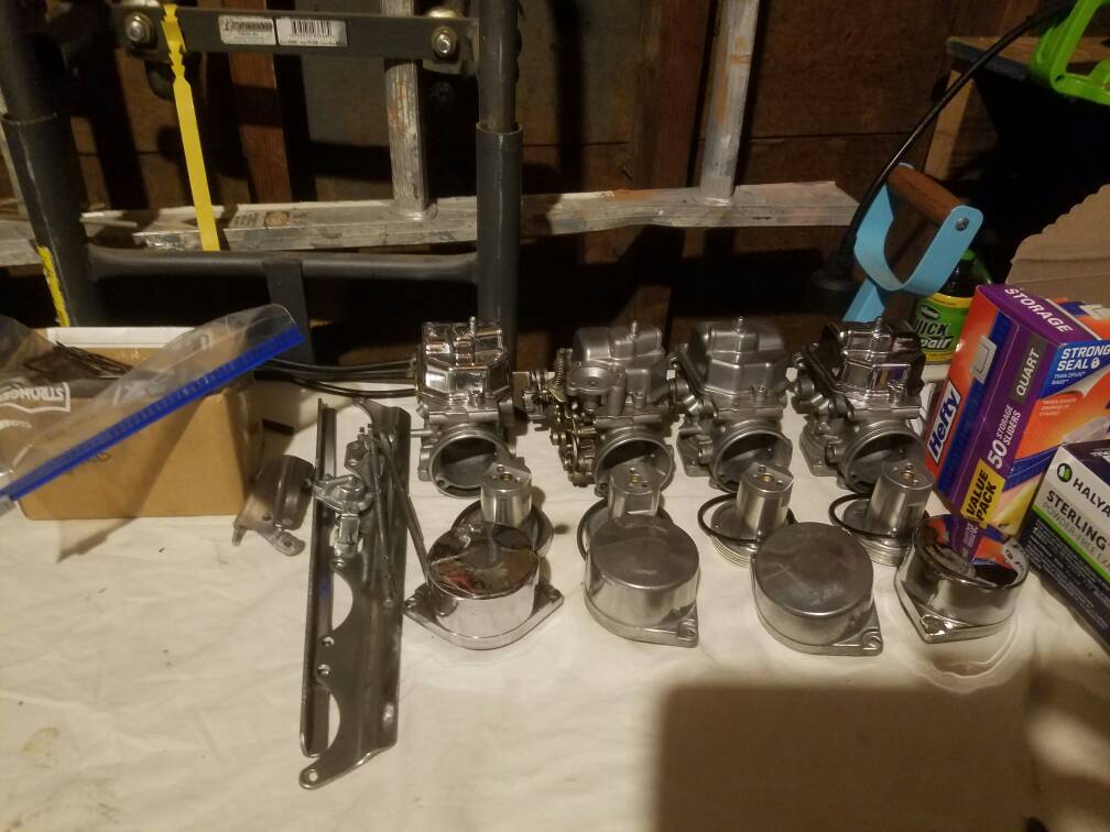

Thanks Mork, I appreciate the encouragement, I actually printed that pdf a few days ago and went by that for my disassembly. Now I'm going to soak and clean everything then put it all back together once I get my kits in the mail. Any recommendations for chemicals to clean with, I picked up a spray carb cleaner but what should I soak them in? I've read pinesol anyone tried it? Mork I've been following your build and it's coming along nicely, you've got a sweet looking ride that's along the lines of what I'm going for.

I use Pinesol on almost all my aluminum parts, usually an overnight soak, hit with a toothbrush, rinse and repeat with a shorter soak the second time around.
I've never used pine sol...I've always used simple green dilluted in an ultra sonic cleaner with much success. Cook them a bit, wash with hot water, Then I spray out passages with carb spray, then blast with air to dry and blow any that didn't come off with the spray. I also hit the vacuum piston and chamber with brasso to polish it super smooth. Good luck!

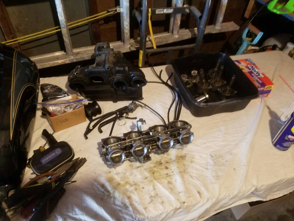

Good progress this weekend, carbs cleaned and front end disassembled. Wish my carb kits were here so I could put them back together. Hopefully next weekend.

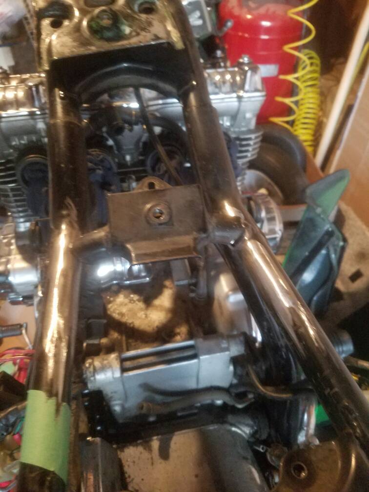

Also picked up an 81 750f for $100. Mocked up the tank. Anyone know if the swing arm will bolt up easily? I'd like to swap for the disc rear. I know the master cylinder and such will need brackets.

I hear you on the carb stuff. It can be a little overwhelming. As far as the swingarm it should just drop right in. I don't thing there should be any issues.

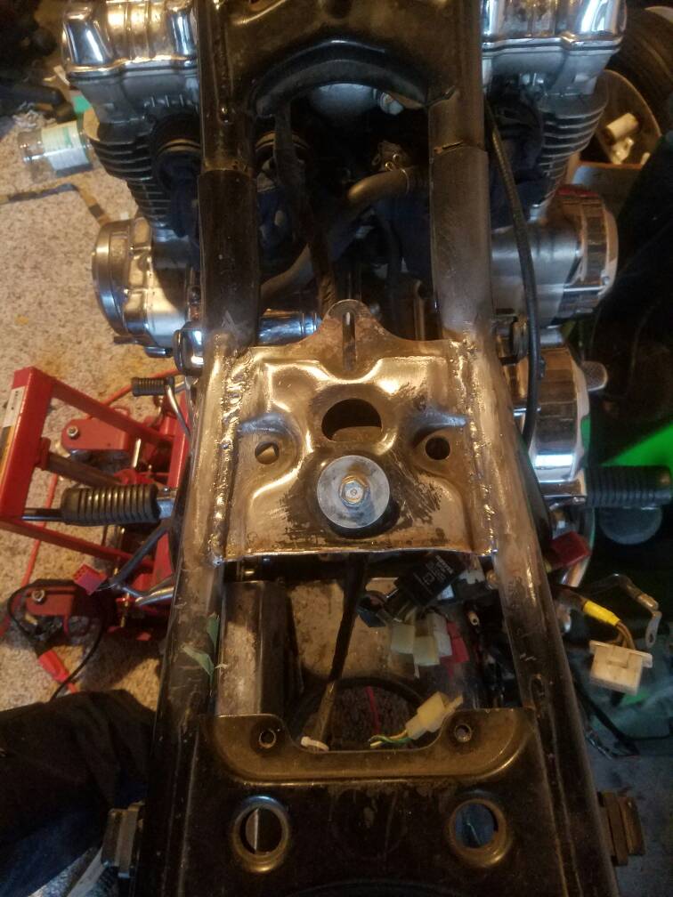

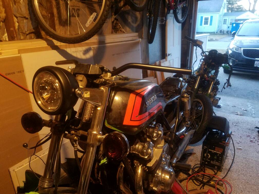

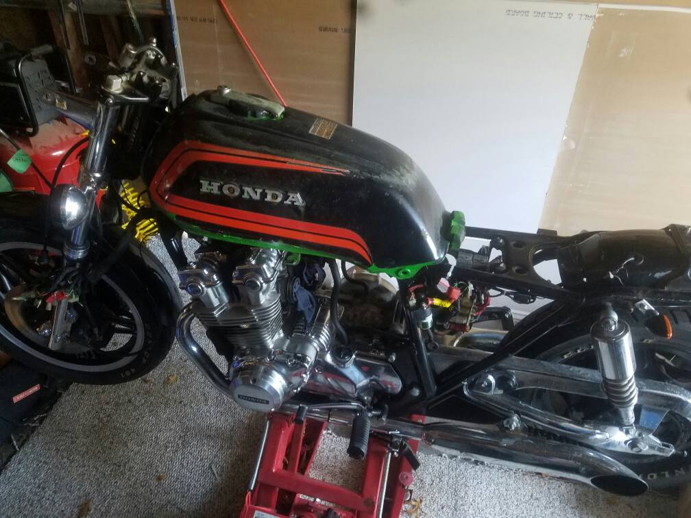

Latest update got the f tank mounting bracket fit up and welded. She fits like a glove. Threw the light and bars on quick just to get a feel for it. The other bike is my goal for the rear end take note of my sweet paint skills. Ignore my hideous welds.
