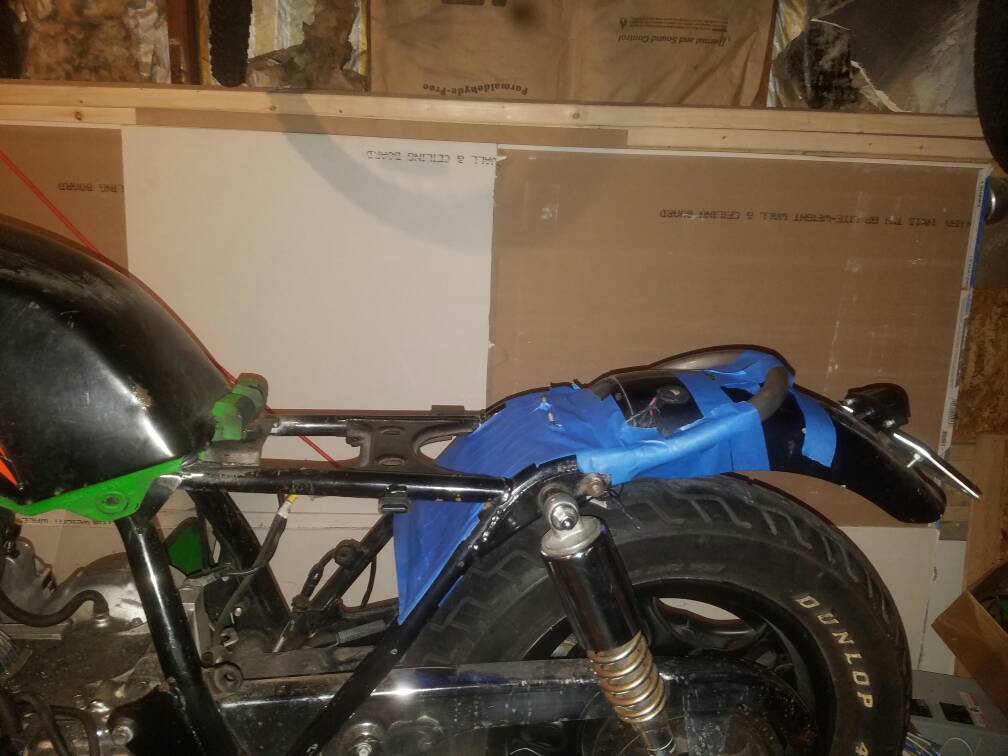

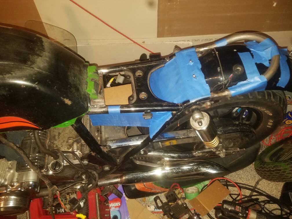

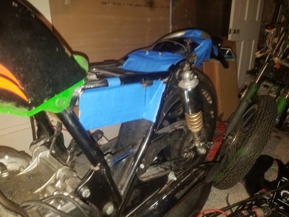

I spent many hours brainstorming and a couple hours with cardboard and tape. Still not loving what I came up with so it may change. I'm open to suggestions.

Any chance you wouldn't mind throwing a tape on your rear axle and letting me know the length?
Hey man sorry for the late reply. I measured it and then my furnace shit on me so I forgot to post the dimensions for you.
The overall length is 13" to the outside of the axle. Let me know if you need anything else.
