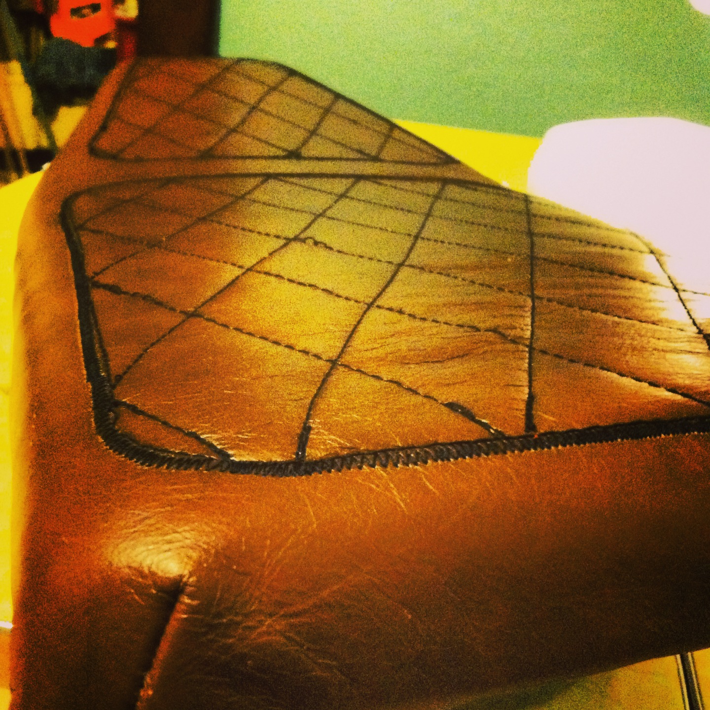

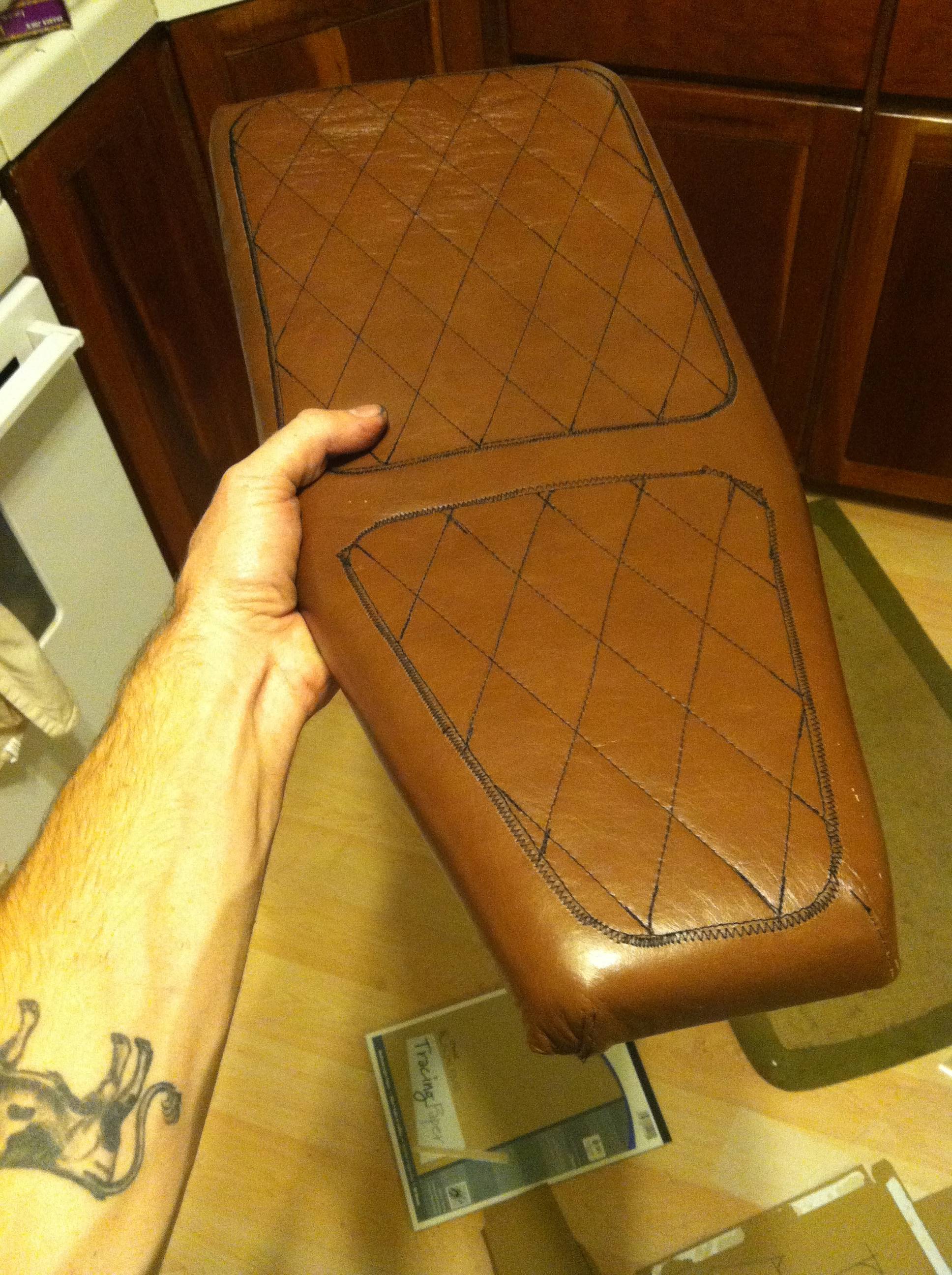

Made the seat last night. It's... okay. I don't know the first thing about sewing beside's how to set up a machine and run straight lines, so it was kind of baptism by fire. I didn't have any quilt batting to go underneath and used material from an old torn up sweatshirt instead, so the diamonds didn't really 'puff' up or anything.
The end result is definitely not as nice looking as I was hoping for... but considering that it's function is to be sat on, I guess it'll do it's job nicely.
For the leather, I spotted an old couch with a broken frame at a thrift store and asked the manager if I could salvage the leather for a few bucks. He said if no one had purchased the couch by the end of the week, the leather was all mine. So by Friday I had a couple bags of nice leather for $2 total. Not a bad trick.
It's not letting me post pictures right now, so I'll try later.
