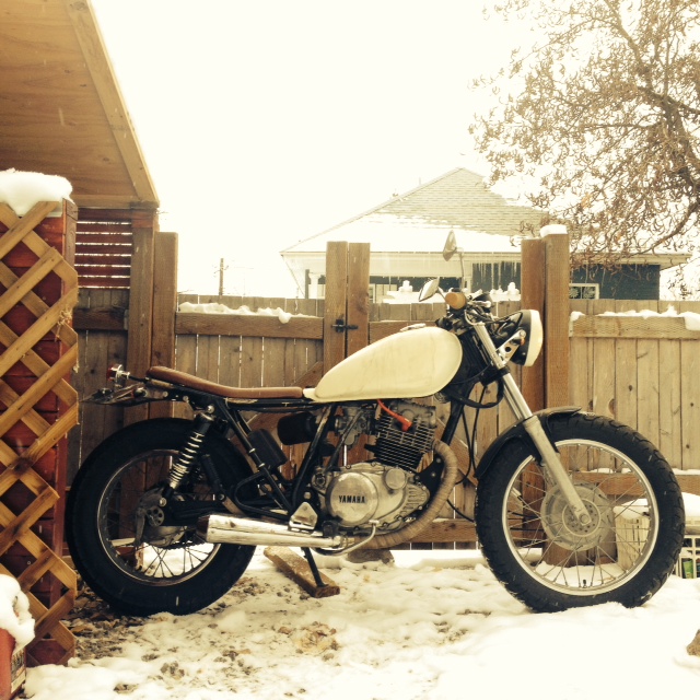

Little Pete as he sits today... quite unhappy about the weather.

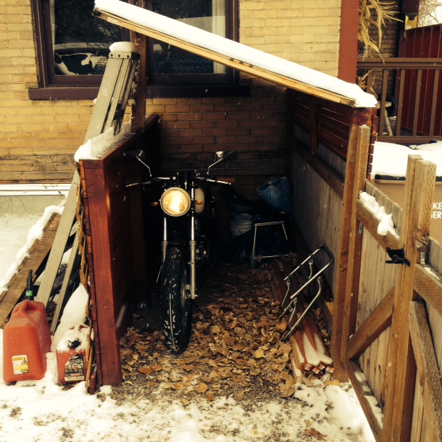

Also, a few shots of my compact "shop space"...

I like your expandable roof! =) Seriously good work so far, loving that seat work you did by the way, it's an amazing first go.
