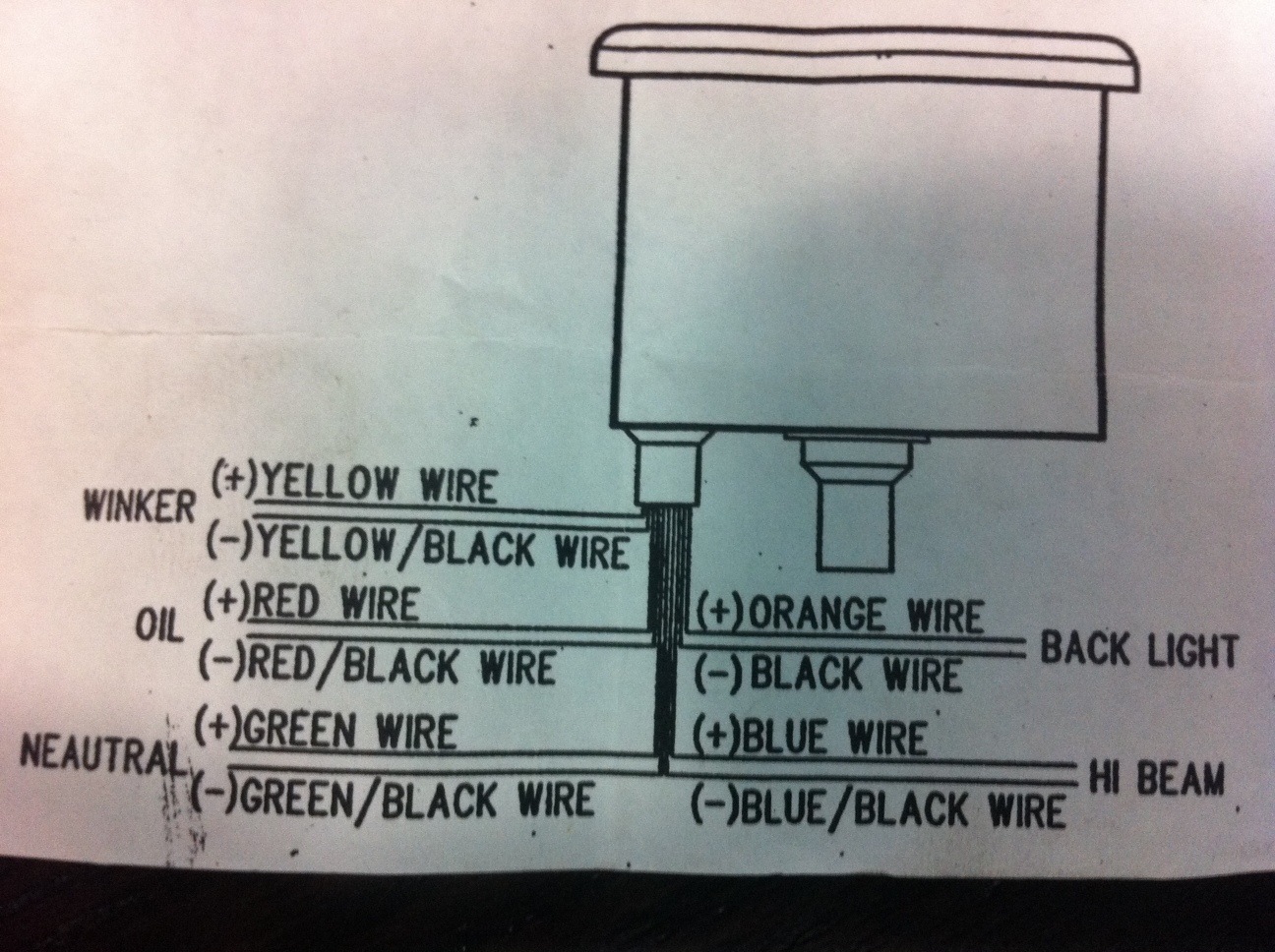

I know this is an old post but I'm working on an sr250 and I'm trying to figure out how to install this same speedo on mine. Can't seem to figure it out. Any help would be great
Need more info on your difficulties. Connecting speedo cable? Constructing mounting plate? Connecting electrical?

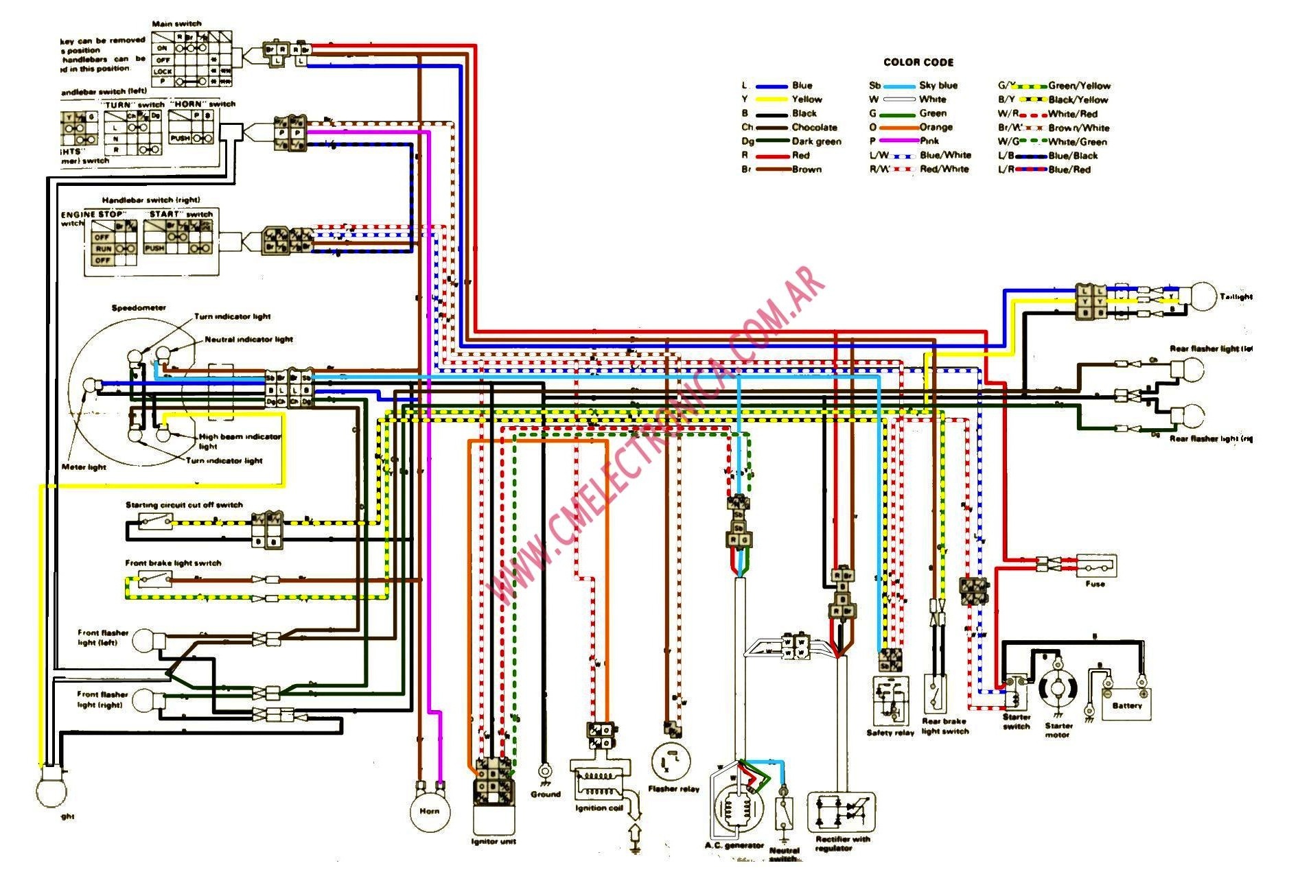

Got your PM- sounds like it's the wiring for the indicator lights you're trying to figure out? I'll try to answer it here.
Are you still using your stock wiring harness?
The speedo has five lights (four indicators and a backlight), each with two wires, one (+) and one (-). All of the (+) need to go to the right wires on the harness, and all of the (-) go to ground expect for the neutral light's (-)
One of those indicators is for oil, but I used it as a left turn indicator since the sr250 doesn't have an oil sensor (typically you'd have one indicator showing that either of your signals is on).
You need a wiring diagram to figure out what wires on the harness you'll need to run to.
High-beam indicator
Blue -> Yellow wire on the headlight
Blue/Blk -> Grnd
Neutral Light
Green -> Lt Brown
Green/Blk -> Lt Blue (sometimes it's hard to tell the difference between blue and lt blue on the 250... watch out)
Left Indicator (repurposed oil light)
Red -> Drk Brown
Reb/Blk -> Grnd
Right Indicator
Yellow -> Green
Yellow/Blk -> Grnd
Backlight
Pink (or orange) -> Blue
Blk -> Grnd
This is how to wire if for the oil light to act as a left turn indicator. If you'd rather only use the one general turn indicator light, then run the yellow wire from the speedo to both the green and dark brown wires, with yellow/blk still going to ground. Tape off the red wires from the speedo. (Your oil light would be useless this way.)
Hope that helps. Here's the diagrams for both if you'd like to make sense of it for yerself.
Well fuck... that part is bullshit. You would definitely need diodes on those wires to keep the two circuits from crossing. LEDs don't take much juice, so I think just small cheapo diodes would do the trick... but that's about the extent of my knowledge with that shit.
Or you can just use the oil light as a left turn indicator light and not have to worry about all that. Up to you.
What is the light blue/sky blue wire? Whenever I touch it to the ground wire "black" it powers the starter. Also whenever I touch it to any of the other wires it powers whatever that wire goes to.
From the mini speedo I have all the ground wires connected together and plugged into the black ground wire from the harness.
If you look at the wiring diagram, the lt blue wire is essentially a negative lead that runs through the neutral switch before grounding... and is also tied into the safety relay (as is the red/wht wire from the starter solenoid).
I'm not positive why touching the lt blue wire to the ground would trip the starter switch, but I will encourage you to not test out what happens when you touch different wires together if you're not sure if they should or not... that's a great way to short something out and fry it. I find this shit pretty difficult to grasp, but spending some quality time getting familiar with your wiring diagram will help you to make some sense of things. Helps me a lot at least.
