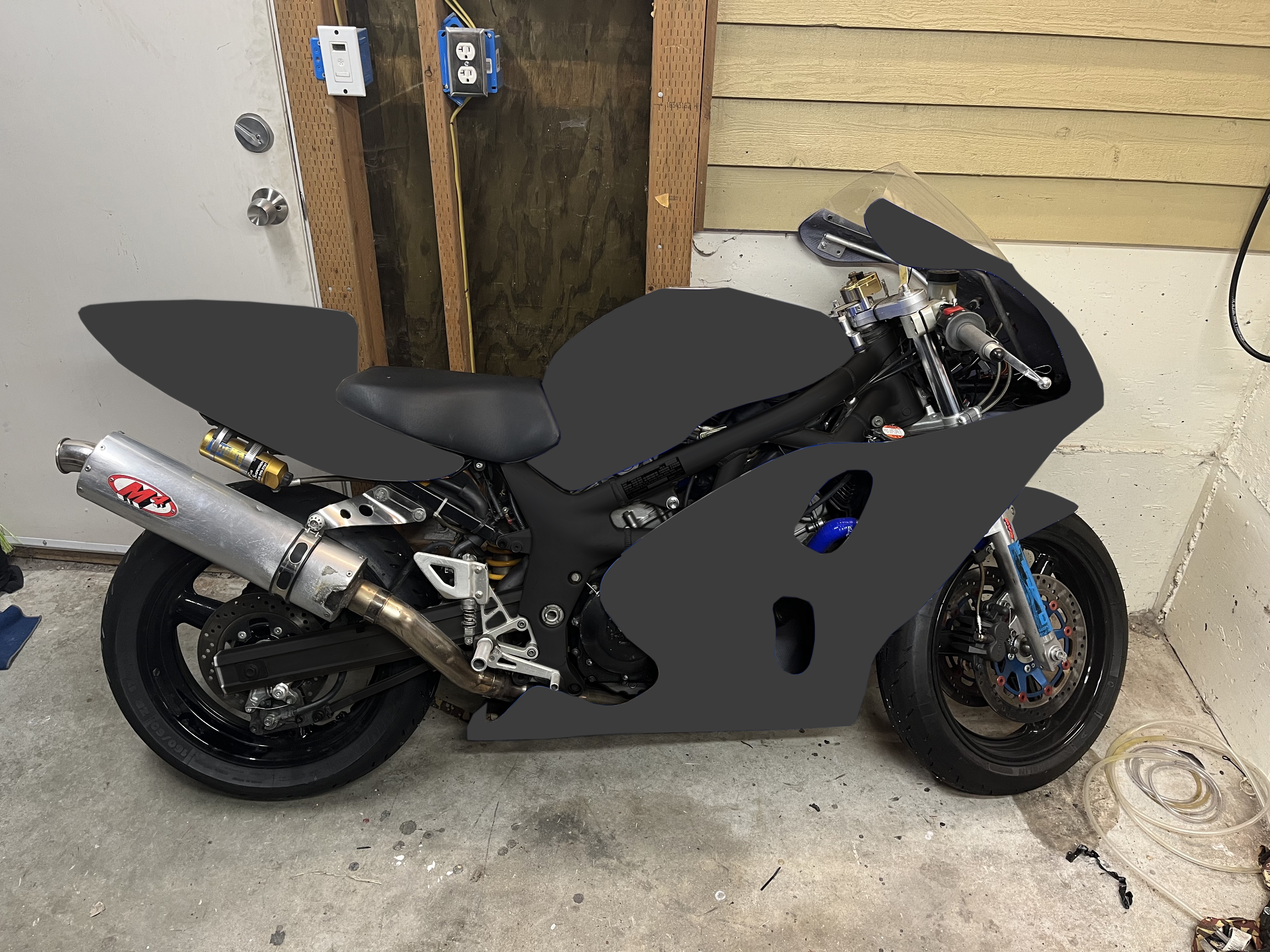

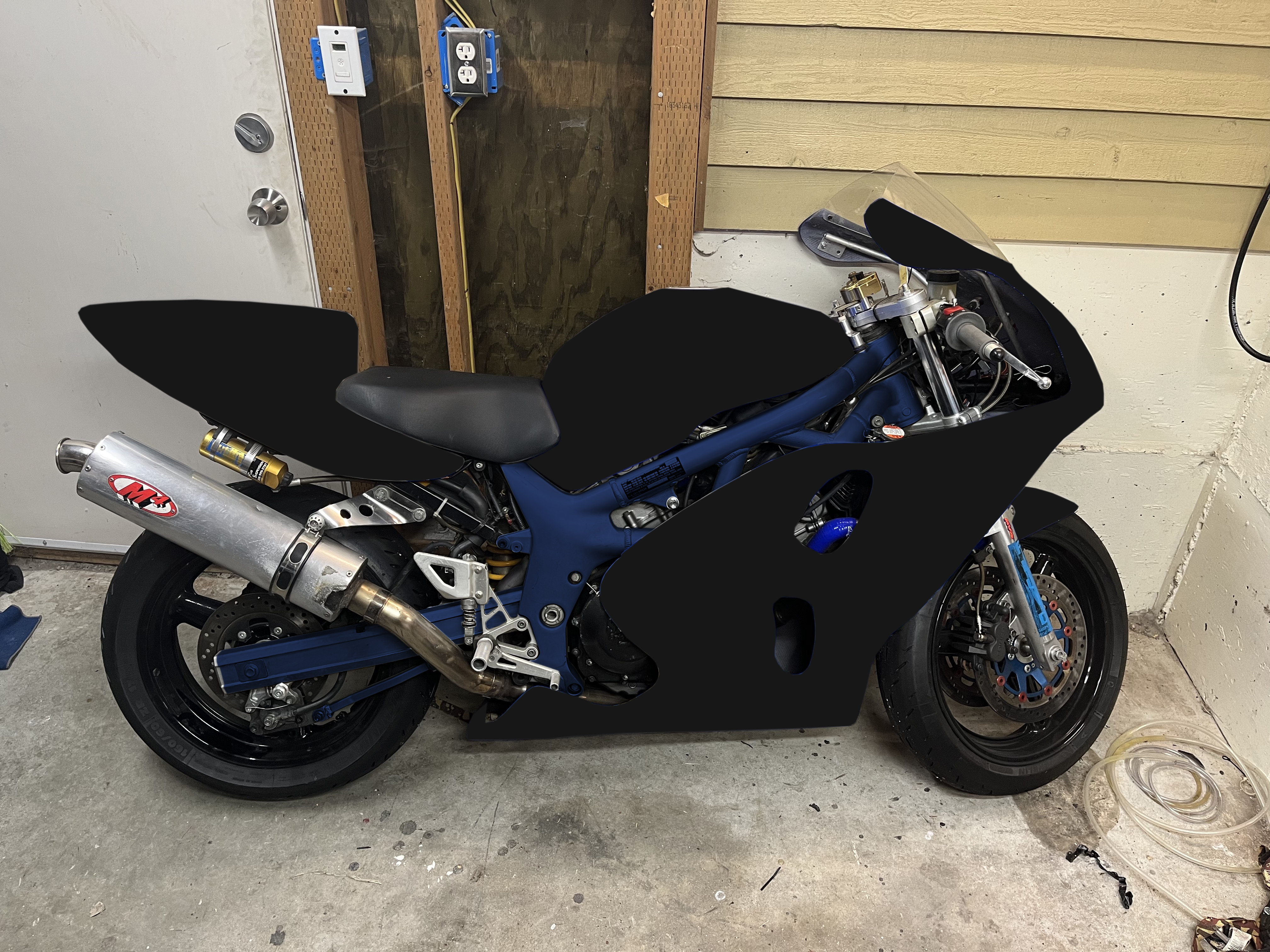

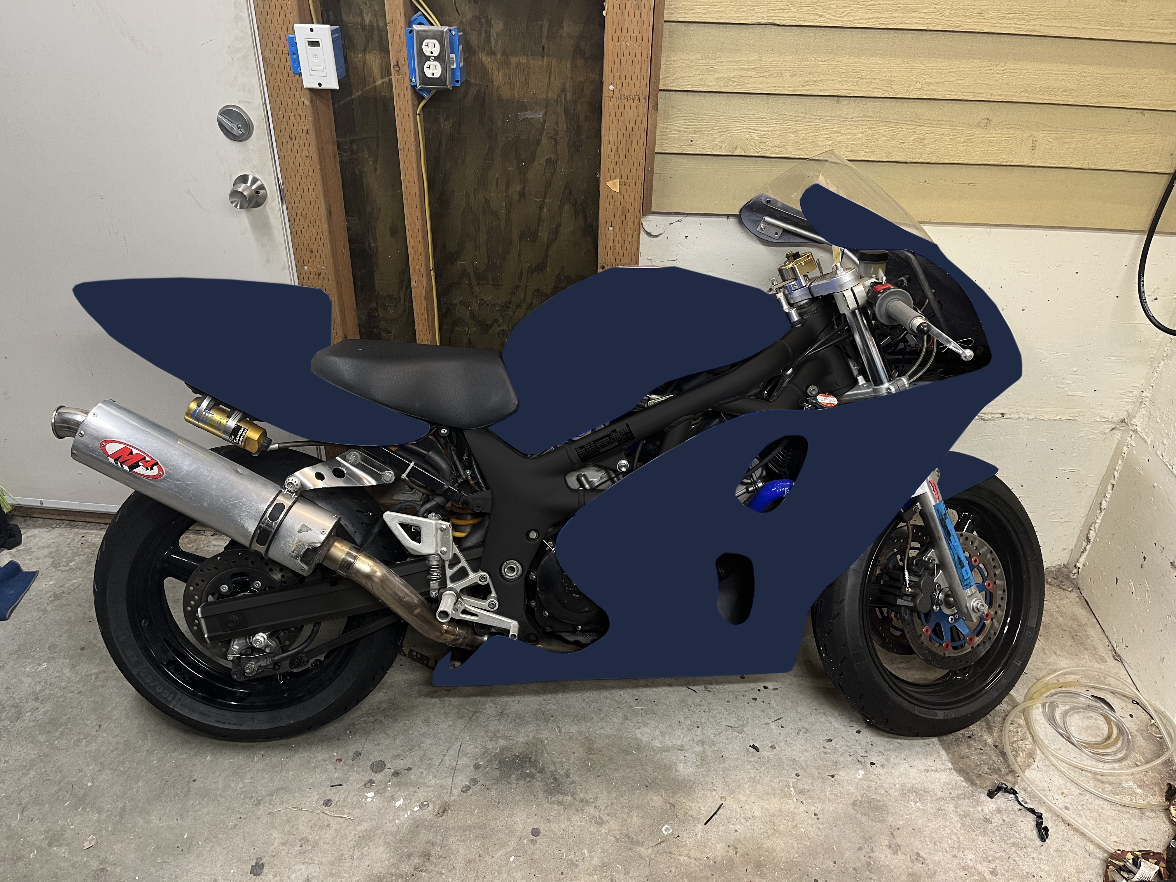

heres a couple quick color way mockups.

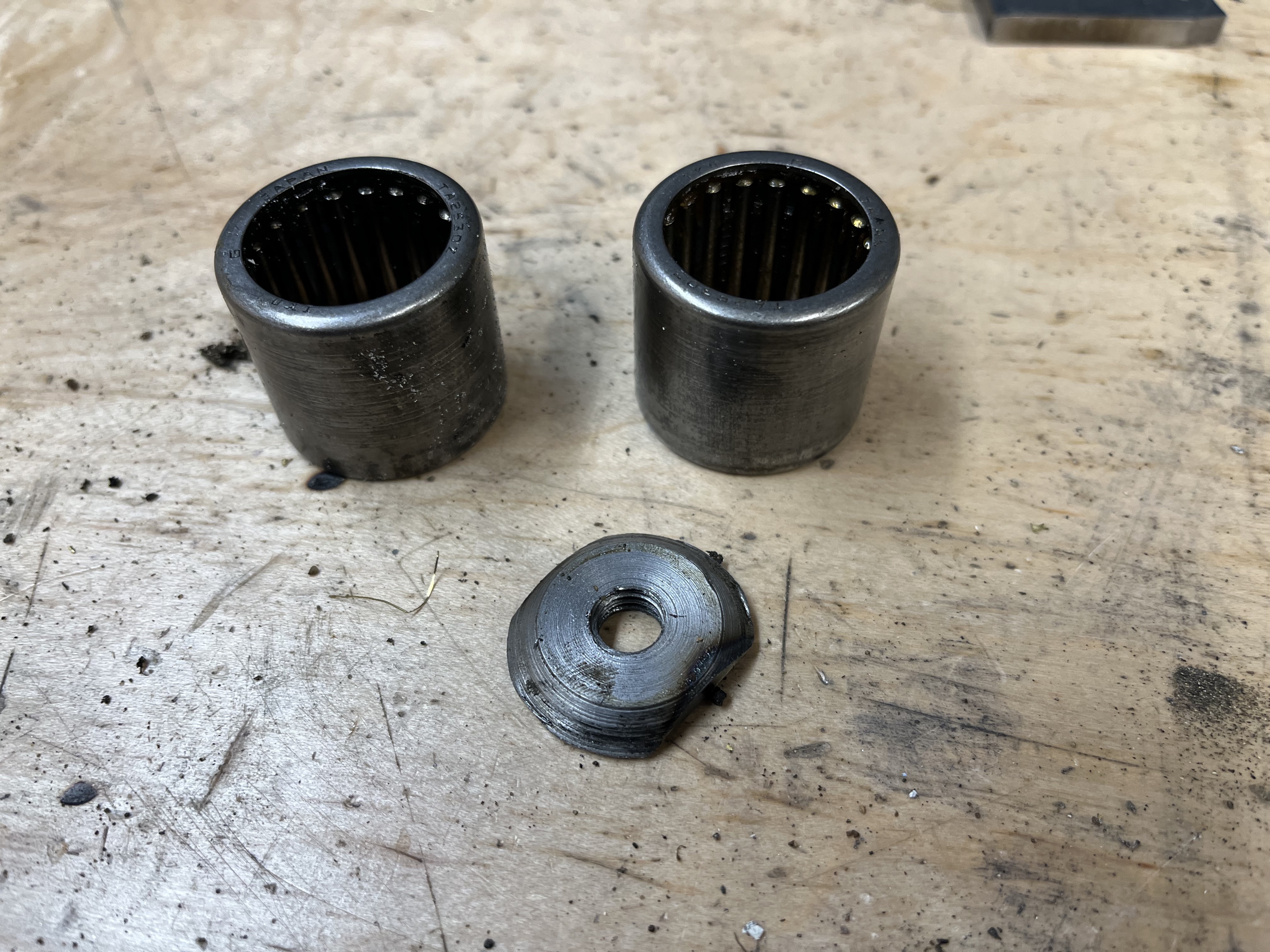

I needed to remove the bearings in the swingarm for powdercoat. The bearings are in good shape and high quality Koyo bearings so I wanted to try and pull them out with out damaging them. I made this thick threaded washer with two flatted sides, pass the washer through the bearing, then reorient it on the back side of the bearing, screw in some all thread with some jam nuts and a socket and the bearings pulled out nice and easy, ill clean the bearings up and reuse them.

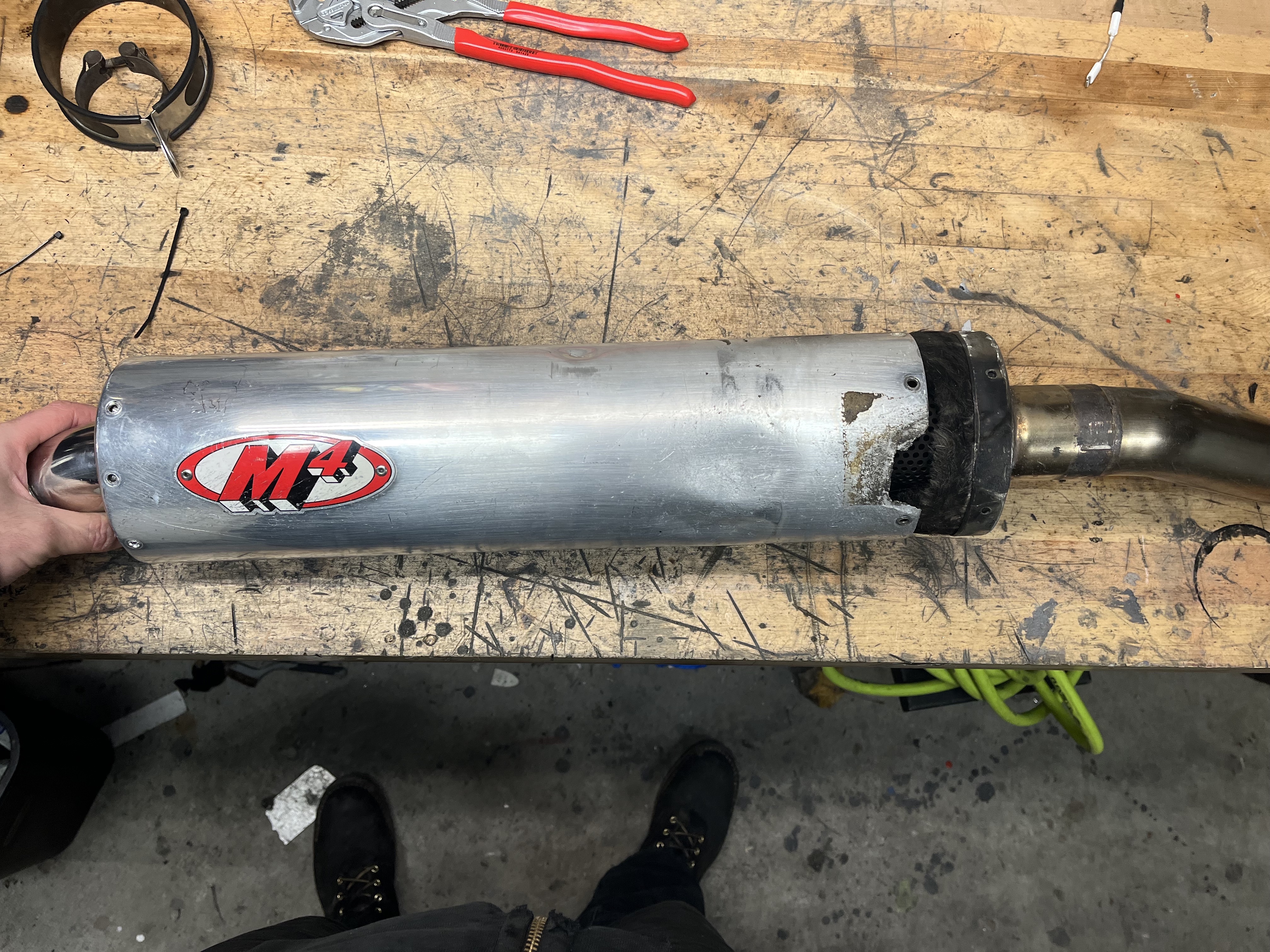

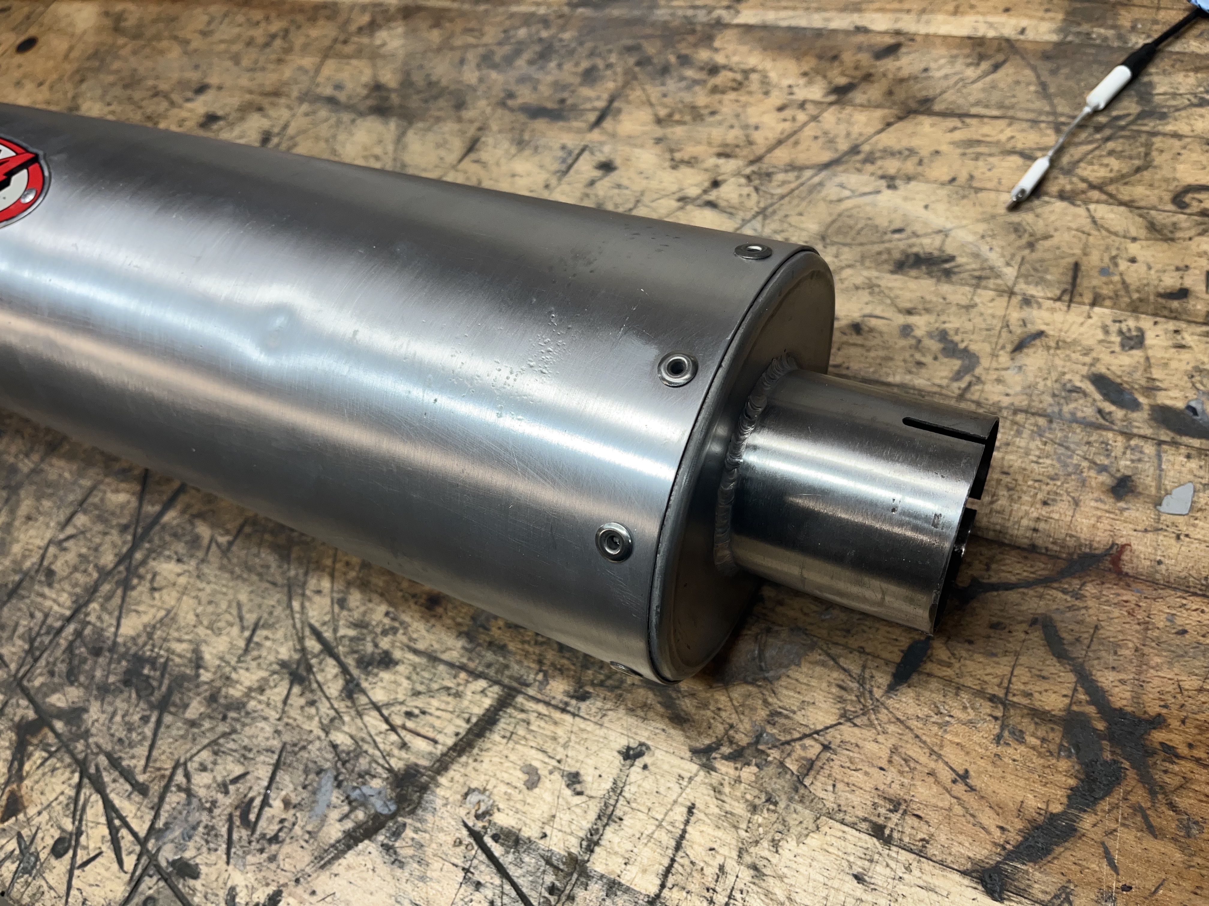

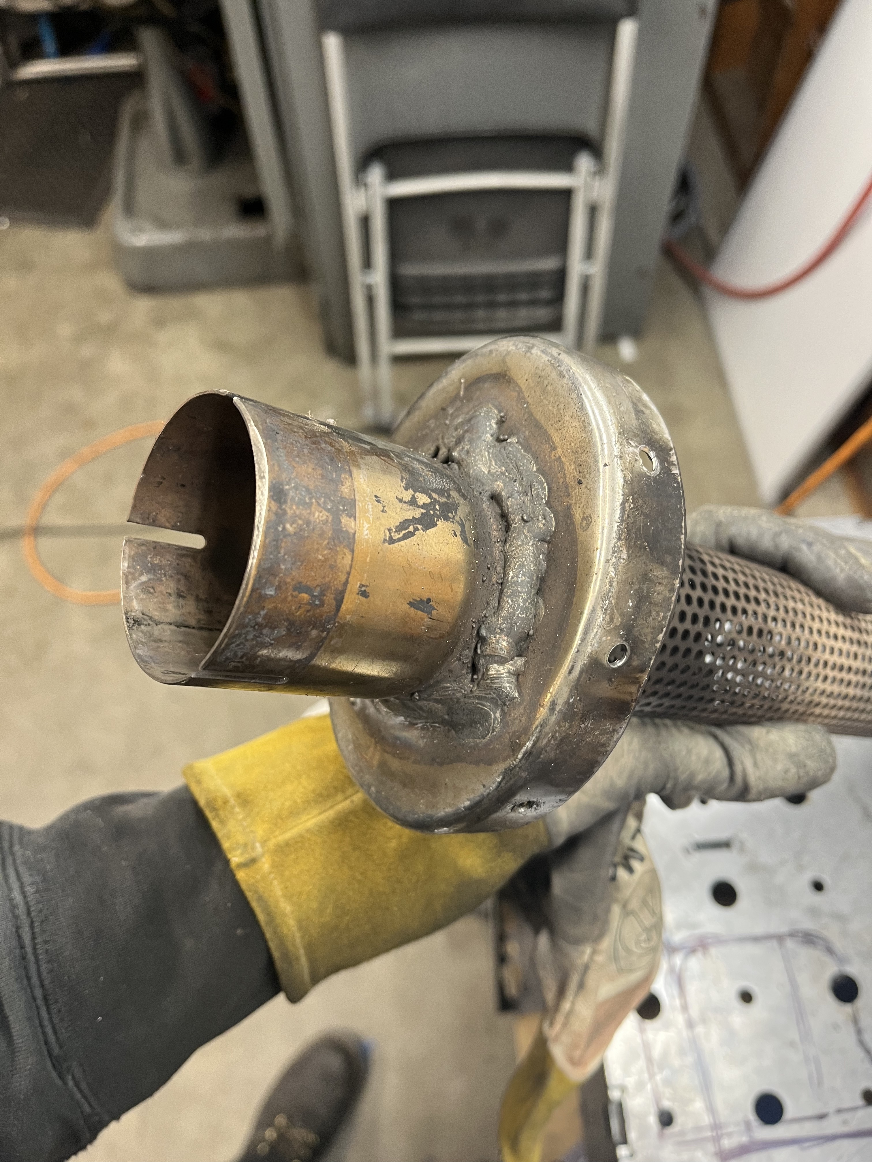

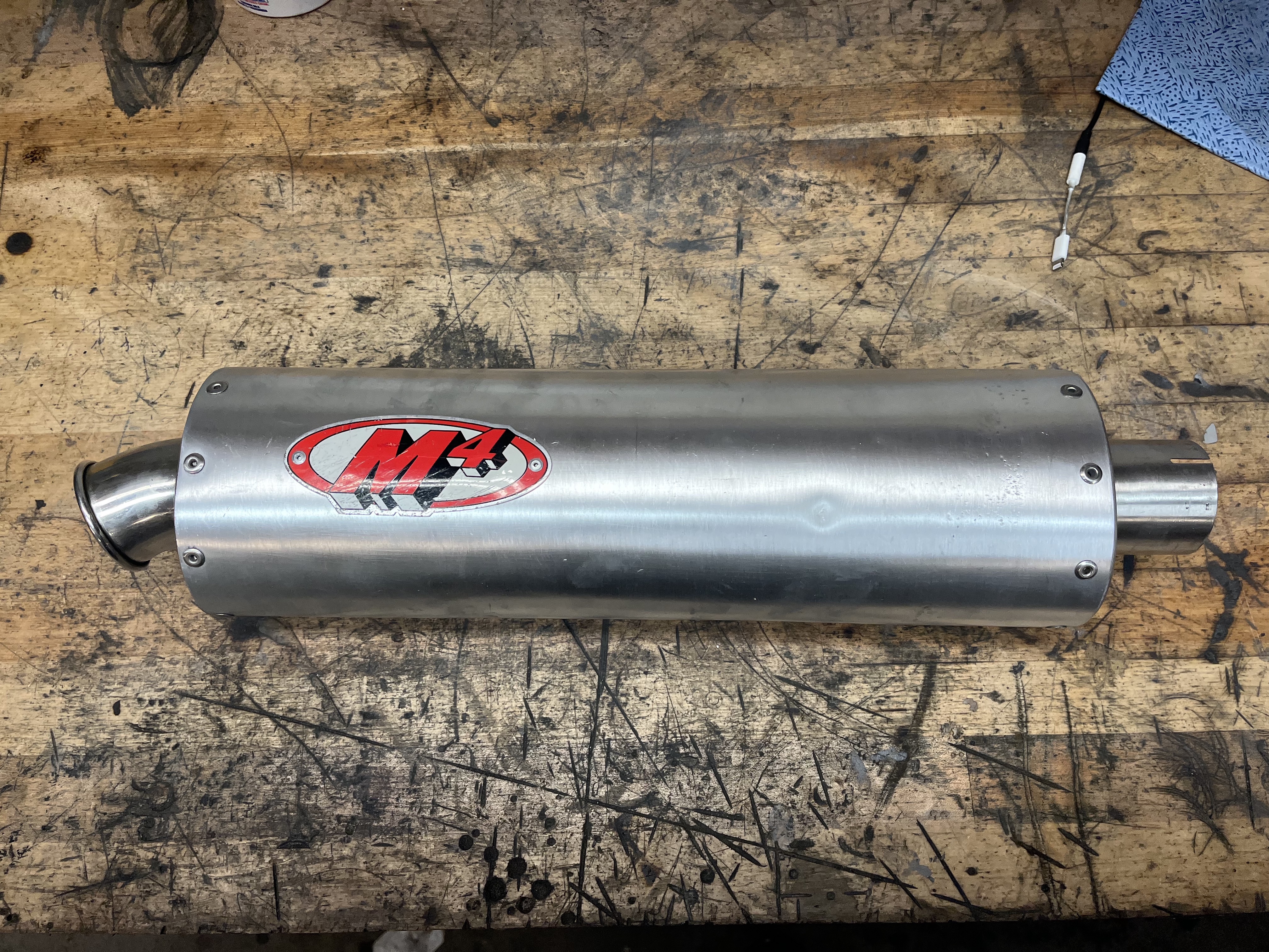

Rebuilt the M4 muffler. Hammered and dollied out the dents on the can. Fabricated a new end cap in stainless because i couldn't stand the crap welds from someones previous repair. packed with ceramic fiber matt and riveted it back together. I managed to knock it off the bench after I finished it to put a nice little dent in the can.... sigh.

I love to save money but needle roller bearings are so cheap, I just replace them. They are available online or at any bearing supply store.
OEM replacements were $100 plus shipping. There were two smaller ones for the shock linkage that I didn’t photo graph that have seals on the outside edge.

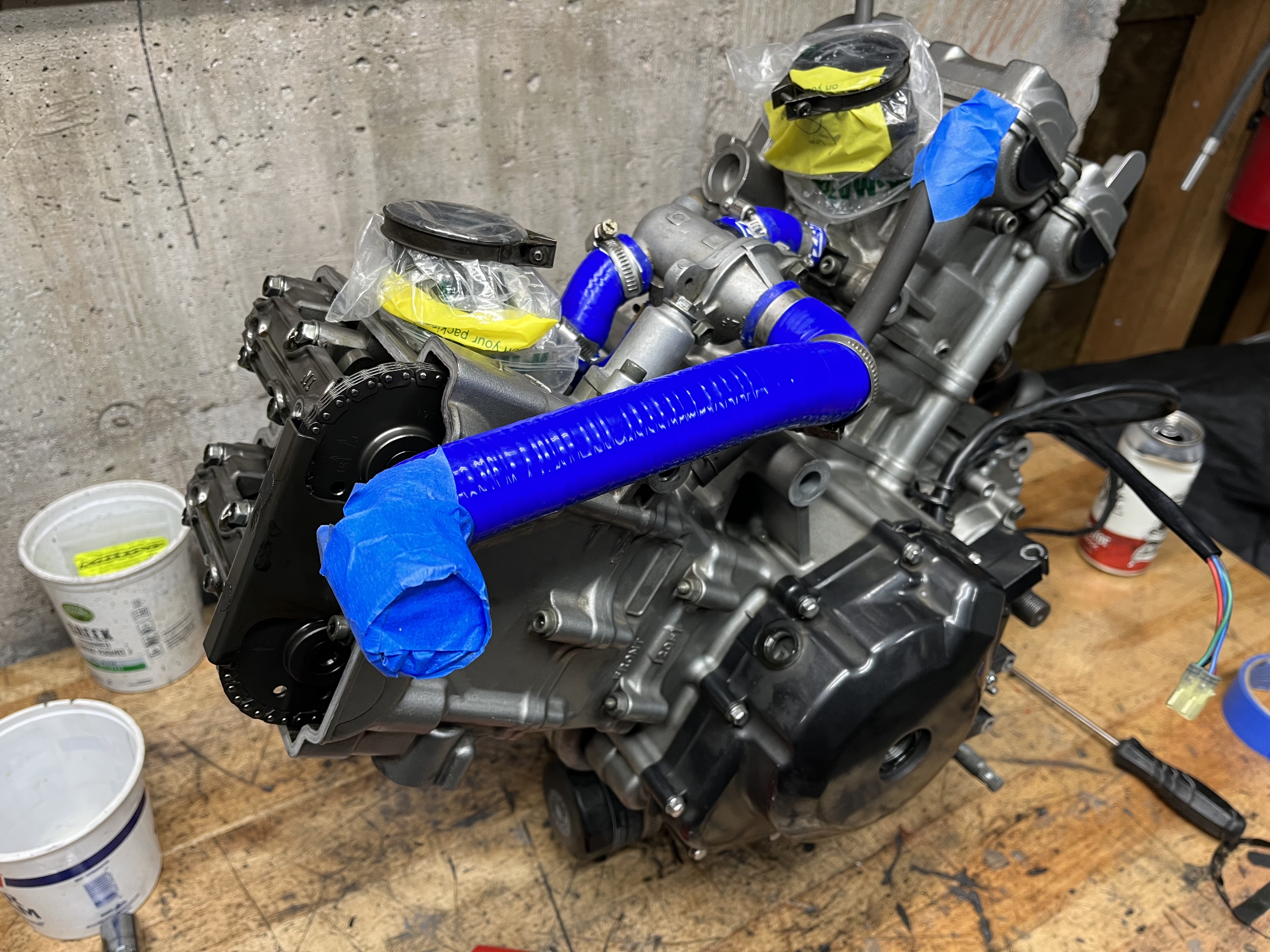

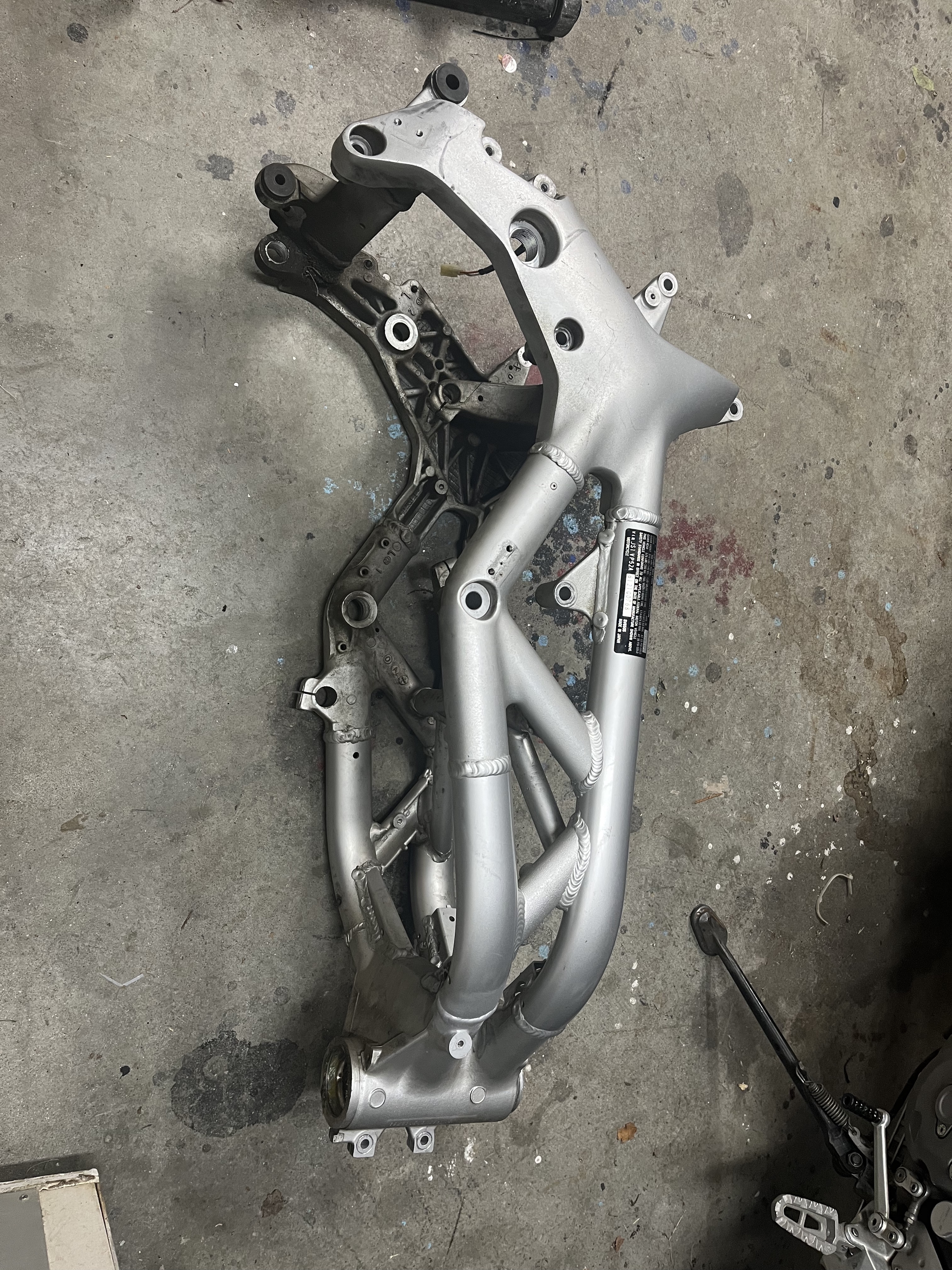

I ended up going with Prismatic Powders "Mystic Lava" on the frame. It has some red and green flake in it and pops in the sun, I'm happy with how it looks. The shock has been rebuilt with a stiffer spring. All the major systems are mostly installed. I'm to the point where i need to start on the custom harness - not my favorite part of any project. As a distraction from that I'm now toying with the idea of a custom sub-frame to move the seat a little higher rather than making a thicker seat.
