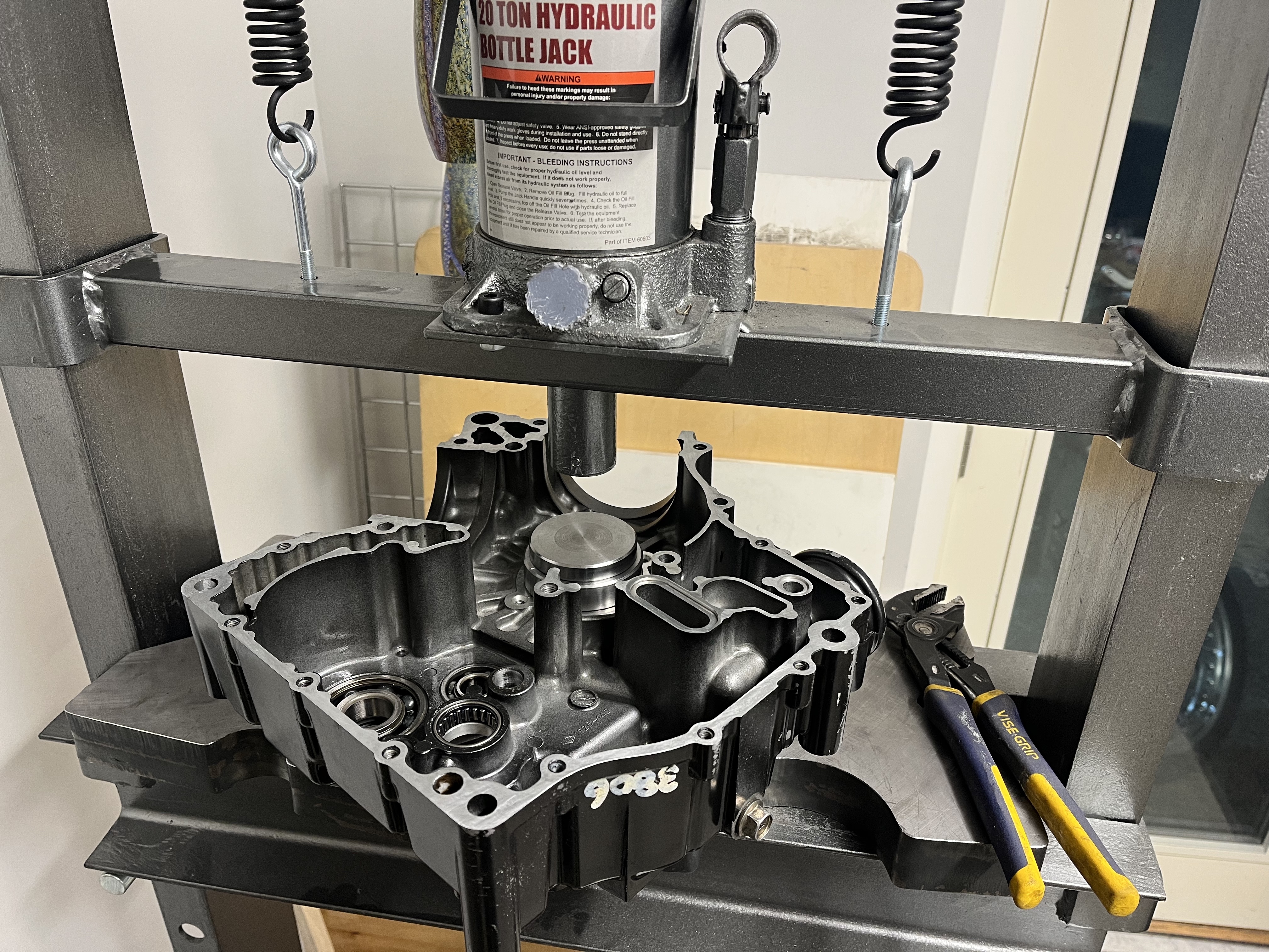

Got the crankcases assembled. The tool I made to install the bearings worked great.

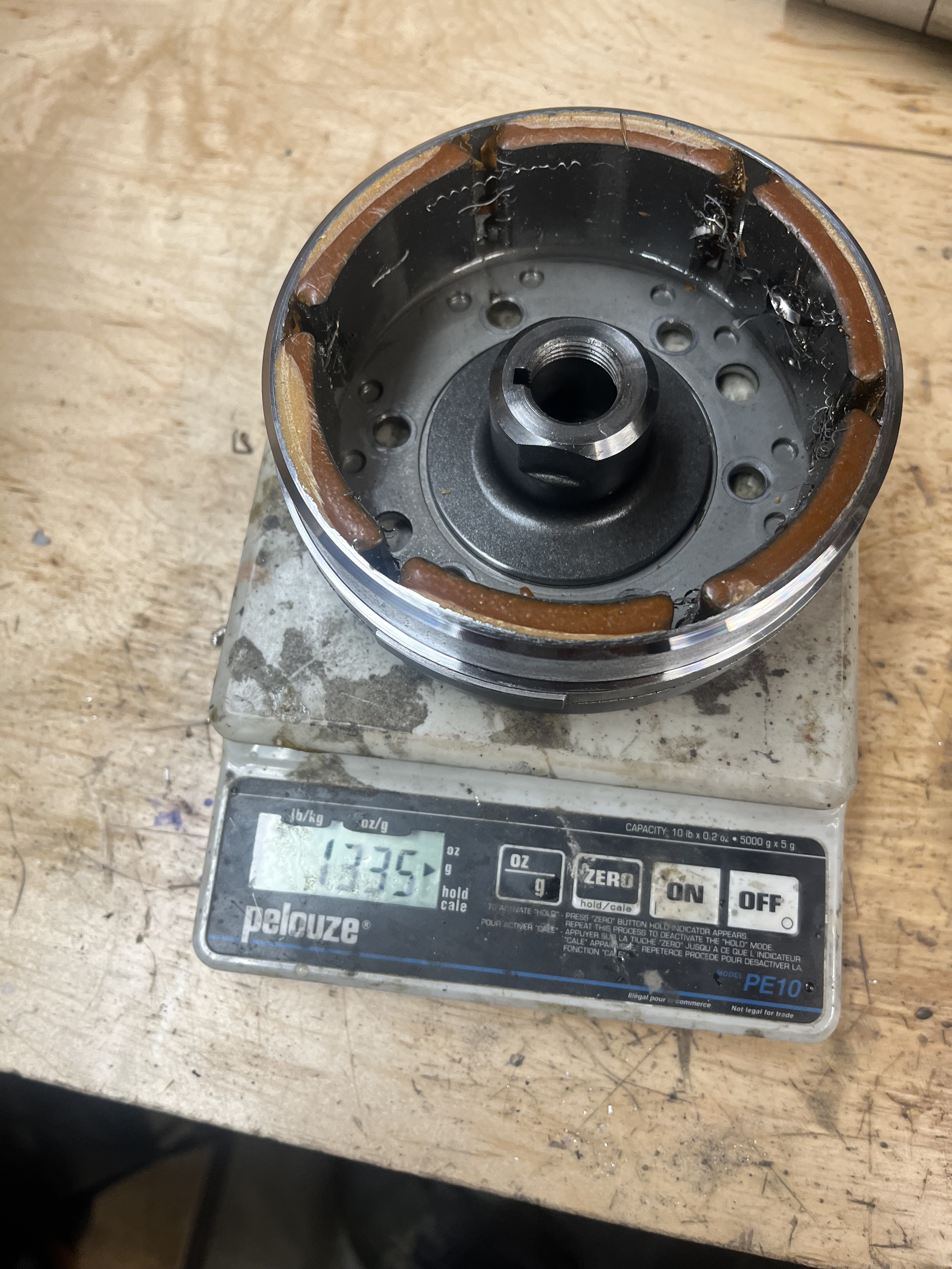

A common performance mod on these bikes is to lighten the starter clutch plate. I recently completed a control system retrofit onto an old CNC bridgeport and this is literally the first part to be made/modified on it. It came out ok, not totally happy with the tool finsih but not bad for the first try. This reduces rotational mass on the crank by 355g / 0.78lbs. check it out next to a stock one. I am also going to trim some fat off the generator rotor for about another 189g / 0.4lbs. all in this is about 1.2lbs off the crank!
rotor trimmed down.

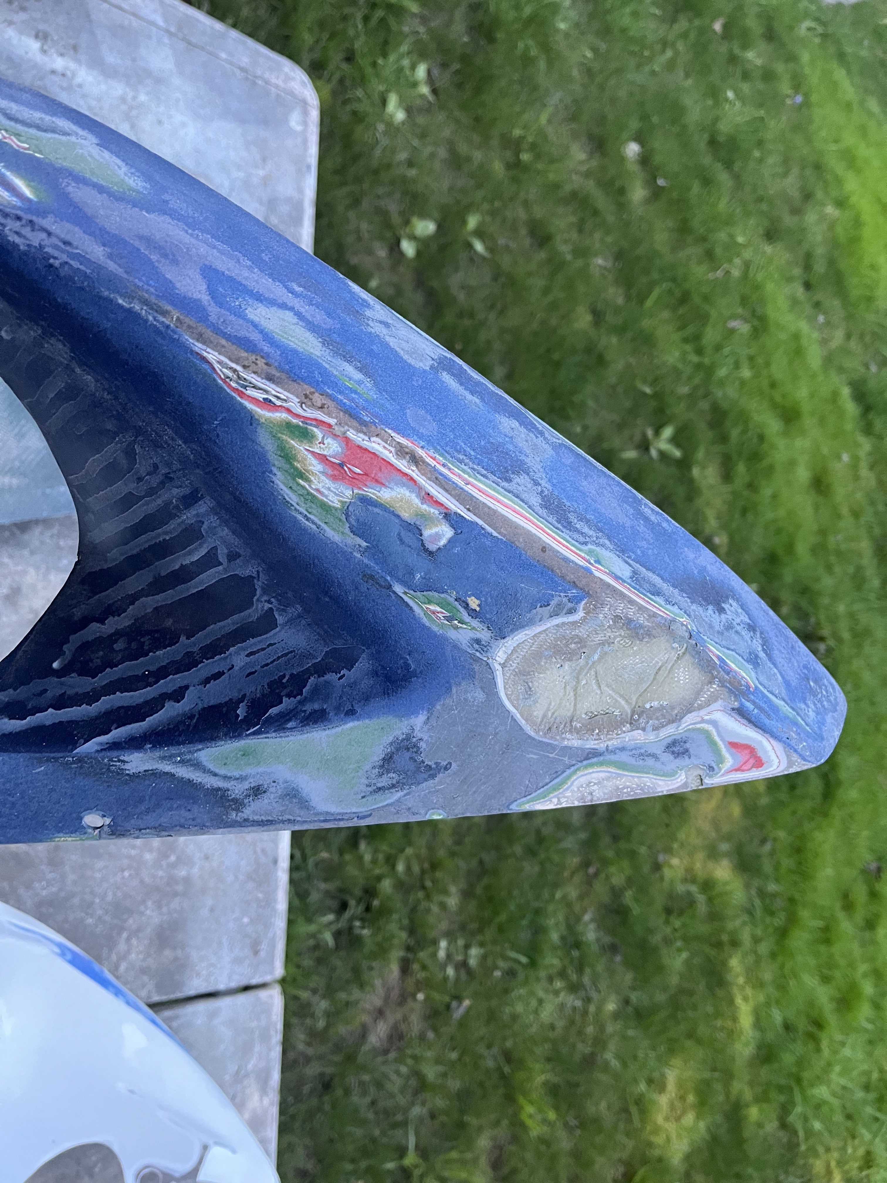

I got a second set of fairings that were in a bit better shape than my existing ones but they still needed a bunch of work - mostly fixing previous repairs. Sanding through the paint it seems like they've been painted a dozen times or more. They are mostly prepped at this point, all patches complete and new 1/4 turn fasteners. I striped the old paint job on the tank and started prepping that as well.

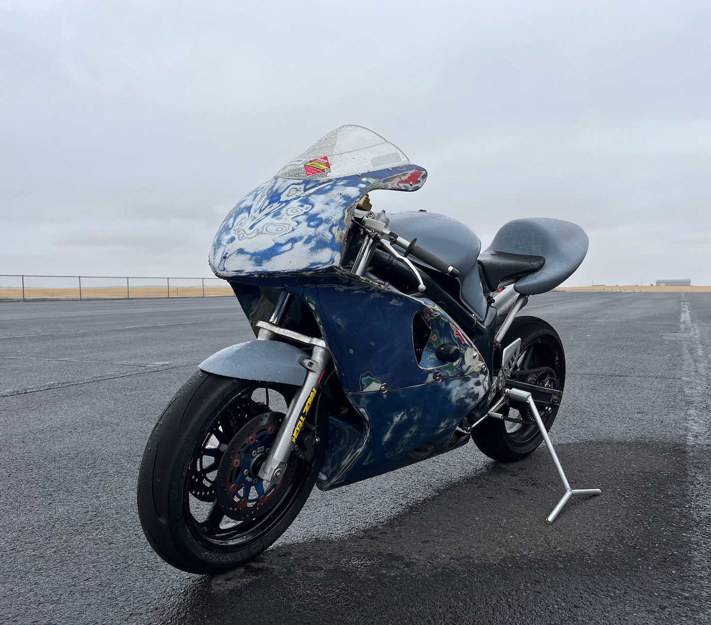

At this point The bike is like 95% ready. I hope to start it up tomorrow. and then finish the fairings at least enough so they are mounted and in primer. My first track day is May 11. I'd love to get this on a dyno for the break in and to check A/F but getting a dyno slot this time of year is tricky.
