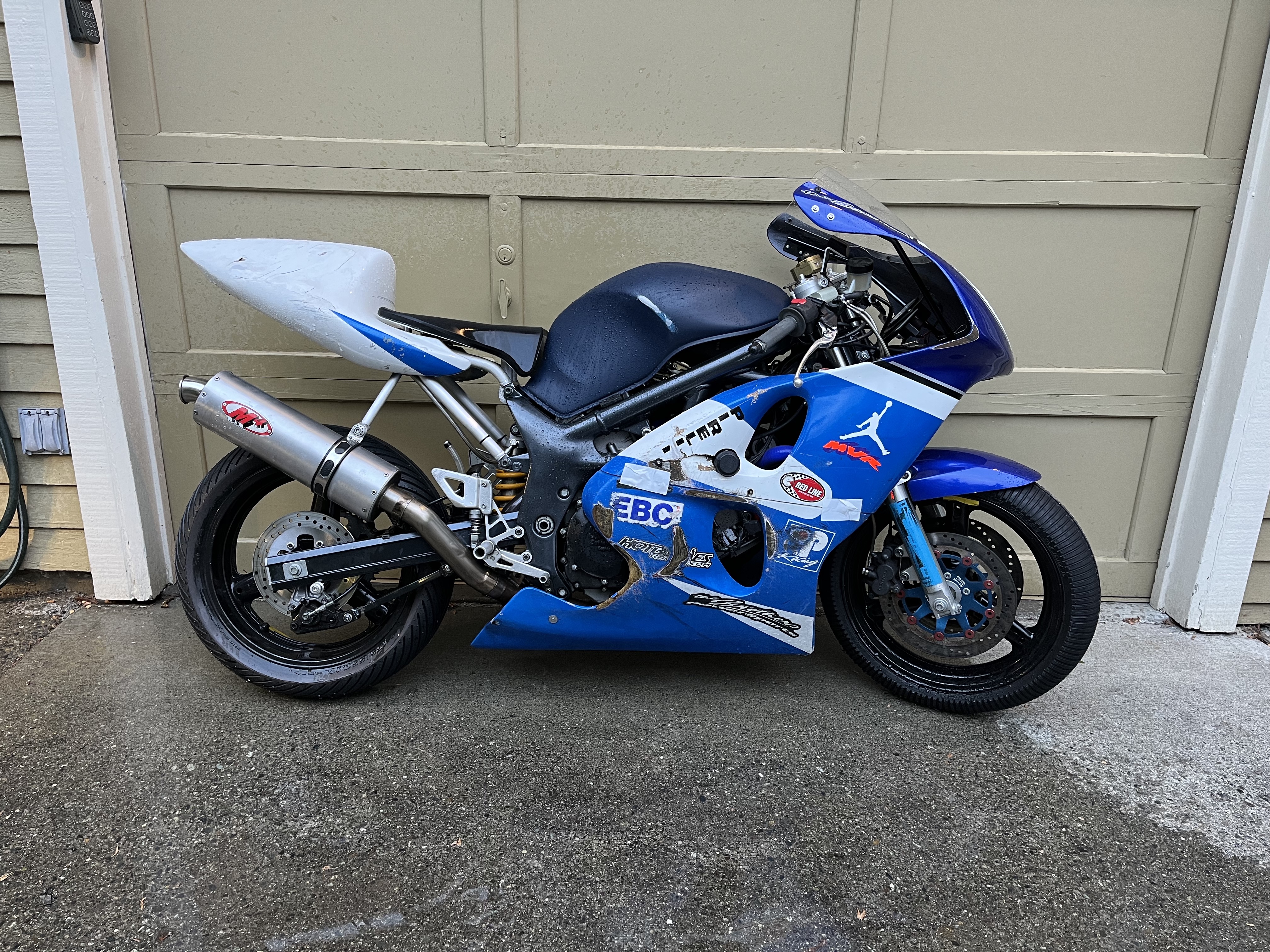

'99 SV650 track rebuild
first track day was a reasonable success other than the weather being absolutely shit. It was about 45-50 degrees most of the day with intermittent squalls coming through every 20 minutes and stiff breeze ensured I was soaked and freezing my ass off the whole day. Rain tires were awesome in the wet. I was feeling OK on the bike and everything seemed to work well however I need an even stiffer spring on the shock as i could not set sag without excessive preload. I threw a cheap quicky paint job on the tank to try out the color and it didn't even make it through a session before i wore through it - still undecided on the color. I may have a line on some used body work thats in better shape than this so i haven't bothered fixing this stuff up. raising the tail and slimming the seat have given this a bit more contemporary look in my opinion.

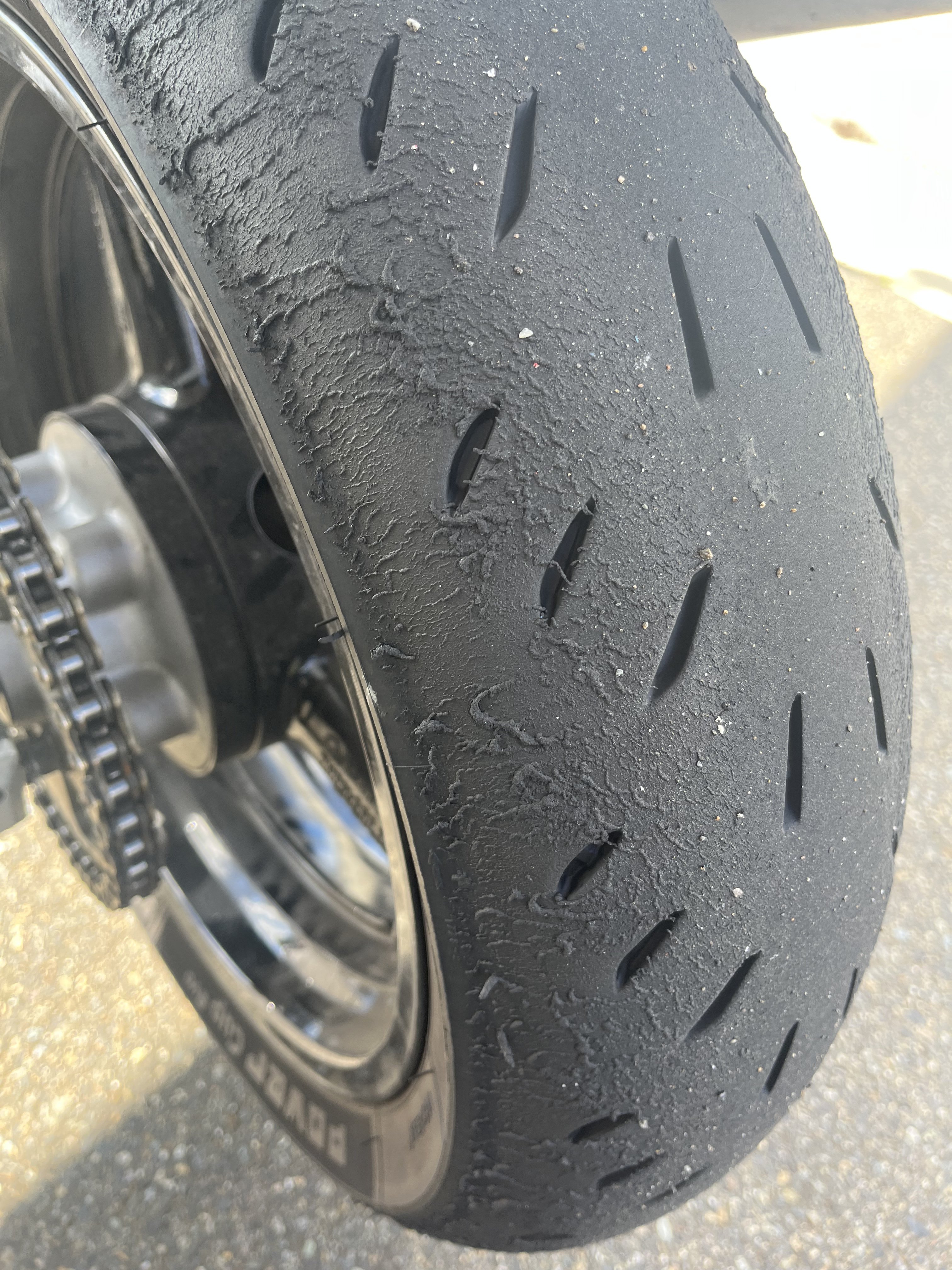

I did another track day this weekend- a double feature Sunday/Monday. Actually had some nice weather too! What a difference from being freaked out in the rain. It was my first time in the intermediate group and it was great. I got a lot faster and more confident riding with the faster guys. By the end of Monday I was passing guys on panigales and bmw 1000RRs which felt good on this crusty SV

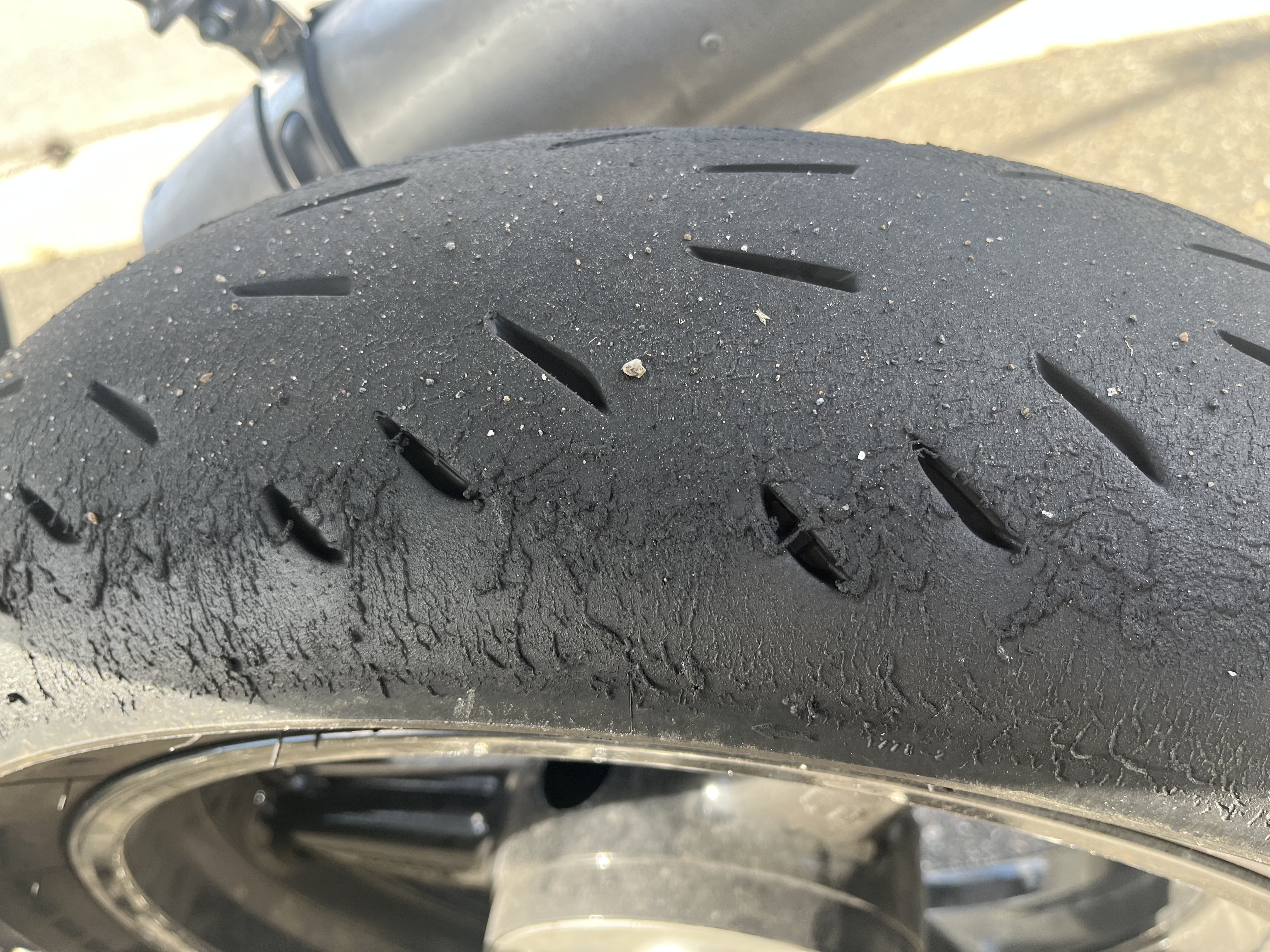

It’s crazy how far you can lean this bike over and not go to the tire edge. I’m chewing up my rear tire with what I believe is “hot tear” I ended up at36 psi on the rear trying to mitigate this. It improved some but with uneven wear patterns. Maybe the soft spring is allowing the bike to squat a bit and overloading the tire?

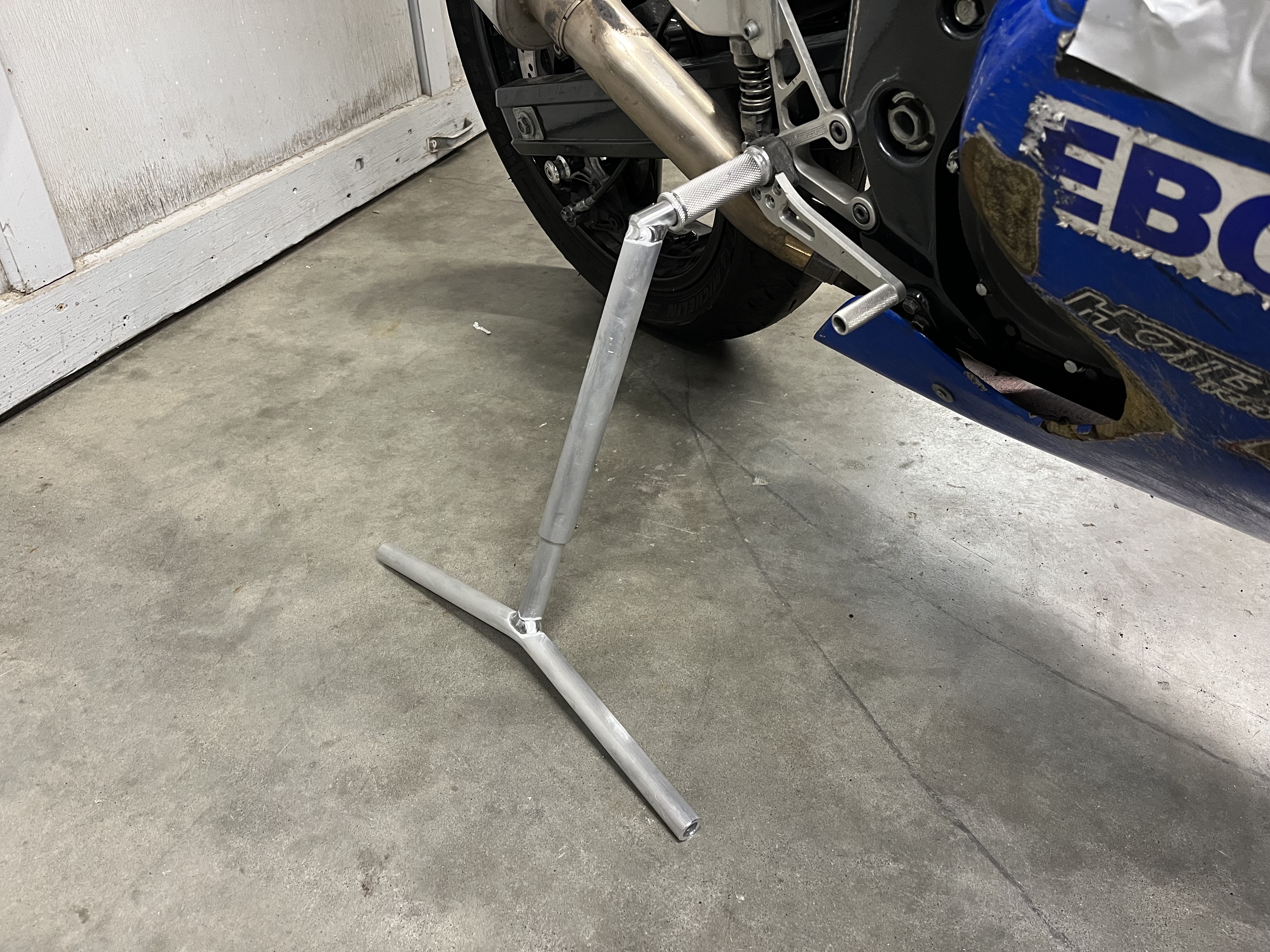

Waiting for parts to come in so I decided to make a new rear brake torque arm. steel OEM = 8oz. Aluminum = 4oz.
I also made a stand for taking the bike to tech, it telescopes and is adjustable. right side stand is tripping me out!

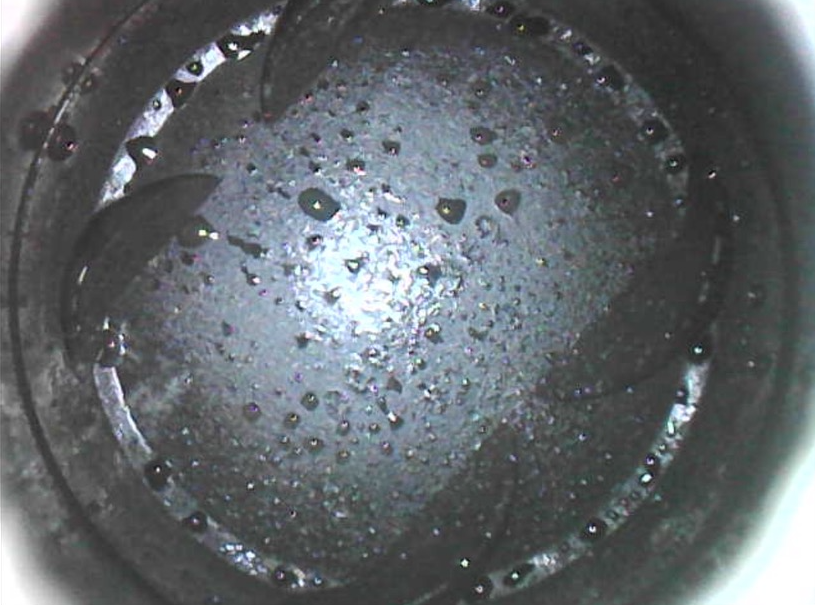

I stuck a bore scope in the front cylinder and as suspected the head gasket is blown. This cylinder was making 225PSI - rear cylinder was 230PSI. I checked the head for flatness and its good to go. I'm just gonna slap a new gasket on there and party on for the rest of the season. I recently picked up a second engine that I will do a cheap refresh over the winter so I have a spare for next season.

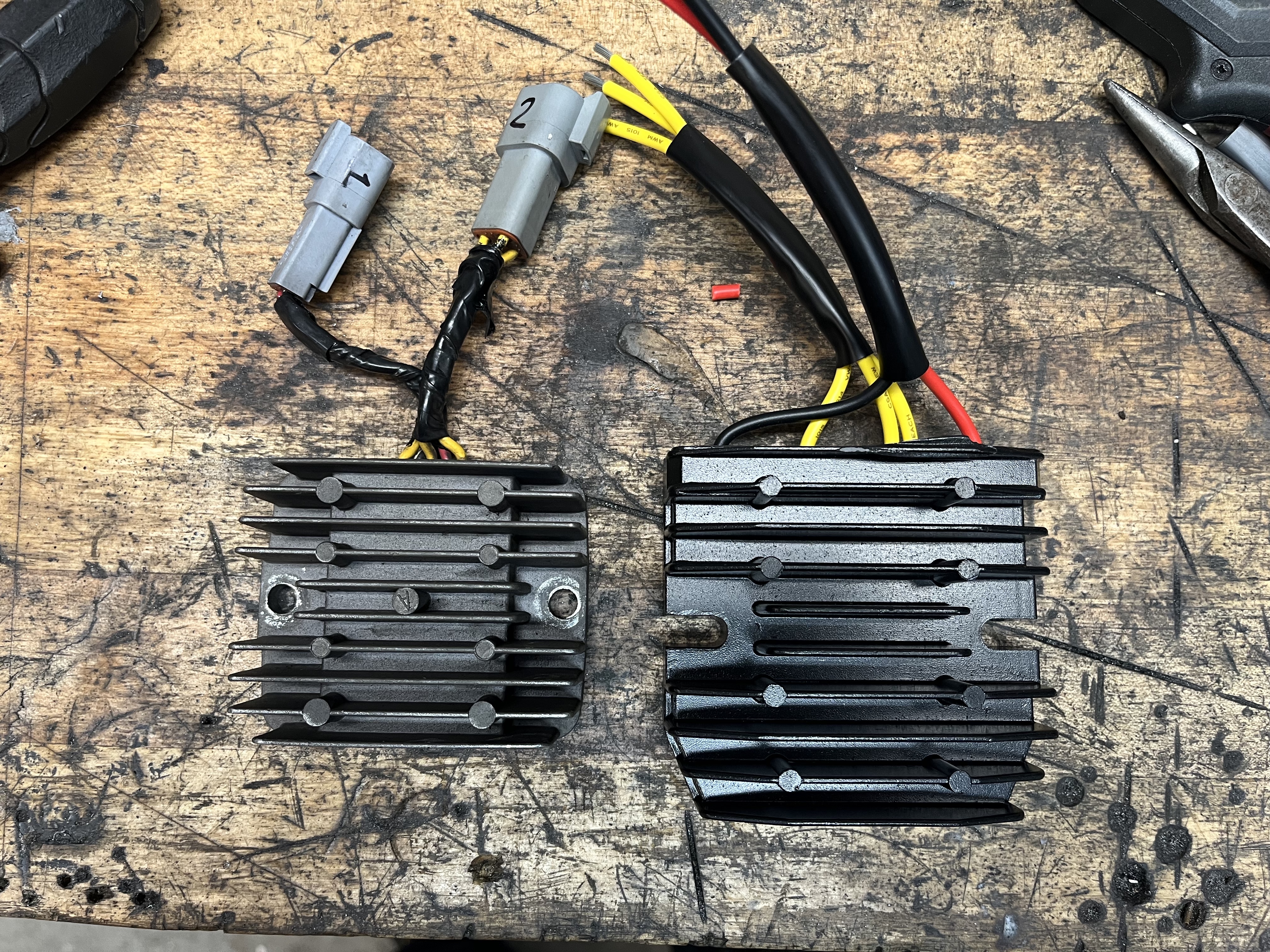

I upgraded my regulator/rectifier for a lithium specific one, despite the stock one bench testing OK it seemed as if it was overcharging the battery. Without any of the running lights all that extra power has to go somewhere and it was getting the stock r/r super hot. New Rick's r/r is quite a bit bigger and intended for lithium batteries. Seems to be working well, and doesnt get nearly as hot

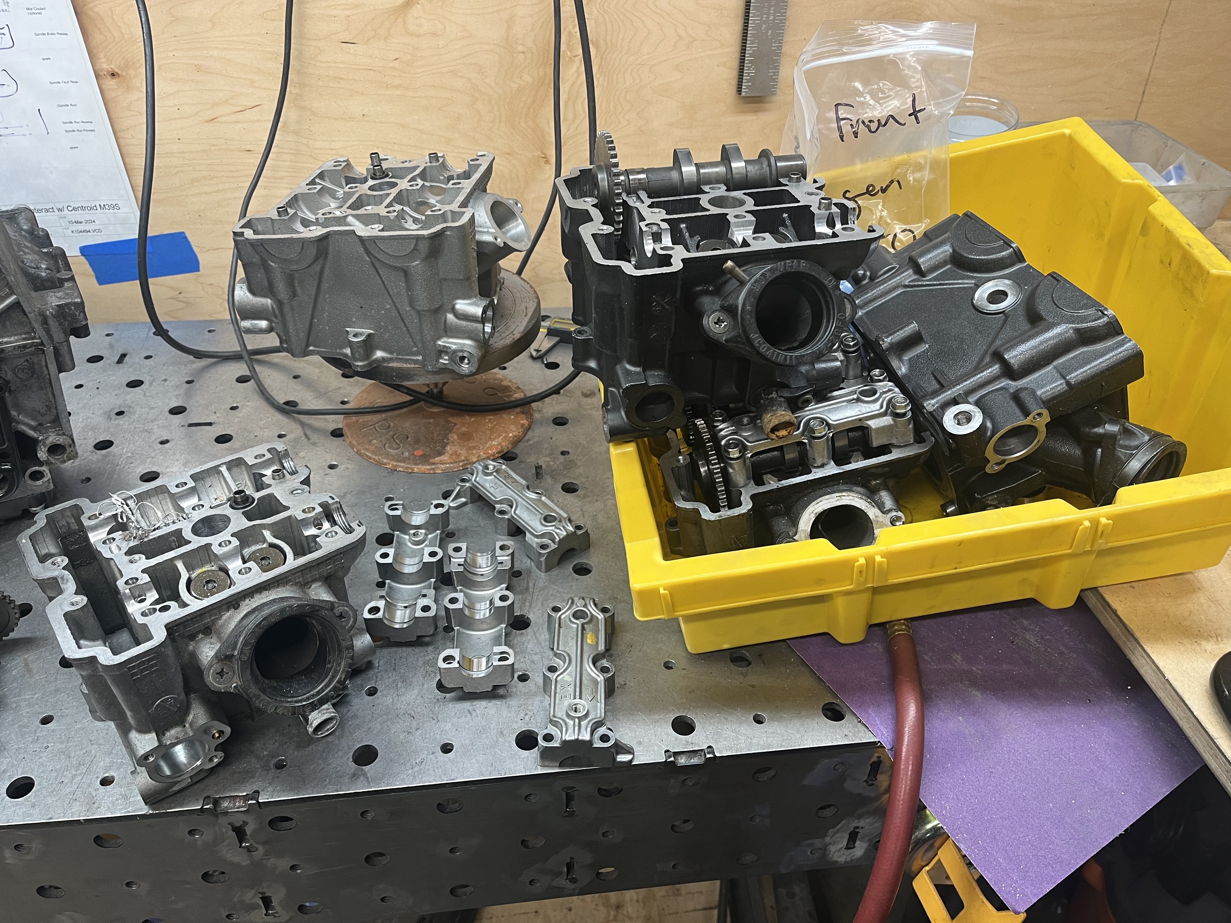

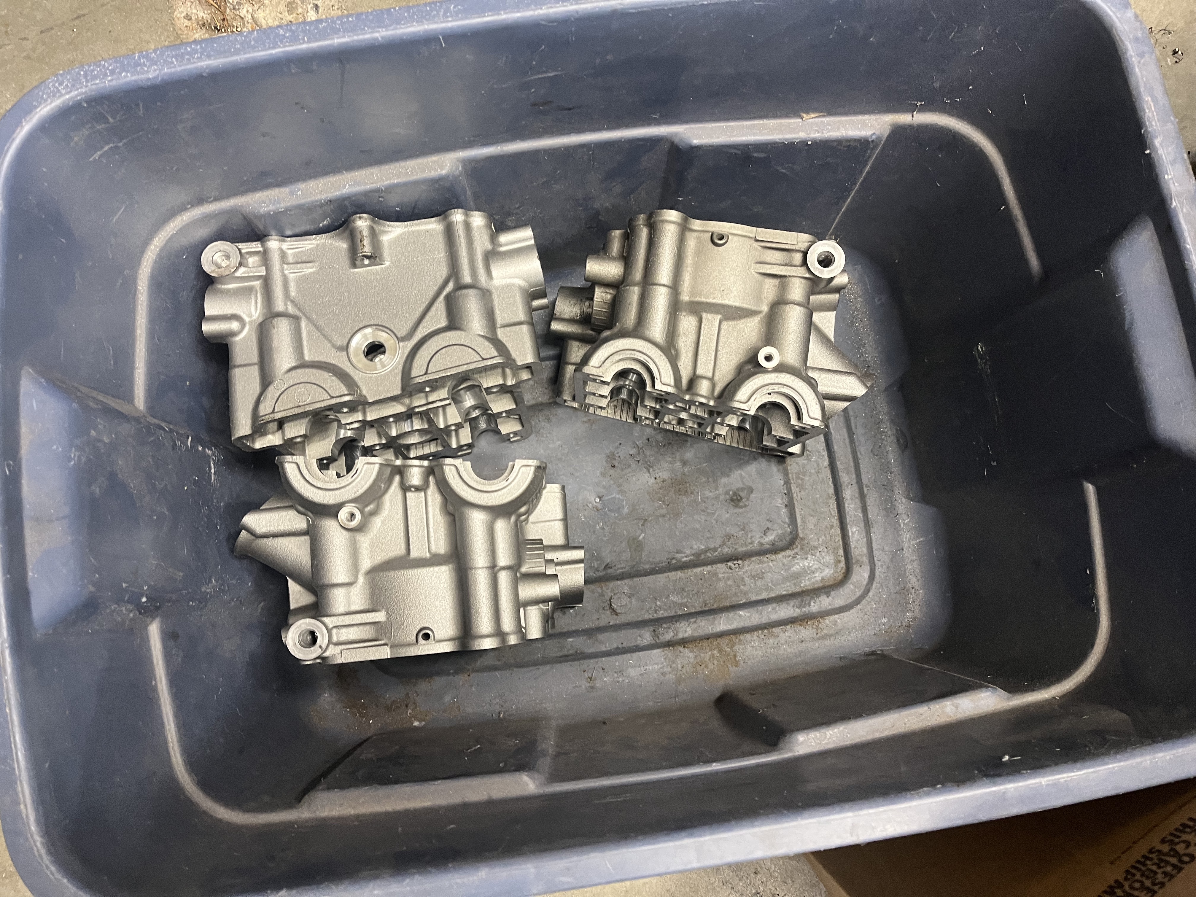

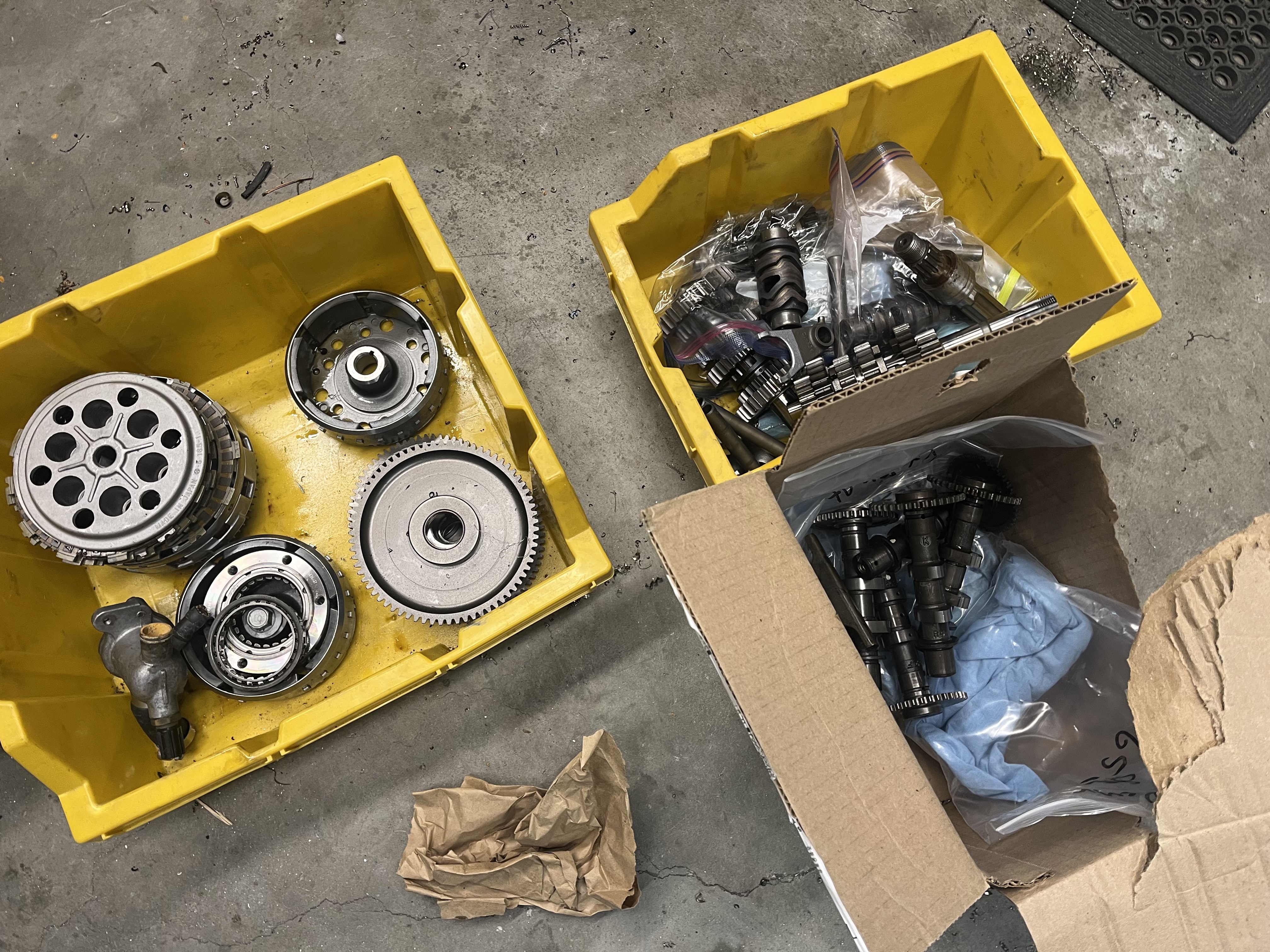

Im building a fresh engine for the new season. I broke a spare engine down and realized it needed a bunch of stuff so I traded for a hoard of used SV engine parts. In the stash of parts there were 10 cylinder heads and only one has matching cam caps... WTF is wrong with people? Bolt the cam caps back in place when you strip an engine! they are matched to the individual head and not readily interchangable.

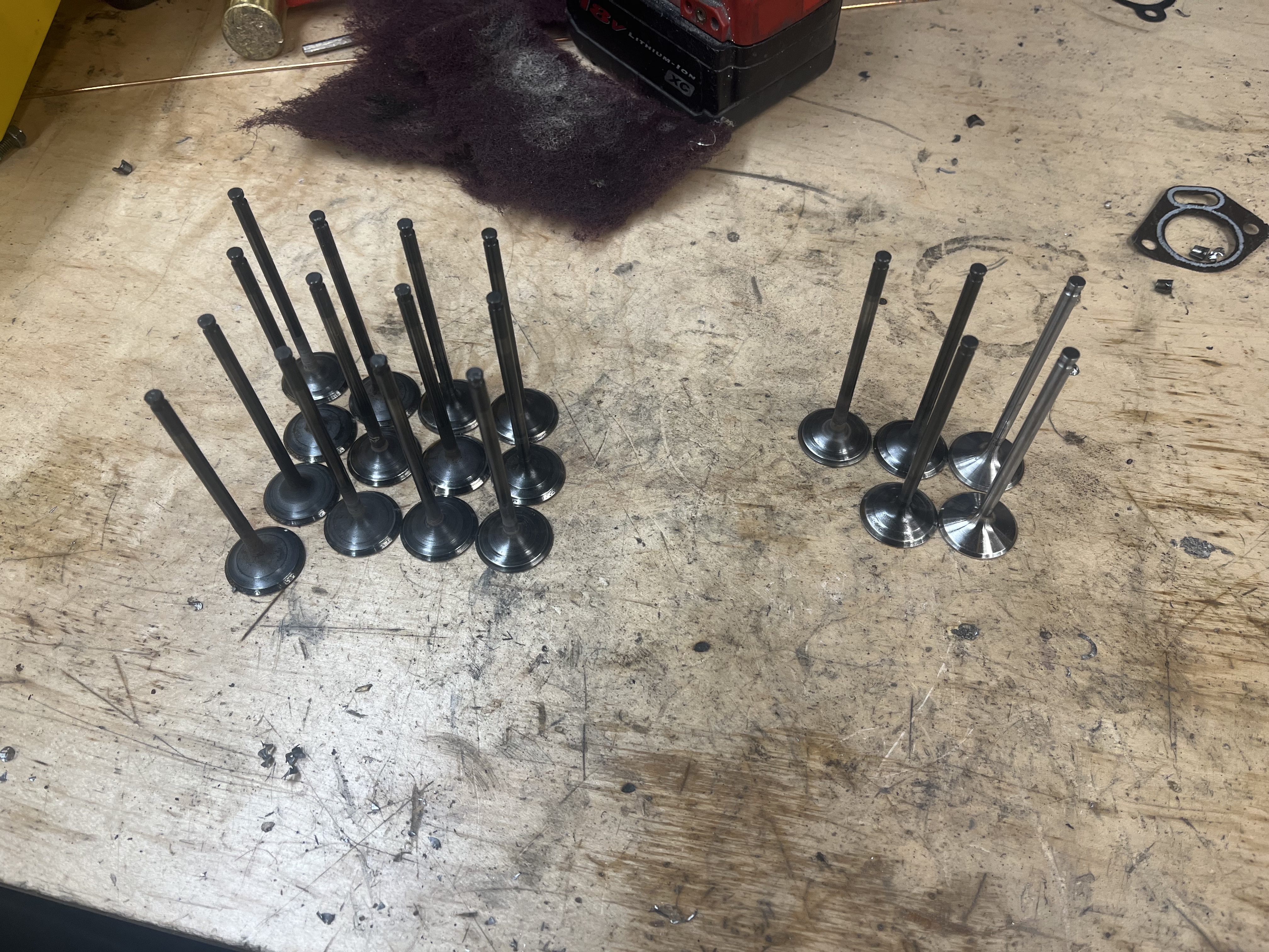

After I went though all of the heads I got 16 stock exhaust valves, out of that only 2 are good to use, one is questionable, and the rest have pitting or are deformed. Not a good part from Suzuki..... One interesting thing was there was one head with a port and polish and stainless valves. If i use those stainless valves I have enough to rebuild my heads. I don't like the idea of mismatching the valves but I doubt there is any practical issue for mismatched valves between cylinder heads. Maybe I'll see about finding another two stainless exhaust valves since pitting and deformation on the exhaust valve appears to be a common problem on these engines.

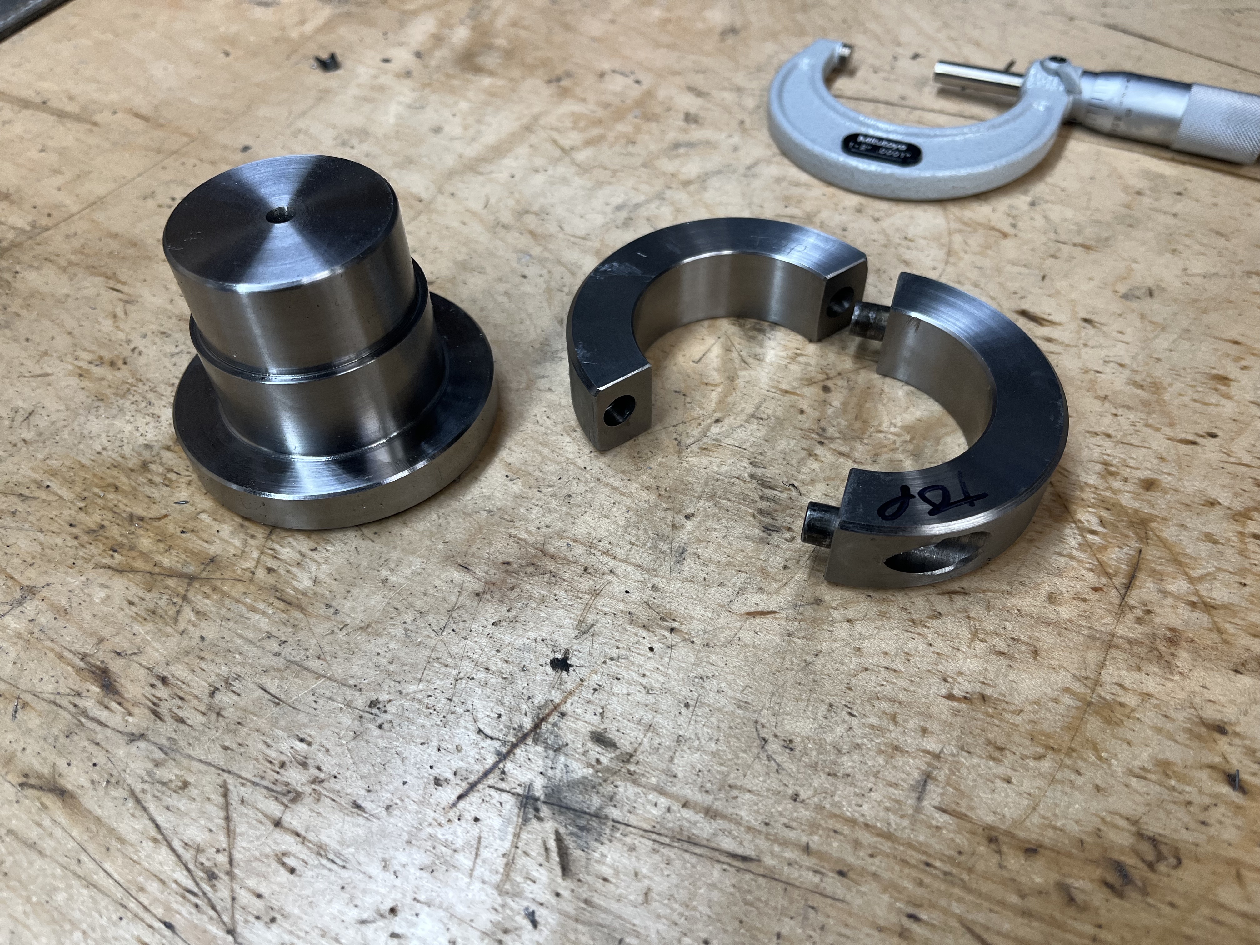

I fabricated the tools necessary to remove and install the crank bearings.
