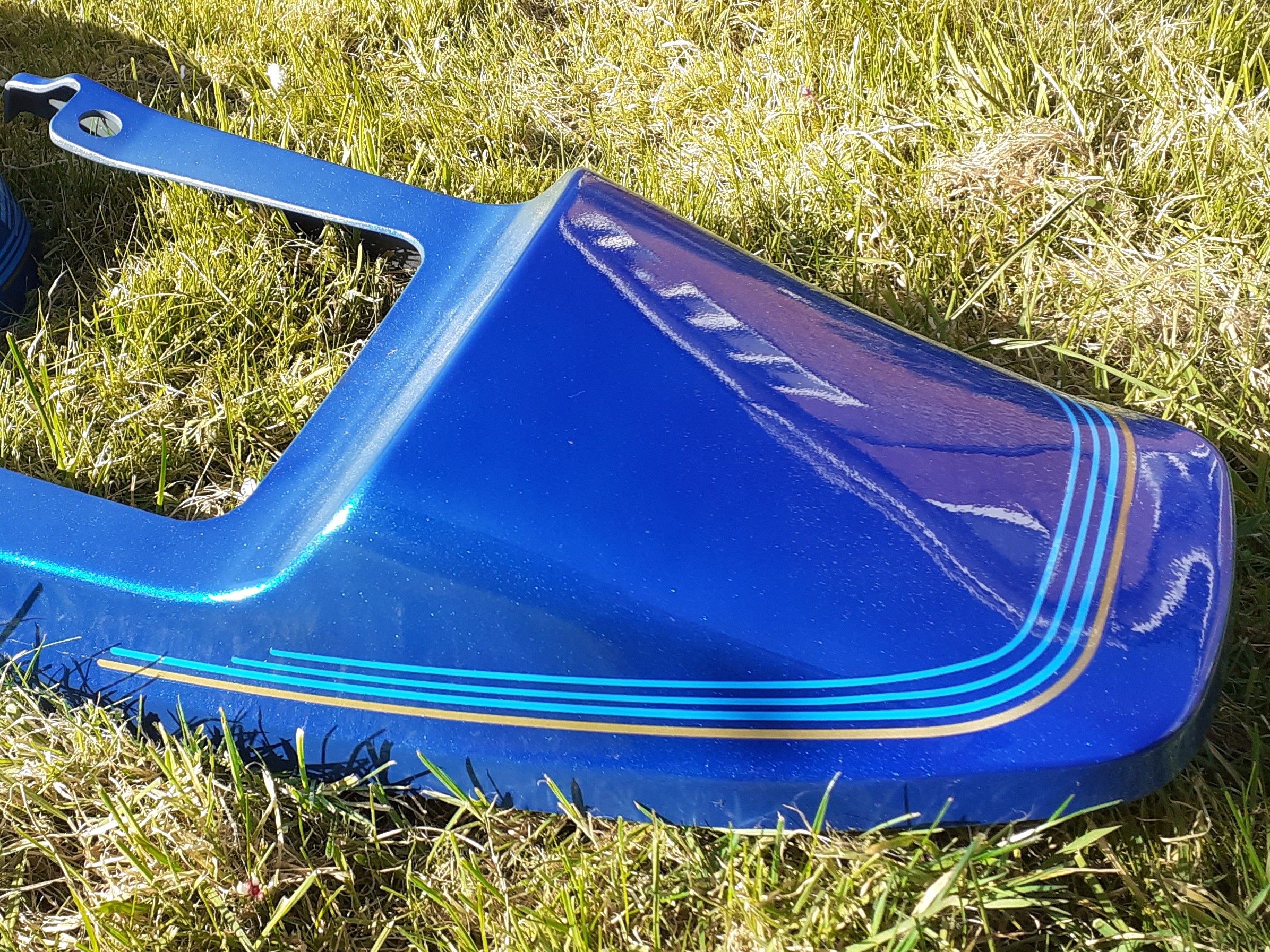

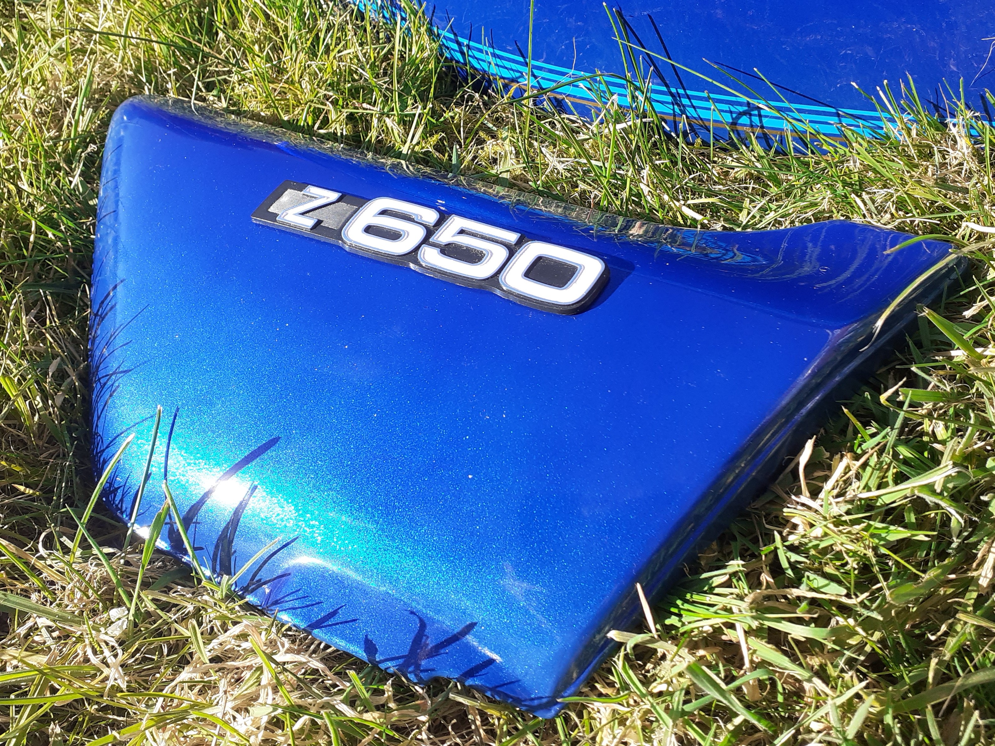

Applied the decals, followed by three more coats of 2K clear. Now have to wait a few days for the 2K to harden, then can flatten it back and give the paint polish..

With the badges and filler cap fitted, just need to polish the paintwork and its done. The 2K clear seems a little soft after a few days, so that can wait until the clear is fully cured. Next job is to make the rearsets..

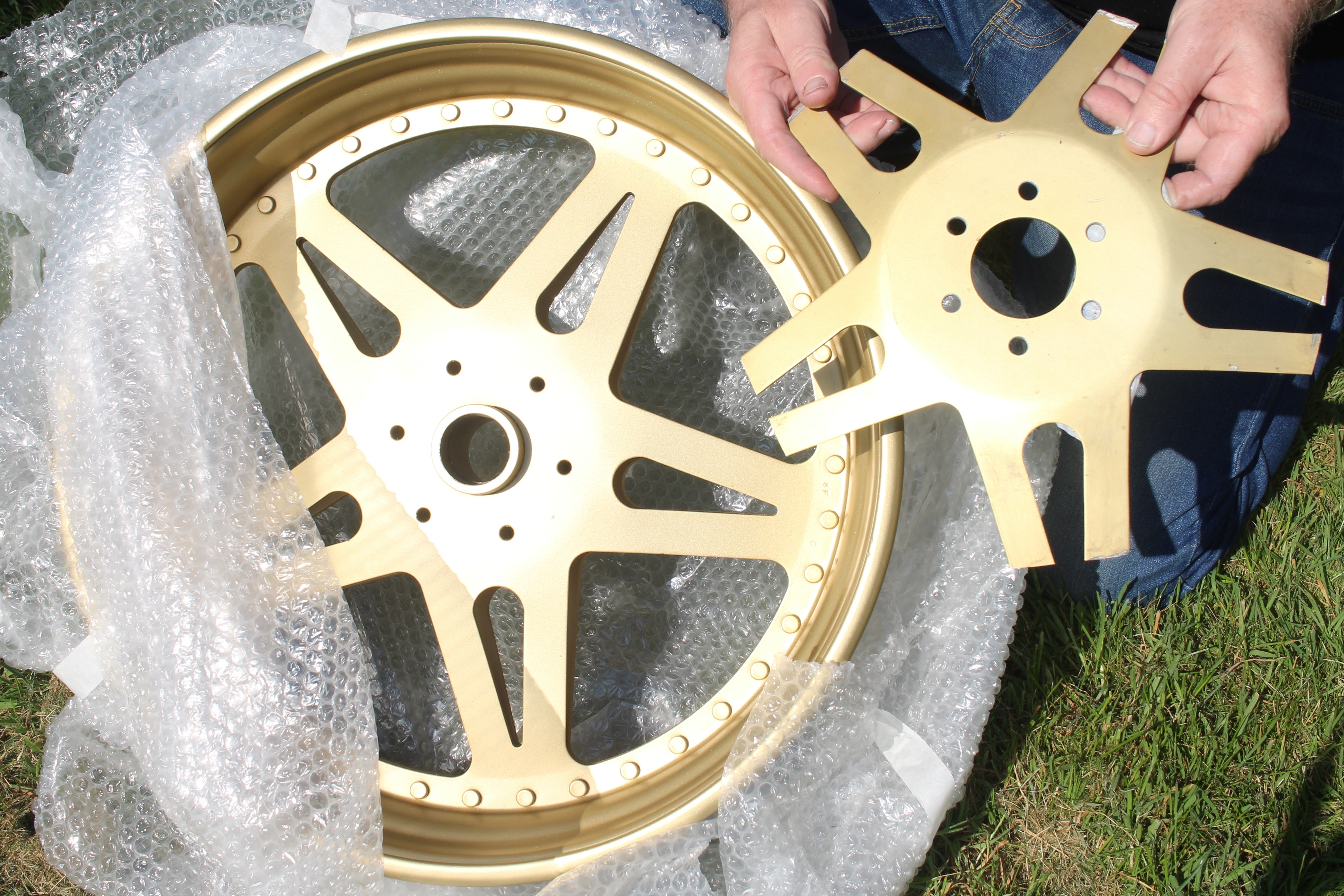

Got the old Astralite wheel back from the local coating specialist, pretty good colour match from an original section cut out of an old wheel..

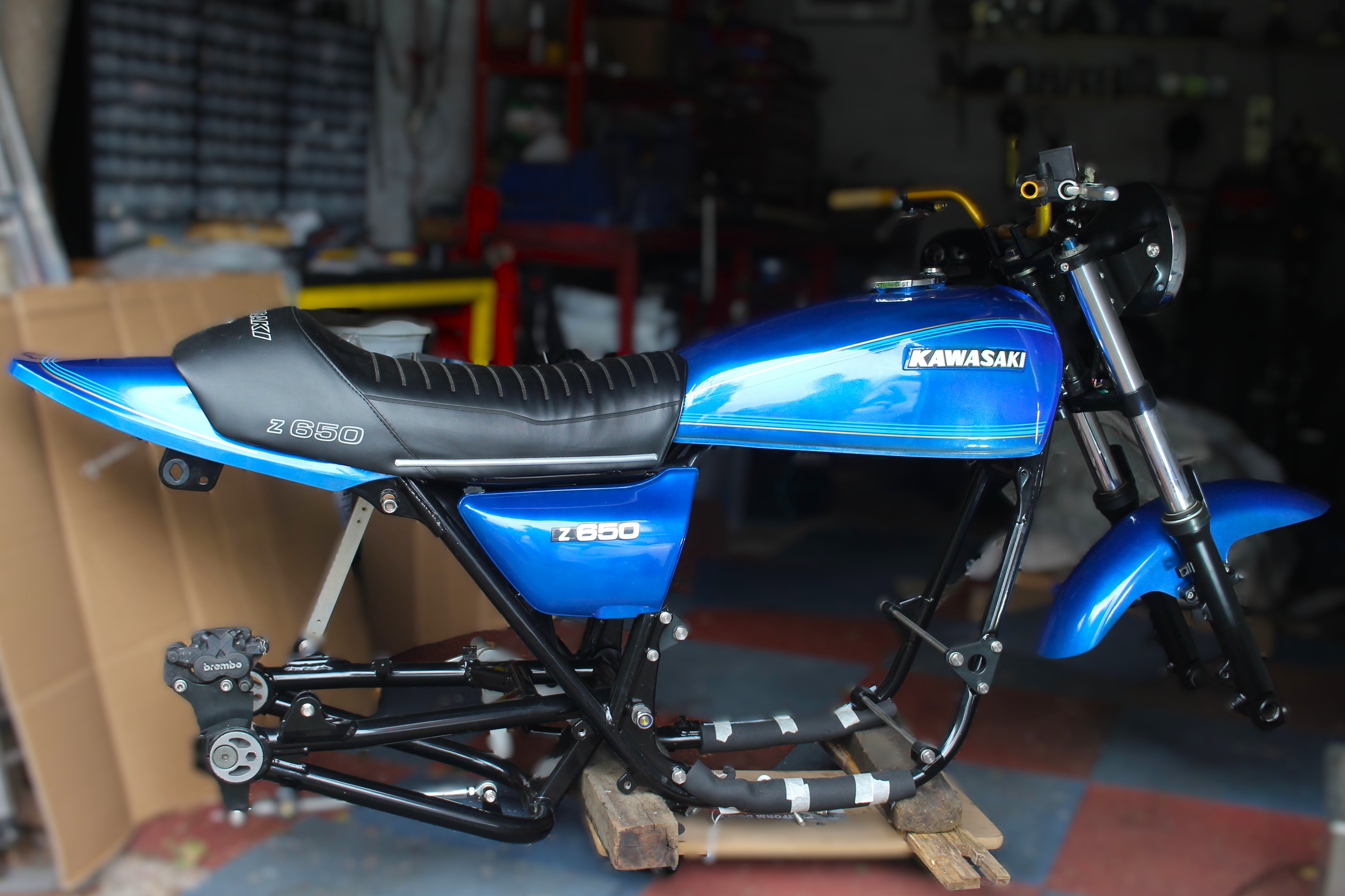

On its wheels at last, with rearsets done. Weighs 81kg as it sits, don't know by how much, but its much lighter than a stock bike in the same state.
