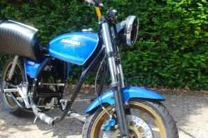

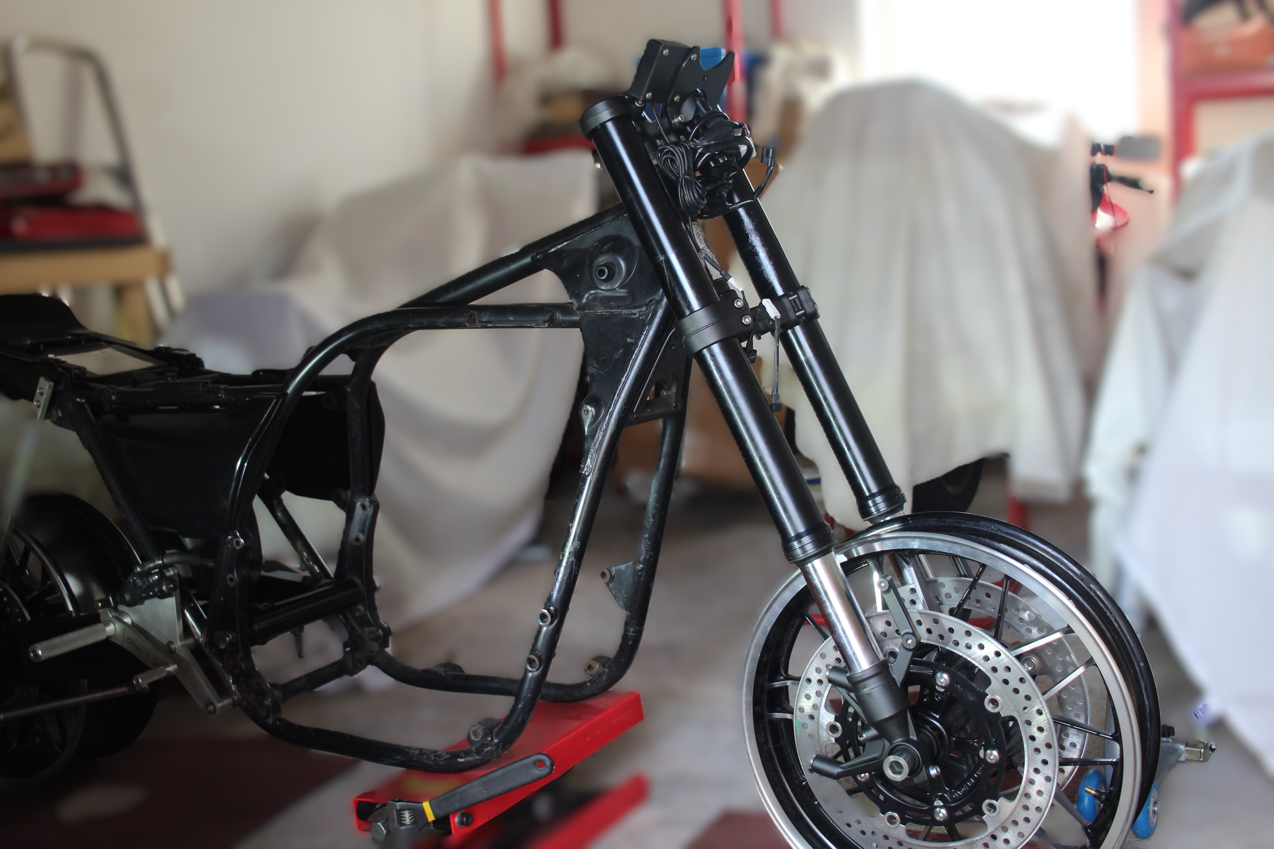

HEL custom brakes lines now fitted front and back..

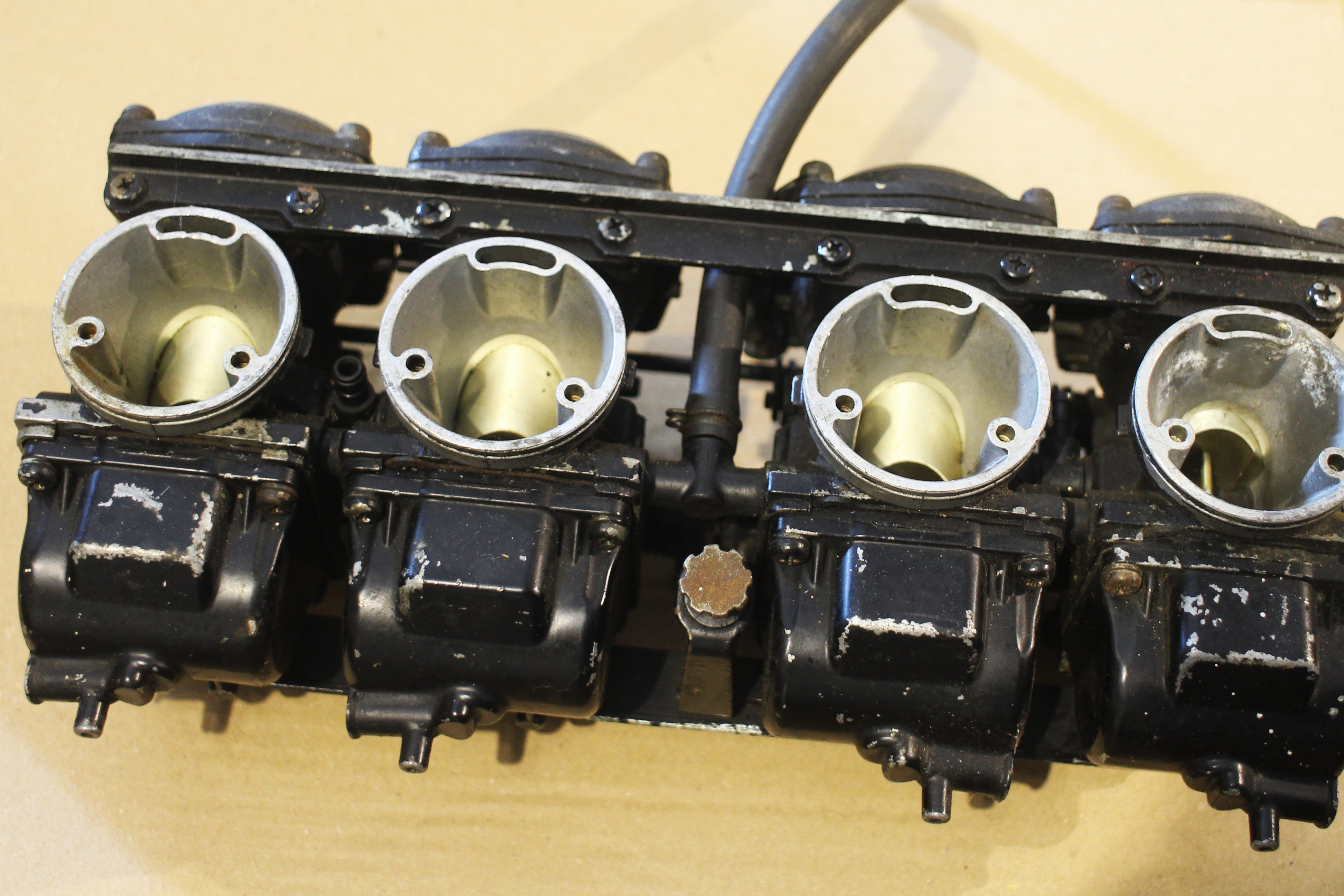

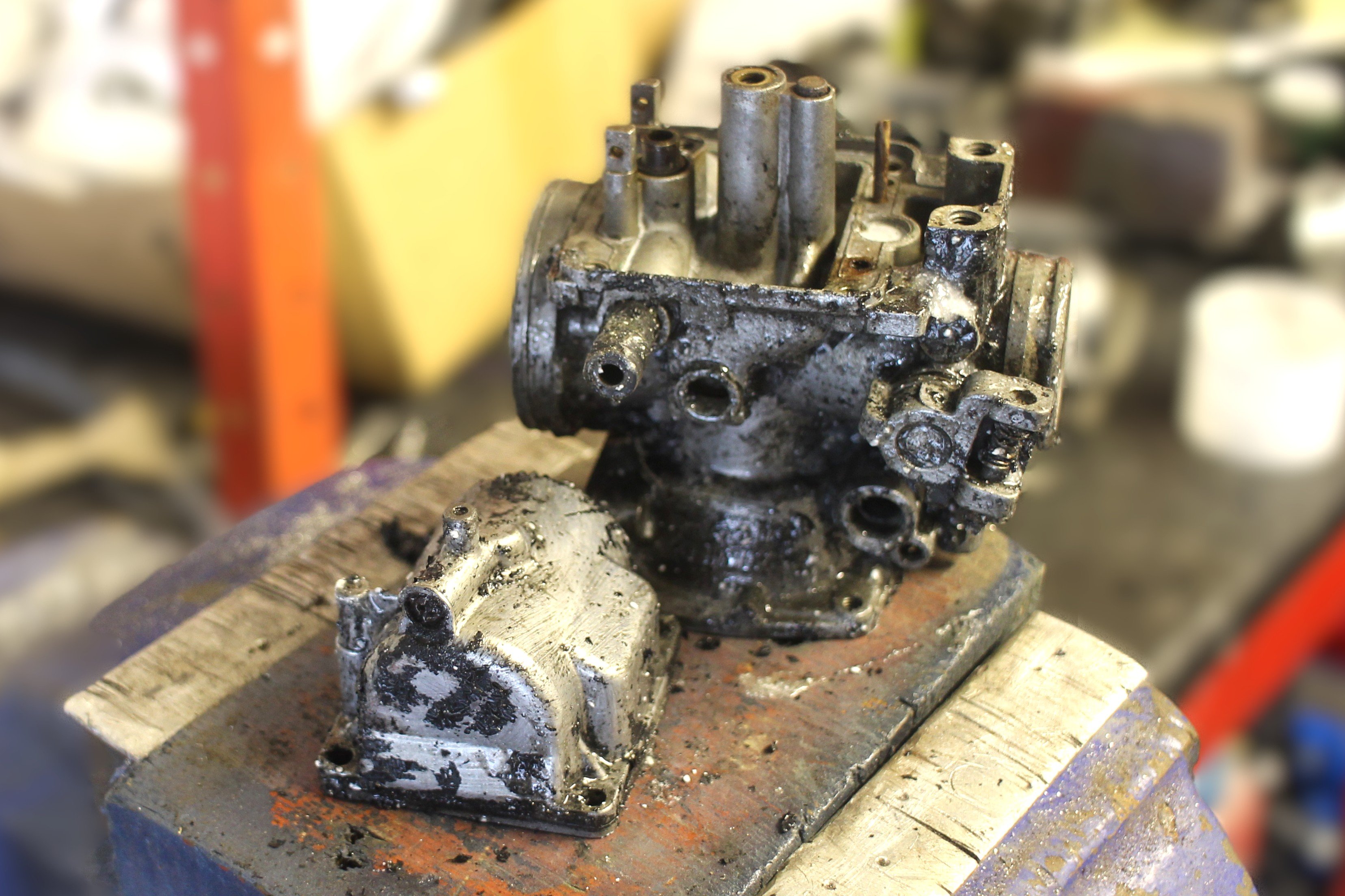

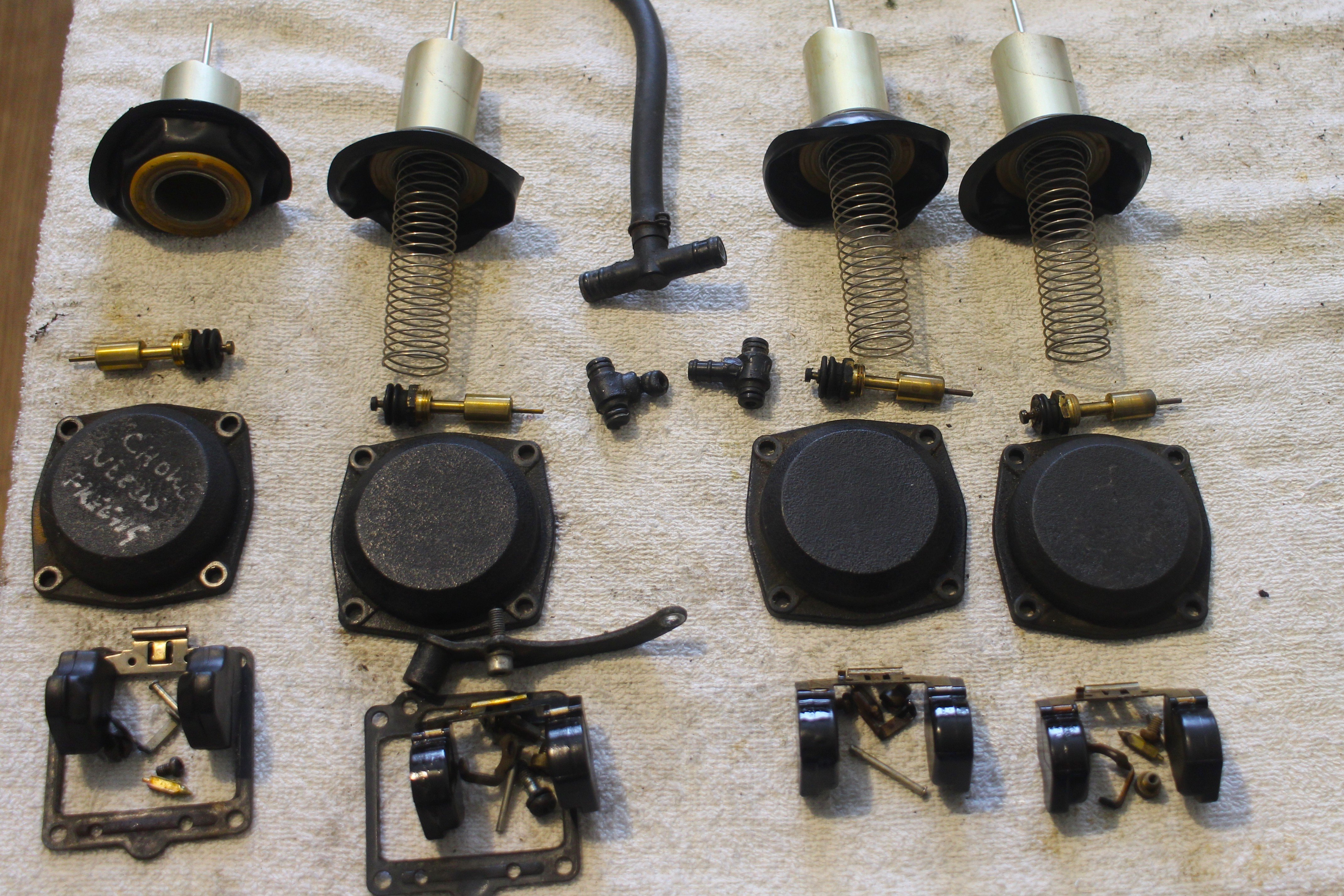

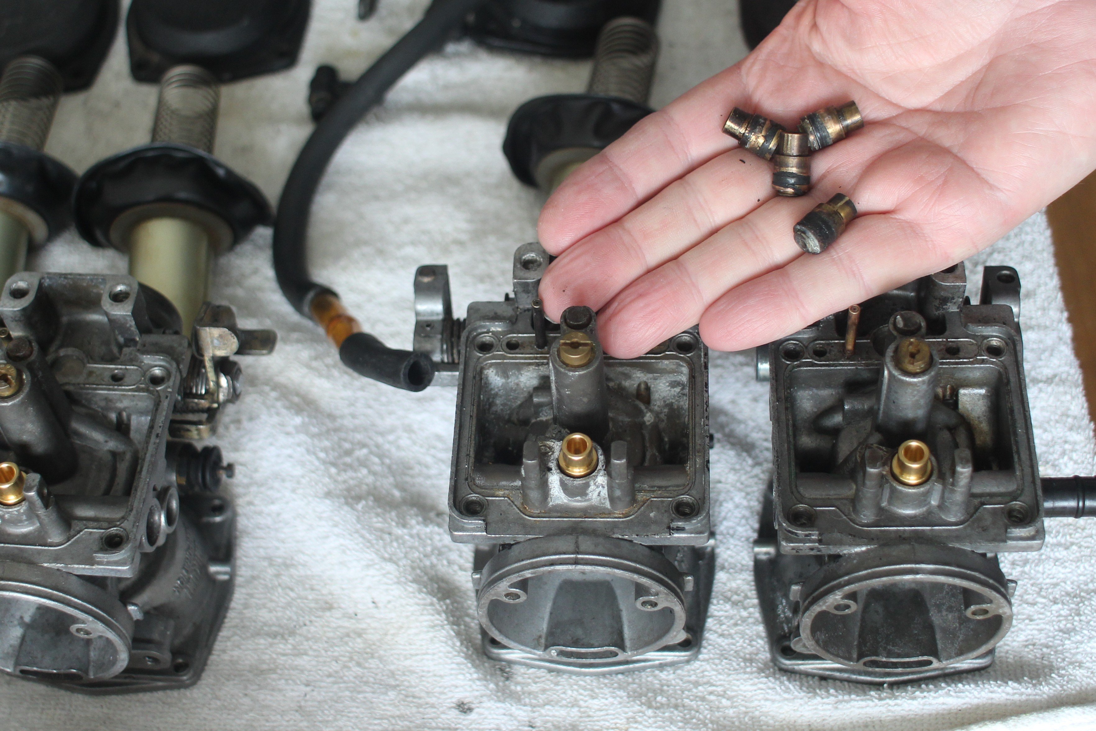

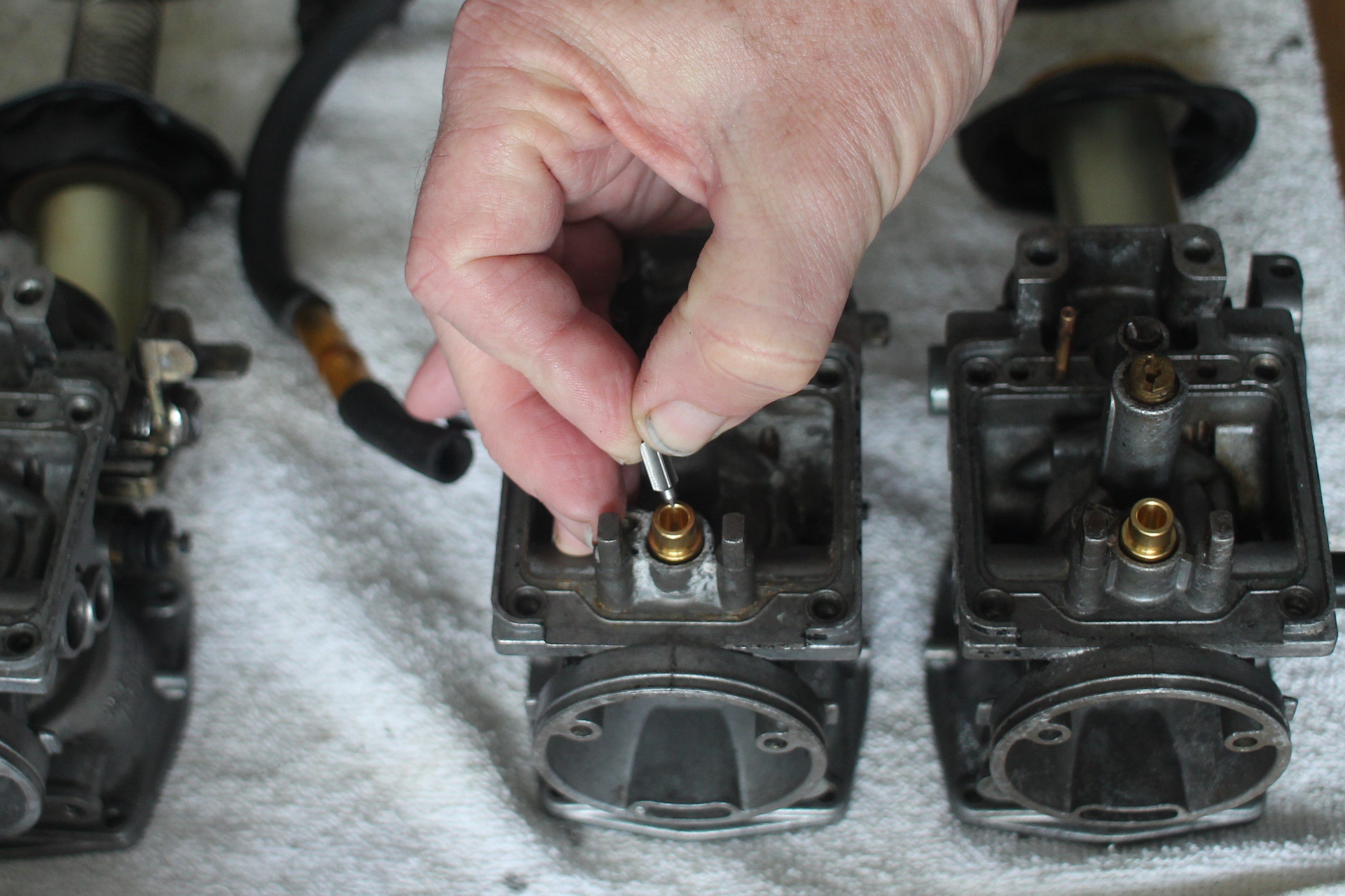

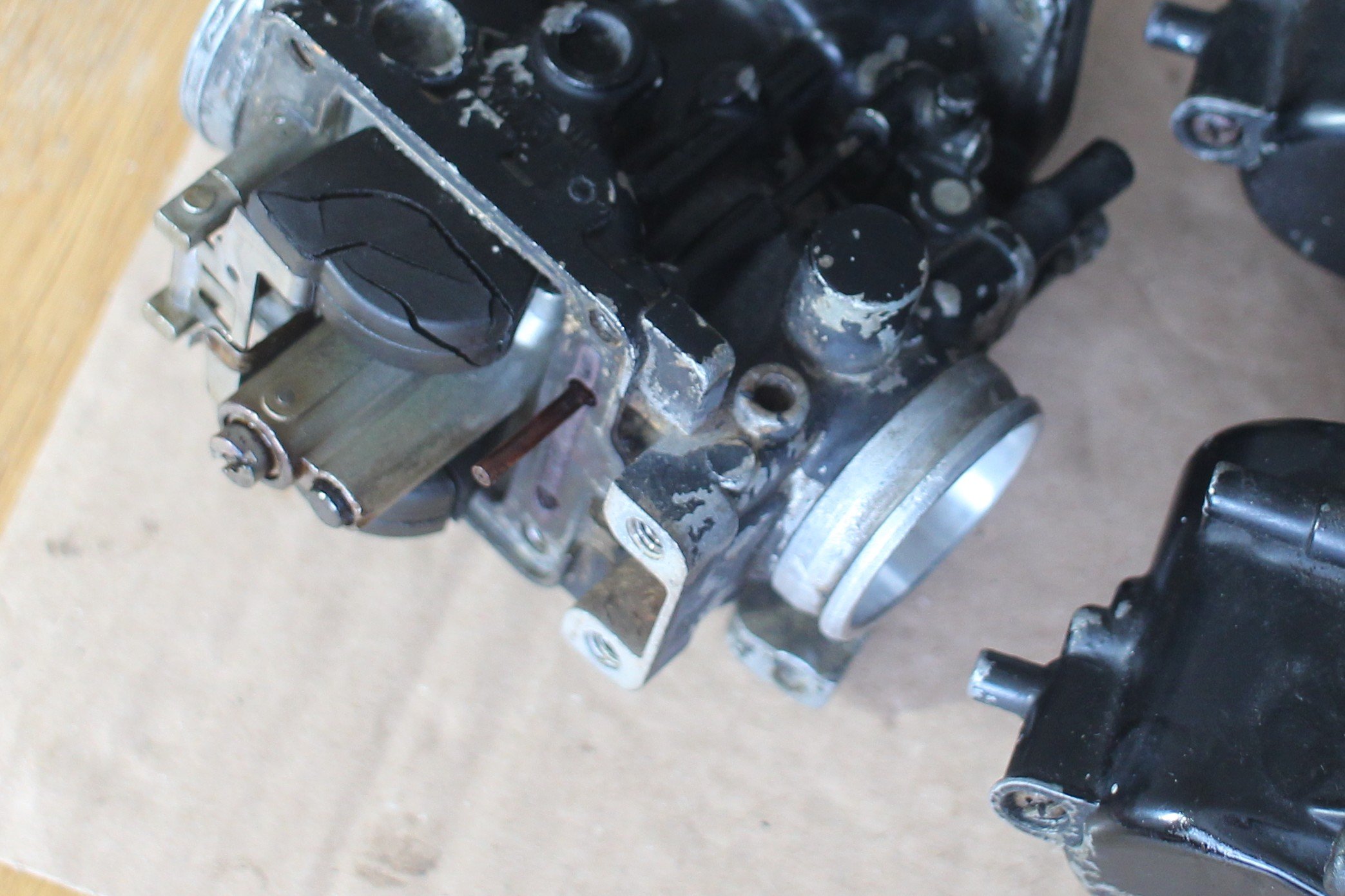

In the meantime took the Mikumi VM carbs apart, they were worse than I expected. The homemade black paint was peeling off, while one of the floats was badly damaged, one carb had a missing spring.. god knows how.
Spent hours slowly stripping off the old paint, the carbs have been rebuilt unpainted, the choke rod is rusty, so going to try make a new one in stainless.

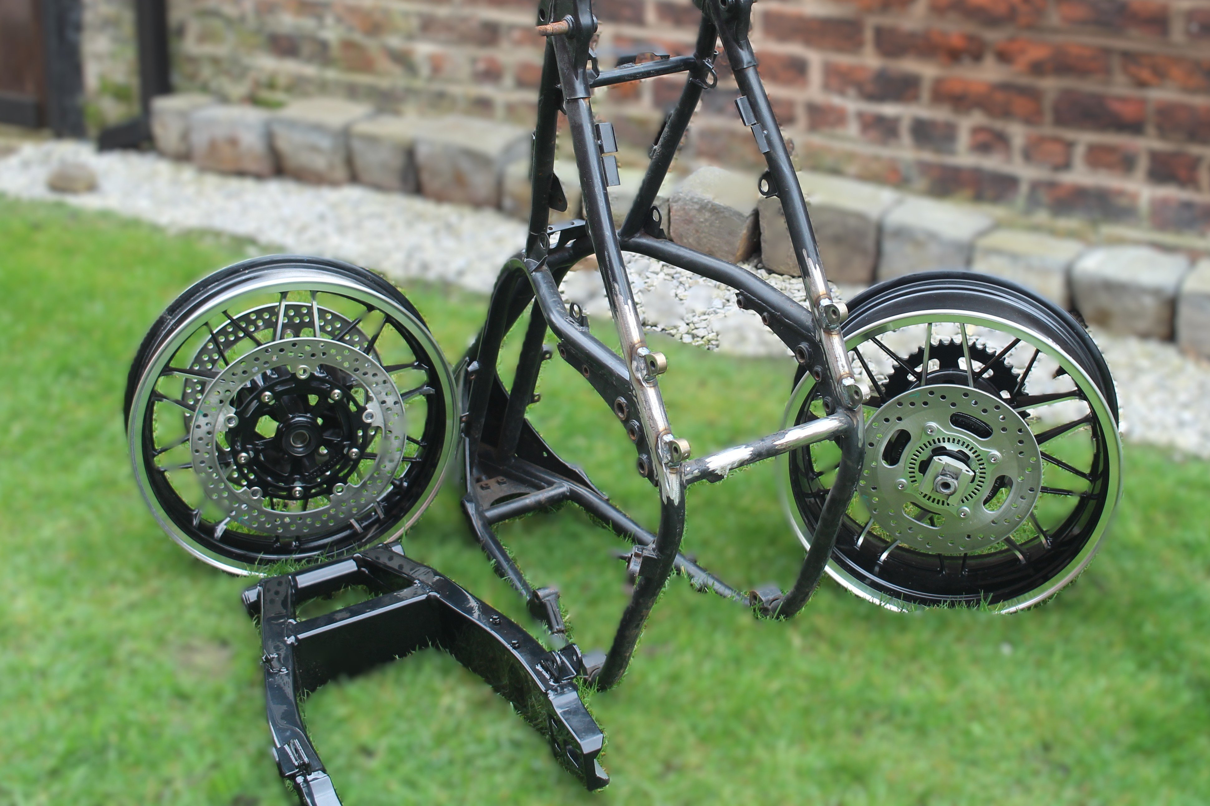

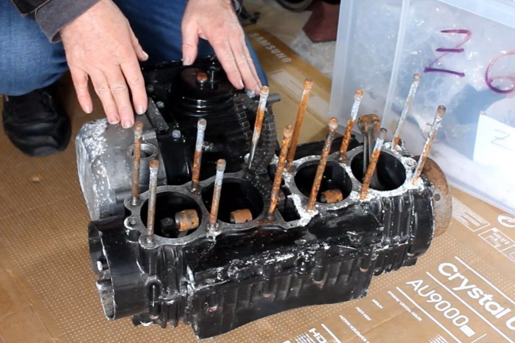

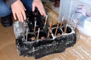

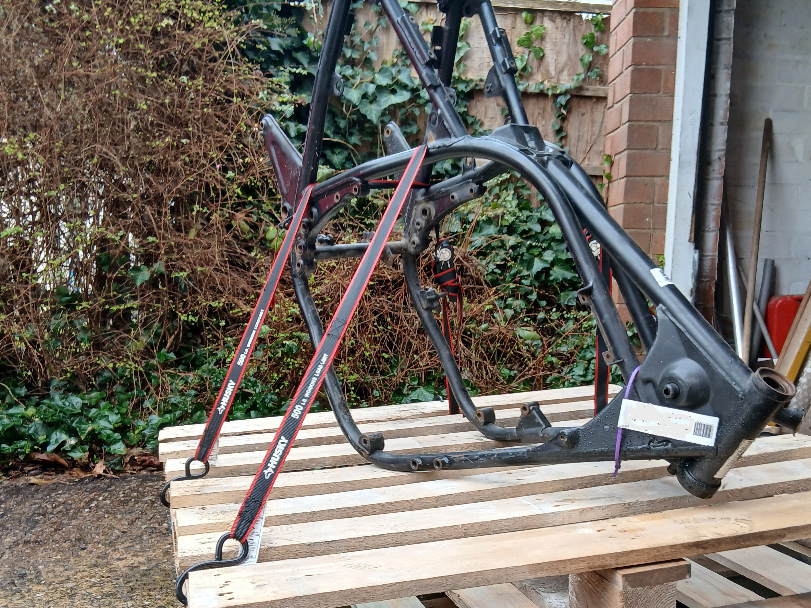

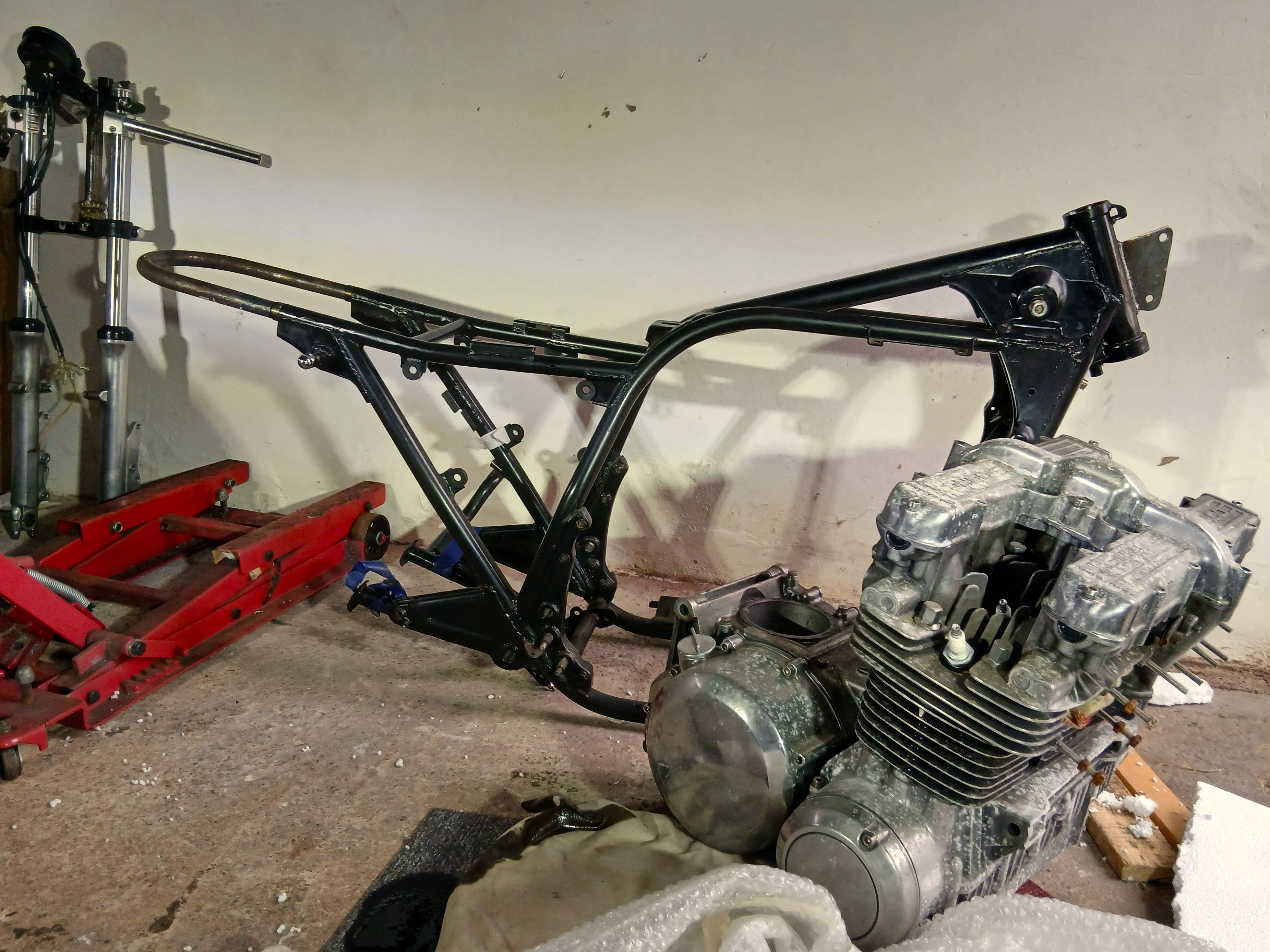

I'm in the UK so that may be a little far away lol. I've since bought another dismantled engine, when I went to collect it, the owner asked me if I wanted to buy his never completed KZ650 cafe project. It was so cheap, how could I say no.. So now I have 3 Z650 engines and three Z650 projects... As earlier this year I bought a Z650 frame, for a future project, which has progressed much faster than I had expected. I had the front end/wheels from a modern Kawasaki Z900RS, along with a swing arm from a Yamaha XJR1300, all of which had been modified to fit an old KZ1000. That project is dead, but luckily those parts when into the 650 frame with very little work..

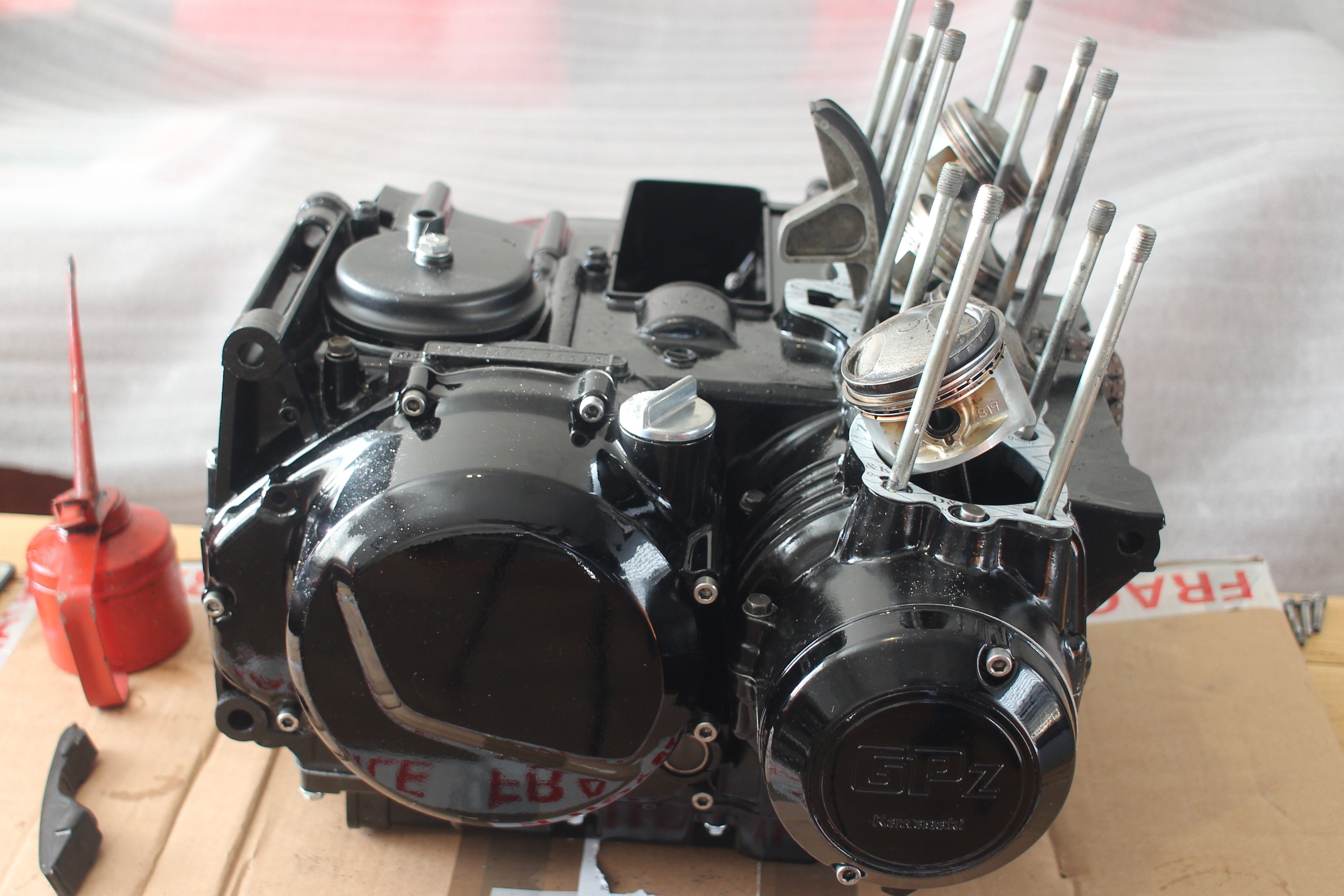

Pics are the GPZ750 engine slowly coming together. Cases have been cerakoated and covers powder coated..
And my two new projects, the first I call Deja Vue, and the second I'll probably build as a cafe racer, with different bodywork and a half fairing..

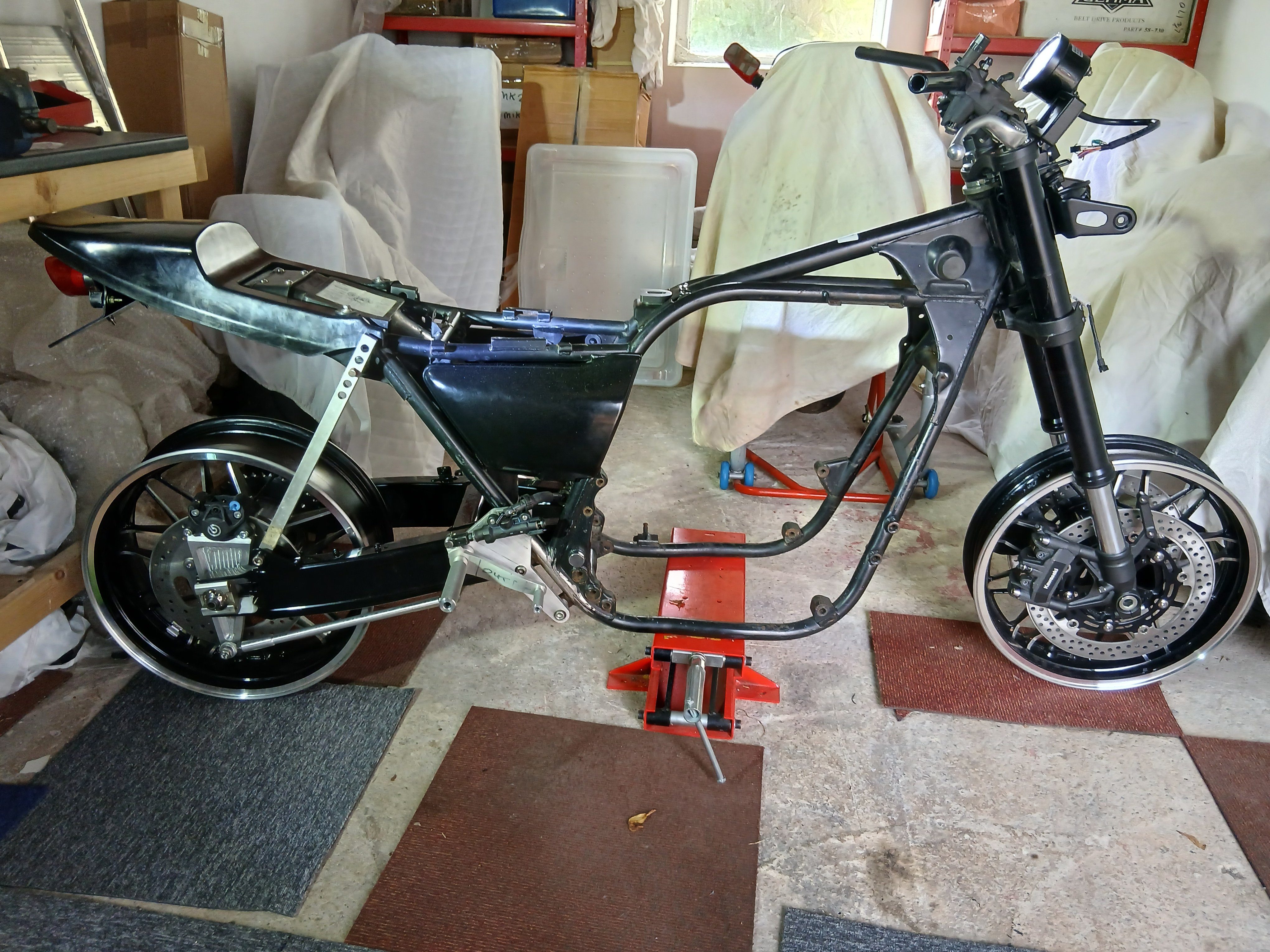

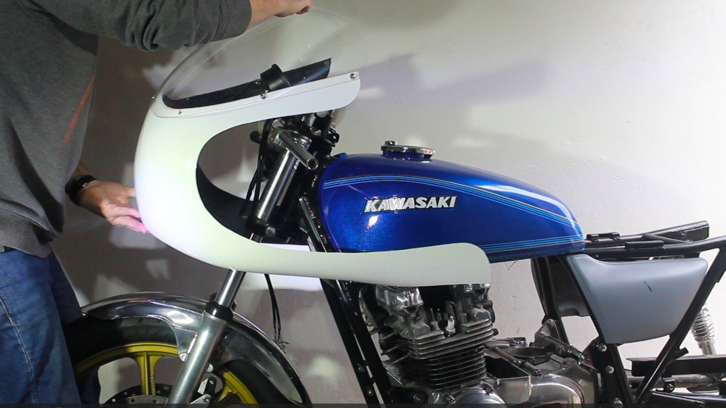

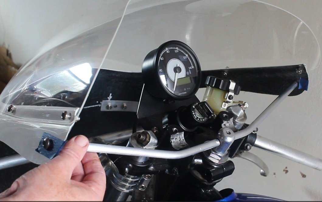

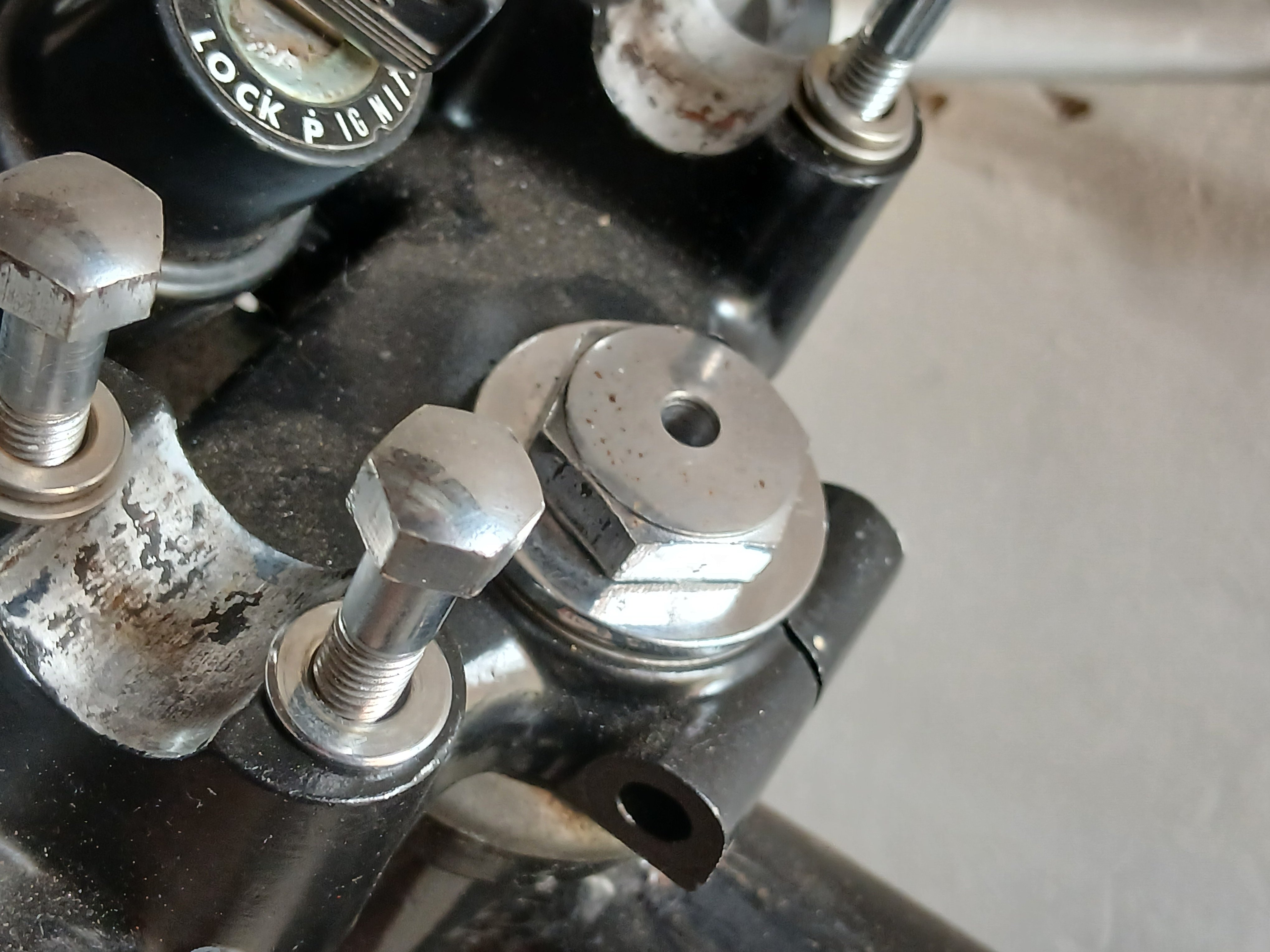

I've been messing about with the unfinished Z650 cafe project I bought recently. Just trying out a few ideas, using stuff I already had. I tried a Ducacsti SS900 Desmo seat unit, which didn't look too bad, so I then bought a cheap replica 900ss fairing to match. Mounting this fairing wasn't easy, though I have owned an original 900SS Desmo, so that helped.
All the brackets are aluminium, two of the three are now done, just waiting for some alloy tubing to arrive, before I can complete the third, lower mount.

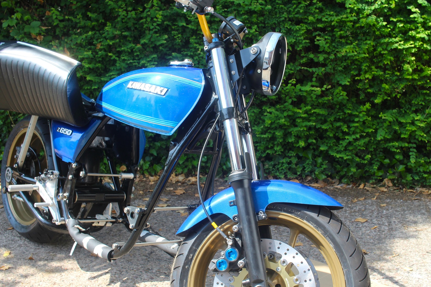

Also I swapped out the spoked wire wheels, with a pair of mag wheels from the green Z650, as they came with discs and calipers from an R6. This change also meant swapping the forks too.
The bike looks ok now, except for the side panels, which I'll change in the future, though not sure how yet.

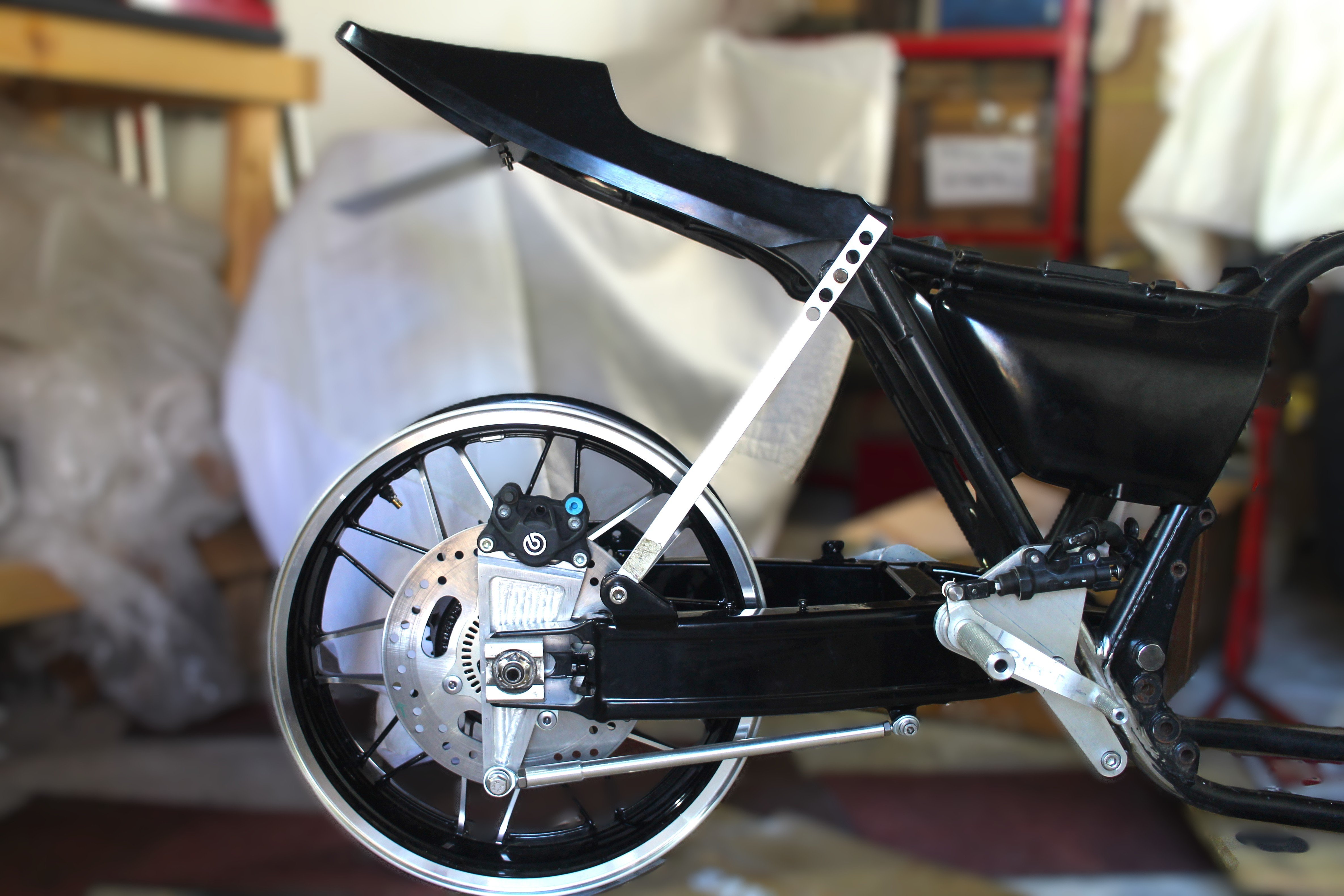

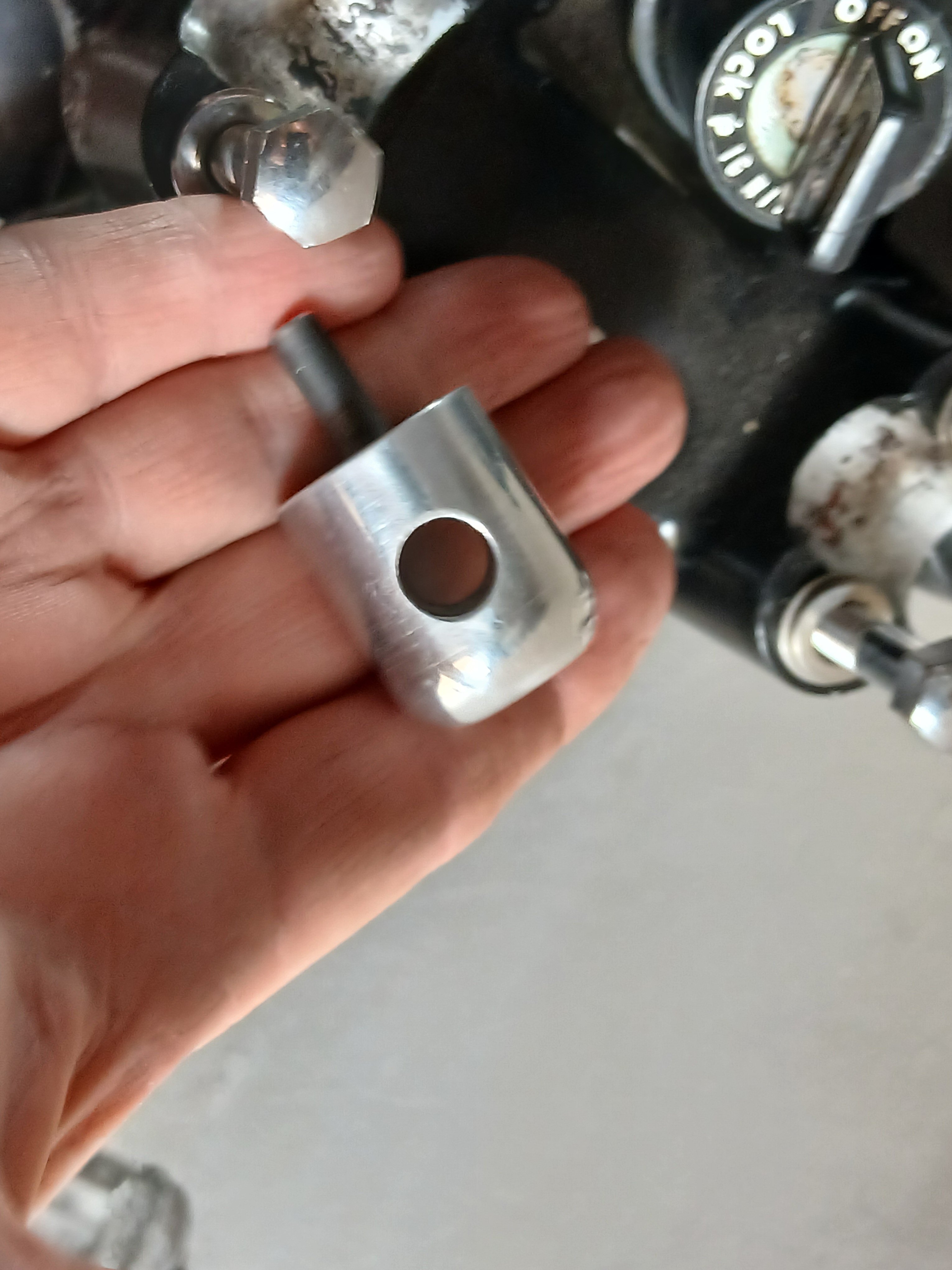

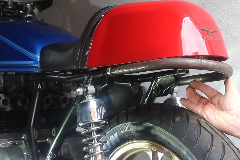

I've been working on the Z650 cafe project recently. Machined a pair of slugs to attach the frame loop to the frame, giving the right length to match the SS900 seat unit. Just needs a bit of heat and a big hammer to get the loop to fit. It'll be welded later.
I swapped the heavy chrome front mudguard for a Ducati replica in fibreglass, along with a pair of replica side panels. Not sure about the latter. I'm making a fork brace to stiffen the forks, now they've lost the steel mudguard.

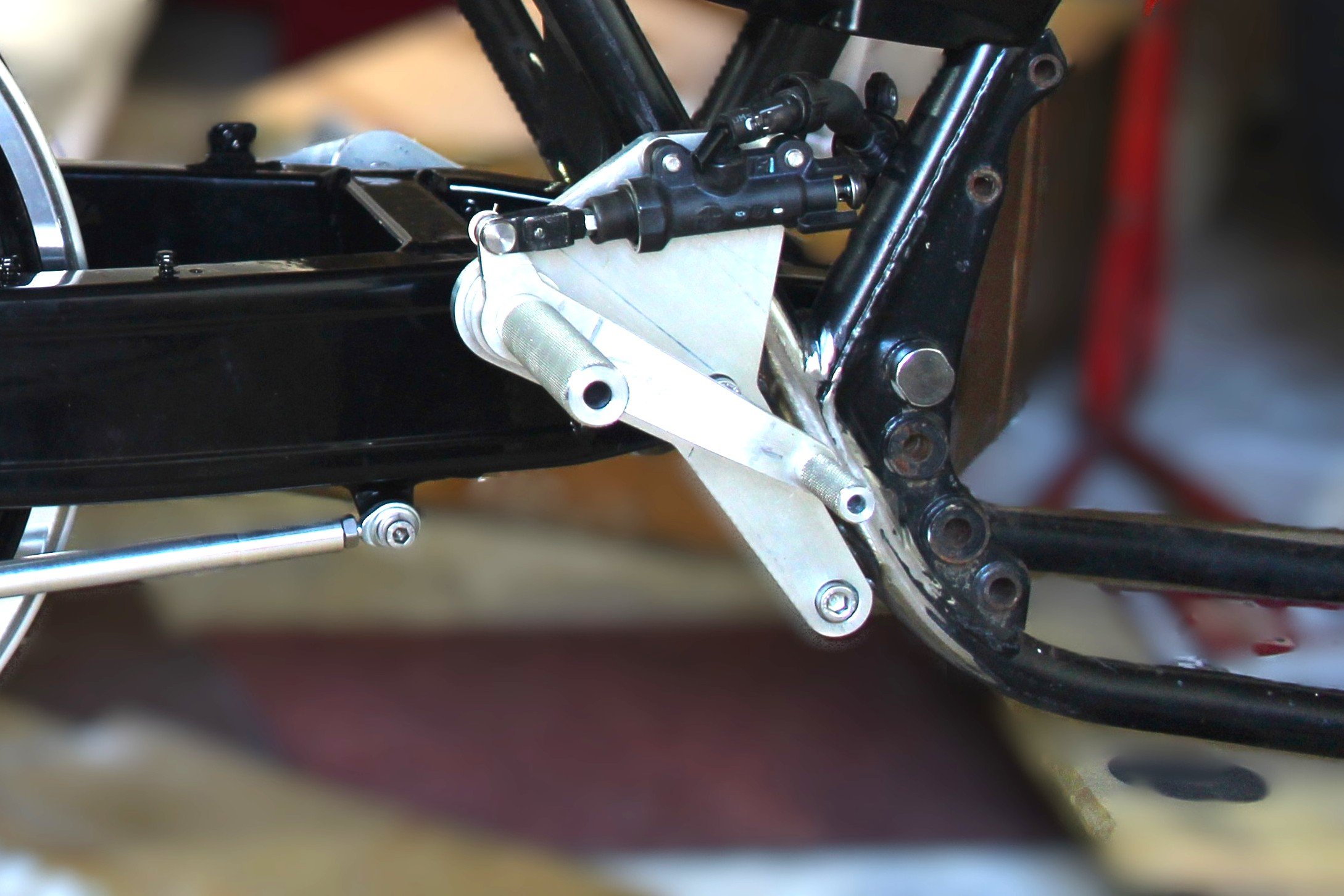

The bike will also be getting rearsets, a problem as it has a rod operated rear drum brake. I'm going to try to make it hydraulically operated. If that doesn't work, I'll have to fit a disc rear wheel.
The slave cylinder arrived, £12 off Ebay, surprised it doesn't have a bleed nipple. Will make bleeding the system interesting..
Also after a lot of heat and a big hammer, the rear frame loop is in place. Works quite well with the Ducati seat unit..
