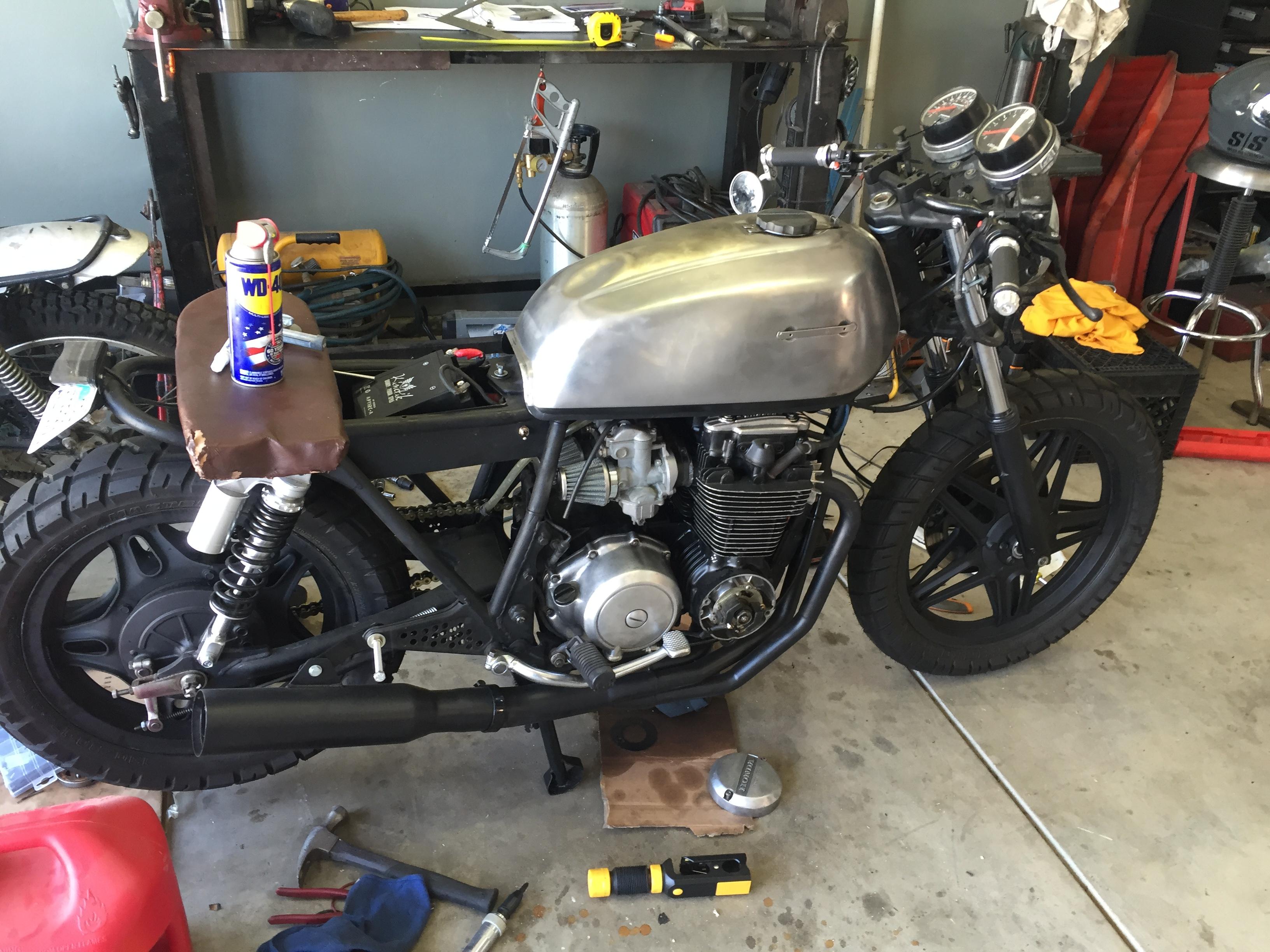

Alright, So picture and video dump! I have been crazy busy with work so bike had to go on back burner for a few days....However after sitting for a few days I took the tank off to look at valves and wires and such, pulled choke cable and hit the starter (with the ever so slightest blow on the fuel line to push out the gas as the tank wasn't on so no pressure from that) and she fired right up....I haven't taken her for a ride because I don't want to get stuck again, and I haven't had the time. So lets go over what I found when I took the tank off.

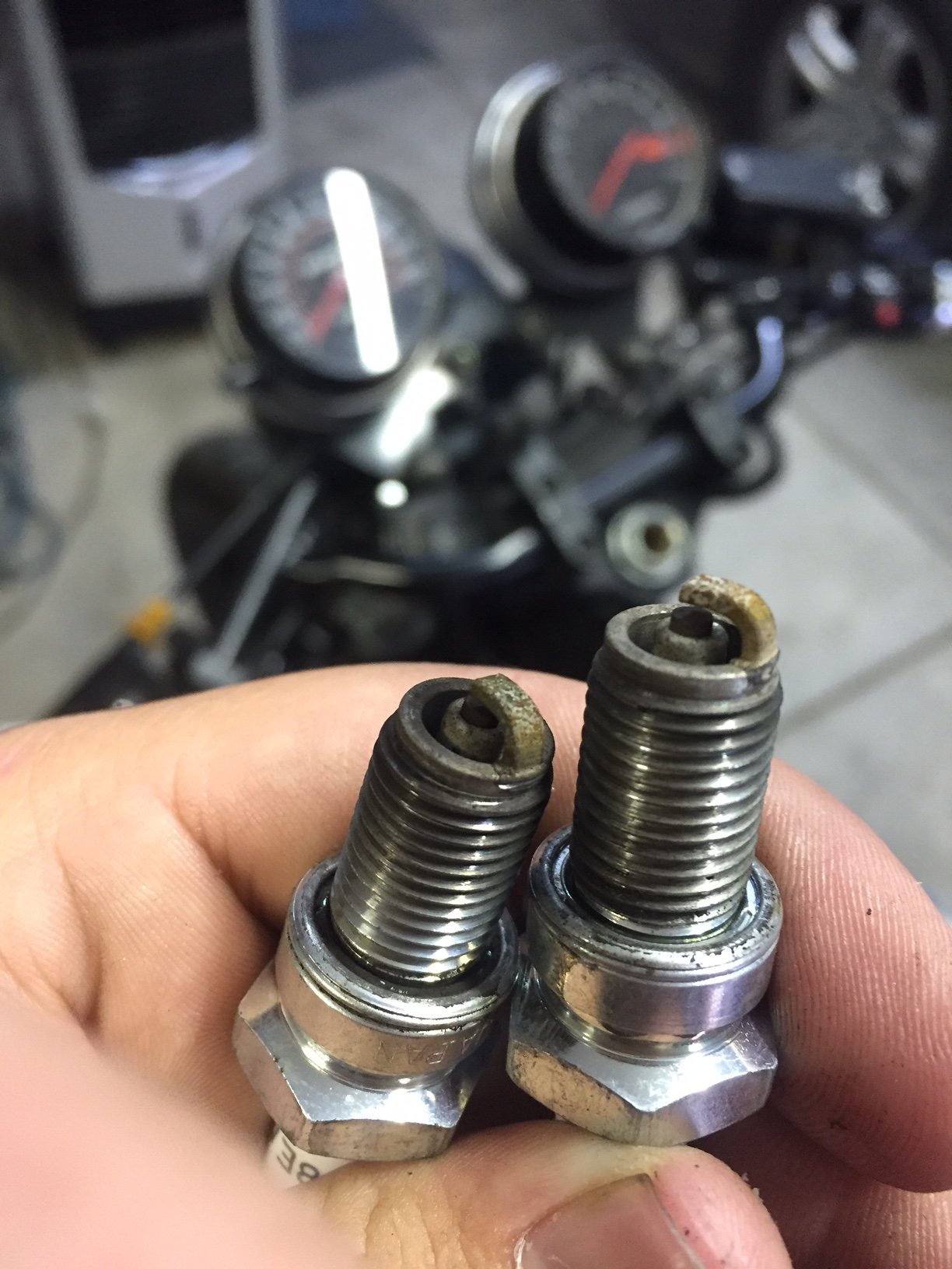

2. spark plugs 1-2, look good (maybe a little lean? might richin up a little)
3. Spark plugs 3-4, same as 1-2

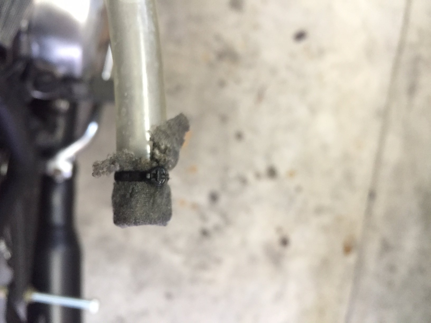

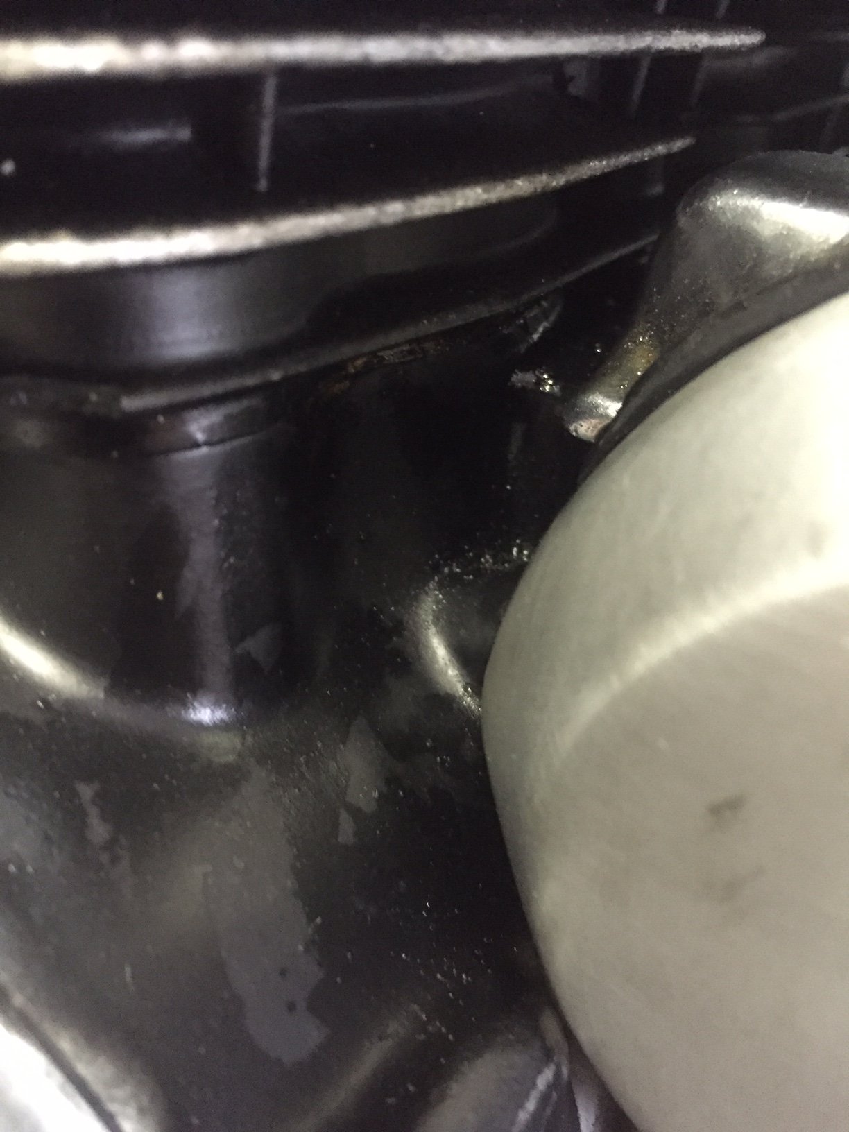

4. Well breather hose looked pretty oily after the bike sat for a few days in the upper triple digit degrees garage. So maybe I did over fill, and that caused the smoke and loss of power? (can that happen? oil getting into the cylinders causing loss of power in the upper rpm and stalling in the lower? [wouldn't this show on the spark plugs?])

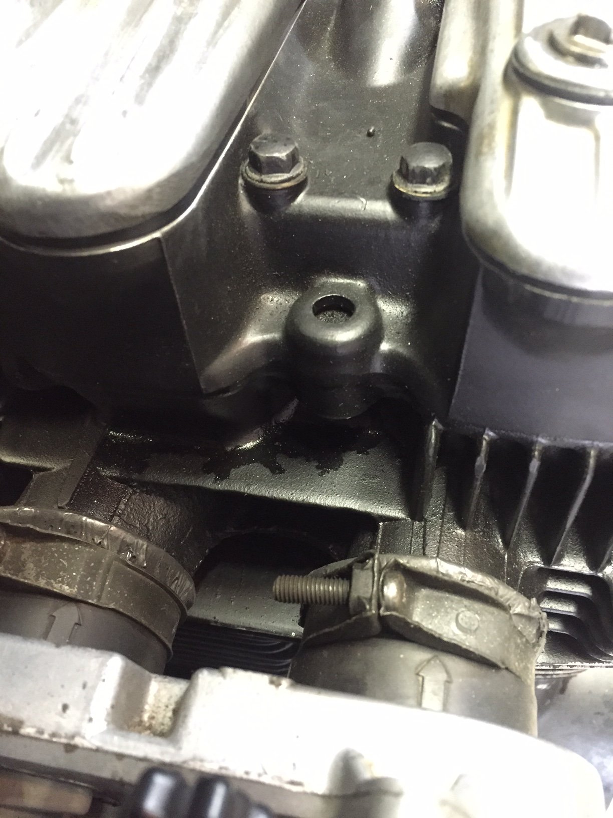

5. Well the silicon didn't hold......Anyone got any great ideas? I would love one of those filter boxes that go over two carbs but I don't have $300, let alone $50 for K&N / velosity stacks......

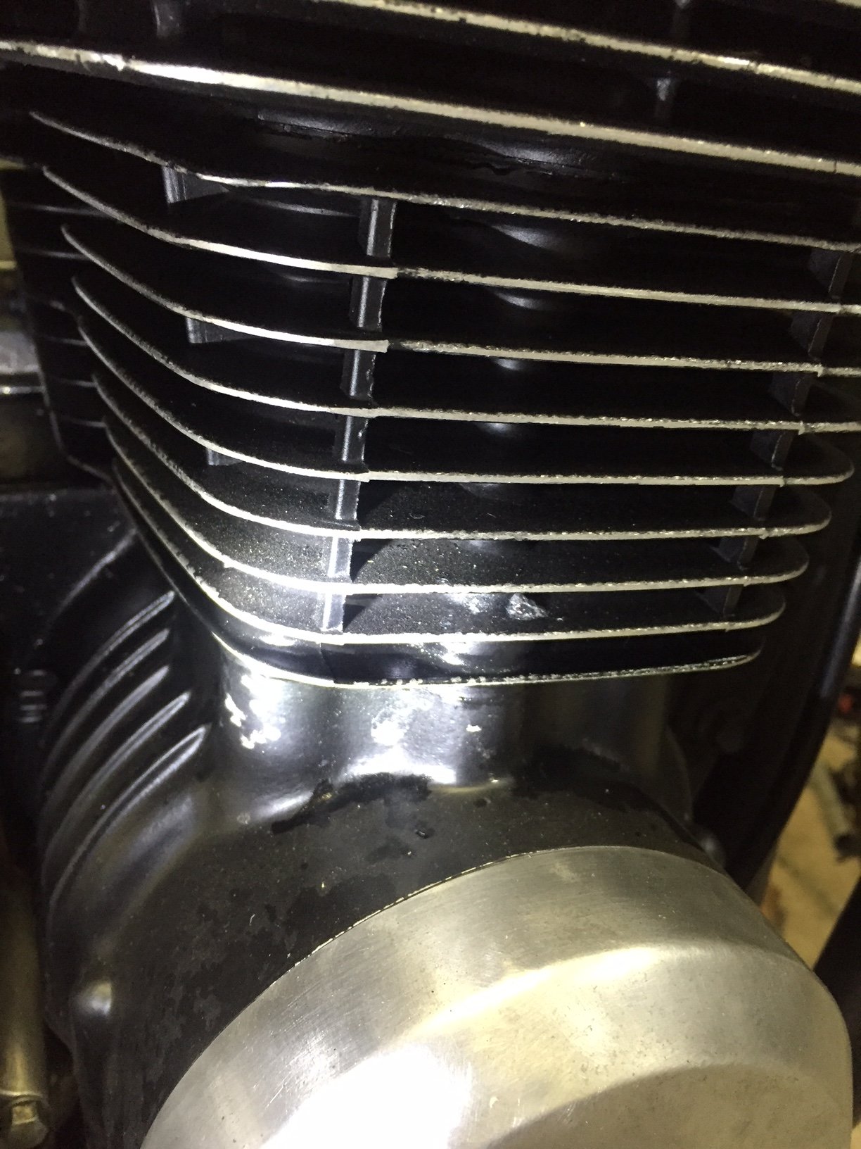

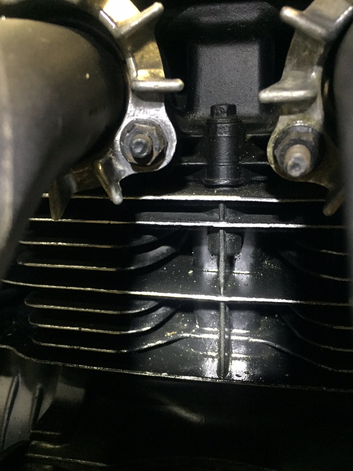

6.-11. Misc leaks with new gaskets and O-Rings, This really makes me think there was too much oil by all the leaks with all news seals.
So what do you guys think? Tank is still off so I can do whatever test you guys need.

Blocked or crushed engine breather causes all sorts of oil leaks when motor gets hot and oil thins down. Gearchange shaft oil seal can actually get pushed out of case. 650, being based on 1974 CB500 motor has most of the issues fixed but the oil feed to cam bearings on outside of cylinders still has a problem as the 'o' ring isn't supported and eventually leaks

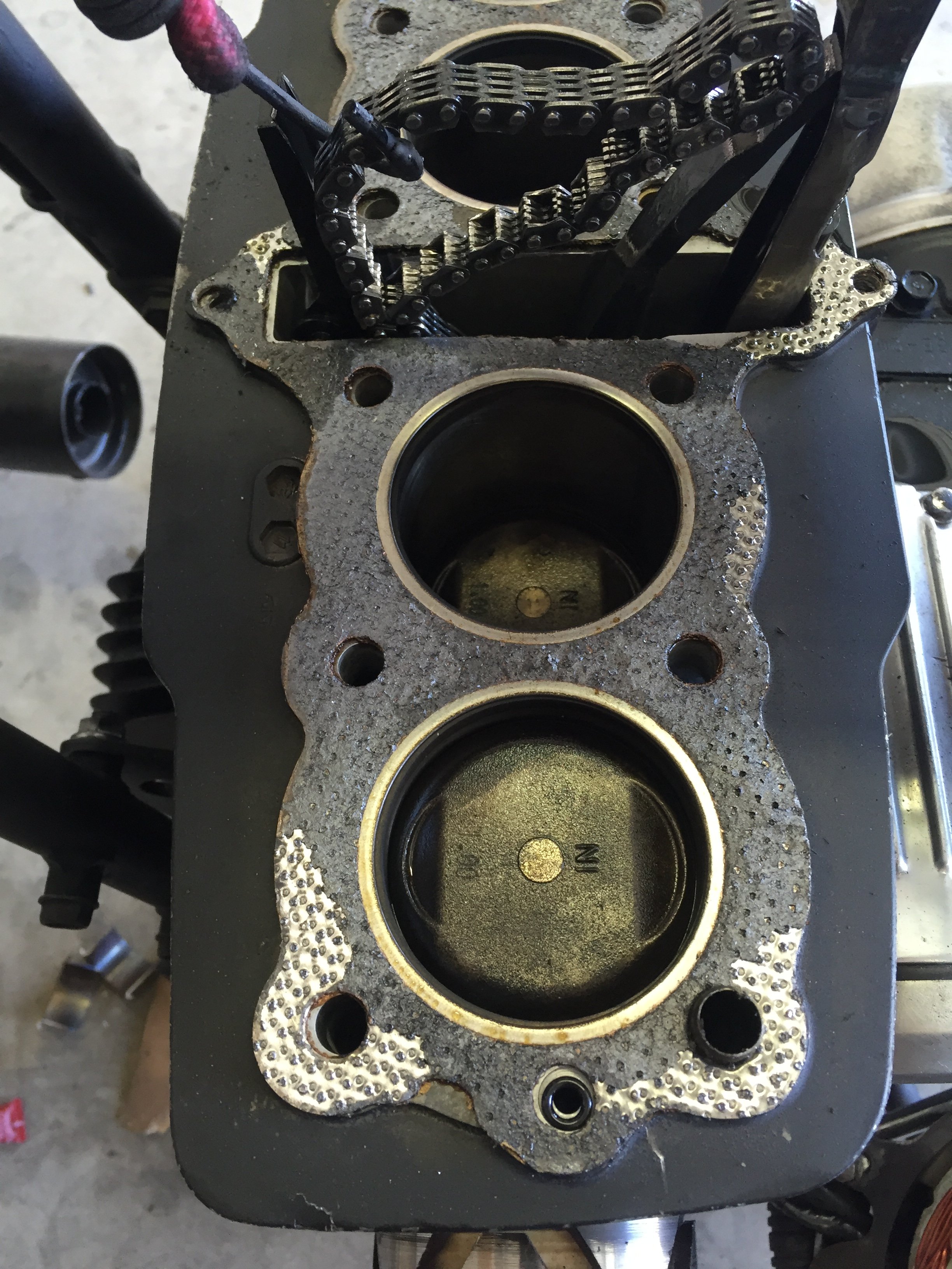

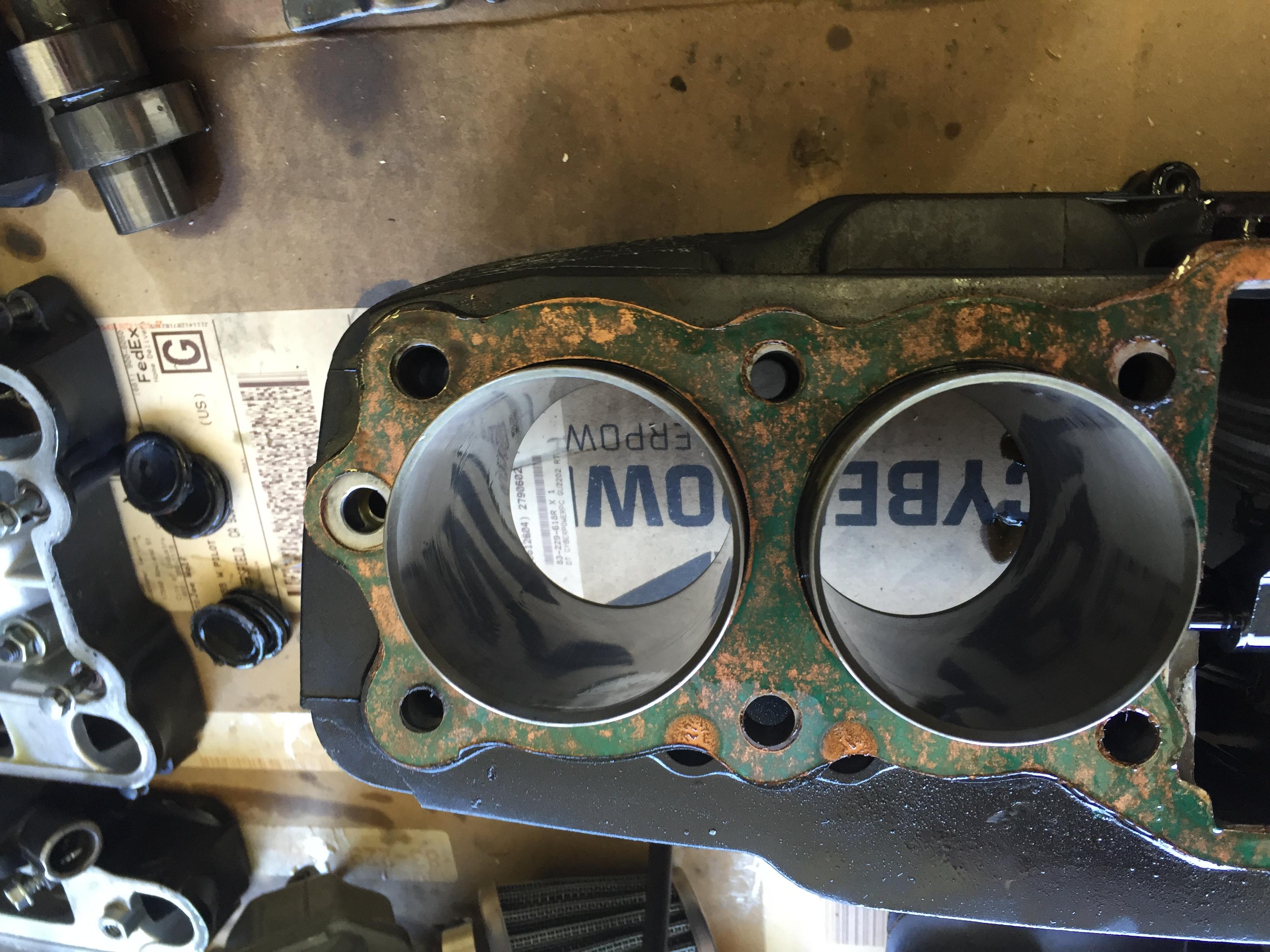

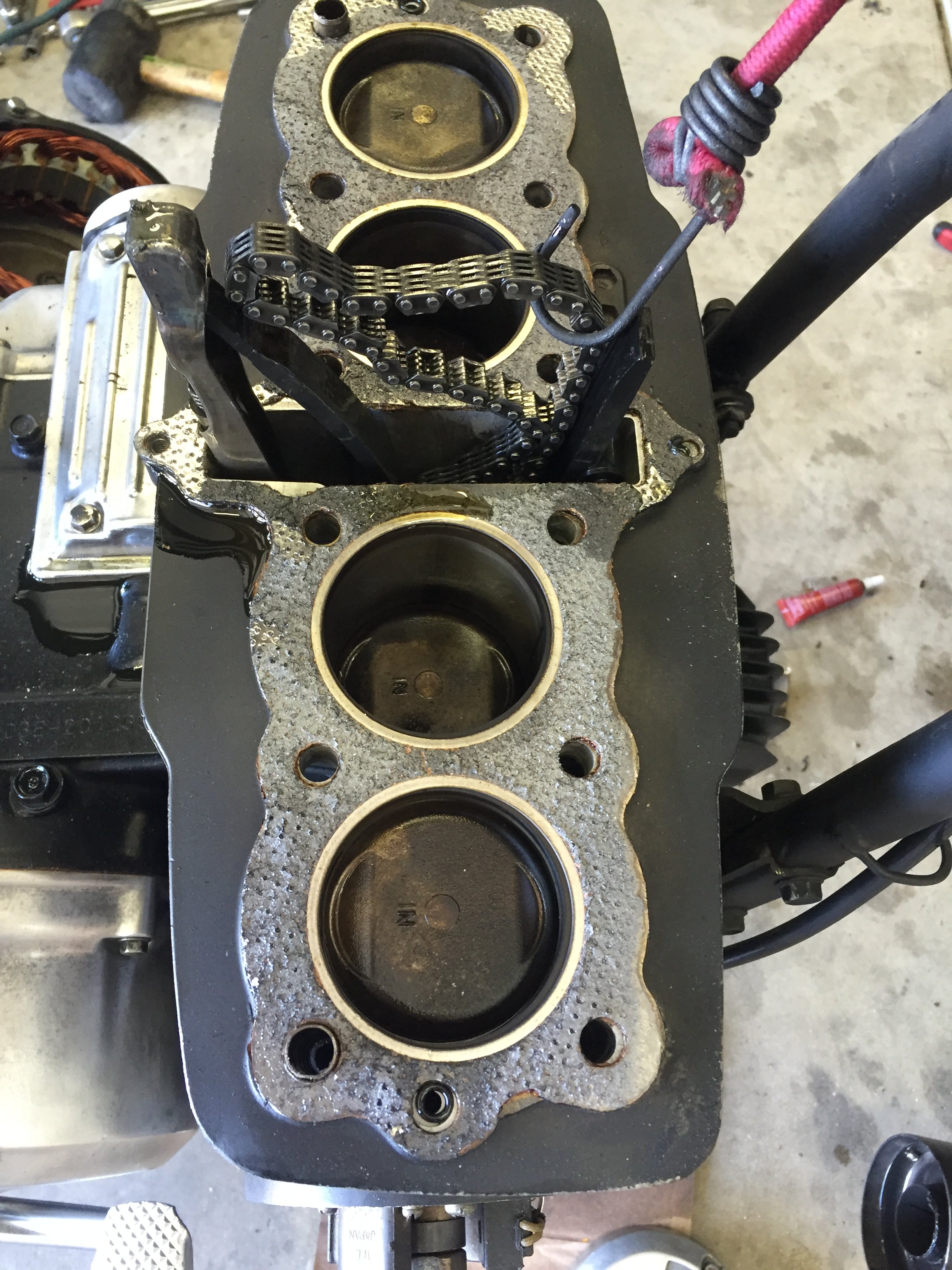

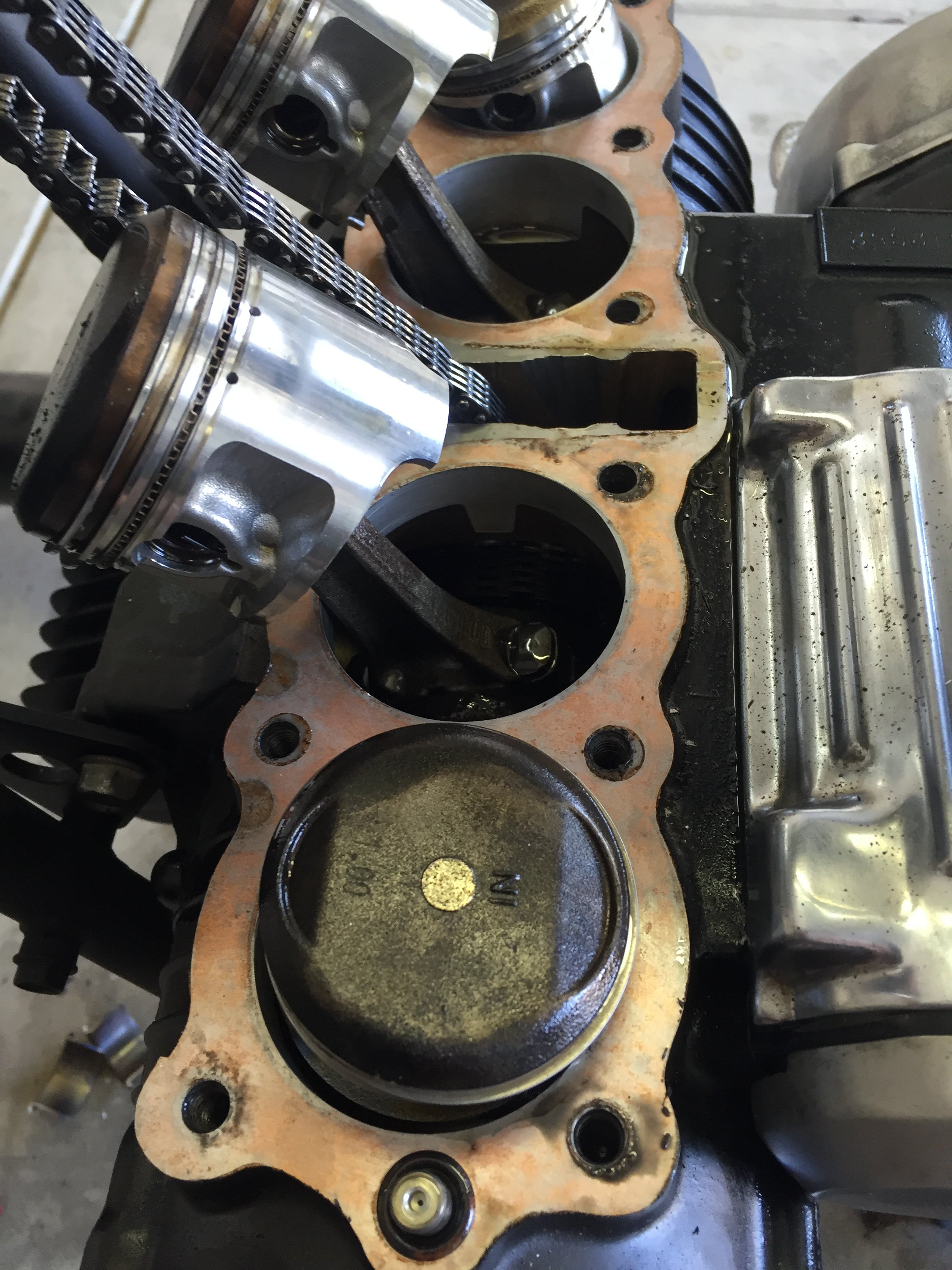

Alright, I am going to spend today taking the top end off to see if I can figure out where the leak is......pray for me lol

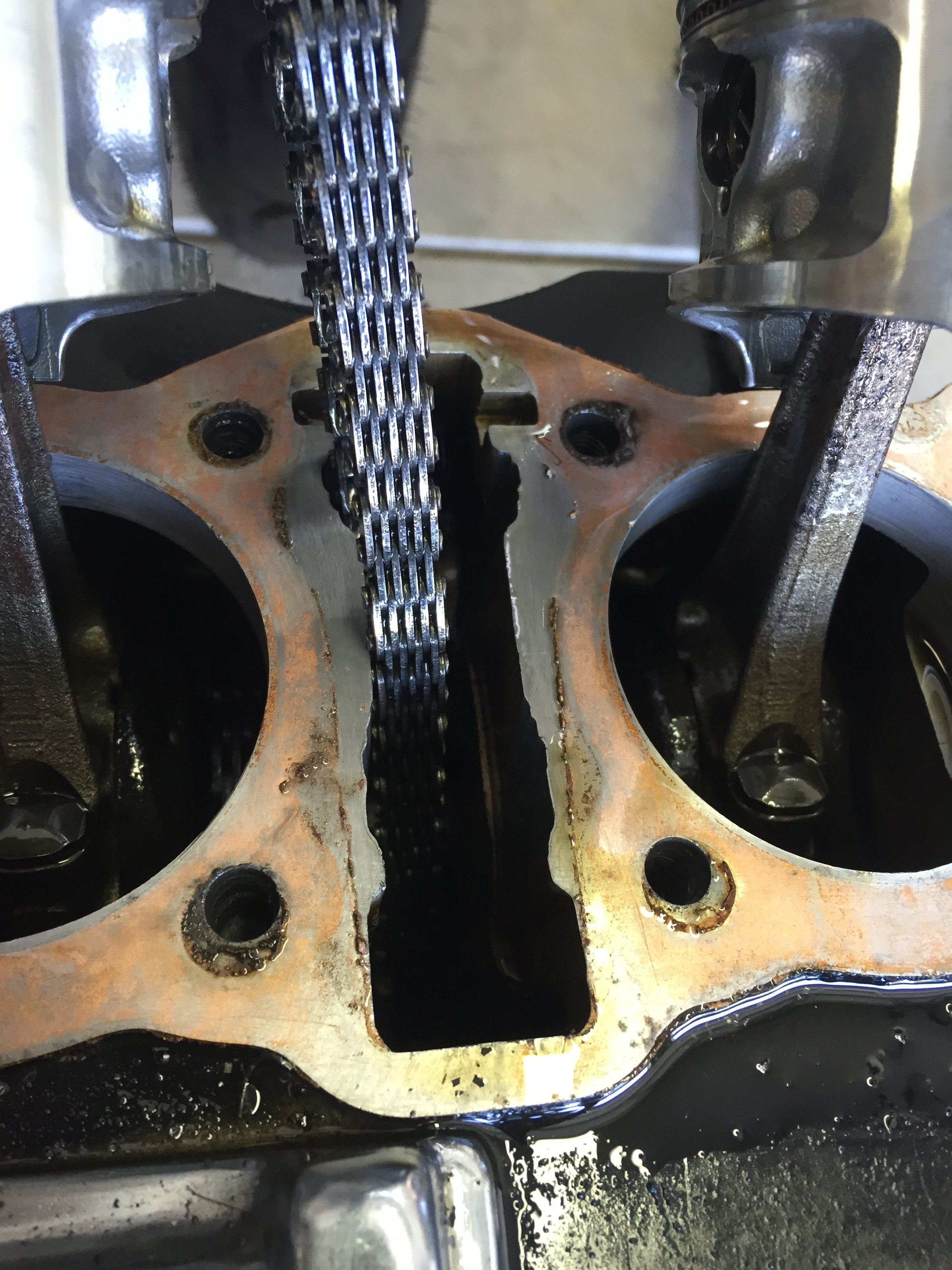

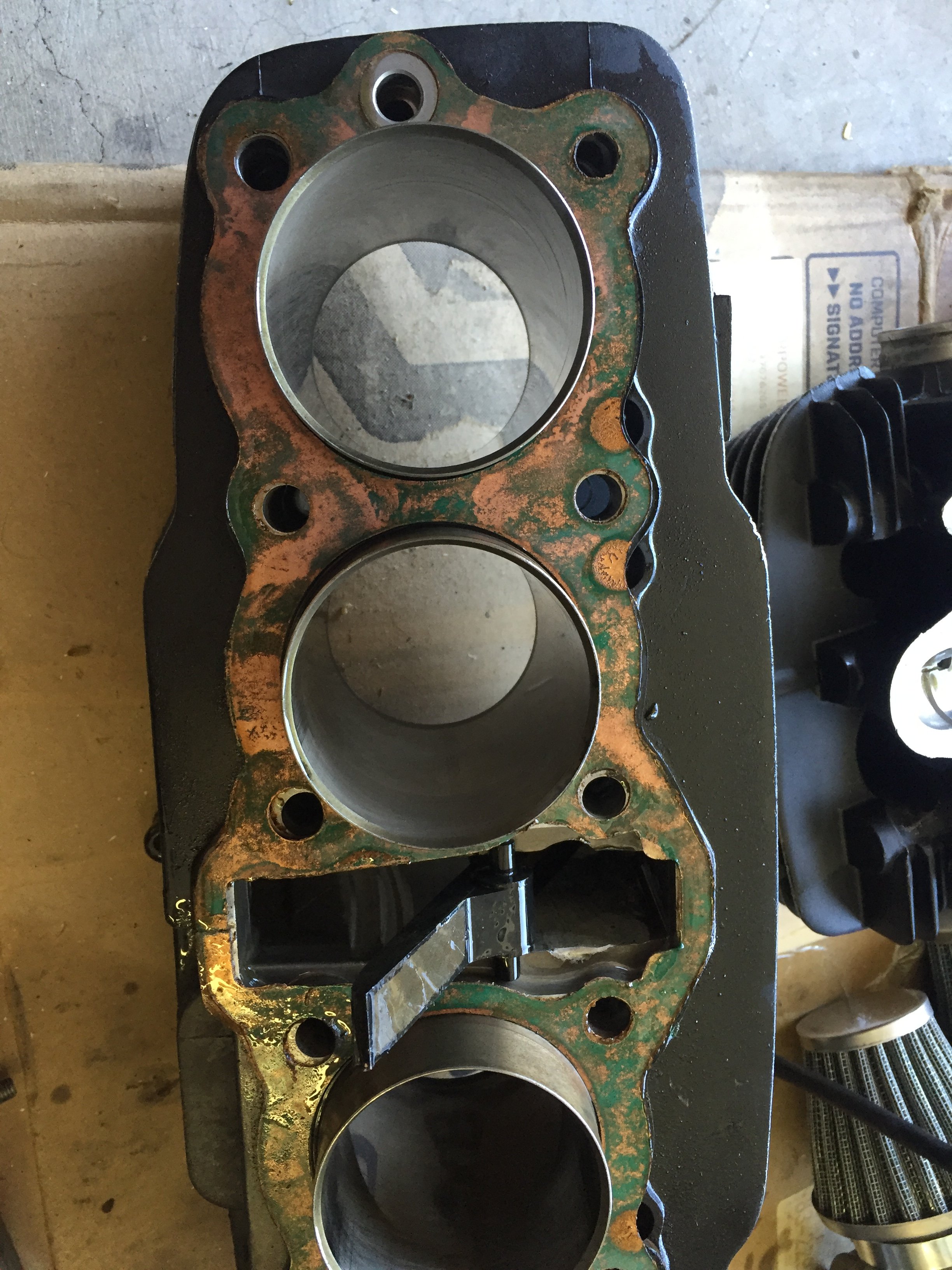

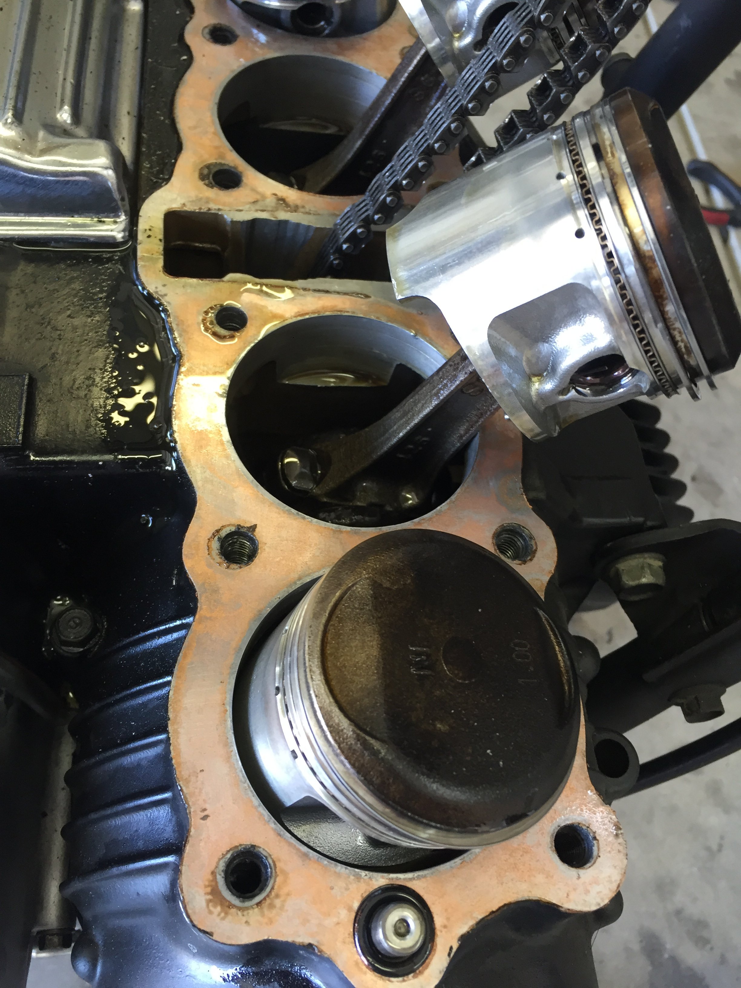

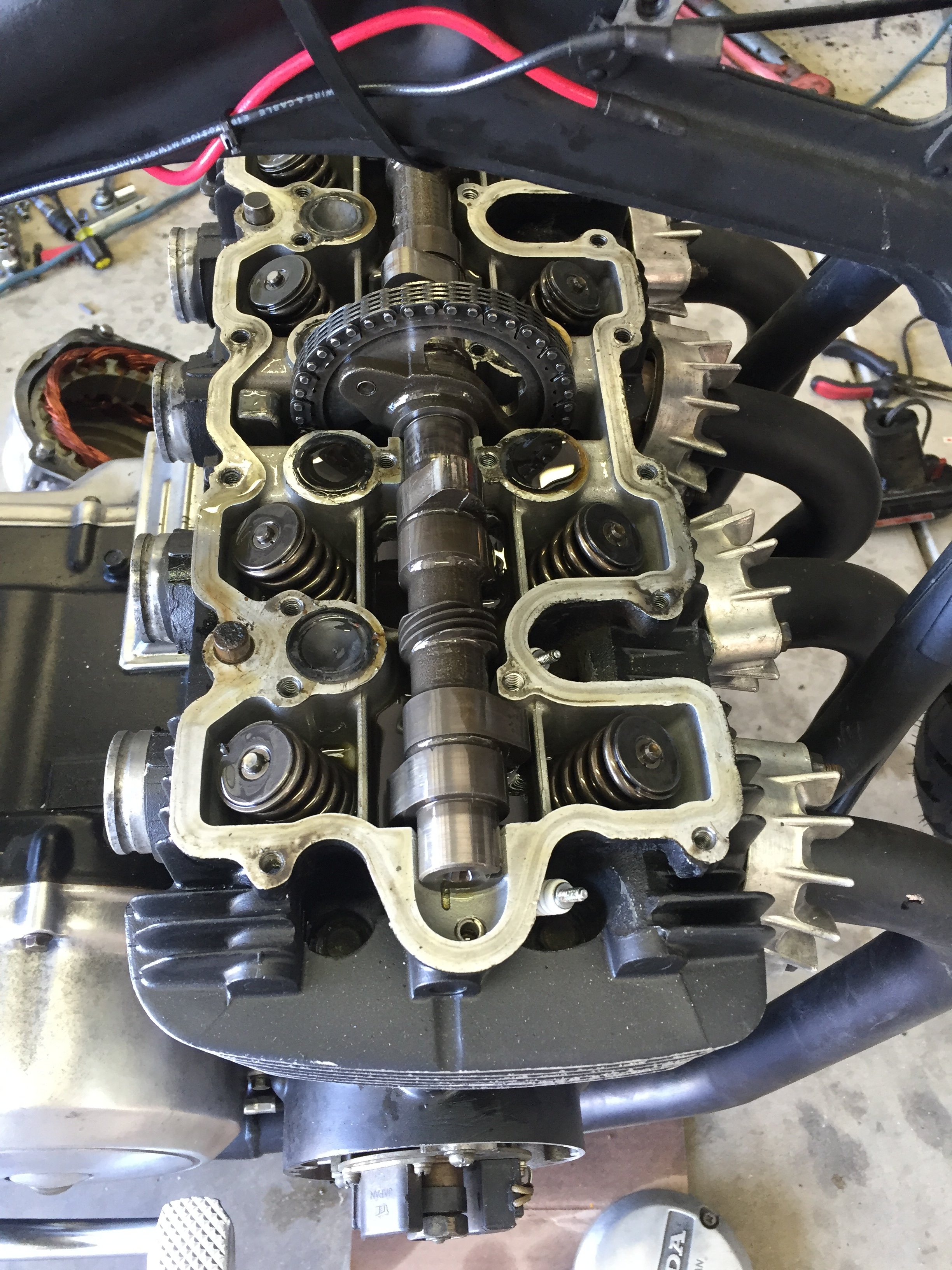

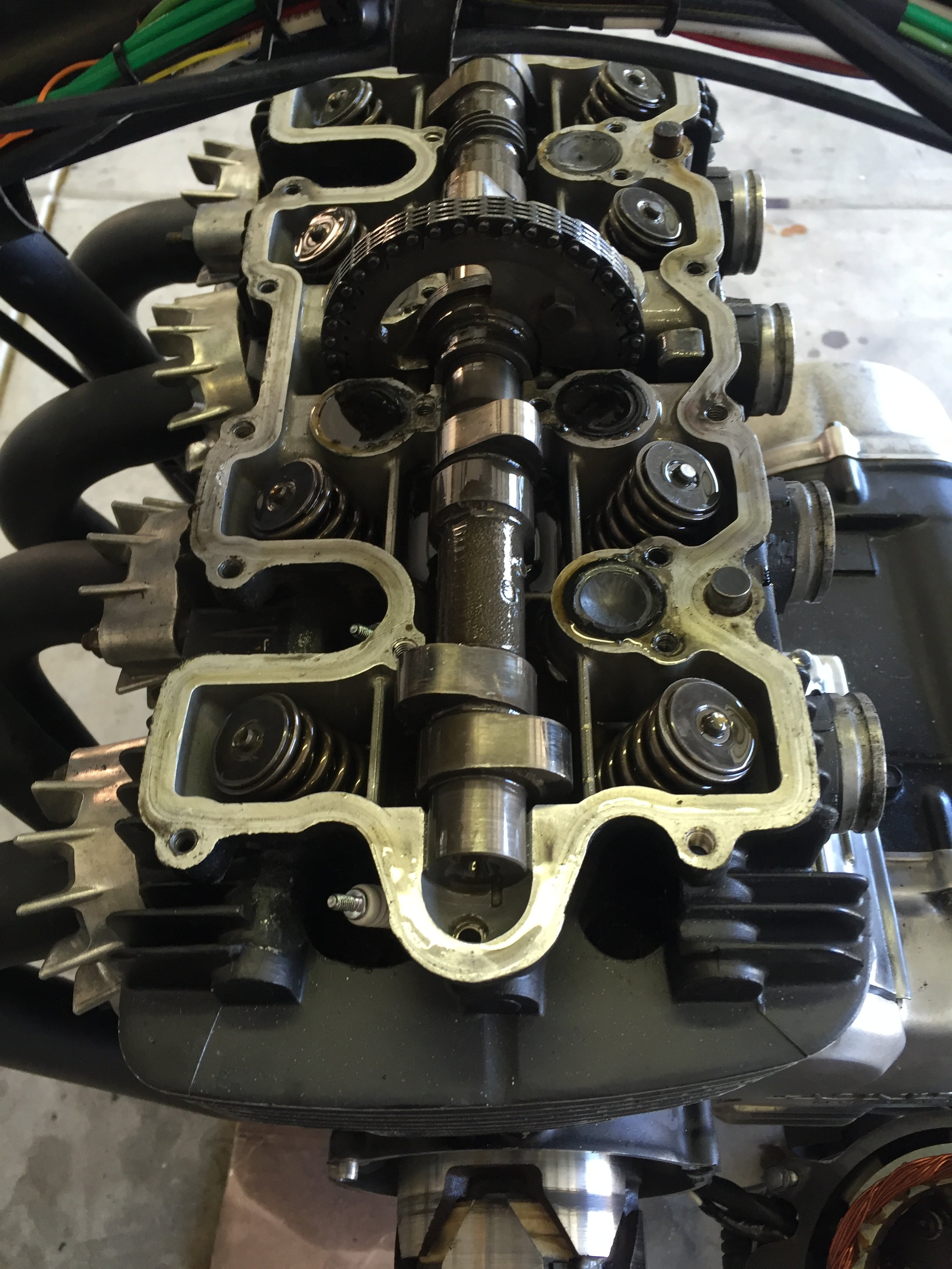

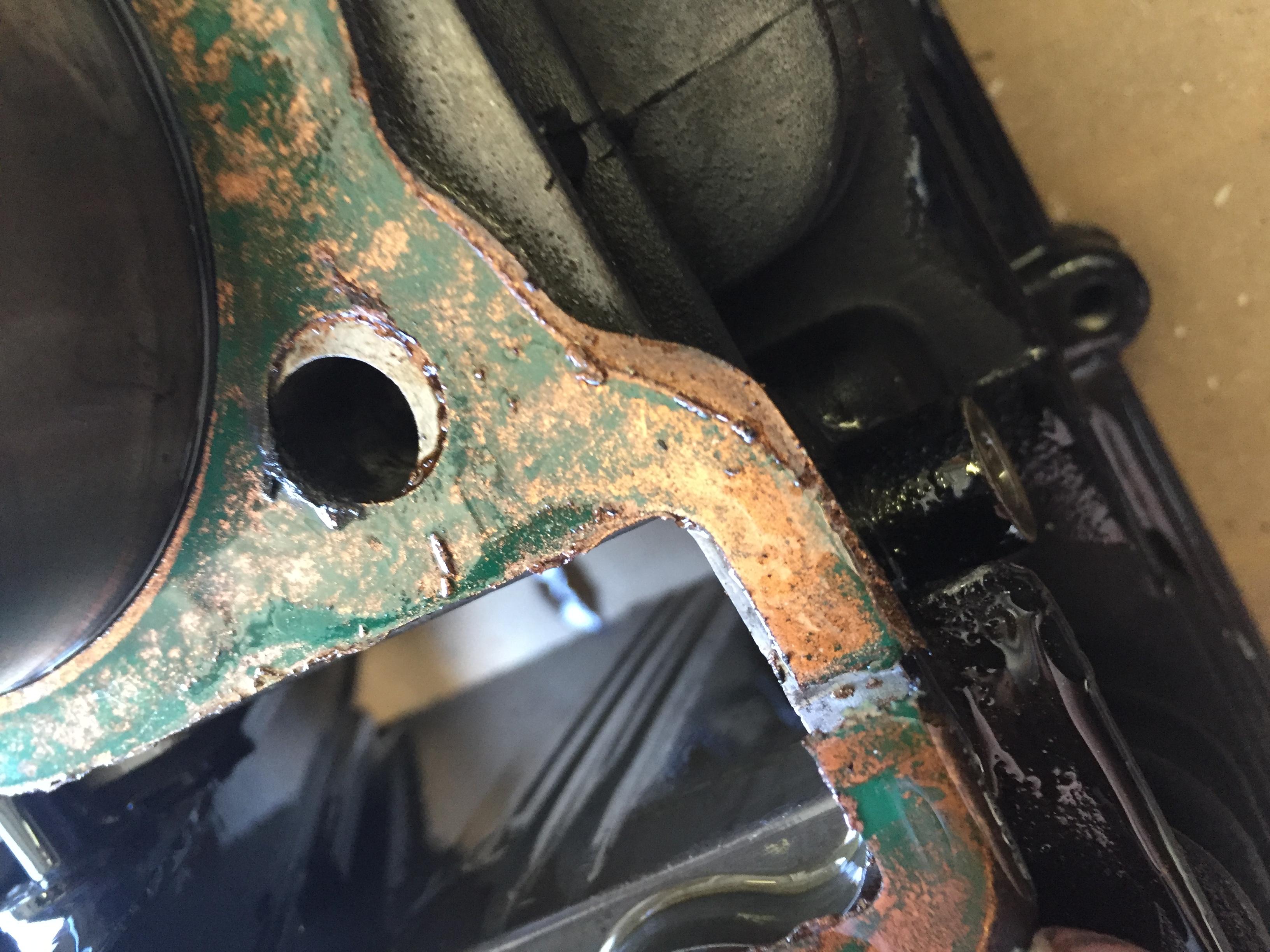

Pic dump, here is what everything looks like. I assume the base casket was cracked before I pulled it off.......that's what I am sticking too. I will be buying high grade cut your own gasket material and cutting it exactly for this head With copper coat spray. Is that suffice or should I see about having it ground? Or get a tiny bit thicker gasket? Everything was properly torqued.
Do I need to replace the head gasket? Which I think is backwards....

You need the metal flame rings in head gasket, personally, I would get copper gaskets top and bottom they have much higher heat transfer capabilities.
Yep. Needs a real head gasket to withstand the heat and pressure and flame front.
Copper will be a fair bit more expensive than DIY gasket material but I think it's worth it.
http://www.coppergaskets.us/
Lani likes having a chat with customers. I've found he isn't much more expensive than DIY if your making copper gaskets and to be honest, it's way easier to just buy them ready made. I would get the thinner base gasket, I think 0.031"?
I counterbored the cylinder on my 550 and fitted a dowel from side cover (approx 6mm hole) Then use an oversize 'o' ring plus open oil hole in gasket. Bike did around 70,000 without leaking instead of the 6~8,000 miles I previously got between top end re-builds.
Don't use aluminium for head gaskets, it can get hot spots and cause pre-ignition
For base gaskets I like OEM and for head gaskets I like Cometic if I have a choice. Copper can work, but I they are more difficult to get them to seal. I agree with Tune that they can be problematic and tend to need gasket goo and I hate to use that on gaskets and on head to barrel joints unless there are no other options.
