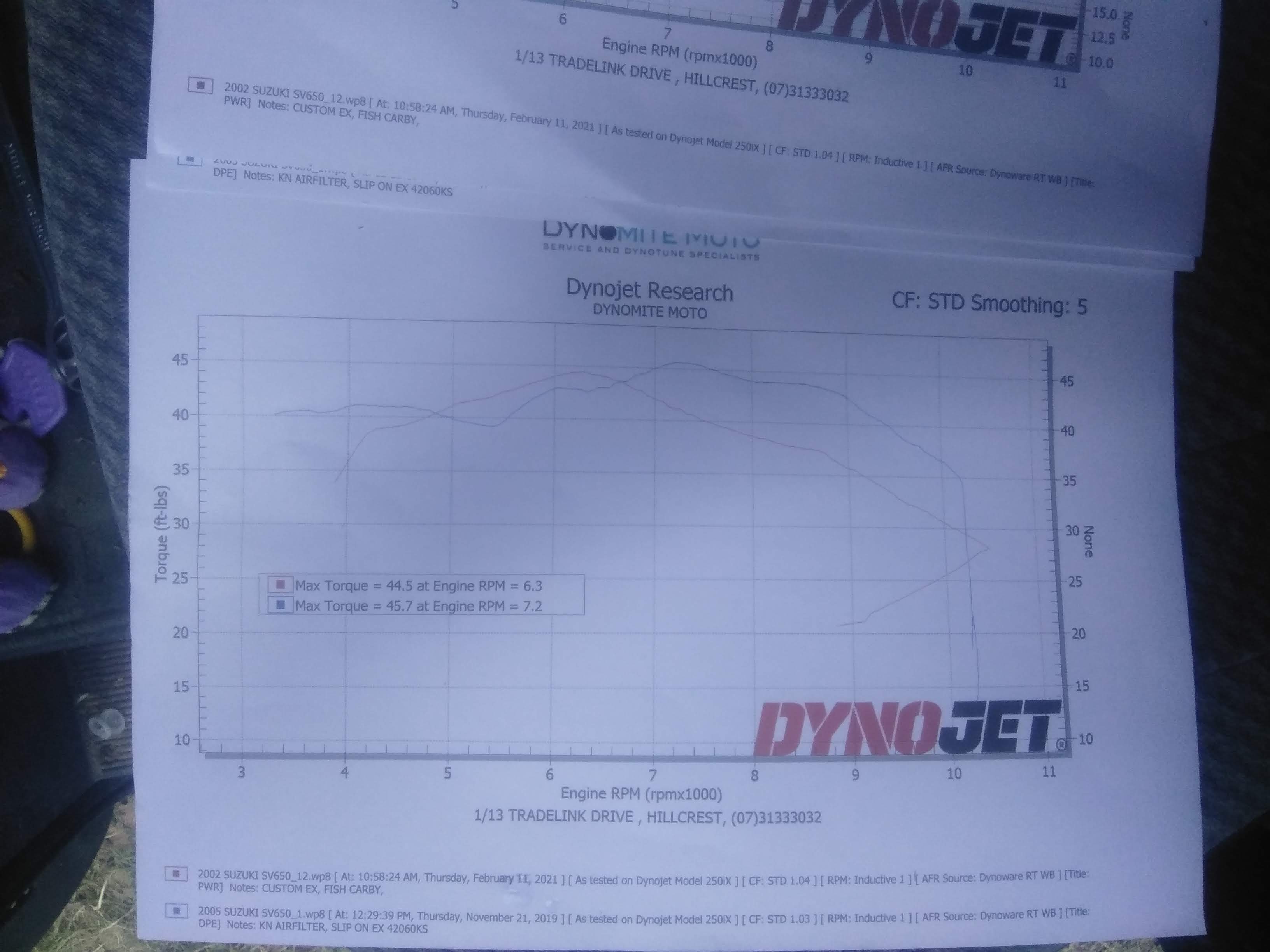

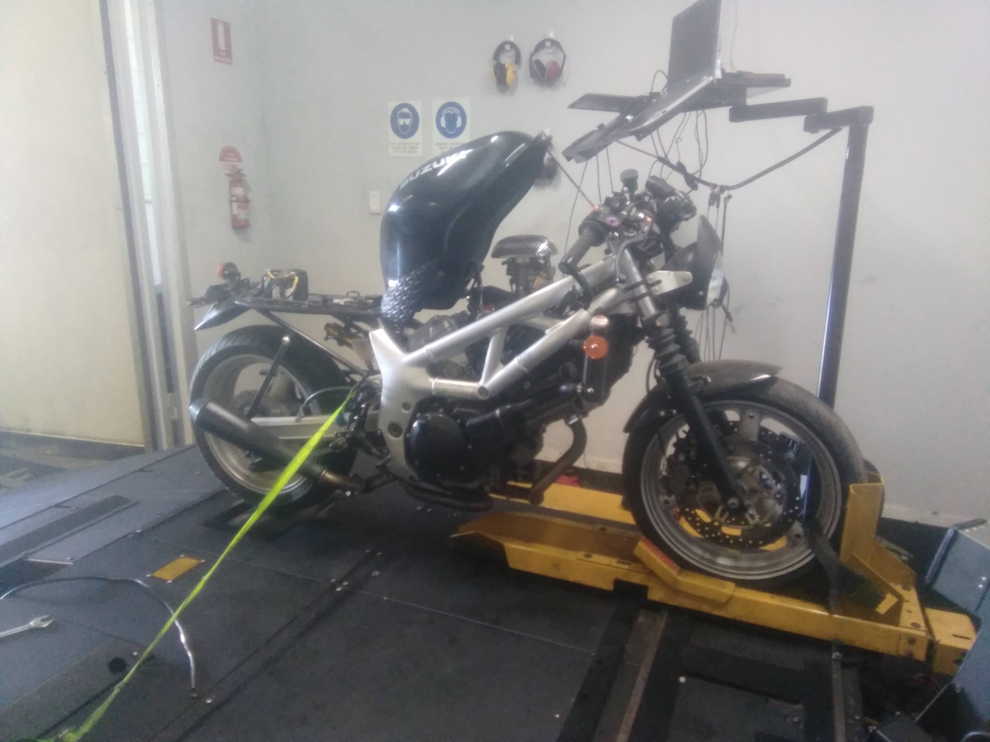

dyno results My base line for further changes

A decent WERA legal superstock first gen SV should be getting 72-75 rwhp. That is a totally stock motor with a valve job and very careful assembly with timed stock cams, thinner head gasket, stock airbox and rejetted stock carbs and an M4 exhaust. My last stock motored racebike made slightly less than that as I had not slotted the cam sprockets and was running a Micron exhaust.

Looking at that dyno chart and ignoring any differences between dynos ( they can be significant), let's focus on Air:fuel ratio.
Was the throttle 100% wide open by 4,000 RPM? If not we have a transient and part throttle issues. If it was wide open, we can focus on that.
At 4,000 it's the same as from 7,000 up to the red line and that's a bit rich all the way. His chart has a dotted target line at 13:1 which is close enough for government work. In theory 12.5: 1 is ideal but the curve is pretty flat around there, so go a touch leaner to 13:1 and it will be close enough to spot on. The GS is quite a bit rich all the way up the rev range, so I would lean out the whole thing slightly before tweaking the 4-7 region. Watch the torque curve and it should rise across the whole curve. When that's right, start looking at that lower rev range.
Not too shabby for a first dyno trip.
I think that is a pretty good first run. The SV is very sensitive to its intake and exhaust. Teazer has given some good ideas that will get you closer to 70. I suspect that some cam timing adjustments and some exhaust work will gain even a few more hp. But, if you get close to 70 with good drivability it will be a great street ride. Keep it up, the SV is a great bike. I guess I better find the missing spark on mine before Spring.
Kept in mind this is an experiment using a single vintage throttle body similar to ones used on some early nascar
Unlike a carburettor you set up the max fuel flow and the metering shuts that flow off down to idle, mid range is adjusted by moving the throttle plate so the air supply matches the set fuel,
Because this is a custom application it wasn't designed for motorcycle applications and the throttle plate ended up set way in the rich direction to get enough fuel mid range after restricting the top end adjustment so much to suit the small engine, but the metering can only move so far.
End result rich idle and at full throttle the plate was sitting about 5 deg off full open. That is how it was for this test.
So I hope drilling the fuel spray bar for more fuel will let me open the throttle plate in relation to the spray bar/throttle shaft a little, fixing all issues
Fingers crossed

My torque curve compared to later efi model with k&n filter and slipon.
