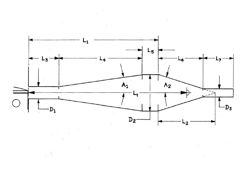

Thanks guys. I'm having a lot of fun building this thing so far. The pipe has been on my mind a lot lately since that is getting near the top of the next-to-do list as time moves on. I really, really, really want to run an underslung pipe but I just don't see how it is possible to do, even from a length perspective and not even diameter. I need about 53inches of length without a stinger tube and muffler even. If I snake the thing around the front of the frame and soak up a foot or better underneath the radiator and come back under the frame, that's still better than 3ft to put somewhere...lol.

redwillissuperman said:
You sure 53-inches is correct?
198 degrees (with Power valve wide open)
x
1,700
= 336,600
336,600 / 6500 = 51.78
And note that "Lt" in the second diagram is the "Tuned Length" which is the point in which the wave reflects back, but is not to the complete end of the convergence cone. But, Lt also is measured from the face of the piston, so between the length in the exhaust port and flange, you could probably shave off about 3 inches, which would get you close to evening back out to the end of the convergence cone. But still no stinger tube or muffler.
In the 3rd screenshot is from the old 2 Stroke Pipe Wizard program I used initially for the pipe I already built, but I had it set for 7500rpm and thus the pipe is a little bit shorter. You'll work out 1306mm tuned length to be about 51.5inches. I wish that program worked with windows 10, it'd make my life a lot easier but I have now done all the math with a calculator (and a friend, ha!)

That may be an over simplification since the soundwave speed is a function of the exhaust temperature. You may just want to double check here:
http://3cyl.com/mraxl/manuals/chamberdesign/2003exhaust.pdf
Re: Building my own two-stroke "Mongrel" - Inspired by CharlieT & TedT
Never saw that book before, will take a look. I based my new dimensions and parameters on Gordon Jenning's old book. While old, Its still a great resource and his formula while not nearly as complex as something like Blairs has produced a good number of pipes. The 1700 figure for sound wave speed is based on gas - obviously different speeds for different fuels. Will definitely take a look at this though!
