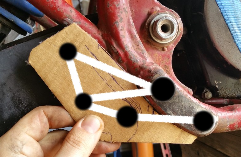

Did work with Dad a little and came up with a plan on the pegs based on the suggestion here of sonic's decided on a way to make a bracket that'll bolt to the frame, and then allow me to bolt the pegs onto that bracket in the position I want. Essentially, 3 threaded bosses to bolt the rear sets to connected by 1/2in Cold Roll. Thence, 2 bosses bolted to the frame in the original locations (with new fresh threaded inserts welded into the frame) that will have a bit more 1/2in cold roll going from there to the other pieces holding the rear set mounts. Something along the lines of the attached diagram, essentially. Without the cardboard backing plate.

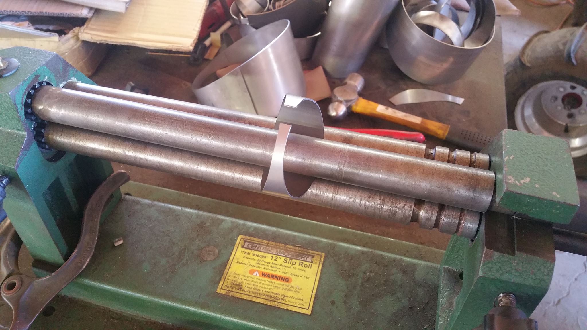

I also started tinkering with the stainless exhaust sections, and frankly it is kicking my ass. I would call myself a pretty good tig welder since I've been farting around with it since I was about 15 (now 30), but I'm having a hell of a time with it. Been chatting with a friend that has tons of experience on it trying to figure out if it is me or my old transformer based machine that isn't playing well at low amperage, yet to be determined.
Heres some of the sections I've been rolling for the pipe

I don't necessarily follow? The skeleton bracket I made uses the existing 250R frame foot peg mounts, and then goes to the 'busa sets, and everything bolts into place? The aluminum plate was my fixture. The mount with the 5 points, is the bracket. You're saying just make some new tabs to bolt the busa pegs directly to the frame? It's not quite that simple with where I wanted them to wind up at, you can go back and look at some of the pictures of just the adapeter on the frame by itself to get an idea of what I mean. I'd really need to box in a section behind the frame cradle with some threaded inserts. The problem is, the swing arm is so close to the inside of the frame and the sub frame, you don't really have room to do that without getting too close for comfort IMO. That has been the one challenge with these sets, is to get them tucked in enough they don't look goofy, but also far enough away the banjo bolt and back part of the master cylinder doesn't get into the arm.
Right. In your last two pics, you have the Suzuki peg assembly behind your new skeleton bracket. I can see it looks tight, but you can make any needed clearance by simply moving it outboard. It would still be tucked in very considerably from the original outboard location in the first pics. Put some washers under the skeleton "jig" where it bolts to the factory mounts to mock it up, holding the peg assembly in the right location to allow space for the permanent weld on tab behind it. It looks like there is enough space behind it in your last pics as you have pretty nearly the diameter of the frame tube available for depth. A piece of 1/4" plate welded to the frame threaded to accept the peg assembly mounting bolts should be plenty strong as the mounting points are so close to the frame. 1/4" steel plate may not be the most "trick" material, but it would be much lighter and cleaner than your very nicely made skeleton bracket.
OK, so I took another look at your pics. Your original cardboard pattern looks perfect, though I see you moved the peg location by the time you made the skeleton bracket and rotated the peg assembly so the upper mount is over the top of the sub frame tube. This might require a bit more surgery to get your mounting plate in the right place - if you want to keep your current location/orientation you'll have to notch the bottom of the sub frame tube to let in the plate, but obviously you have the skills to do that. On the positive side, that makes the mount even smaller, so stronger and lighter!
I follow what you're saying, but I guess I'm just not totally on board with a plate/tab setup. That was my idea and plan with the cardboard template originally, but I had changed my mind.
My aluminum jig could bolt right onto the frame and do what you're saying, but I just liked the idea of a bracket moreso. Its solid as a rock this way, I have my doubts even a 1/4 in plate would be more sturdy especially with vibrations and side load over time, but never know. I have to keep remembering I'm not riding this thing off road and certain components will not get near the beating I am use to. I really like how the bracket looks. I had figured in my head while I was building it, to go behind the busa rear set, but I like the look and design so much after finishing I want to figure out how to get it on the outside, basically.
