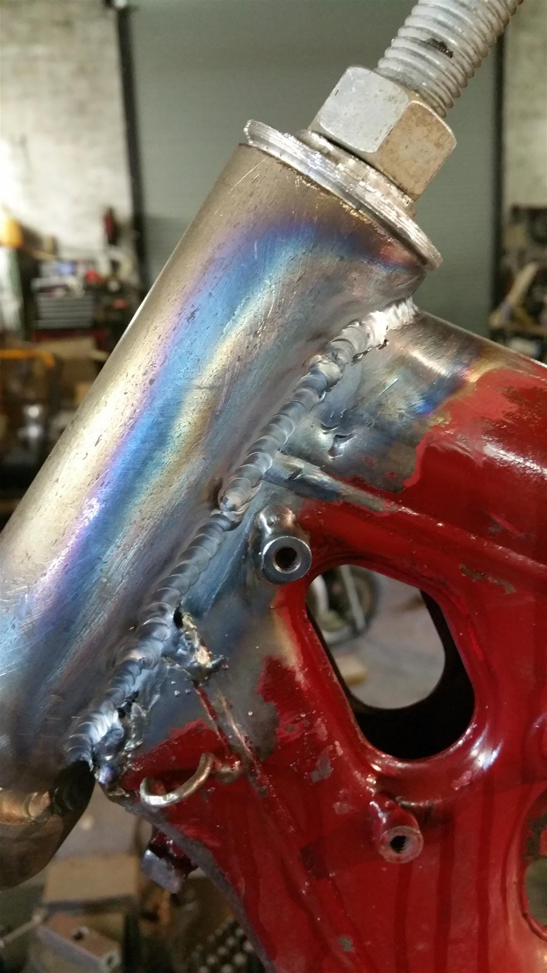

Well I crossed a red-line, no going back now :)
Need to leave it in the jig, have to go out of town for work for a few days, want to add some triangle gussets to catch the bottom of the steering neck back to the frame and over its old steering stops. Contemplate putting a saddle gusset to wrap around the neck also perhaps...have not decided. Frame was kinda rusty and thinner than I would have liked there.

So I wanted to add some triangulated corner gussets on the bottom of the steering neck back to the frame. Mostly because in order to help compensate for the different in front and rear tire height, i needed to slide down the steering neck, so I couldn't really "center" it perse on the back bone.
I am firm believer in recycling. There is a piece of a chain case off of a Bucyrus-Erie 22B Dragline that we use to own laying around the shop. Dad had the foresight to keep that cover when we sold the drag line because it had a lot of good steel plate in it.. ;D You'll see the first one I cut laying on top of the plate I was marking out as a template next to my throatless shear. Material was 3/16ths and a bit much for those, but they got the job done. So now this project has portions of Honda, Suzuki, Bombardier, and now good ole American poured steel from a Bucyrus-Erie circa 1950'ish.
Next, This is the final picture of it in the frame fixture after cutting and welding on those gussets on each side (You can compare to previous pics to see how much reinforcement went in on the bottom). Also gives you a good over view of what my fixture looks like. One thing that was a little bit trippy, you'll notice that the frame is positioned completely different in the fixture. That is because when I built the thing I didn't ever really think I'd be using it for this. I figured I'd be replacing bottom frame rails, checking back bone for straightness, etc. So I had to take degree measurements on the frame before I put it in there, figure out the difference once it was mounted to make sure my rake wound up staying where I wanted it to be. The fixture has literally kicked around on the shop floor for about the past 5 years and it took some figuring to get it dialed back in.
