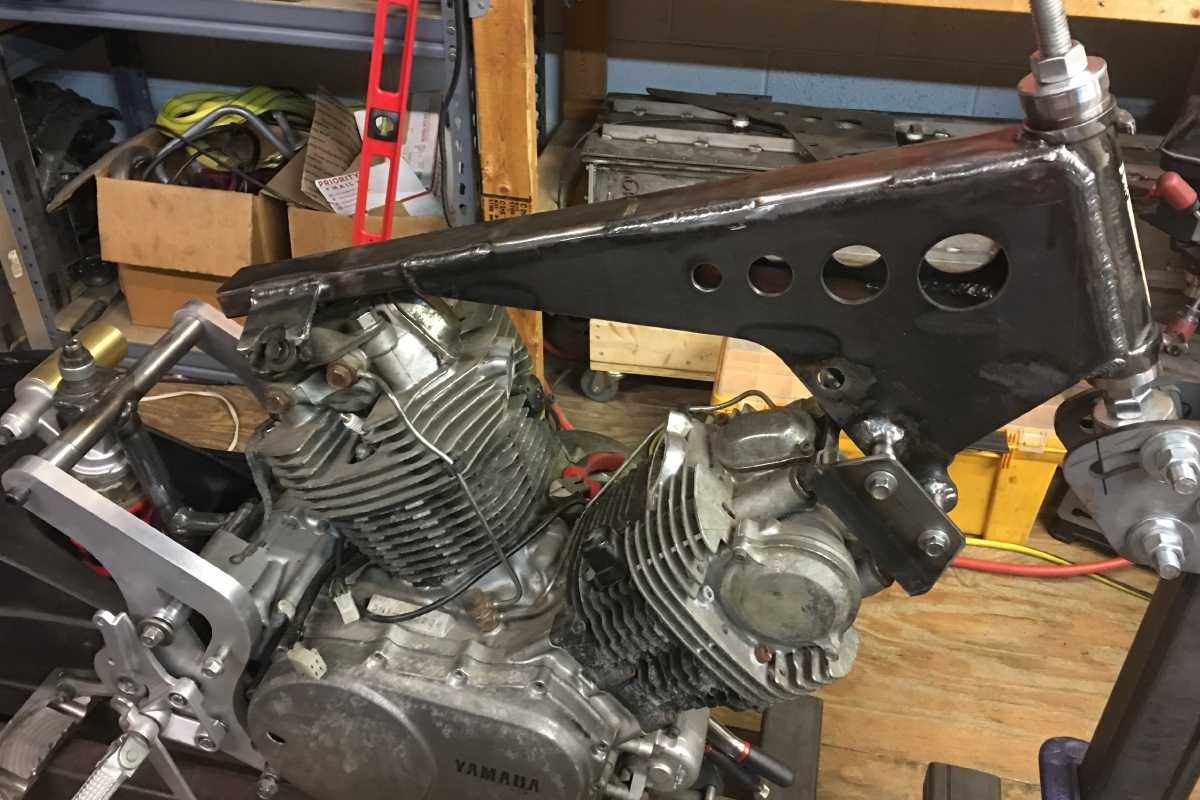

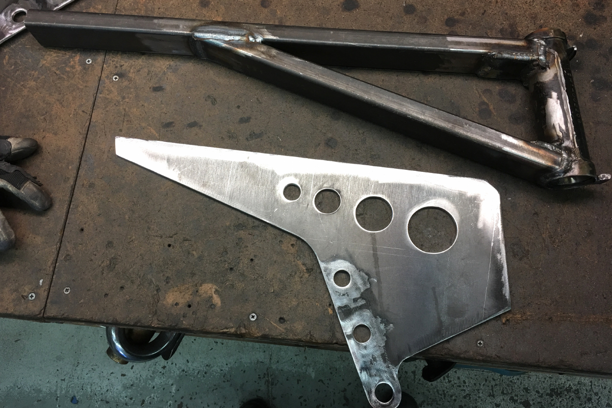

Frame is almost done. I used box tubing to make the main part of the frame and welded it to the stock head stay. I designed and had two support plates cut out to box it in. The plates will attach to a custom bracket mounted to the head similar to stock. I had my frame come down closer to the head for more support. I also will be securing it with 3 bolts instead of 2 like the original. I did move the steering head stay closer, lower ,and at a more aggressive angle than stock for improved handling. Need to finish up the welding and make my mounts to the engine and she'll be a roller.

Doing some more work on the frame. I made the mounts that goes from the heads to the frame and finished most of the welding. Still going to add a couple more supports, but now I should be able to make it a roller pretty soon.

are you going to bore the headstock bearing cups post weld? I have been thinking about making my own swing-arm lately and one of the issues I've been scheming on is how to fixture the swing-arm to bore the bearing cups after welding to eliminate distortion. nice work.
I took some precautious when welding around the headstock. First of all I left the bearing outer race in the headstock to help keep the shape. I also used welding gel on the race to help dissipate the heat. I doubt that I will need to machine it.
