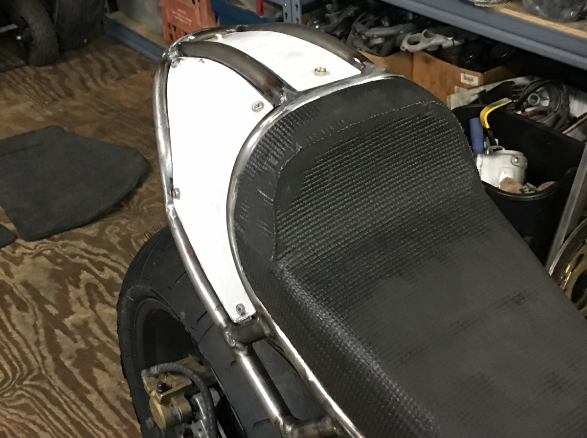

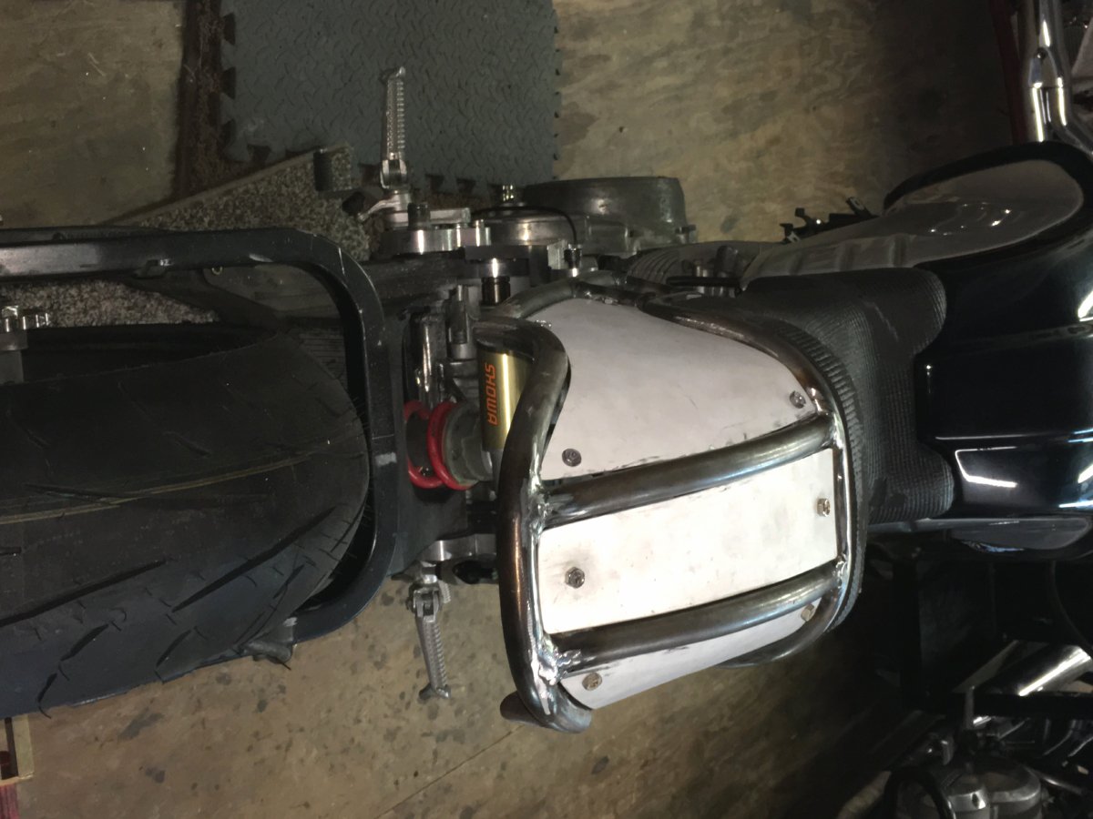

Just stalled a bit on progress haven't had much time to work on it lately. I did make some panels that fit into the sub-frame have a couple pics of that. I also started on my under tail muffler I'll take some pics and post that soon.

Really like the way that's looking, great work.
