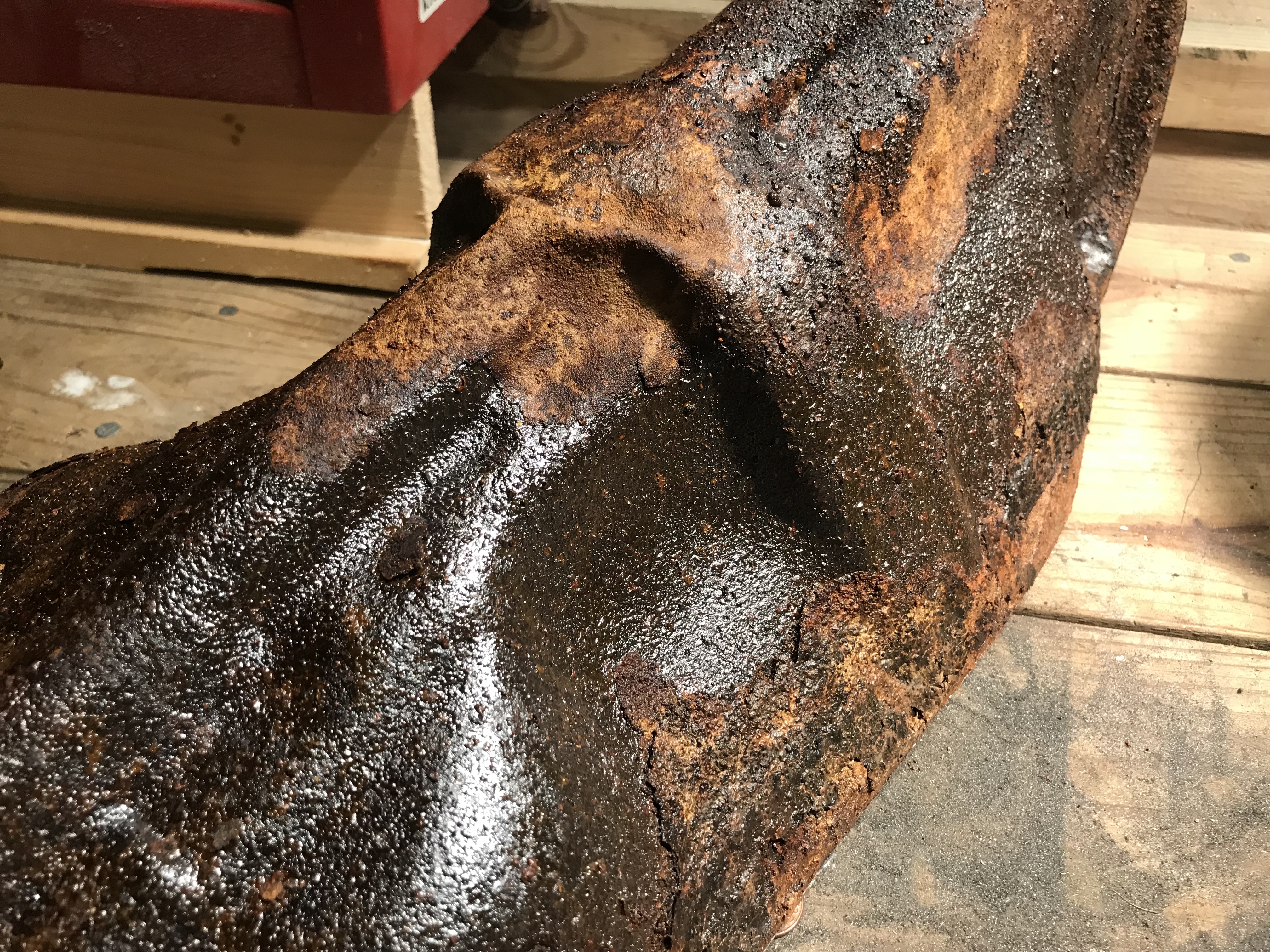

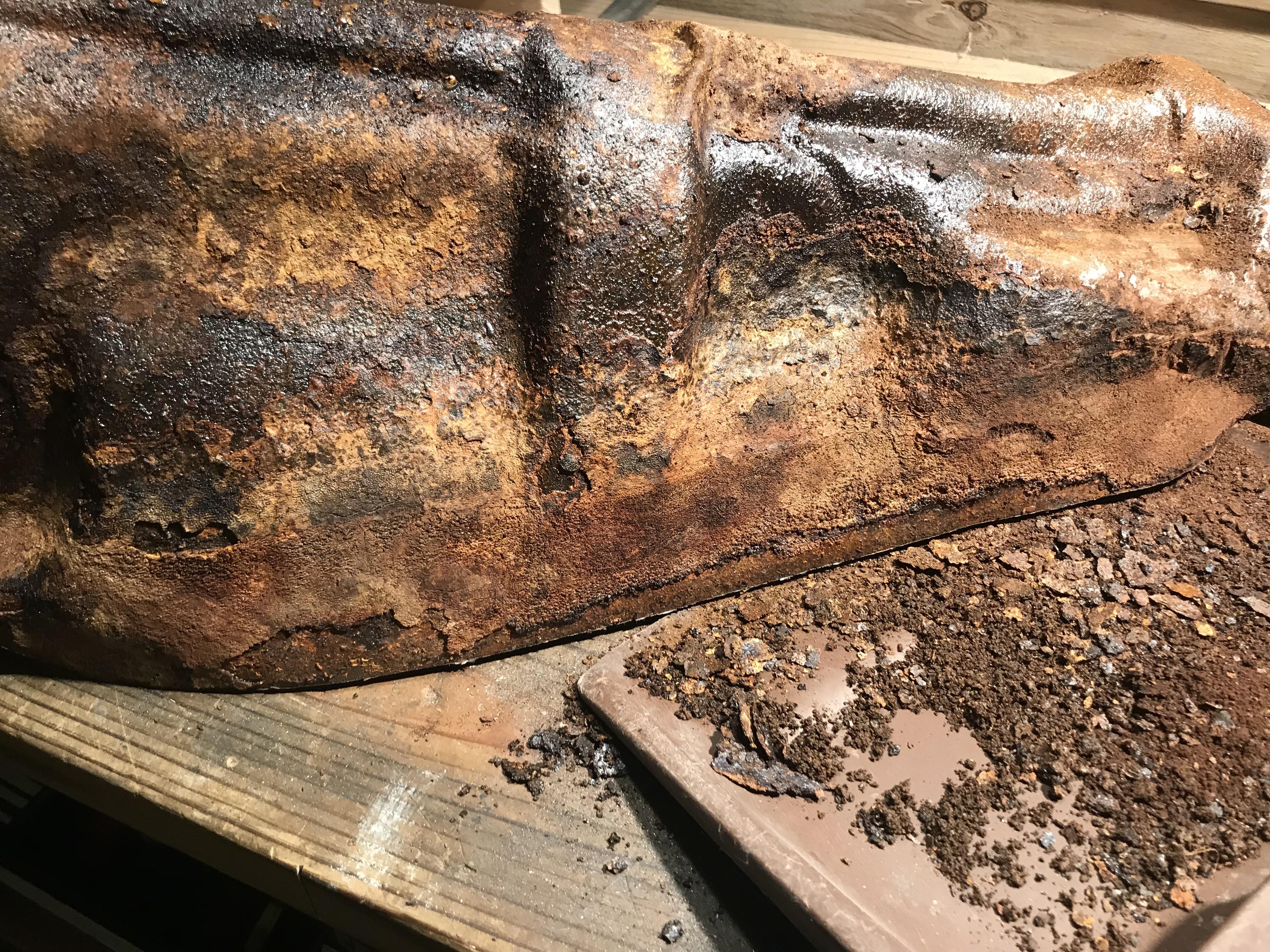

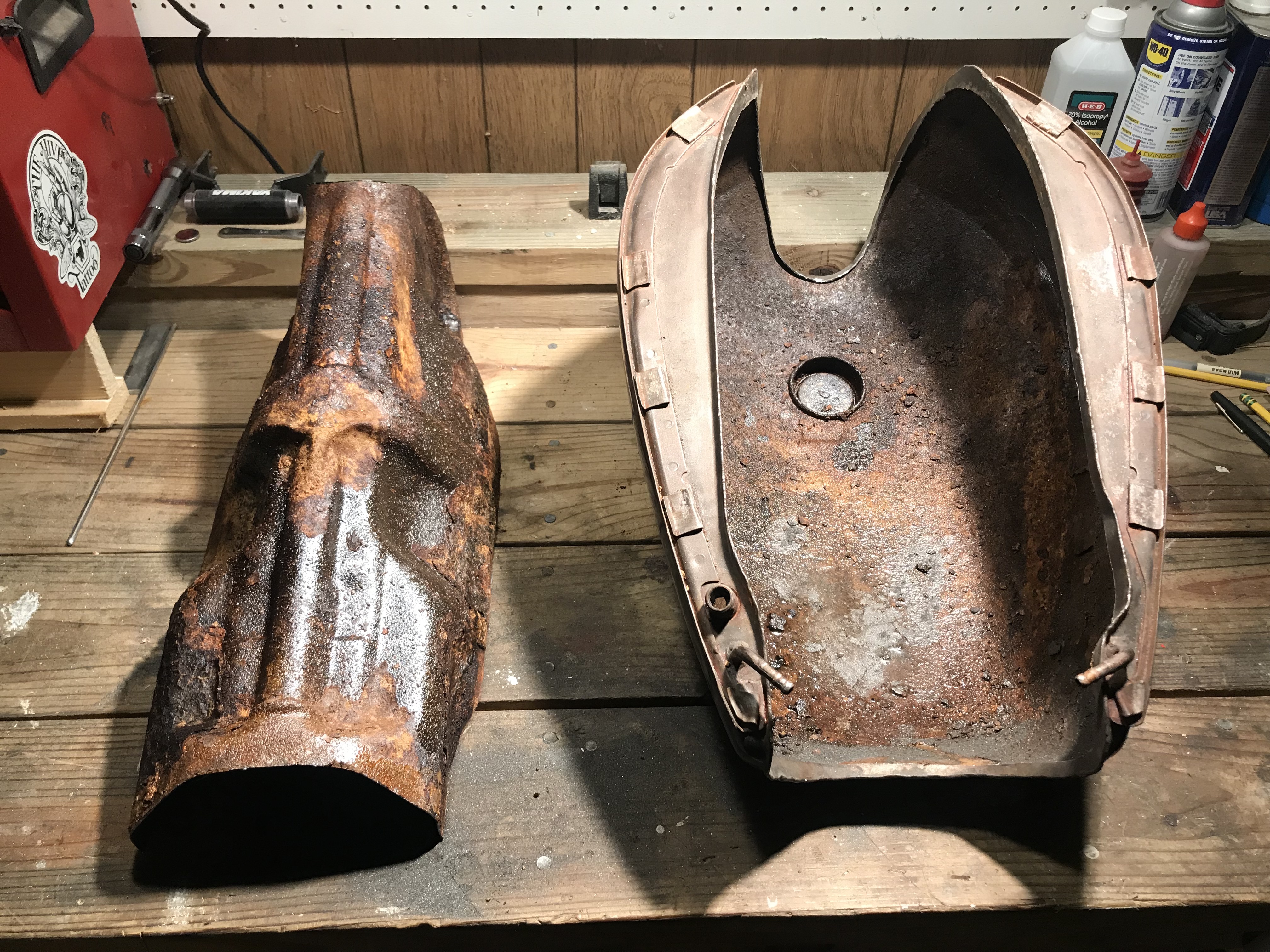

So the gas tank on this thing is pretty bad. I tried soaking it in vinegar and it didn't make any difference. I was thinking about just finding another tank, but the 350 four tanks that I like are pretty pricey. So I figured, why not slice this thing open and give it a complete scrub from the inside, bang the dents out and braze it back together? I figure all it's going to cost me is some sweat and time. So that's what I did. Started off by trying out a hacksaw blade, but that was painfully slow. So a I pushed my Dremel to the limit and used about 4 reenforced cut wheels. I was a little nervous about abrasive cutting into a tank, but I gave it a good flush with water and went to town.
Here's the inside:

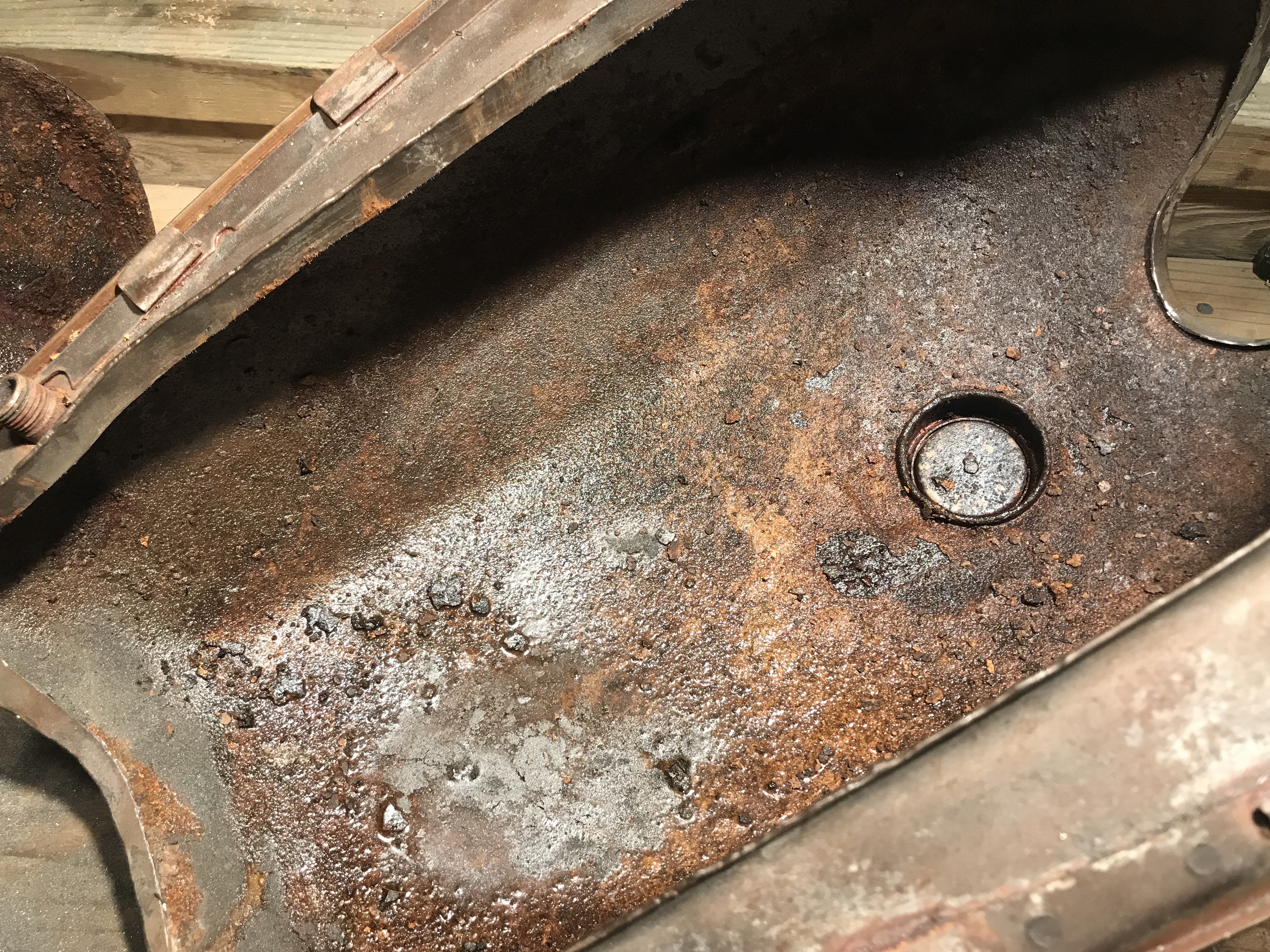

It looked like there might have been a weak attempt to seal this thing, there was some kind of layer of gunk in it that accumulated along the bottom 1/3 of the tank. As I wire wheeled through it, it smelled kind of plastic-y.
And a couple hours later I have a clean tunnel and shell. I couldn't really get into the seam as well as I'd like, so I might need to spend a bit more time on some problem areas, but this is a good start.
Someone probably used KREEM on it at some point. Stuff should be outlawed.
Lots of good protective coatings on the market like POR-15 or RED KOTE. KREEM IS KRAP.

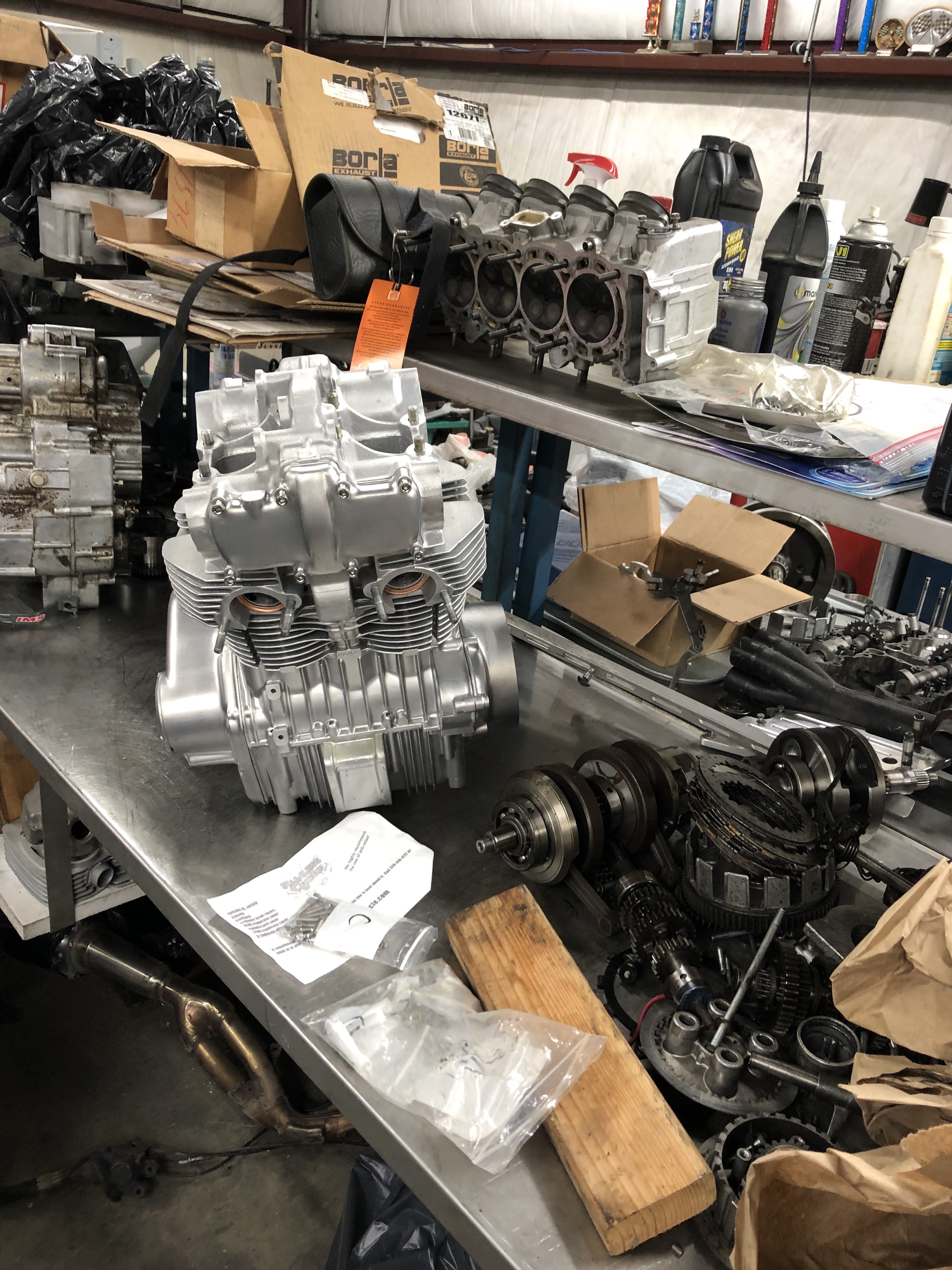

When I left off I was riding high, I'd found help and had dropped off my motor at the guy's place that was recommended. His shop looked great, out in the edges of Austin. He had a lot of motorcycles out there that looked like customer bikes and he seemed pretty legit. Well it's been almost a year and I still don't have my motor. I paid him $500 up front to help cover costs and the only time I hear from him is when I pester. I told him a couple weeks ago that I just want to get my motor and I don't care if it's done and he sent a picture and said he would wrap it up asap. And then two weeks go by and I hear nothing. I'm getting worried that I'll never see the thing again. I'm also worried that this job is going to cost more than expected. I've been asking for a price since day one and have only gotten a price for vapor blasting, honing the jugs and fixing a valve guide. On the plus side, the picture that I got a couple weeks ago looks pretty great. So there is always that. I haven't really done much to the bike in the meantime, because I wanted to make sure I had a motor. I knew this was going to take time to do, but this is pretty ridiculous.

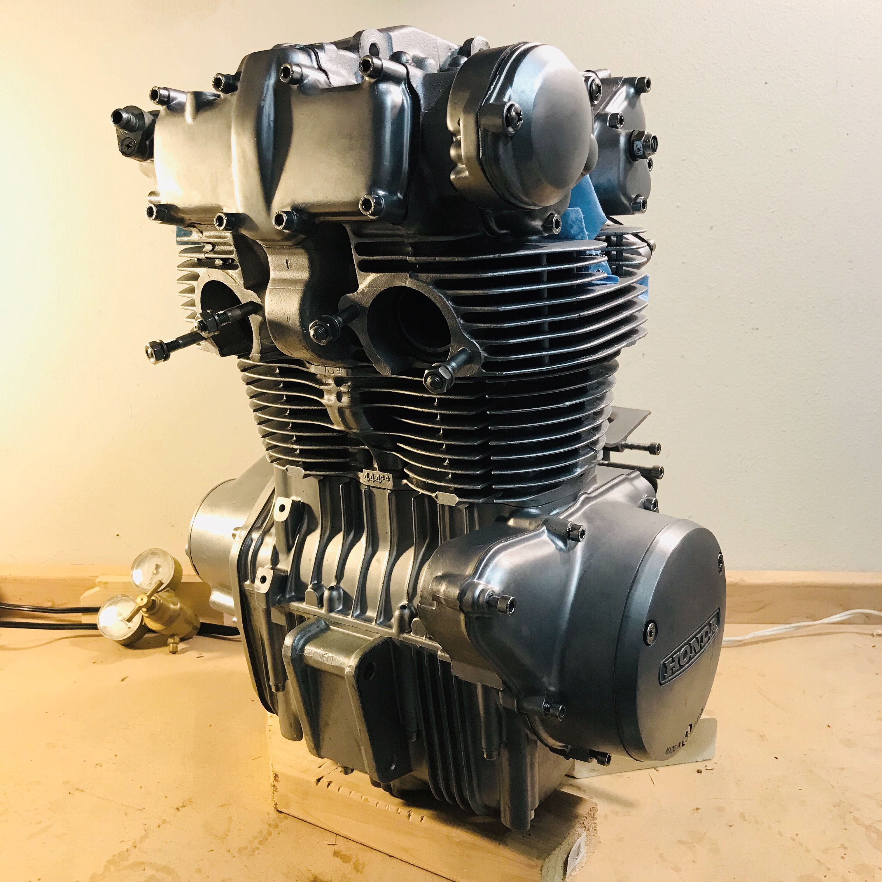

After another month and a few more nags I finally got most of my motor back!! It's missing the chain cover (I dropped it off with the engine, but it's gone missing :'( ) but everything looks pretty good. There was no need to add bore size, so it remains stock displacement.
That motor looks great. Did he fix the valve guide, and how did the pricing work out?
Yeah the motor got at least one new valve guide. not much else other than a full rebuild and cleaning and a new timing chain. As far as pricing goes, what would you expect to pay for a job like this? I'll say it was more than I expected, but I also had to wait almost a year for it.

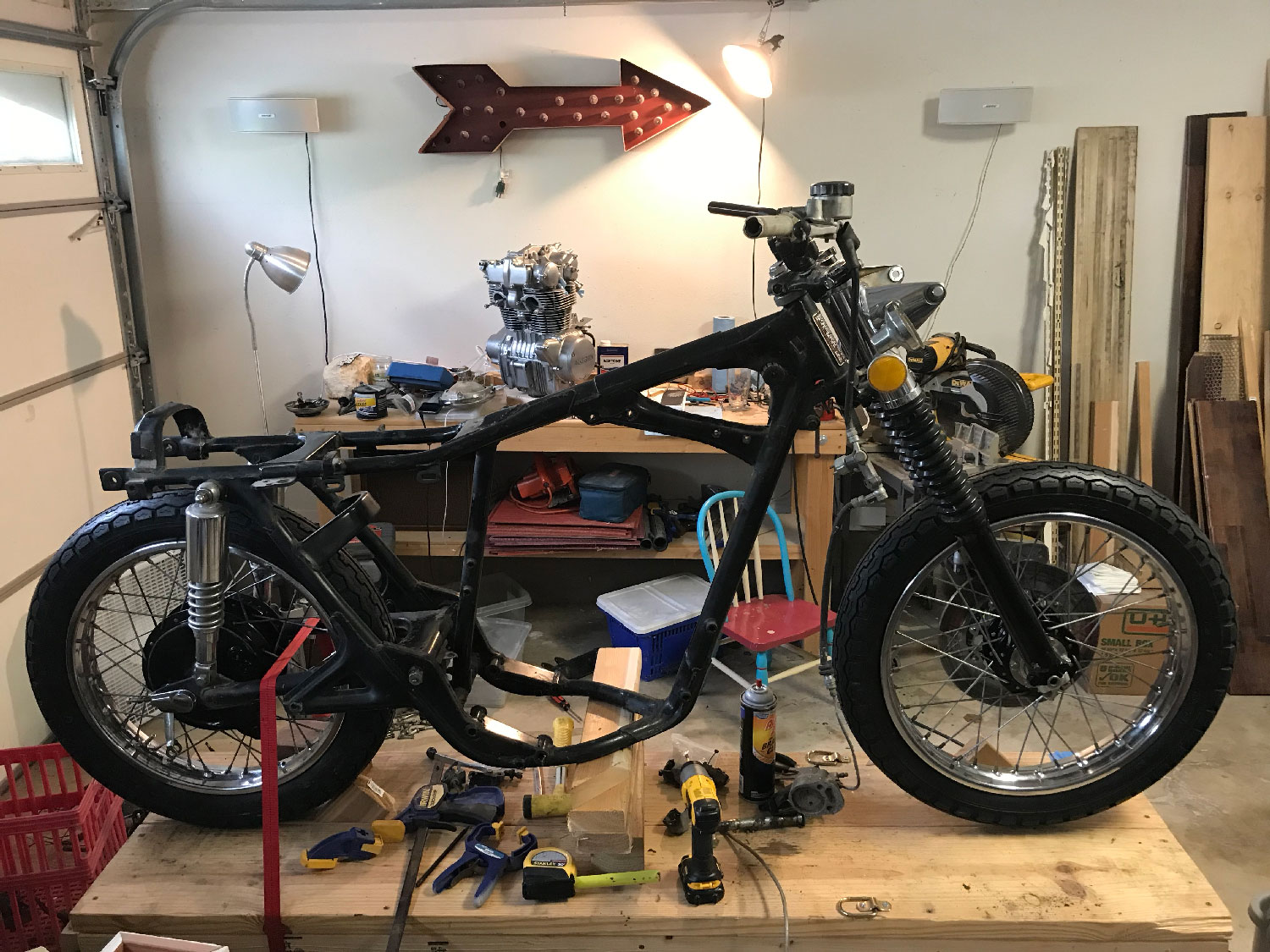

Now that the motor has become bench jewelry, I've got motivation to spend more time in the garage. I got new cheap duro tires and rebuilt the wheels with new bearings. I was on the fence about replacing the rims with some equal size guys (either 18 or 19 front and rear, but decided that I need to just focus on getting this one on the road. My wife quit her job, so the goal switched from making THE bike to making a bike that I can ride. I need to keep the budget down on this, but will try to add sweat equity where I can. Case in point, I called the local shop to see what a tire install cost, it was $38 per wheel! Is that normal? I decided to do it myself (and only ruined one tube in the process ;D ). So now I have a rolling frame! It's great to see wheels on there after this poor thing has been sitting so long. Next up is to figure out my tank and seat situation and start re-wiring the beast.
Here's how it sits as of today:
In the top pic on the work bench.
Your mechanic blasted it without removing the old copper crush gaskets in the exhaust ports? AND he lost one of your engine covers?
Wow.
Wow.
The motor didn't have any copper gaskets in it when I picked it up, Not sure why they are in that pic above (he sent that to me) Yeah, he said he found the cover and is getting it vapor blasted, so I should be able to get it back soon. Hopefully.

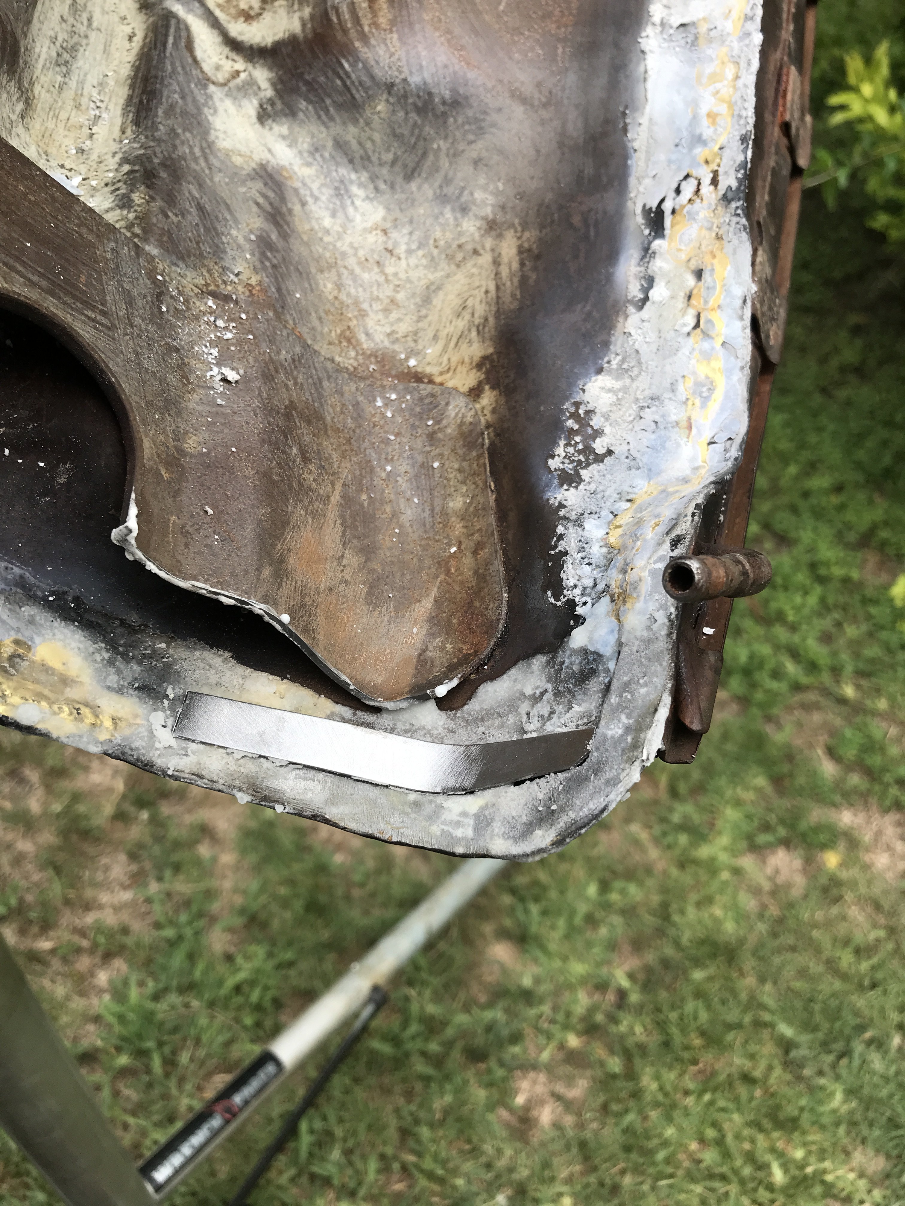

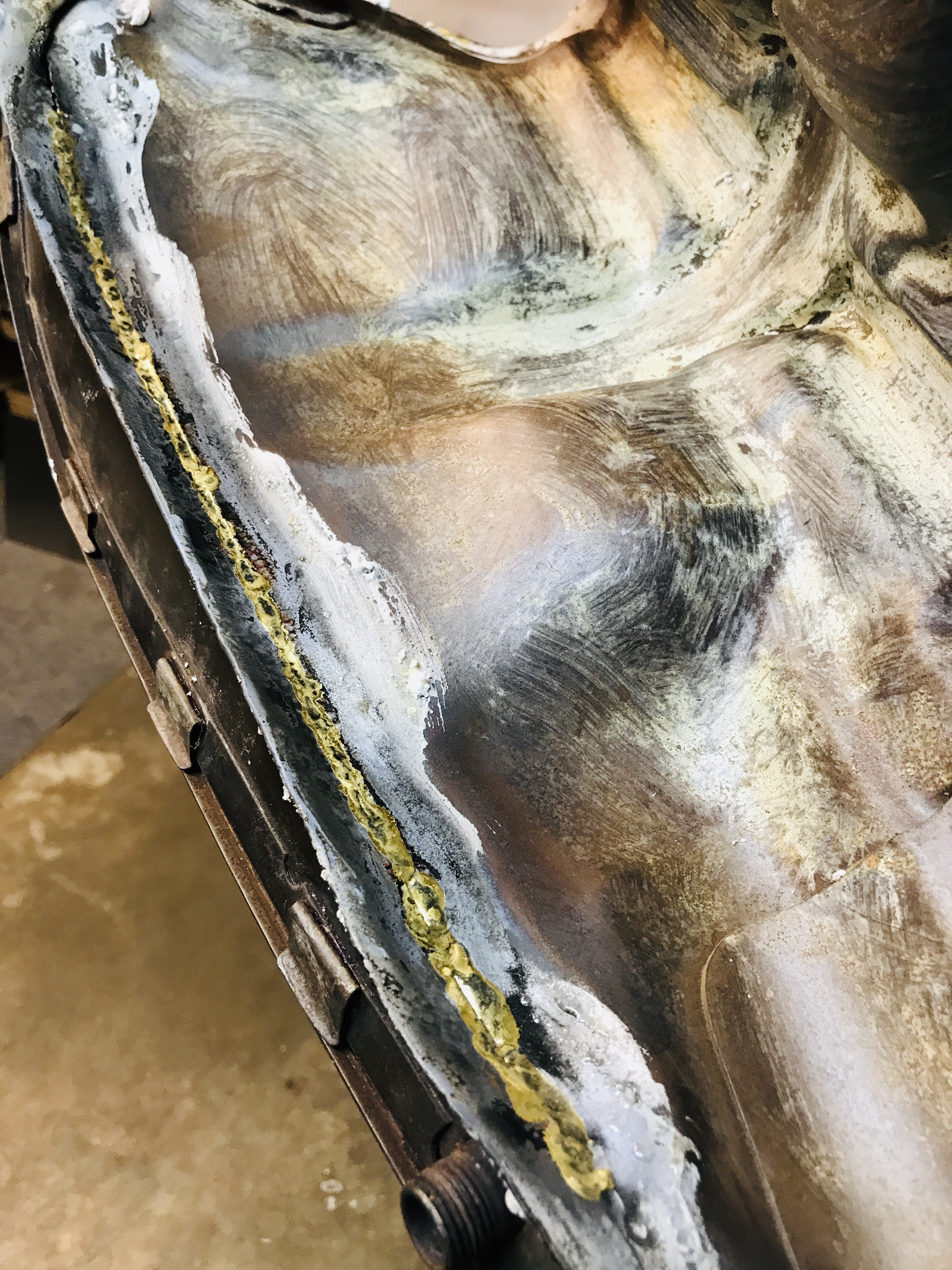

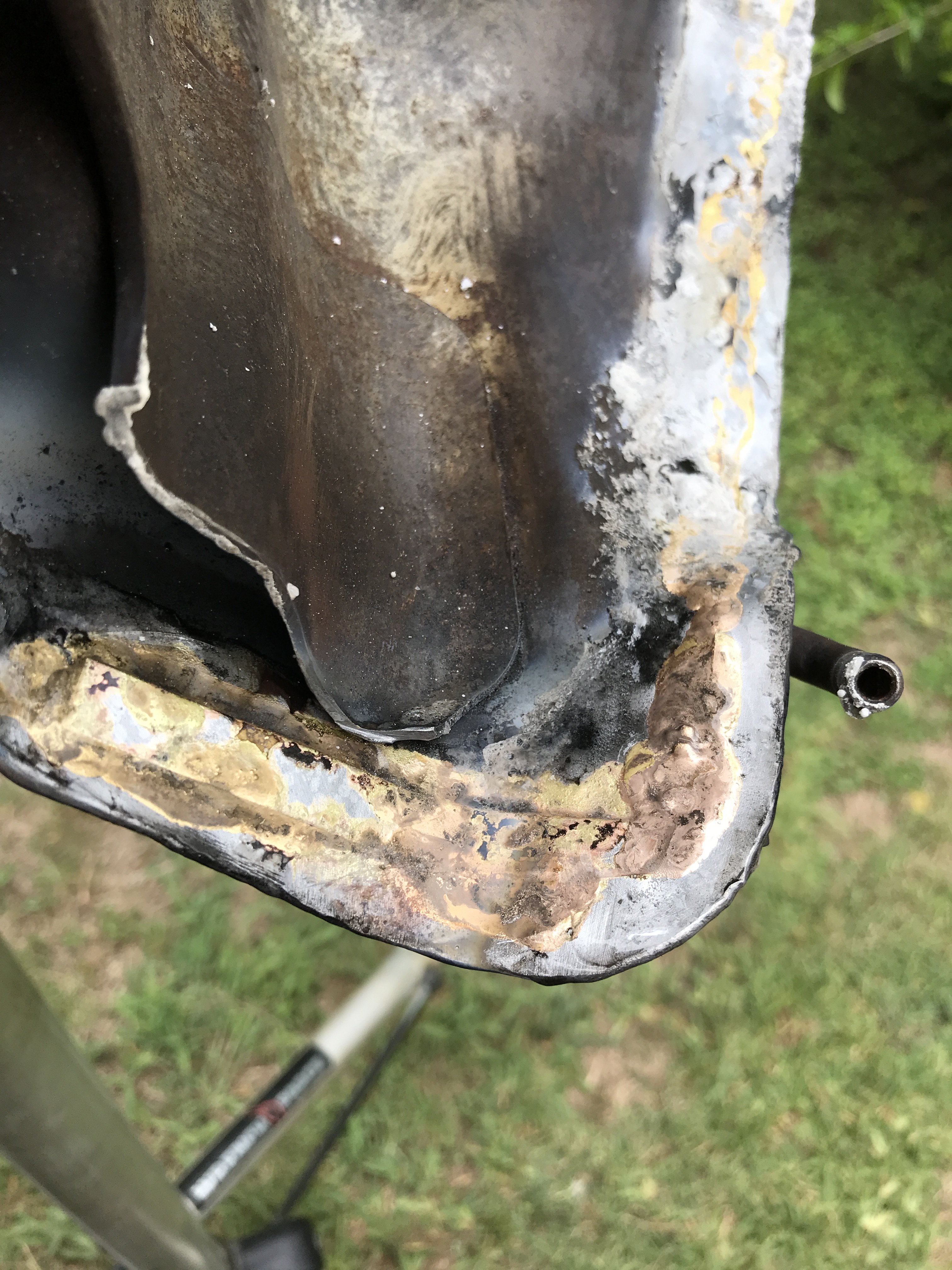

I started brazing my tank back together last night. I haven't picked up the torch in a couple of years, but I feel pretty good with how things turned out. I tacked the tunnel to the tank and then attached the sides. I need to make a piece to cover up a 1/4 inch gap in the bottom of the tank, and I expect I'll have that all buttoned up by this weekend. Then I should be able to test for leaks. I'm thinking that I'll probably still coat this thing once I get it together.

A few more brazing shots
I had a gap to make up in the bottom that wasn’t going to be able to fill with just brass, so I spliced in a little material. Turned out fine. Testing for leaks tomorrow.
