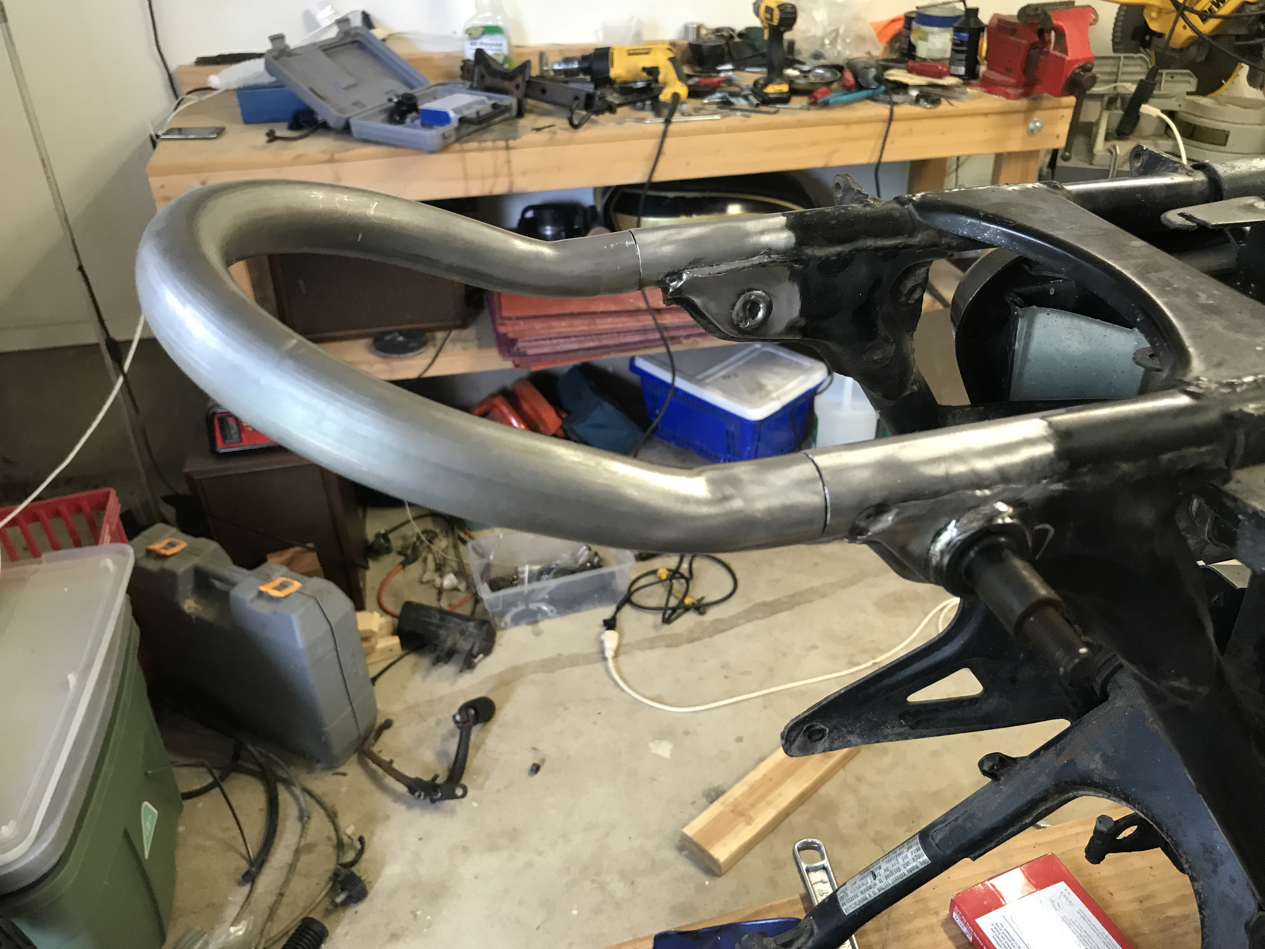

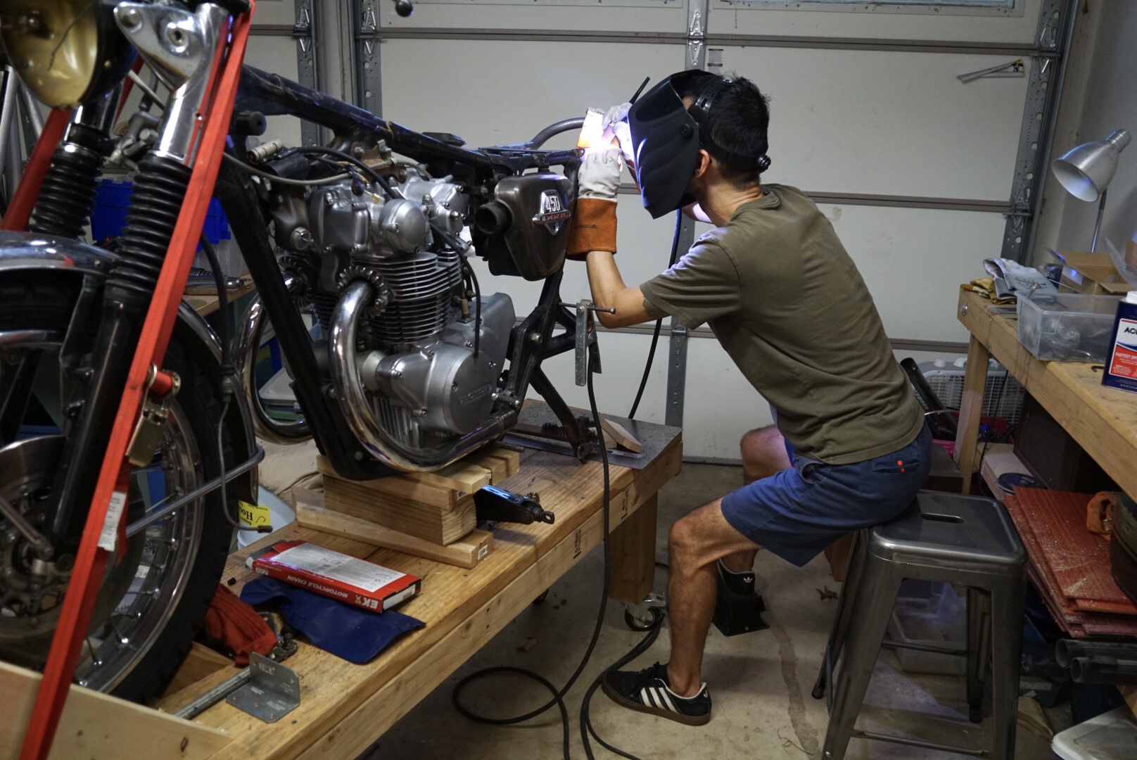

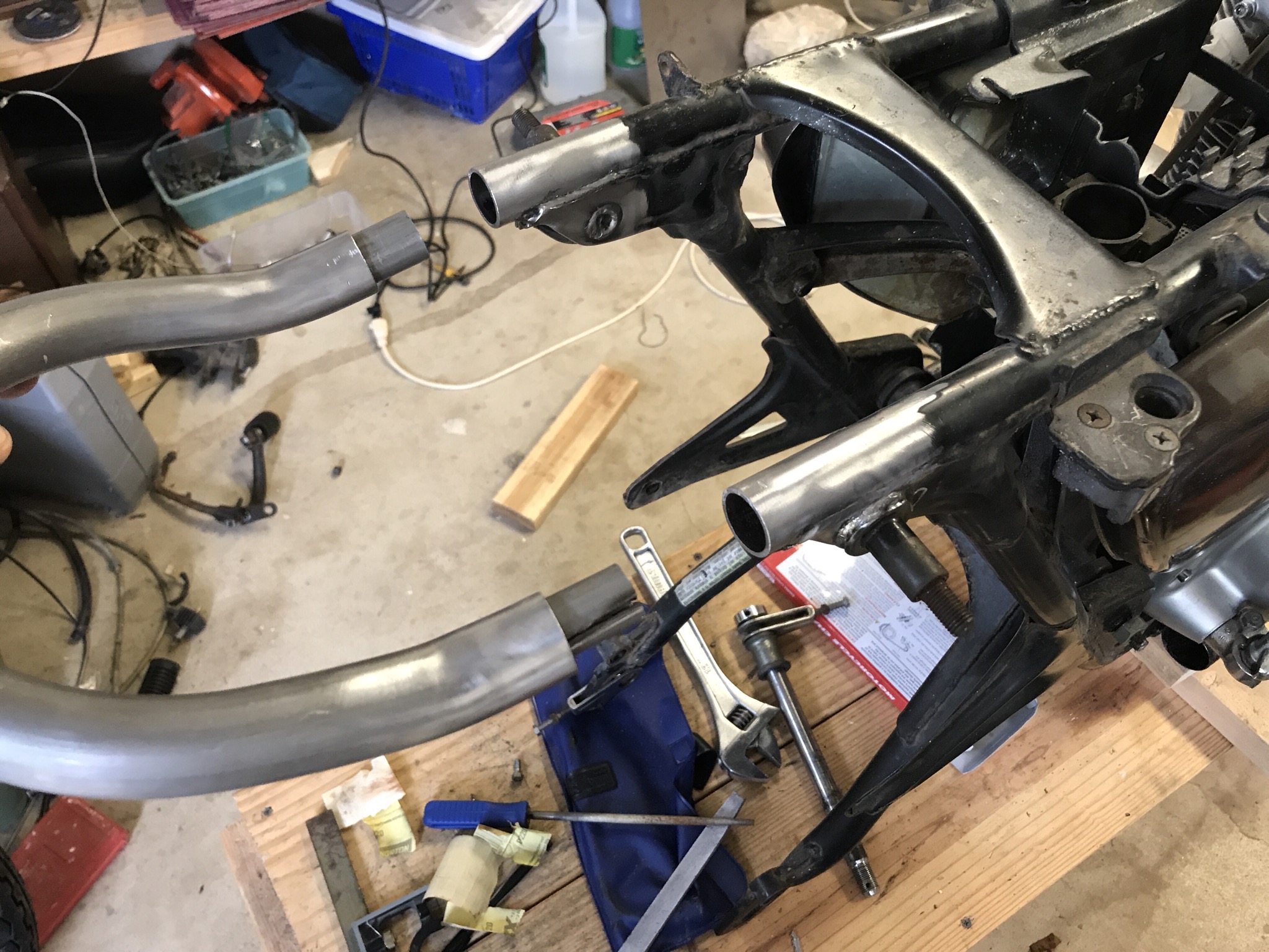

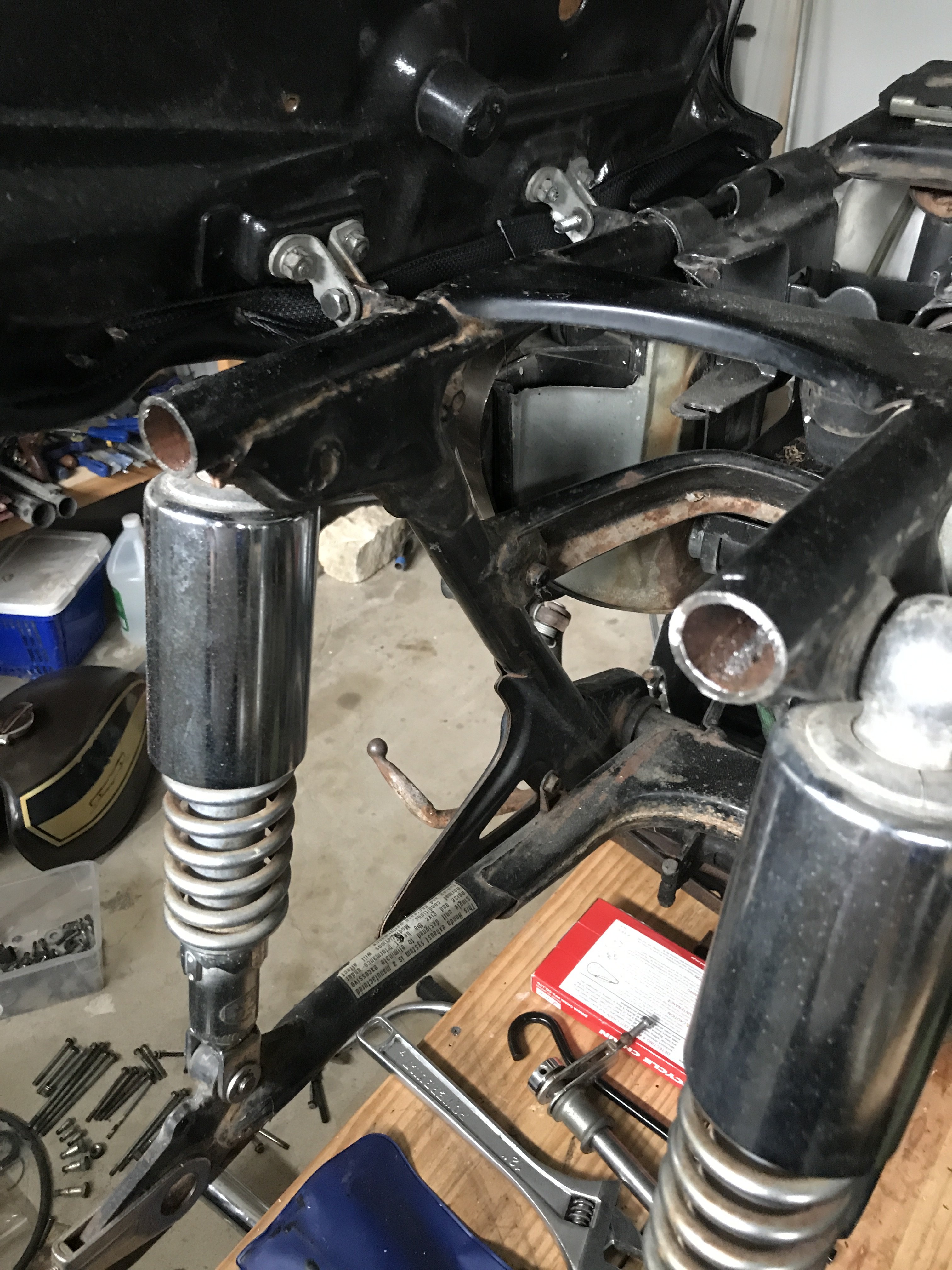

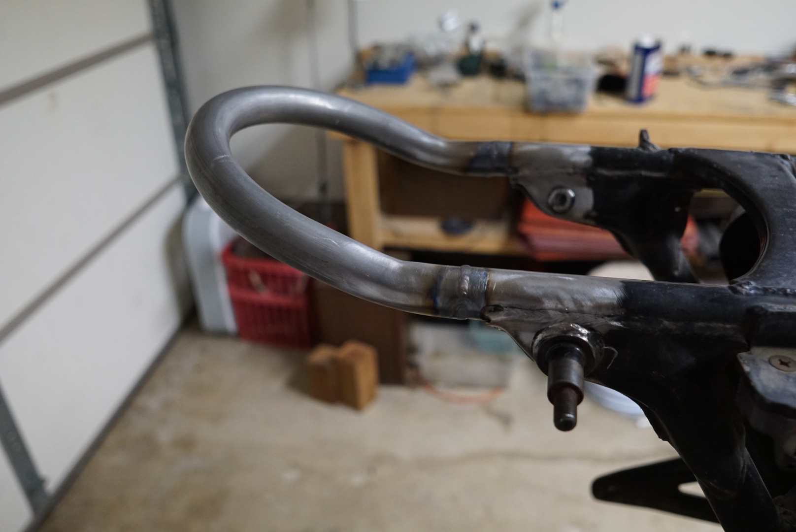

Went ahead and got a frame loop from Dime City. I opted for the extra Bend to try to keep the rear tire clearance where it should be. Was thinking I was going to braze it, but then decided to ask a buddy if he’d be able to come over and TIG it. Fortunately for me he said sure! Now I can figure out the rear lights and fender situation.

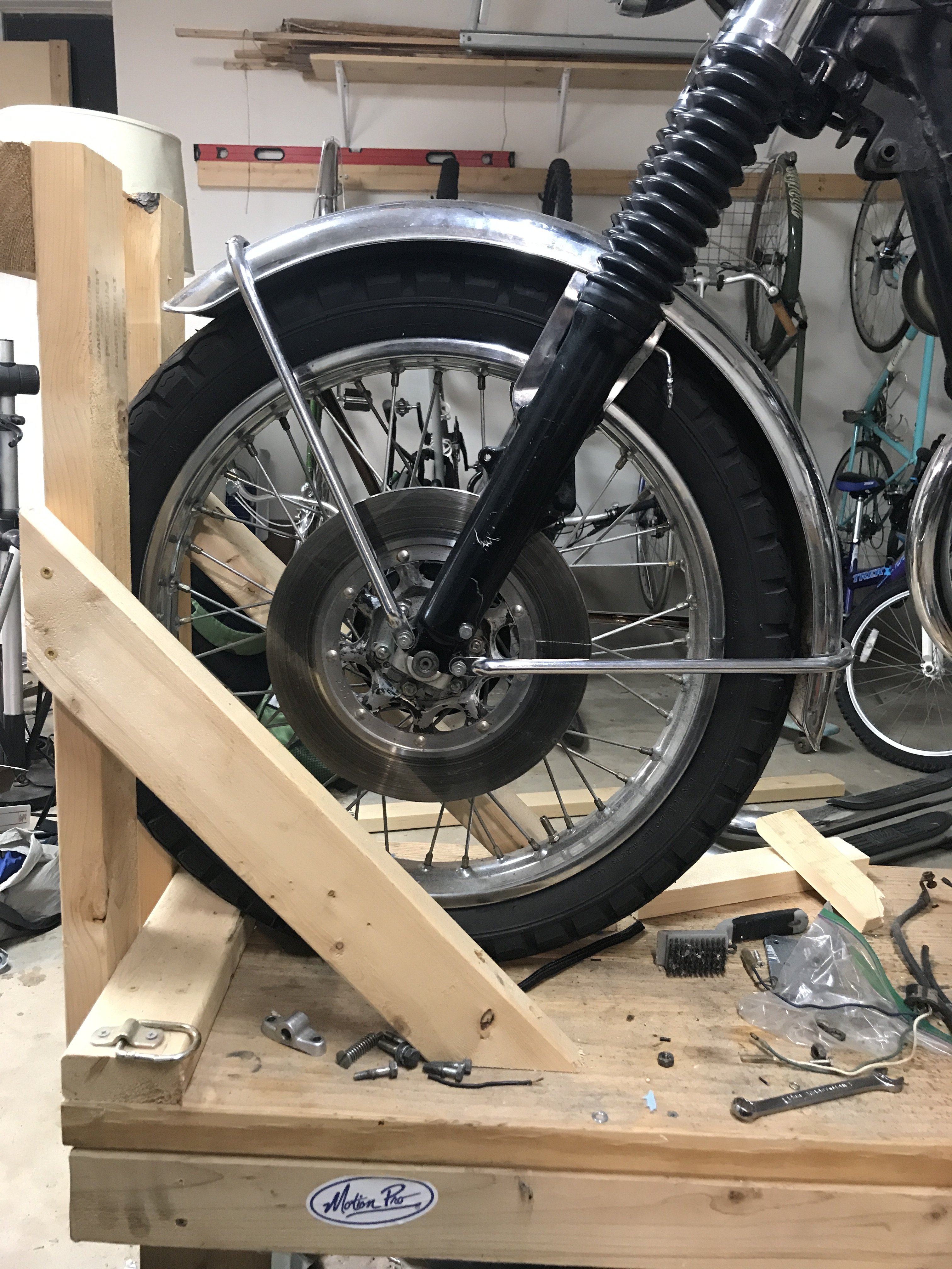

I worked on the bike for a bit last night and decided to fix the front fender. I wanted something a little sportier and wanted to keep the connection between the forks so I don't lose rigidity. I pulled the fender apart, ground off the riveted on struts and hacked it down. I still need to clean up the edge, but like the result a lot.
The final step was to drop the height a bit. I don't like seeing daylight between the fender and the tire.

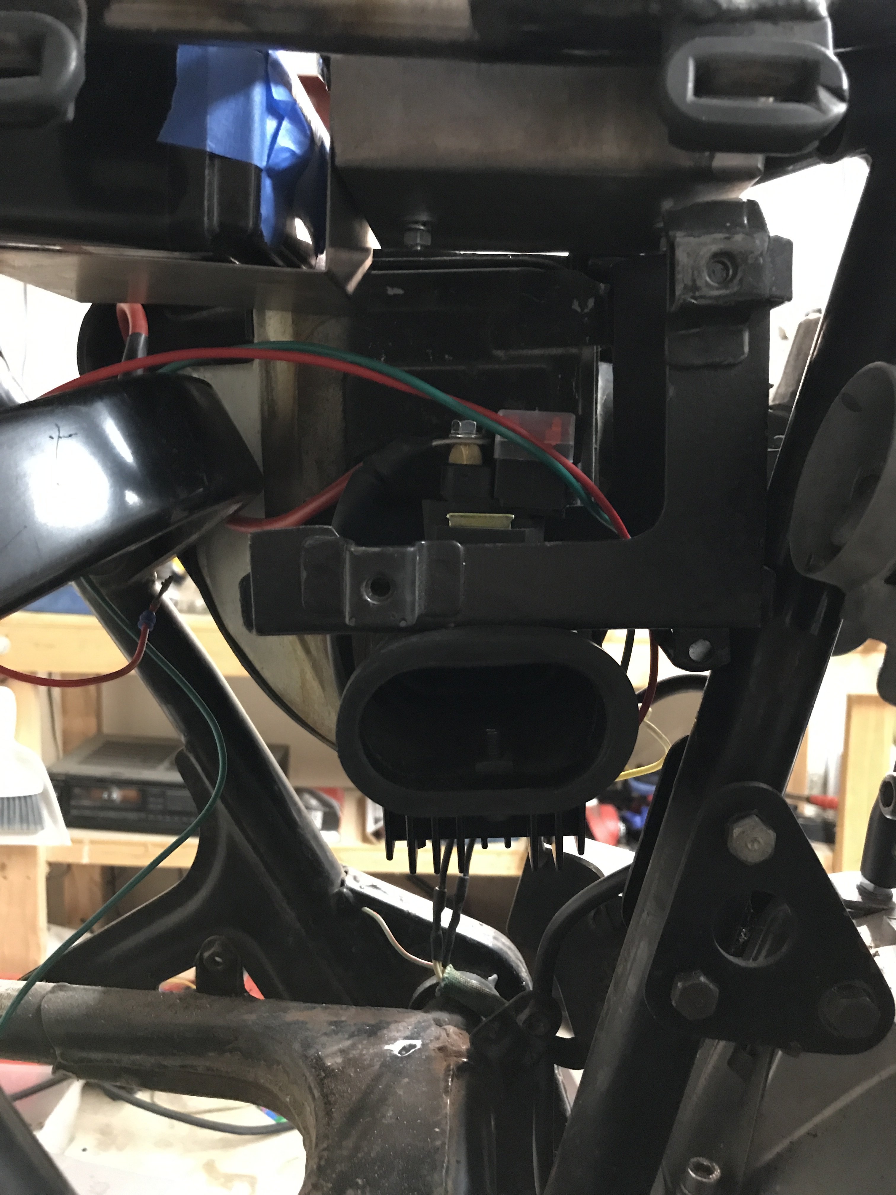

I needed to get the electrical system sorted, and decided to move the battery and m-unit up where I could access them easily, but I am keeping the stock air boxes, so there isn’t a lot of room to work with. I cut down the stock battery holder and bolted the reg/rec under it and the starter solenoid in the spot where the stock battery would have gone. I think it’s going to work out great.

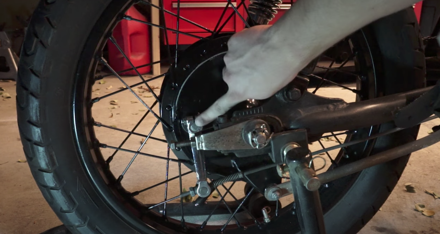

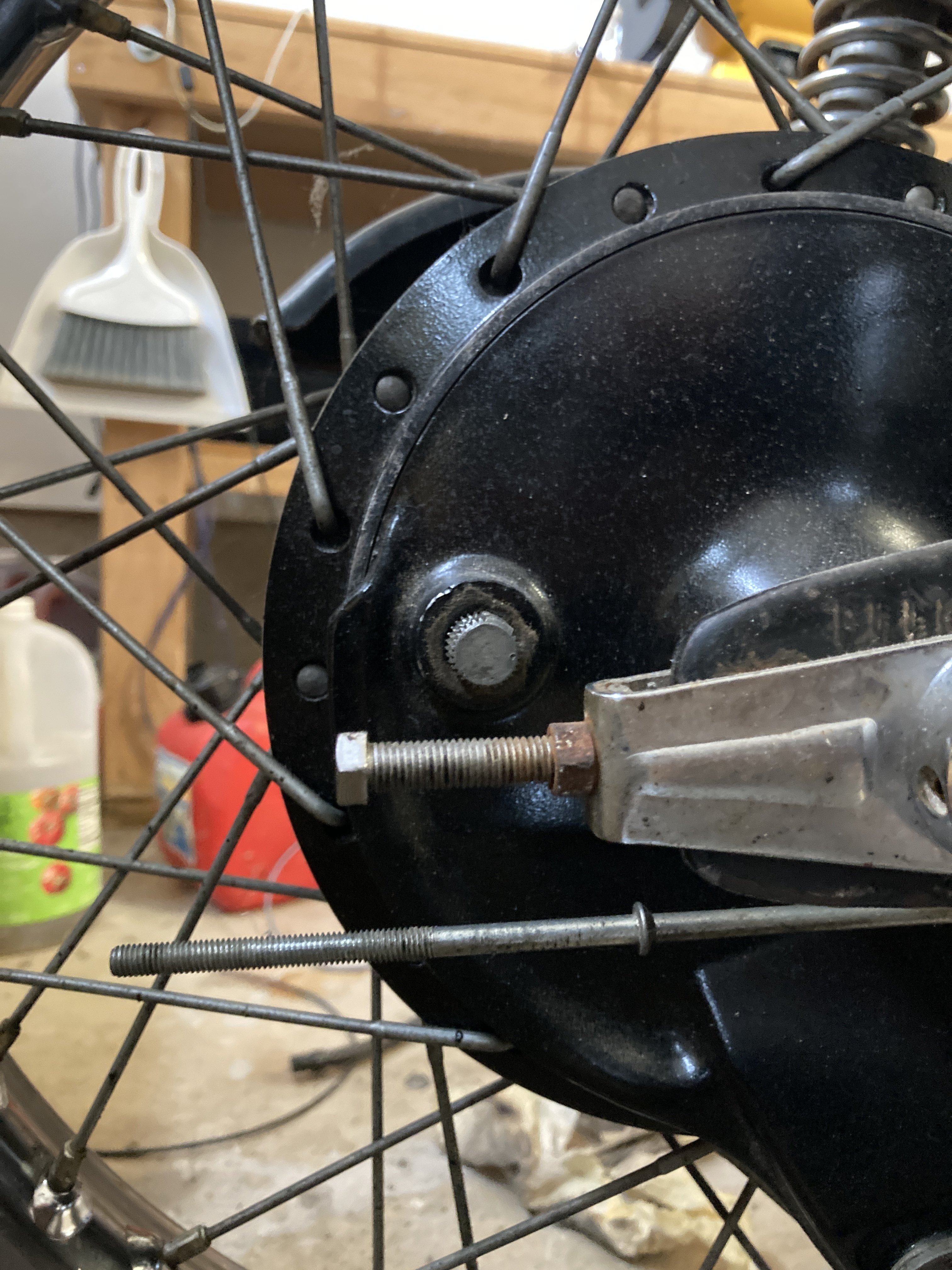

I bit the bullet and ordered the part from cmsnl. And now I have a clutch! Another step closer. As I'm assembling the rear drum brake I've noticed that the engagement rod seems like it is too long. Does anyone here have a measurement for the stock rod length? Looking at the side of my bike the threaded end starts beyond where the arm would drop down at a 90. I'm not sure I'll be able to set this up properly. If I compare to what I see on other bikes, mine is definitely longer. Again, since this bike was non-running when I got it, I may have acquired the wrong brake rod. Maybe I can shorten it? Attaching a pic that I grabbed from YouTube and mine (the one without the arm attached)

I got the linkage sorted. I did need to shorten the rod a bit. Used a tube as a sleeve to brass braze it back together. Now I'm having an issue with my front brake. I bought a new caliper and have a new caliper piston and seal, the piston does not want to slide very easily in the caliper. I had to use a vise to compress it in there an after bleeding the brakes it sticks and the brake rubs. The piston and the seal came with the bike, but were new (along with new brake pads). I bought the new caliper because the old one was a mess. I'm not sure if buying a new seal will fix this problem. Any thoughts?
