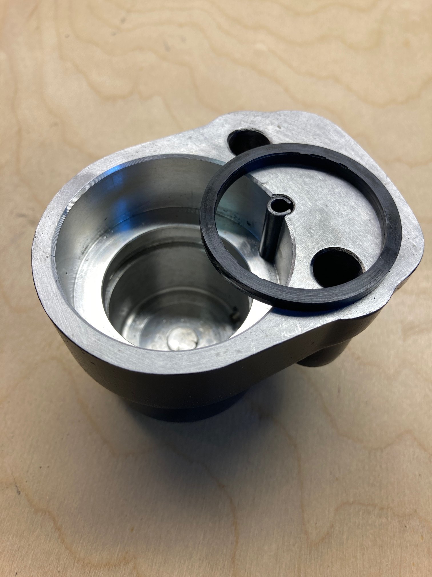

Thanks for the idea. When I was bleeding the brake I could see that both holes in the MC were not plugged, is there another hole that you are referring to?
I am pretty sure this is related to the amount of pressure needed to push the piston into the caliper though. I just pulled it off again and the seal looks ok, there are some tiny nicks in it, but I think it's fine. When I installed the piston I could stand on it and it wouldn't move into the caliper. Using blocks and my bench vise I got it to seat, but it takes a lot of pressure to move it past the seal. It looks like the piston should be able to be installed by hand, right?
Yes, it should fit in by hand. Did you lubricate it and the seal with clean fluid on installation? The rubber needs the fluid to lubricate it some. Otherwise, sounds like the seal is too fat or piston to large OD. Does it fit in smoothly without the sealing ring?
Yes I did use DOT fluid on the seal, and after taking it off there was residual fluid on everything. The piston does slide freely in the caliper without the seal. I think I may just order a new seal and see if it’s any better.
Make sure nothing in the seal groove. On seriously gunked-up old cylinders I use a small brass brush wheel in a Dremel. Could also be that you just got the wrong thickness seal. Can you compare it to the old one?
Good thought, unfortunately the old seal is still stuck in the rusty old caliper. It was so bad that I just bought a new caliper. The piston is new too. I ended up ordering a new seal just to make sure I've got the right one. Should be here in a few days and we'll see how it compares.

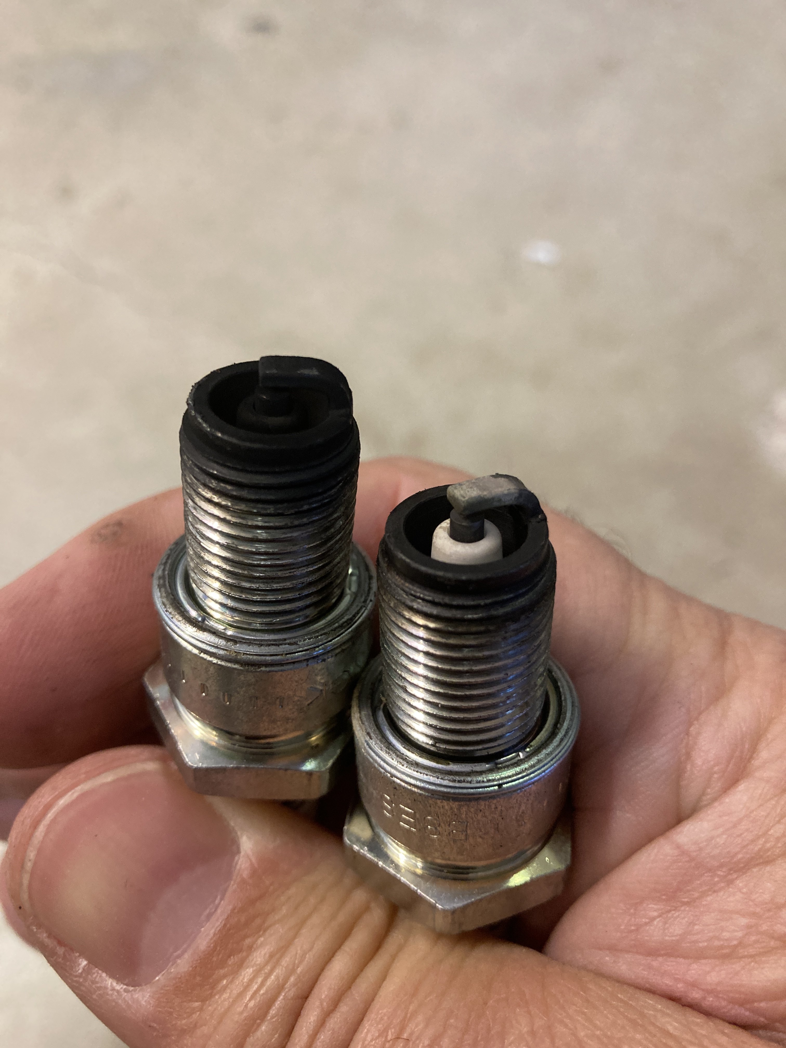

After the short ride the other day I pulled the plugs and it looks like it's running rich. The left side is richer than the right. The bike starts fine and once it gets up in the upper RPM range it seems like it wants to go, but the low and midrange are really bad, so I decided to move the needle up. It was in the middle clip position and I raised it one. It is still lagging, but it does seem to have improved things. When I was letting it warm up, I could hear and feel that the left exhaust was more sporadic than the right side. On the right I could feel consistent pulses of exhaust, but on the left side it was not as smooth feeling.

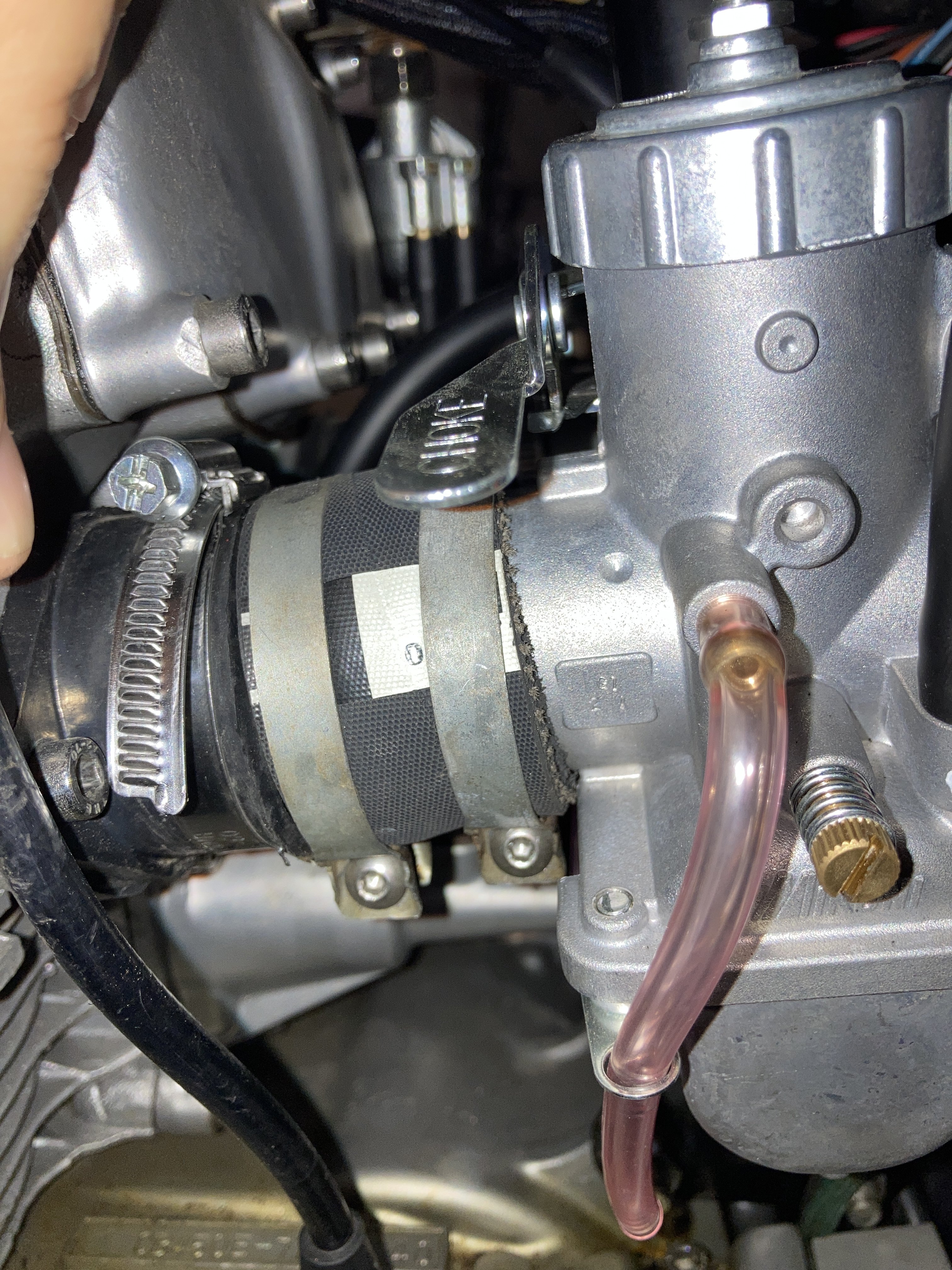

Another thing that kind of bums me out is that the manifold for the Mikunis uses an additional piece and three (!) hose clamps (or jubilee clamps) to hold everything in place. There must be a better way to mount these carbs to a CB 45o motor, right? This feels awfully hacky. Tell me I'm wrong.

Unfamiliar with the motor, but just by your photo I suspect that your Mikunis are WAY too big for the motor. And this is the reason for poor low/mid range performance, also. But, not coming from experience. I think a lot of folks on here have experience with them, and given time will chime in. I would pull one carb and get the numbers/measure to give them something to go on.
I also do not have experience with this motor, but it looks to me that the reason for the extra stuff used to mount the mikunis is needed because the stock boots are too small to fit the new carbs. This is not to say that you must go back to the keihins, but you may find that to be the easiest route in the end
Plugs:
left in the picture is either extremely rich or burning oil or both. Right plug looks really clean and maybe lean if the bike wasn't running hard. Plugs are designed to self clean ie burn clean when they are run hard. when the bike runs less than flat out the plug temperature is much lower and that results in lots of black deposits. Stock were probably grade 8 back in the day but for gentle riding you could go to say a 7 grade at least until you get it dialed in. In CB77 racers we used to run D12. Our CB160s ran D10 on race gas and D8 on street gas with no sign of distress.
Carb mounts:
The OP is correct. The stubs/adapters are because the carb outlet spigot is too large to slip into stock carb mounts of because the carbs are hitting the rocker box. I have used that sort of set up in the past when testing different inlet lengths, but the better solution is appropriate sized inlet manifolds/mounts.
