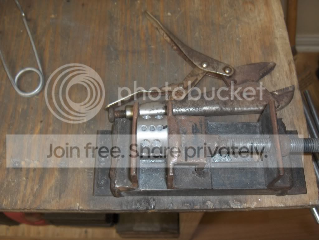

Sometimes when I don't have anything immediate to do on my bike, I just sit and stare at it, in a moto trance. I look at the things I've done and have to do and try to improve on them. While waiting for the rest of the parts I need to get this thing running, and in the moto trance, I came up with a neat idea for a return spring on my rear brake lever.
Started out with this...
I took off the spacer and dug out my original return spring...
Then I marked a spot where I wanted to cut a slot, about the width of the speed holes I drilled previously...
and cut out a slot with several different dremmel bits and cleaned it up later with some files...
Then I went back and heated up the spring w/ a regular Mapp gas torch to turn this little keeper pointing out side the spring, to point inside the spring.
Here's how it ended up... Oh yeah, Happy belated Cinco de Mayo everyone!!!
Now they fit together like this...
I then had to heat up the other end of the spring to wrap around my lever correctly. Here's how it turned out.
Now all I have to do is create a stay for the lever, so that it doesn't return to far. Right now there's nothing to keep it from rotating backwards. I have another neat little idea for that one. I'll see how it works out this weekend.
Thanks for looking.

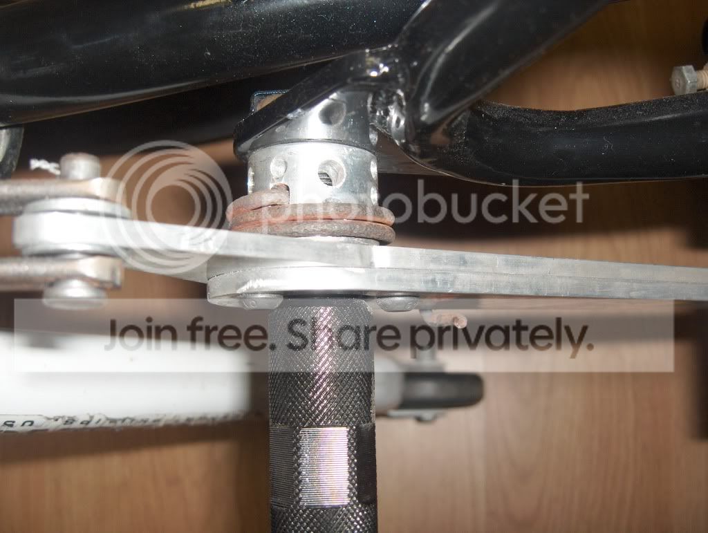

CrazyPJ, I think utilizing the original brake arm pivot is a better way to go, instead of flipping the drum arm and crossing the linkage over the swinger, as I did. I've been looking at it as something to tinker with in the future.
Check out the lever stay I whipped up yesterday...

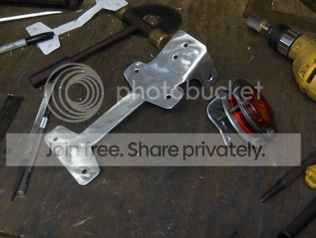

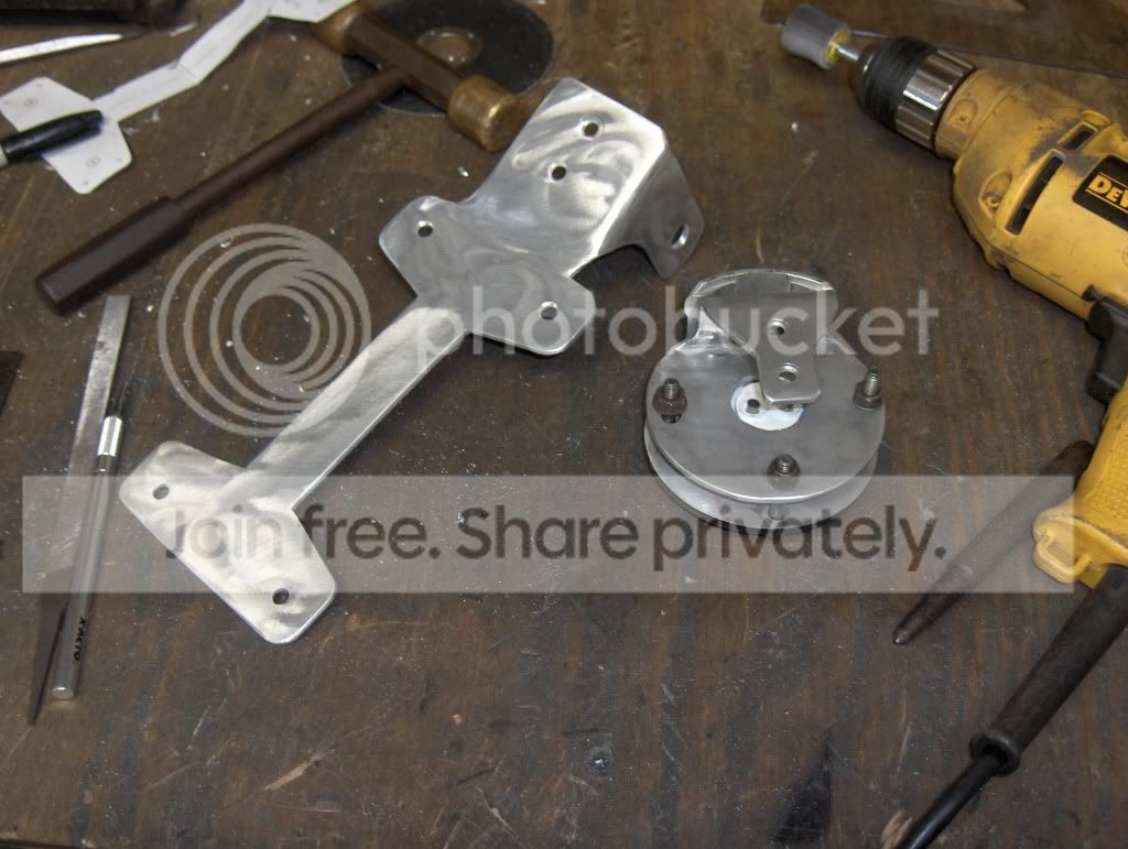

I have had an idea for a tail light locked away in the back of my mind for a while now. So, I've been playing around with it for a week of so now and this is what I came up with.
That's right, it's an old piston. Originally I wanted to use single LEDs, mainly because I have a handful of really sweet stainless steel LED holders that I pulled off of a prison control panel, from a job I used to have. I also had already purchased this sealed LED trailer light. After building the 'loose' LED circuit, of 12 LEDS, I just wasn't satisfied with the maximum light output. The trailer light has just three of the superbright, square style LEDS, and it is BRIGHT. Once I got the trailer light install I was struggling with a way to hold the light in the piston and also how to mount the assembly to the tag mount. You can see what I came up with. I have to swing by Fastenal and get SS hardware, what you see in there now is just temporary.
I haven't begun to wire any of my lighting circuit yet, but will soon. Here're some more pix of the light and tag mount.
