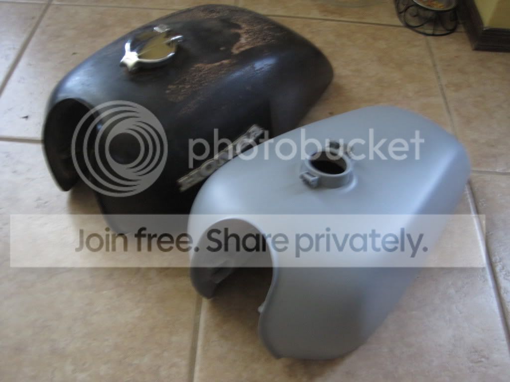

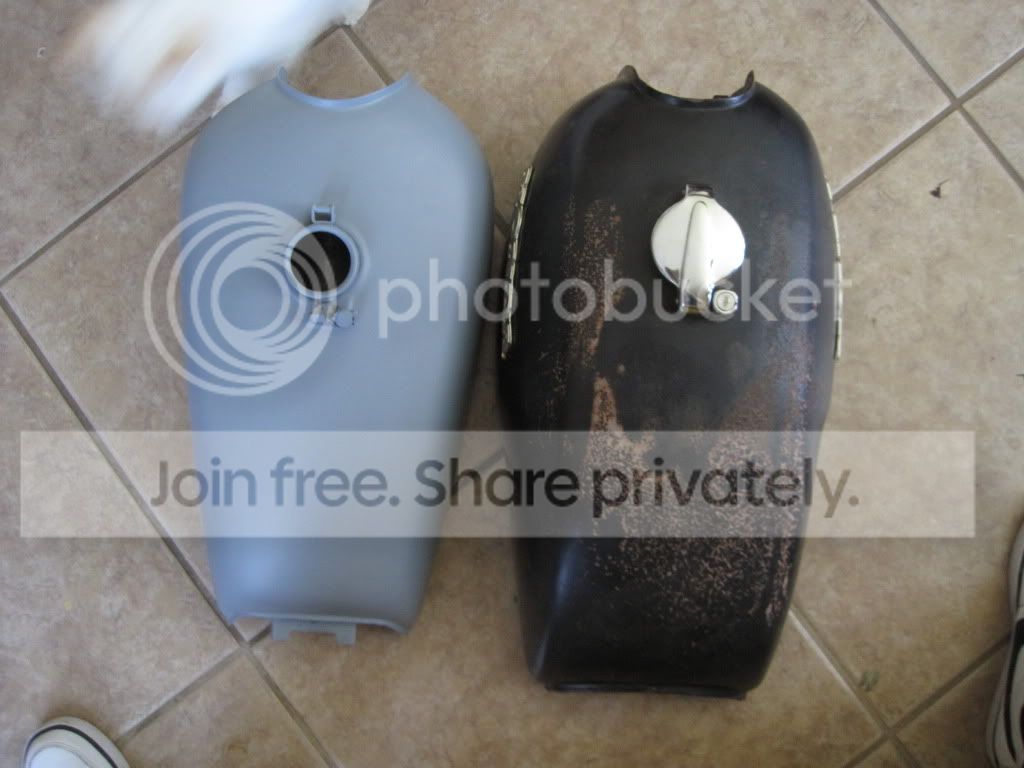

I was about to buy this cb500t tank from a guy locally for $80 and I thought it might be too good to be ture, and it was, I went to go check it out and it had a nasty dent in the side that was pretty bad, rust inside, and which can all be fixed, but I noticed the bottom and the rusted out. At this point I was already eye balling one on ebay for 110 shipped, which it was super nice for that price. So I offered the guy 90 bucks and I won it and It came in today and looks great, the gas cap is still nice and the inside has been cleaned, and literally no dents or dings just bad paint and surface rust, which is expected. And now I have 3 honda emblems. :)

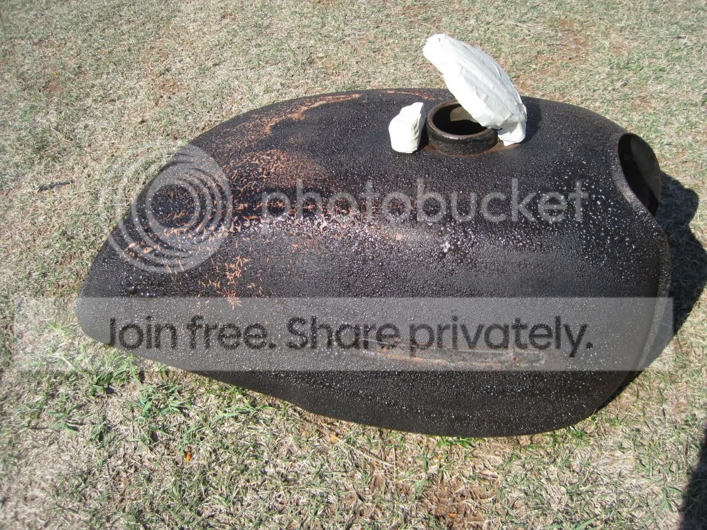

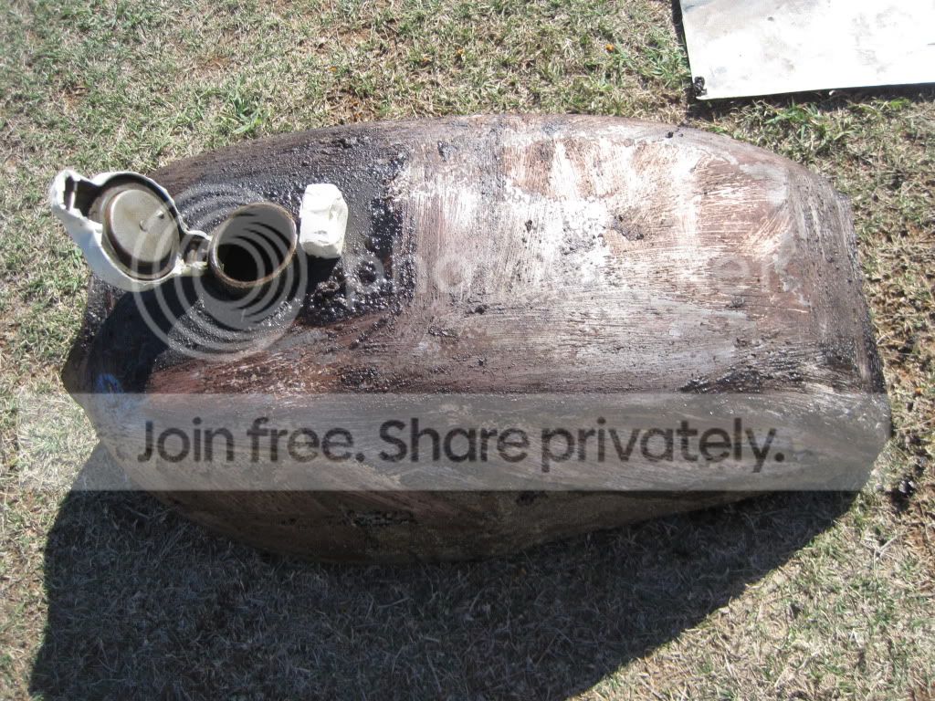

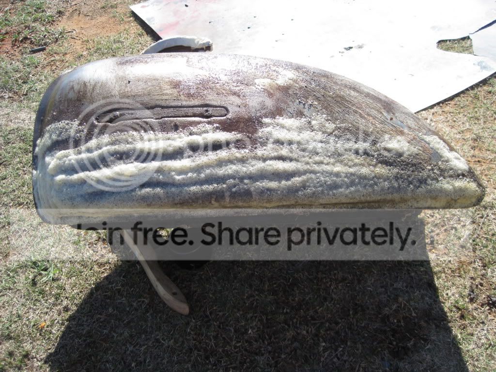

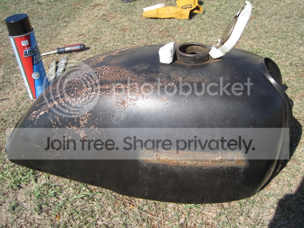

I bought some aircraft remover in an aerosol can, which I have never used before, and I highly recommend it. It gets good in the crannies and easy and fun ( to me ) to apply. The tank has about 2 minor dents, that will be easy to fix.
Nice work. I have found the non-aerosol aircraft remover to be significantly more effective. It comes in a quart size tin, like paint thinner, and you just paint it on with a chemical resistant brush. Works magic everytime. Burns like hell if it splatters on you though ;D Also, you can just wash it with water which is super handy.
That tank is going to look great with your bike.

Thanks, and yea I thought the stuff in the quart was more effective and it doesnt foam up, and you can just lay down some thick coats of it. The spray is more fun, and thats about it, ahah. But they just had a gallon to the paint store I went to and didnt want to drive somewhere else and wanted to try this stuff out. Aggreed that its not as effective as the brush on, because it would have been striped by now.
